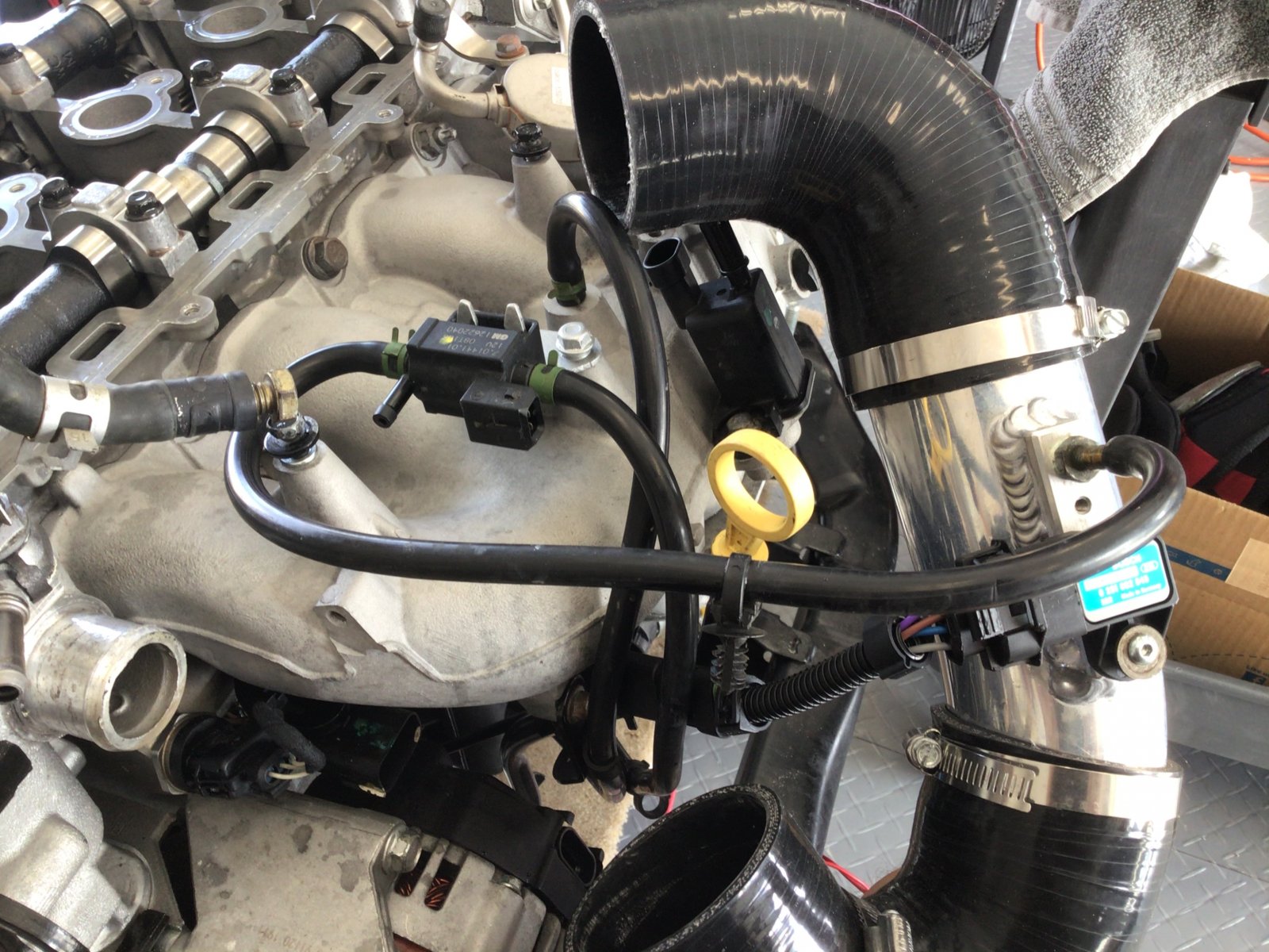

Definitely let us know! the z57 package comes with the remote tuning as well, but I haven't had time to pull the stock file (or even start the engine build) so I have no idea if I'll have that gobble noise or not (hopefully not). Out of curiosity, where do you have the bpv plumbed to?

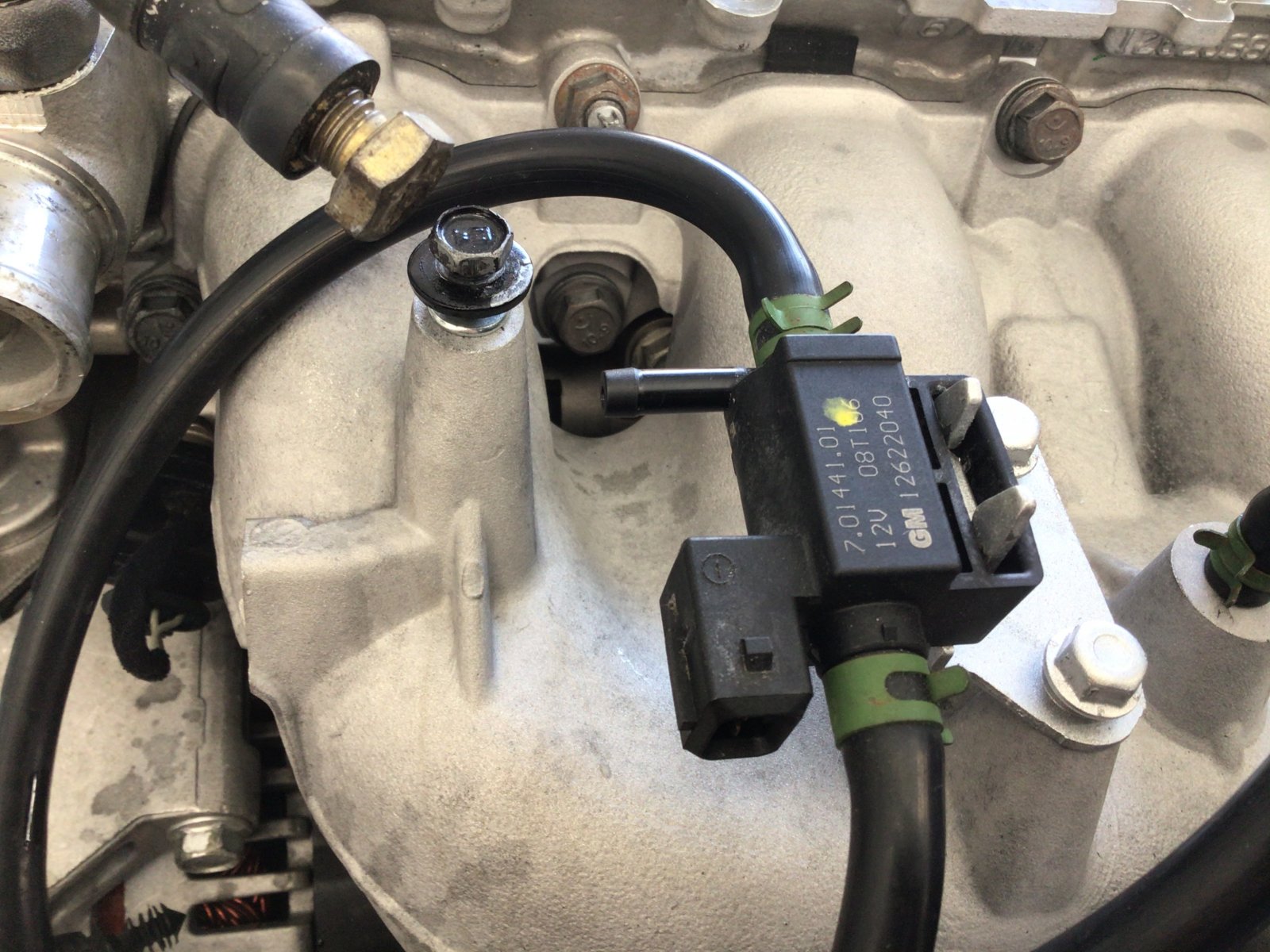

BPV is run to the intake , To the fitting that is open

I don't blame you for avoiding the blown head gasket. I wish there was a better replacement than the stock GM part. I'm going to be running head studs so hopefully it will get a good clamp around everything and hold it all in place >.< Have you tried switching the fitting that the brown bpv connects to? Moving it to that side post that's open I mean in your last picture.

See this thread for reference pic of the bypass solenoid configuration.

@Zoom Zoom That port on the solenoid is open on the zfr turbos, it's a vent.
#6
Yes that’s what ZZPERFORMANCE said also to leave it open.

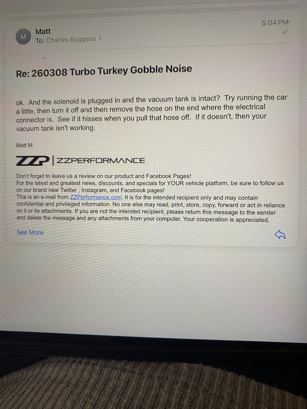

This is the answer ZZPERFORMANCE sent after I sent pictures of the way I had the lines routed , He didn’t say anything about them being wrong
Weird so they don't want that last open port on that solenoid to go to the nipple on the side of the Z54/57? The round tanish plastic piece?

According to AZMoto’s link, you have the bpv hose connected to the wrong port. Look over that picture and compare it to your setup. Might fix the gobble.
