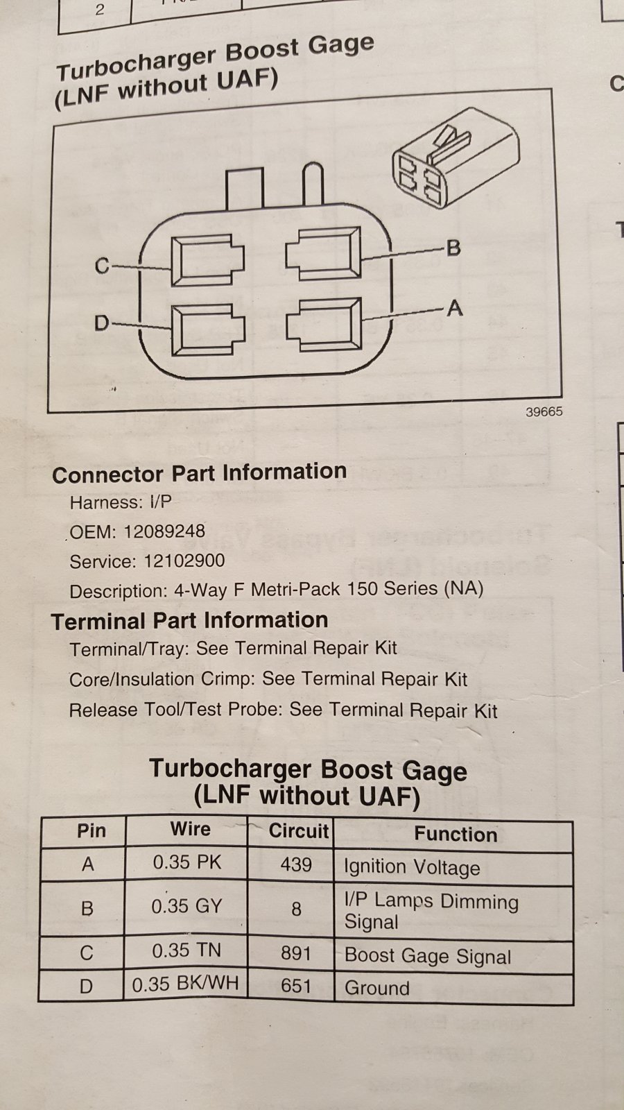

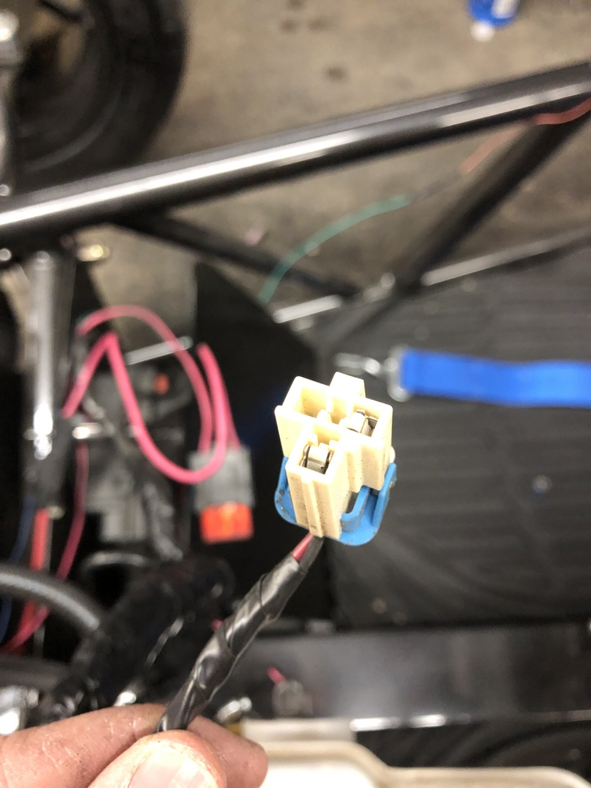

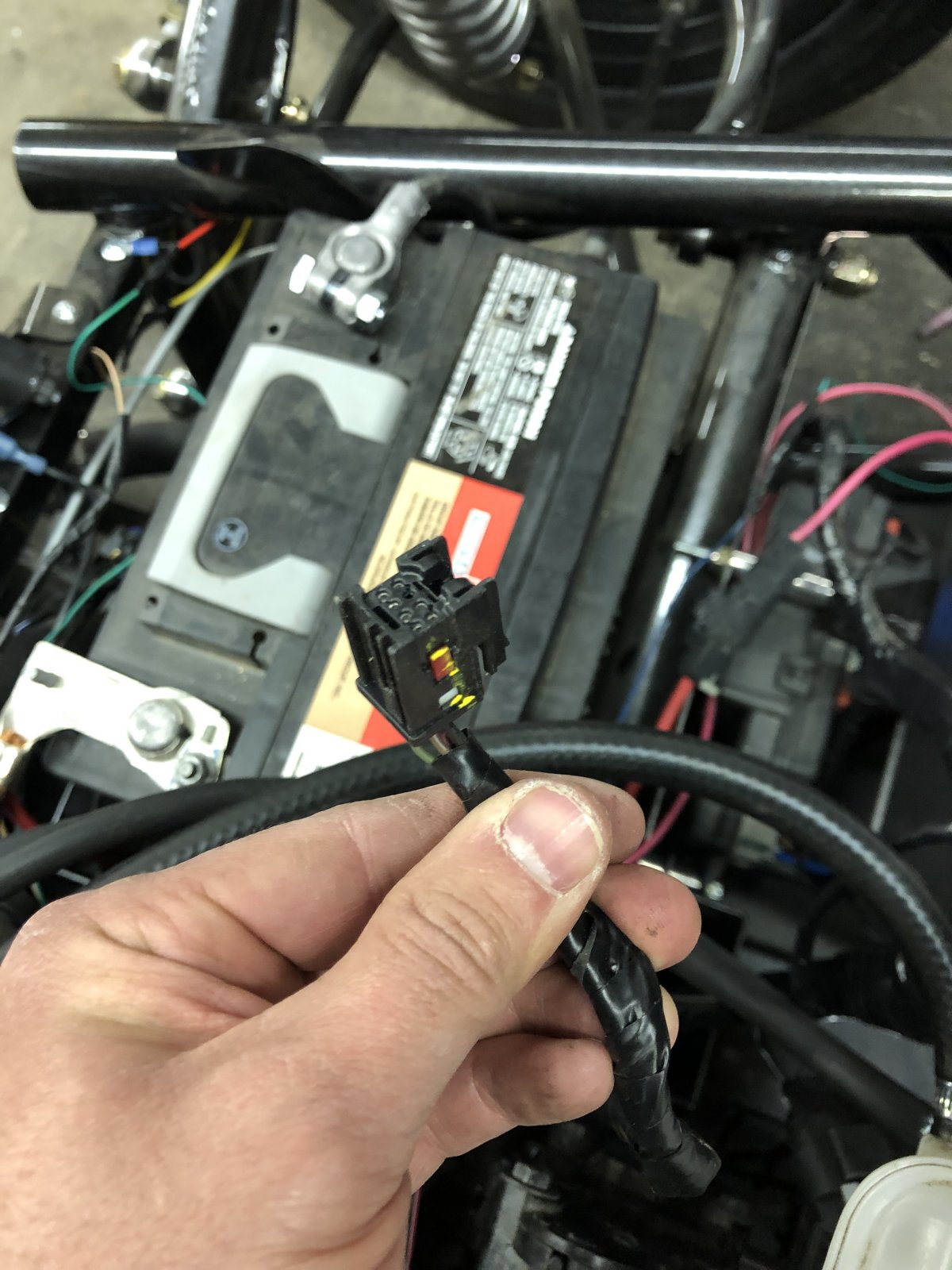

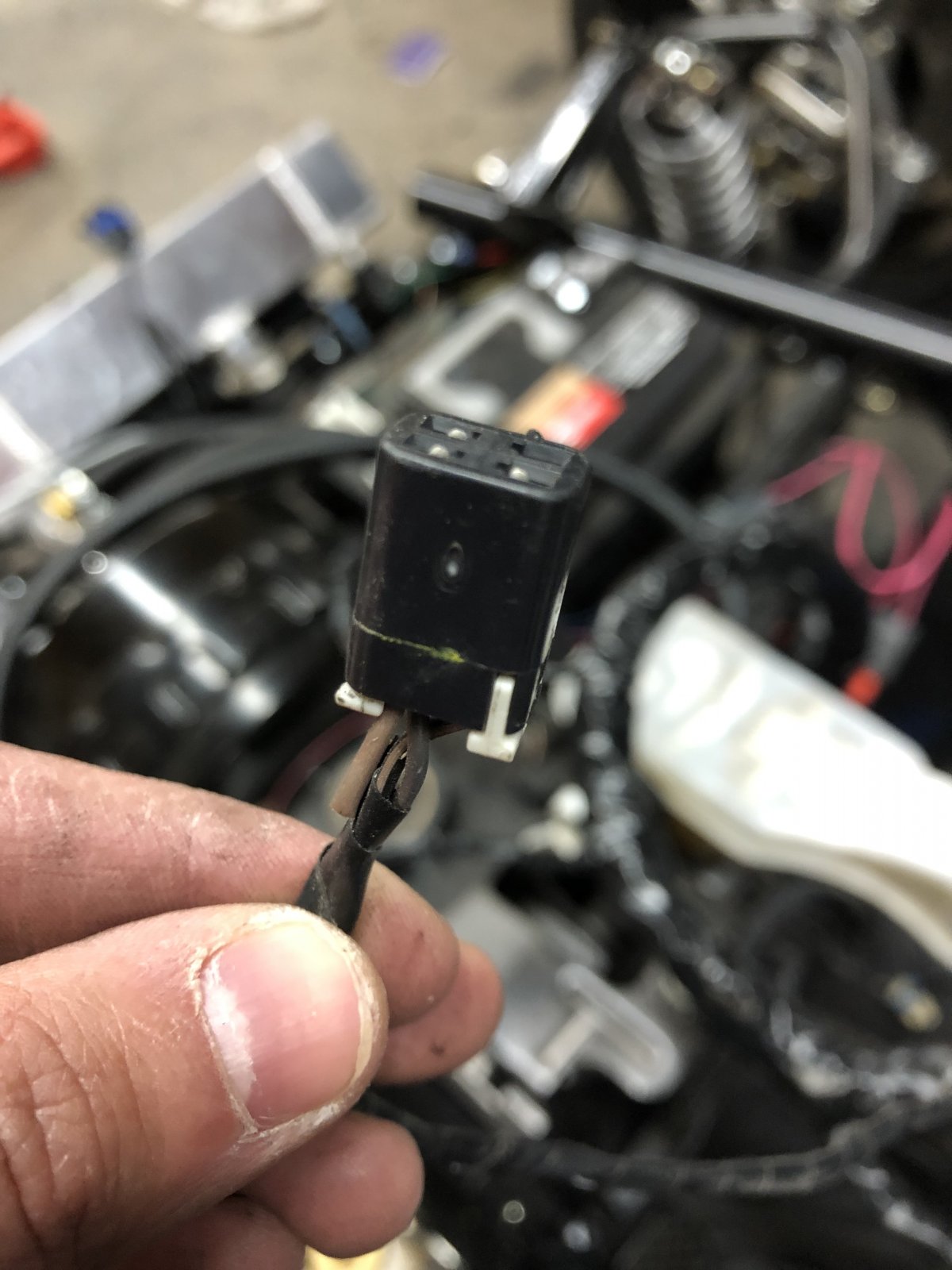

I have three connectors that I have no clue what they go to.. the car starts and seems to function properly can anyone identify them for me.? Thanks for all of the help guys

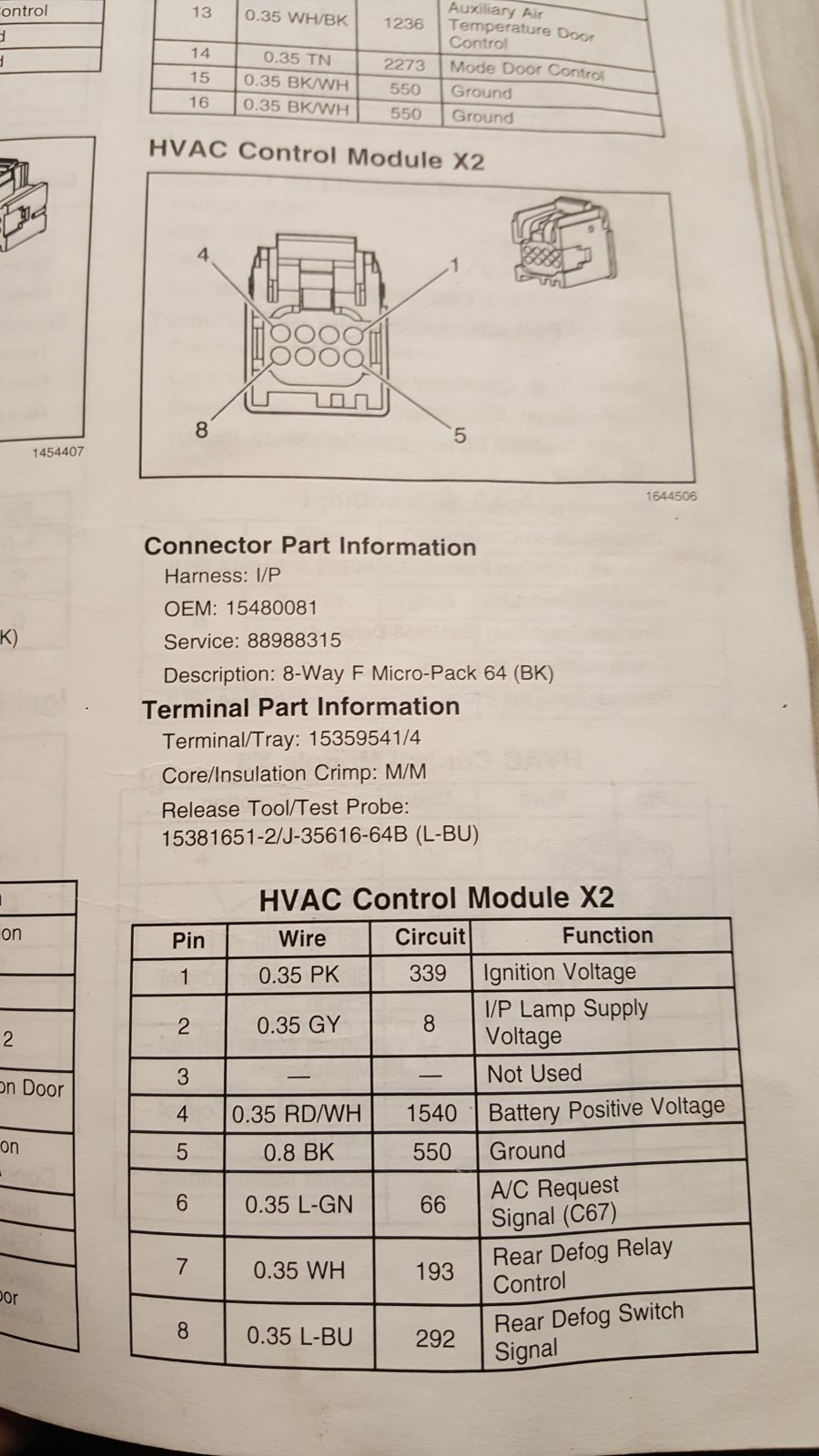

I do not recognize the first two. The first one somewhat looks like the boost gauge but it's the wrong color. The last one is not used however I kept it also for aux 12v for other options.
Christopher Sanchez
Thank you for the help, idk why I’d keep the hvac plug but that one looks the same.. I vaguely remember thinking of saving a power source for usb/charging source so I am happy I left that one. my car did not have the boost gauge so maybe that accounts for the variance in wire colors. Either way I think I am going to zip tie the two under the hood and forget about them since everything works as it sits now.. and wire a charging source. thanks again..

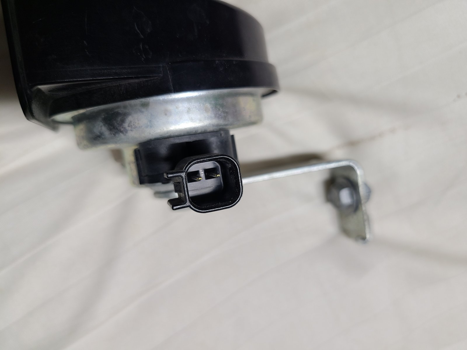

Figured I would just add to this thread since it is a similar question.
I have to assume the horn but because I bought an aftermarket one it doesn’t have a matching connector.
I also check the wiring colors.
