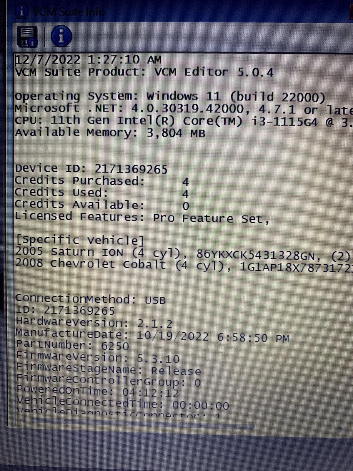

Here is a pic of the info of my new MPVI3
