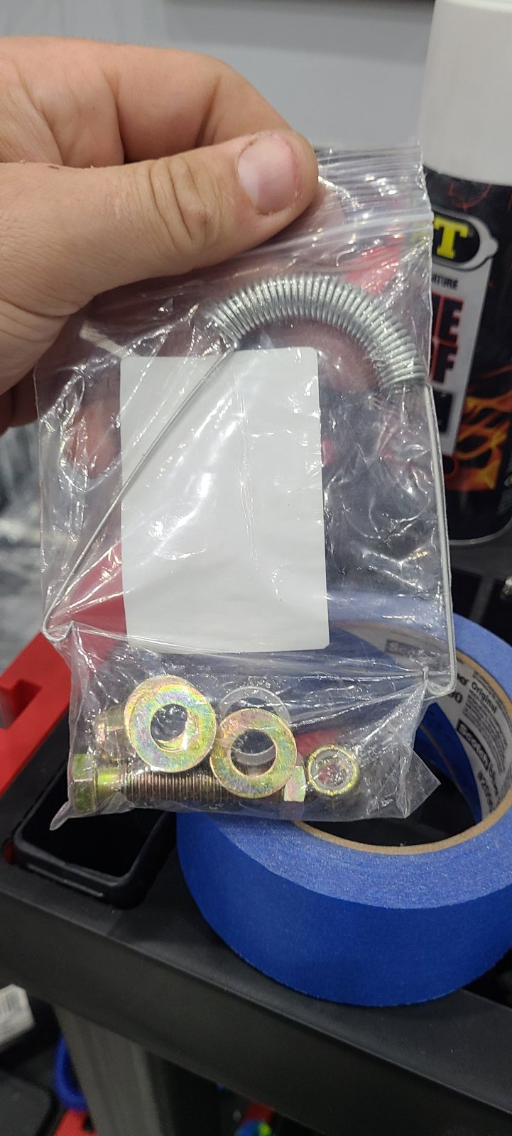

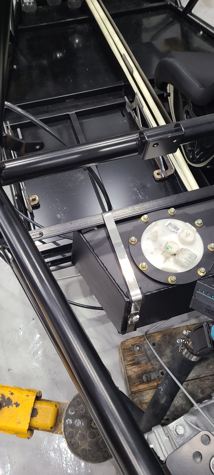

I am struggling over here to find any resources that show a relevant build process when it comes to the TC model. I have no tab for the coolant res nor do I have the bracket to bolt the reservoir to the car. All I have is a bag with a large spring and some spacers. Nuts and bolts... also the seat mount hardware... all I got was the hardware to mount the seat brackets to the floor but nothing to mount the seats to the brackets. Can anyone help.

Bag pic looks like coolant overflow hardware - this mount is new so it's not in the vids (I don't even have the mount :( )
There is an element of freestyle with some items - most of the time with bolts it's easier to go to the hardware store and figure it out than call / wait on DF
Fozda
You have all the hardware you need to bolt the coolant tank in, you just need to locate the bracket. It's a fairly large U shaped unit that the coolant tank sits on.

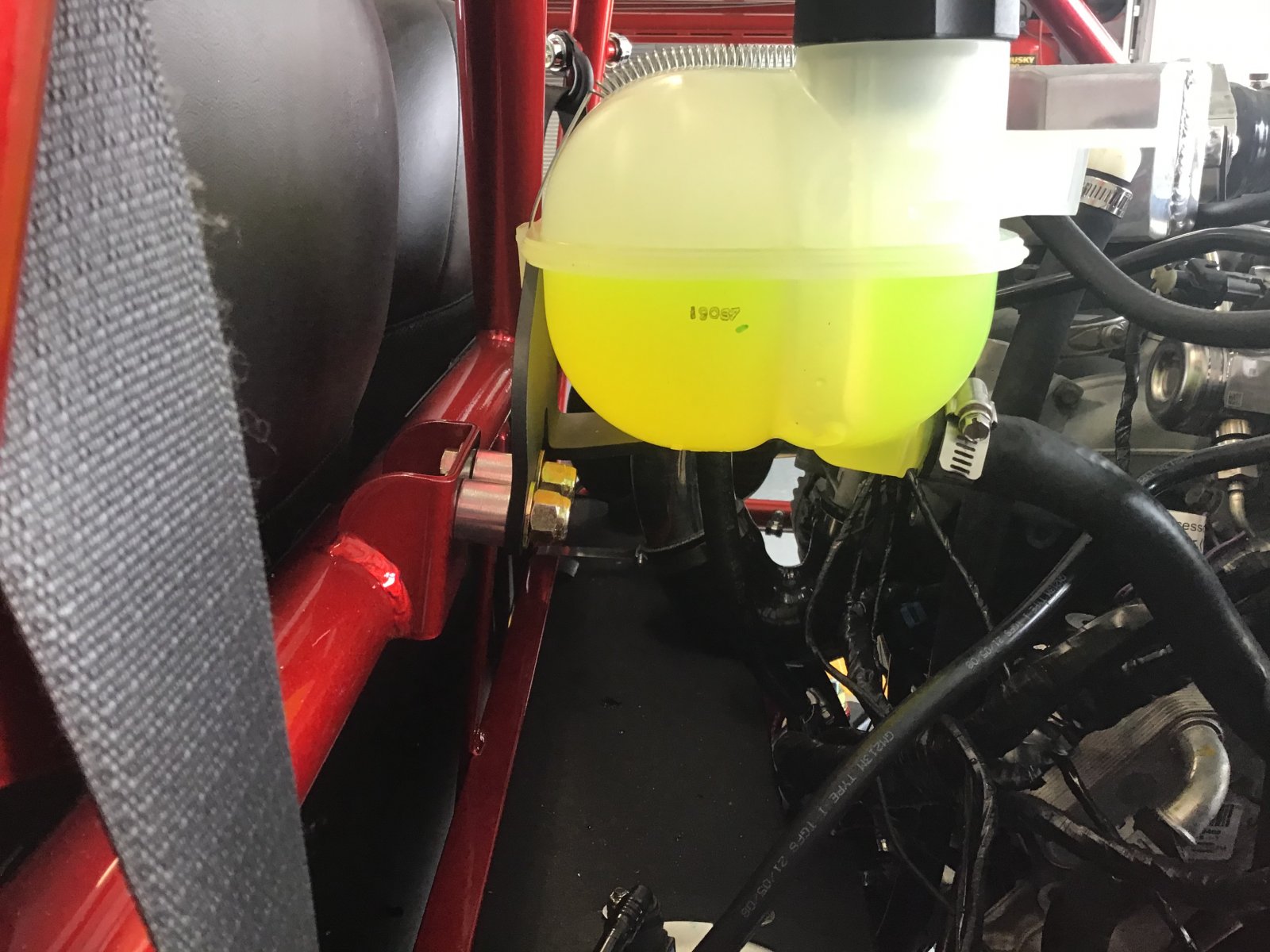

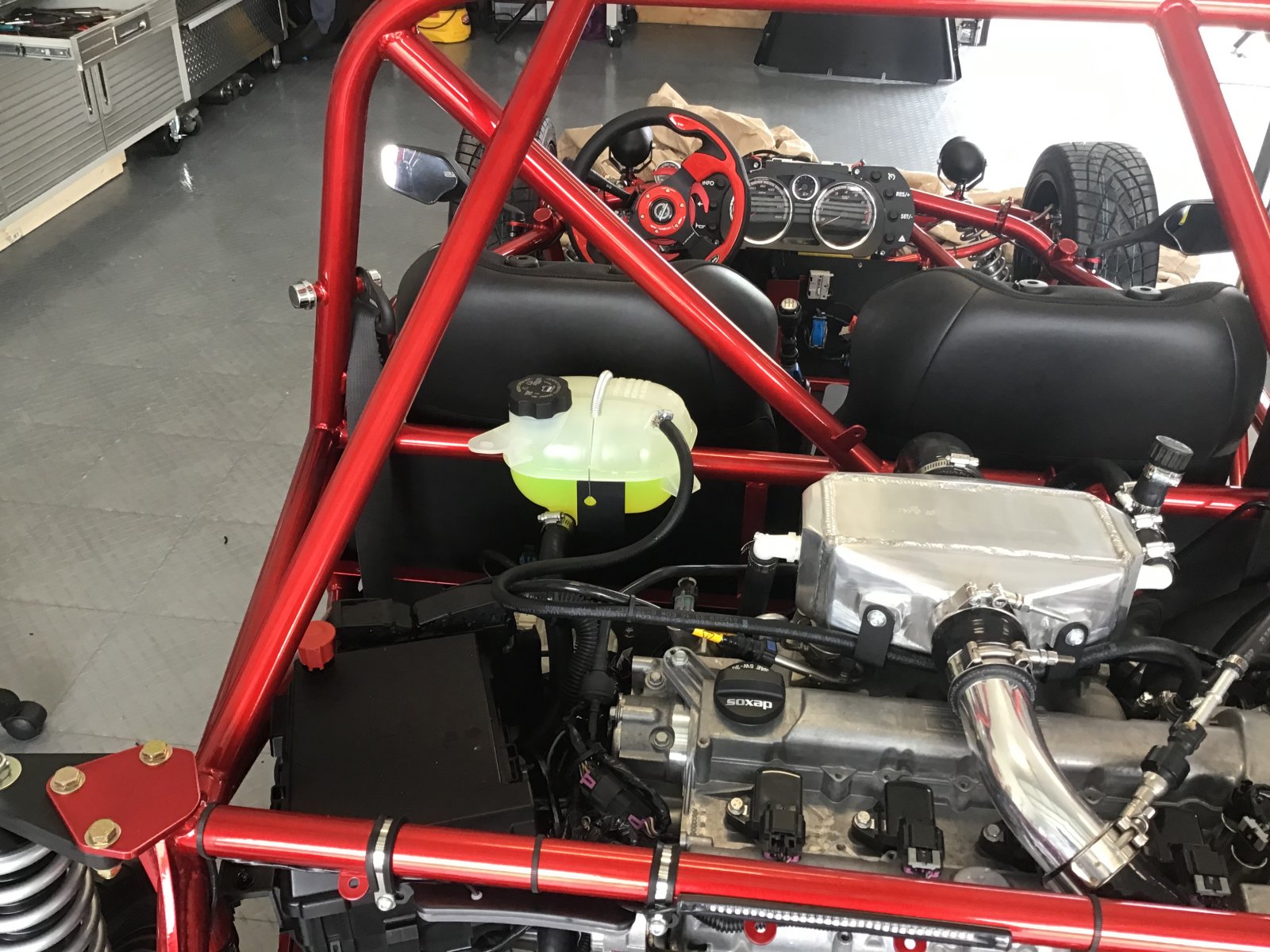

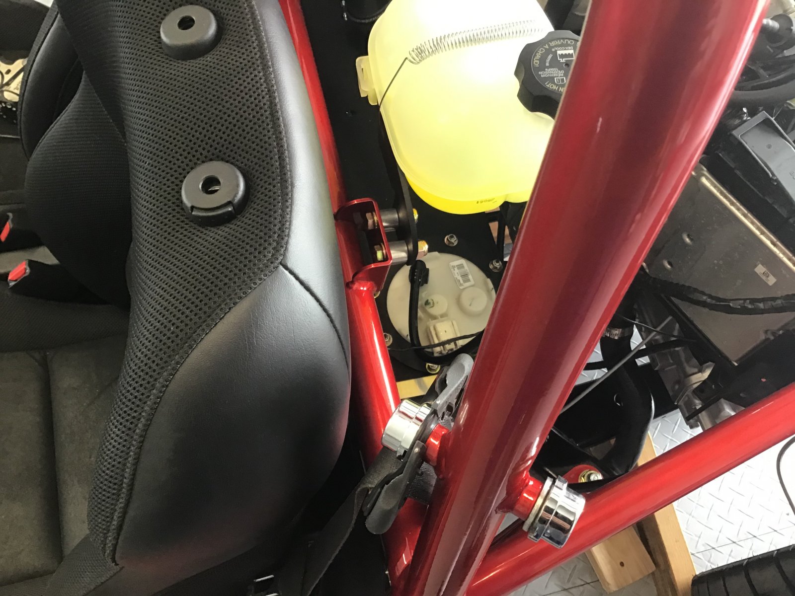

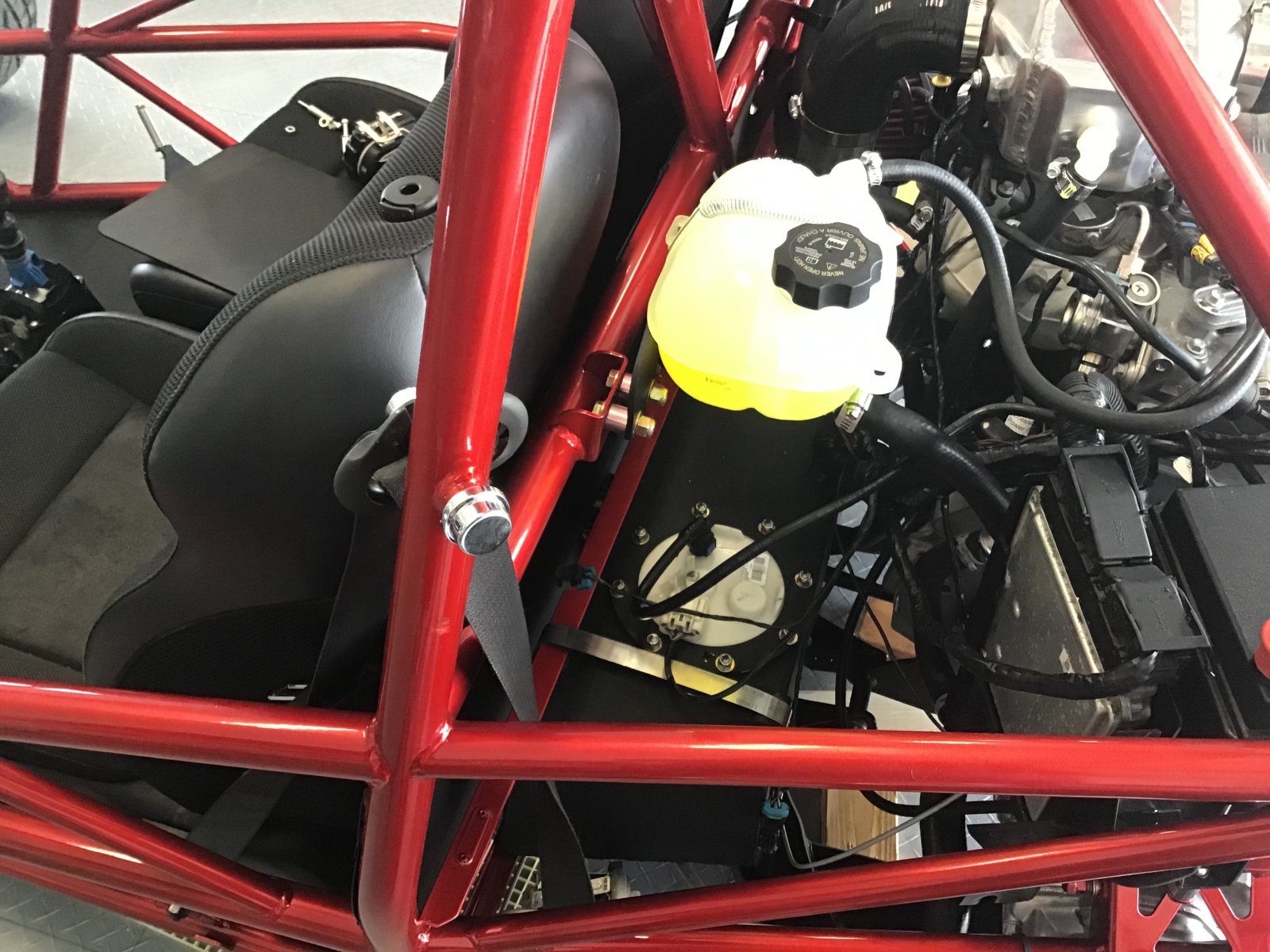

Here you go, We have the new style
Zoom Zoom
They came up with this style to help all the drivers that brake the tab on reservoir tank , now it doesn’t matter if its broke or not all the tanks will mount this way
