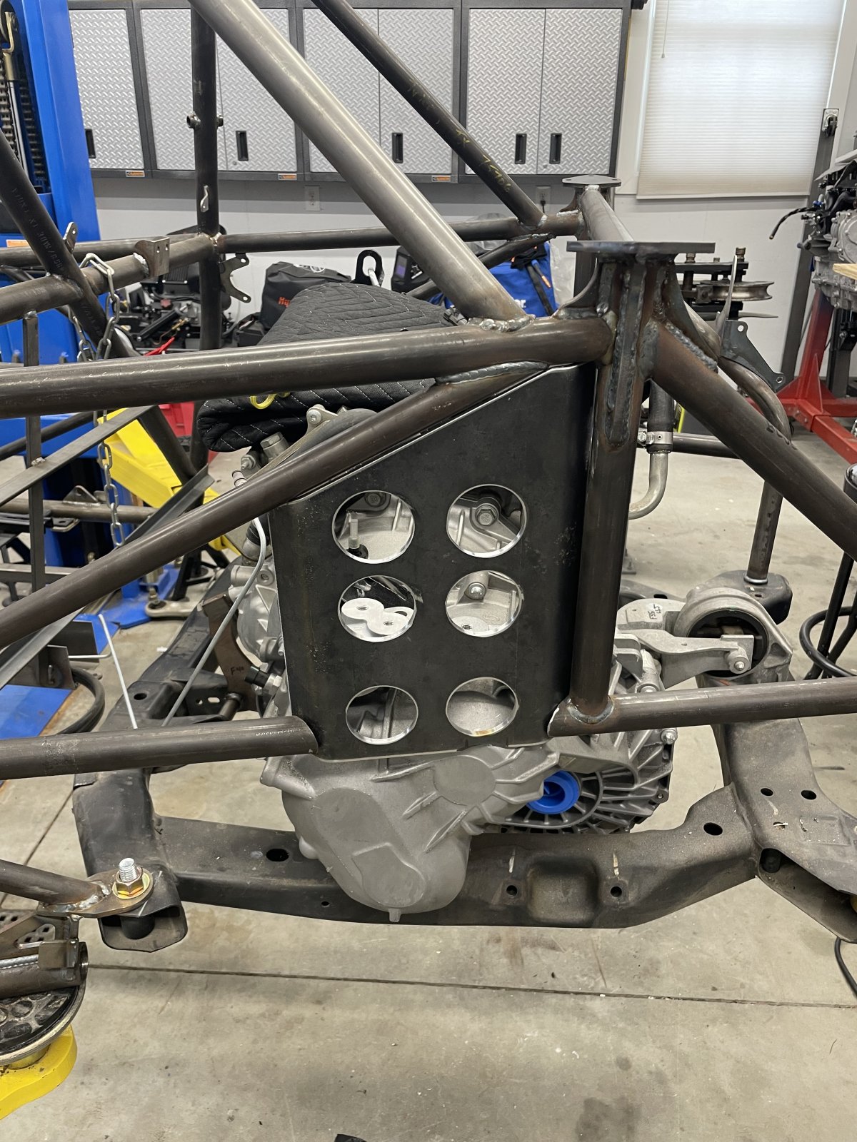

This was my idea of retrofitting an F40 in an F35 chassis. The trans mount will be welded to the back of this plate. It’s just a rough fit for mockup. Does anyone have an opinion - positive or negative I’m ok with it. Just want some opinions.
Thanks
Your design solution looks to be very sound and should have enough bracing and stiffness to keep the frame tubes located and in place under load. For the bottom of the plate, if there is not enough room on the inside facing the transmission, but a 'L' stiffener on the outside of the middle frame tube, as @Gtstorey has suggested. And make certain there is at least 1.5 inches of overlap with the middle frame tube and the 'L' stiffener when welding it all together. The bottom 2 speedholes (Yeah!) will have to be moved up a bit.
What you have may be fine. But anytime I’m dealing with an undefined load, I look for simple, lightweight stiffening as added insurance. A T would serve the same purpose. I was just trying to make it a smoother look.
RobC76
I think I’ll have at least one redesign that’s for certain. I went 1/4” thick on this one and that may be a bit overkill but I thought this is probably not the place to be under built. Elimination or changing bottom speed holes is also a possibility. I made 4 of these in case anyone wanted one lol.

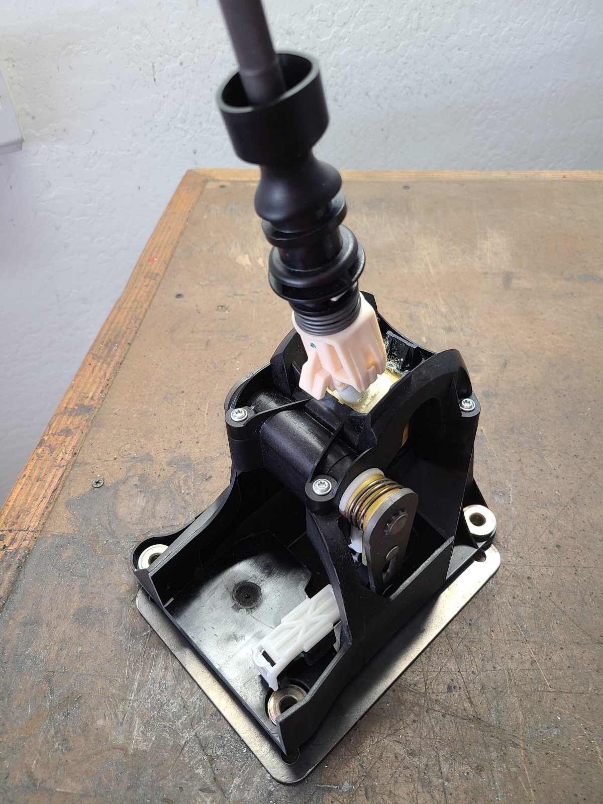

While we are the subject of 6 speed, does anyone have a shifter for the 6 speed they would recommend?
Thanks
I have a brand new Saab 6 speed shifter, it looks just like the Cobalt 5 speed shifter and installs in much the same fashion with the DF supplied hardware.

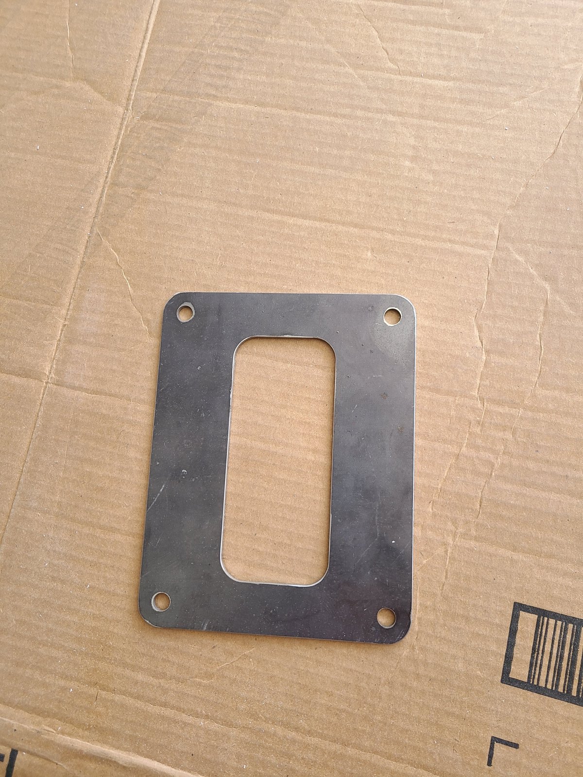

The only difference is the baseplate is slightly different and I would include a DF manufactured plate to weld in place of the existing plate on the tunnel cap.
IM me if interested.
