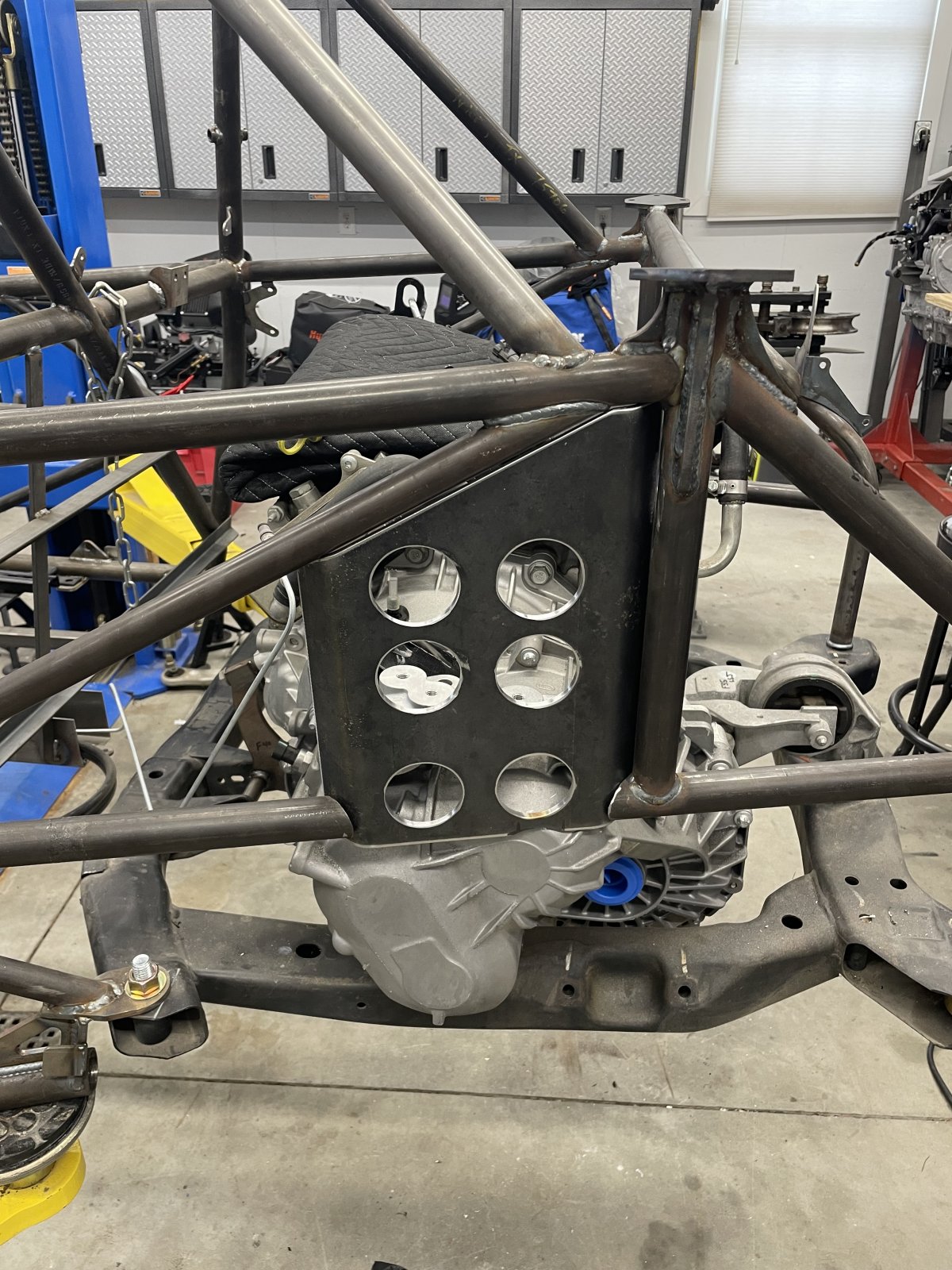

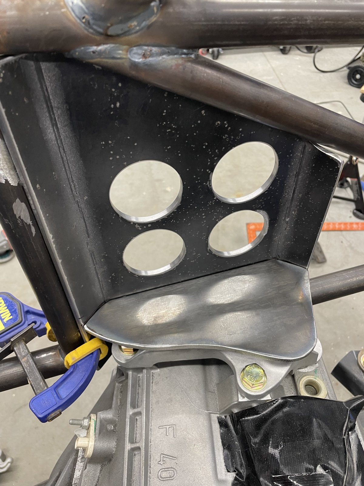

V1 What frame mods are needed for the F40 transmission?

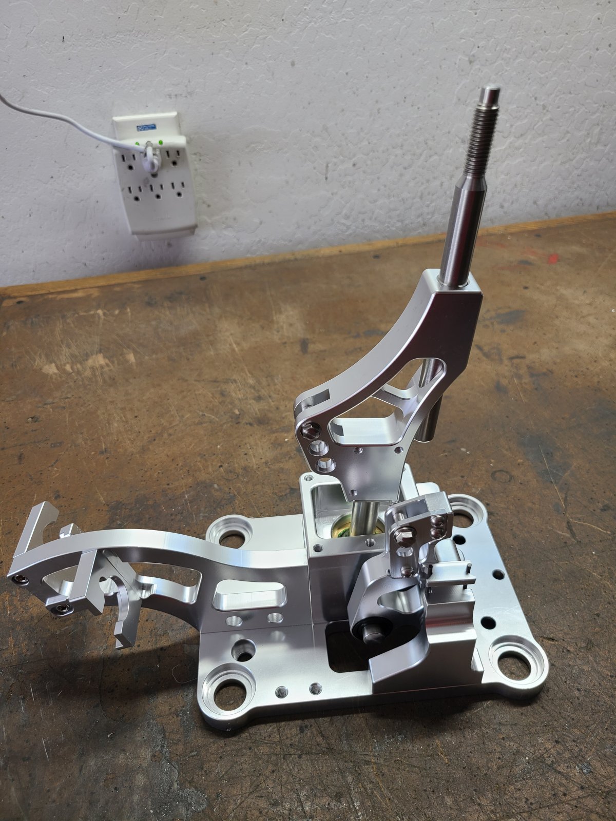

My alternative, since I hate the big plastic shifter, is a Acura RSX 6 speed aftermarket shifter. The attachment points for the shifter cables are above the pivots and it will function exactly like the new DF shifter. It also is a good looking piece of machined aluminum - bling for the interior.
The baseplate will require some tweaking as it is somewhat wider than the Cobalt or Saab shifter - nothing a little time with grinder, some filing, and metal semi-polishing can't fix. Plus the shift pattern works out, since the Honda pattern has reverse to the far right and back next to 6th gear. Flipping the shifter around 180 puts reverse to the far left and forward next to 1st gear, which matches the F40 shift pattern.
I have not installed it yet, but going through the shifter motions on paper - no inverting linkage is required - should be good for the 6 speed pattern and motions needed.
