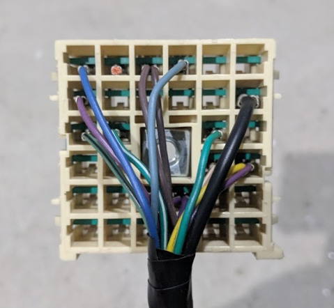

aaronbuley

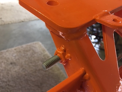

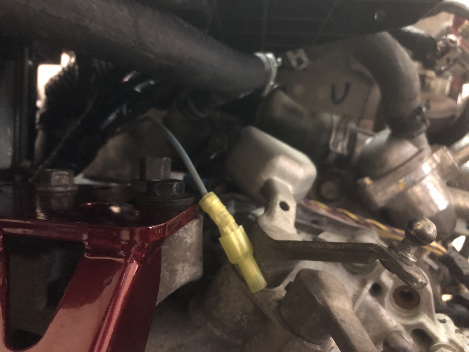

Both of these are supposed to be grounds right??
askiles
Correct. There are zero open wires through the tunnel. DF did the harness so I assumed it’s right.
That doesn’t sounds correct. They usually have the ground lugs to bolt down in the tunnel. You may want to check that. The grounded wires are all at the brake pedal mount, the tunnel, and then in the rear at the ground lug on the driver’s side transmission mount. I’m glad I did my own wiring so I knew where they all were. Give Lonny a call and see, maybe they extended the ground lugs out of the tunnel.

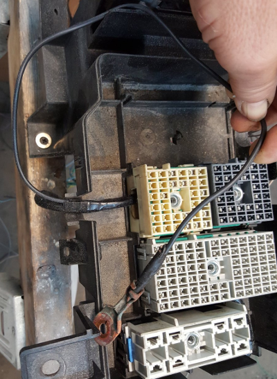

Yessir! The headlight ground wire wasn’t making good contact. Corrected that and BOOM!
My trouble now is that the engine dies after about 2 seconds. But at least it cranks!!!

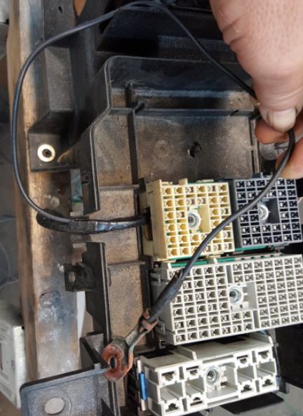

I believe the reason it's working with the ground on the headlight harness is because that ground provides the ground for relays in the fusebox as well as the headlights, that's all. I don't believe everything else is grounding back through it, at least it shouldn't. I totally understand what you are saying and it would be a huge concern, but I believe it's only providing a ground to the relays which he didn't have before and the relays weren't working.

It's not the "headlights" that are doing it, it is a ground wire on the headlight harness that grounds the relays and what not in the fuse box. Hence why if it is not grounded, the whole fuse box is unable to function properly. This applies to Goblins and Cobalts.
