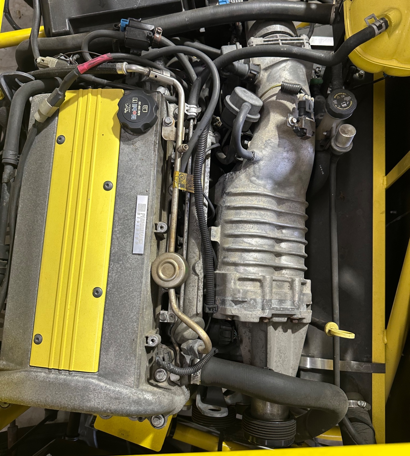

Not sure if I’m expecting more out of an engine that can’t give more but I’m gonna say my goblin is slow from the videos I’ve seen. I have a supercharged goblin with the f23 transmission. It has smaller pulley and some other things but it struggles to hit 85-90. Not sure if something is holding it back or what. Anybody have any suggestions on what could be going on?
What is your boost getting to? When my boost solenoid was messed up, I have 5psi or something and no power. I cruise on the freeway at 80-90, there’s plenty of pedal let for faster.
I’ll have to check. I don’t have a gauge or anything hooked up to tell. Is the boost solenoid the black thing with 2 hoses going into it? Also I did get rid of the supercharger bypass solenoid if that’s of any concern?
Yes that should be it. There is a way to bypass it, I just don’t remember how or if that mod works. Hooking up the gauge helps a lot. If mine ever feels low on power, that’s the first thing I look at.
Update. I tried the bypass mod for the supercharger and now she screams well over triple digits. Car is a lot more fun to drive now. Crazy fast down low. Butttt…. It blew the dipstick up and oil sprayed everywhere. Also I don’t want to leave the bypass mod so I put a new bypass solenoid on and it still doesn’t want to build boost with everything hooked up right. Does that mean the diaphragm is bad? Any suggestions on how to fix both these problems? Btw I had the little piece of foam on bypass solenoid so only one port had a hose on the one side.
The dipstick problem could be from a restricted exhaust, very excessive blow by or boost when you shouldn’t have it (bypass mod).
Could be you need to clear the trouble codes, the diaphragm is leaking, hoses leaking or vacuum hose may not be connected at the intake.

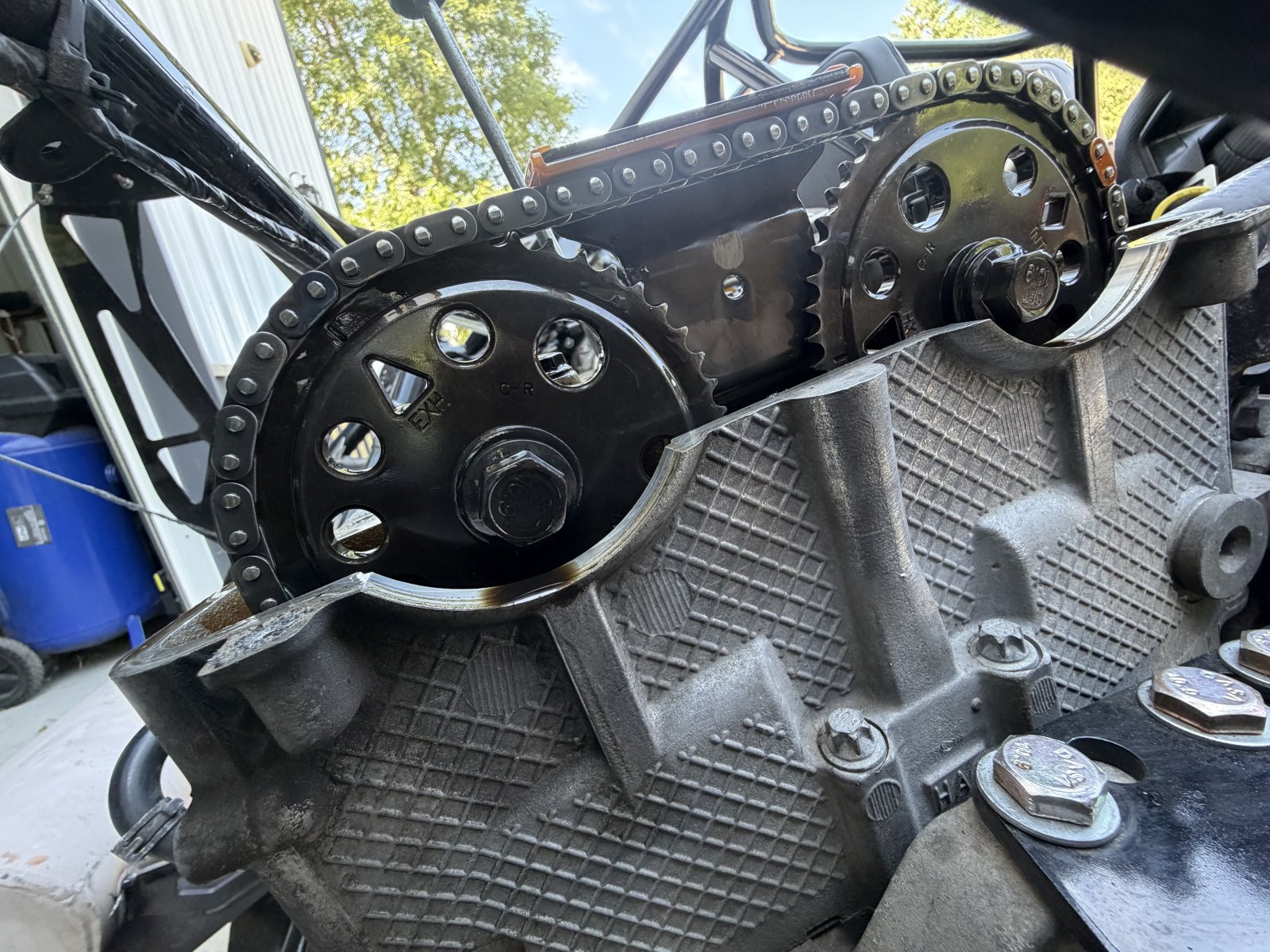

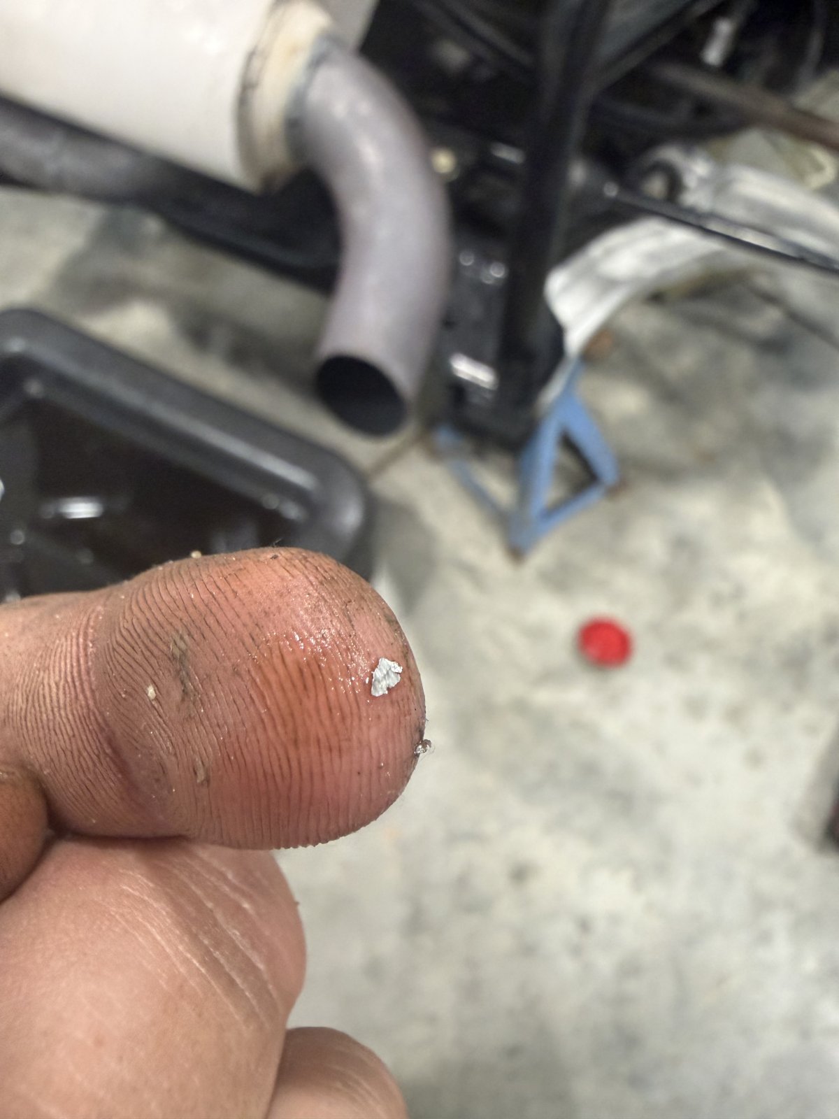

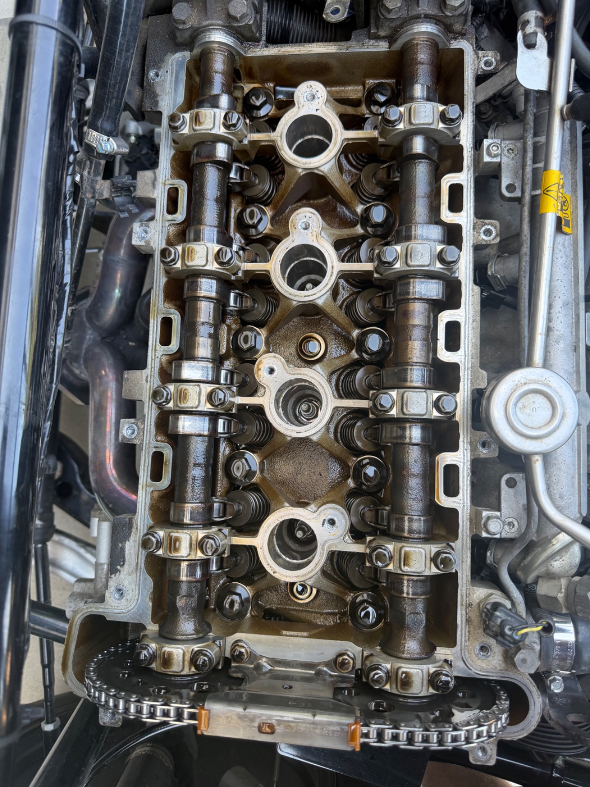

Have recently been trying to track down a sound in my engine. Sounds exactly like this video and he’s got more of the noise videos. I have some chunks of metal in my oil pan. The noise is worse around 2000 RPM. Sounds like a bad chain rattle. I’ve taken the valve cover off many times to inspect and also taken the side panel off. All the chains are tight and timed correctly, and none of the guides are broken from what I can see. I also have replaced the tensioner. Any suggestions on what to do next. Compression is 175 in each cylinder.
This could be any number of other anomalies not yet looked at from your description - cam/followers, the VVT actuators that could be putting metal particles into the oil. Do you have any engine codes? Any trouble starting or idling? No missing or rough running?
Listening to the video, it sounds like compression is blowing out of a spark plug - but that's just because I've had this before, but it wouldn't put metal into the oil. it's hard to say from another person's video what is the root cause of a same/similar sound.

No engine codes, idles perfect and runs perfect just has that bad rattle. Cams look alright and lifters look great.

That does sound timing chain related, since the noise changes with RPM. It does sound like chain slap/rattle, but you said you have replaced the obvious parts. What about the cam gears, are they worn or loose? The VVT actuators are at that end of the cams. These do wear out, could be one or both are cycling at the 2000 RPM trying to activate?

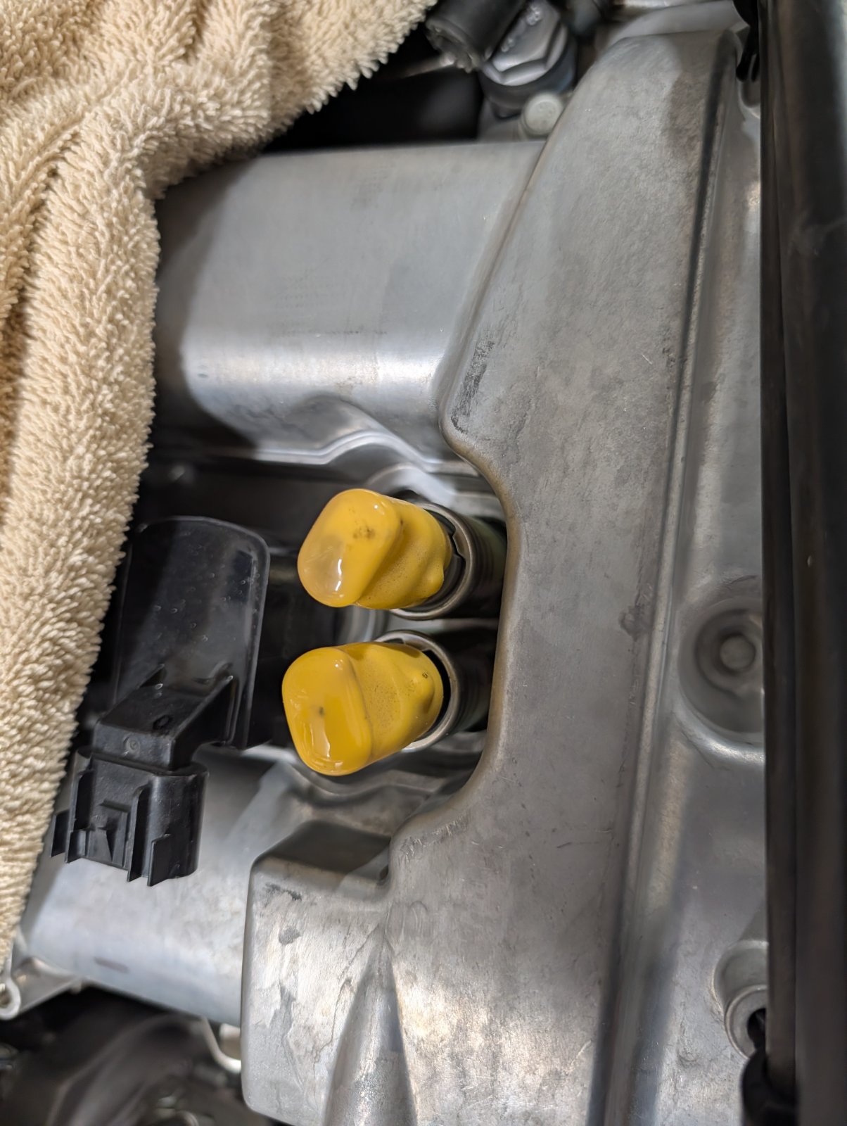

Edit: Or not for the VVT. I don't see these in the valve cover - scratch that idea.
I saw you had a small pulley on the sc. is the belt slapping? I had that when I used a very small pulley on mine. The noise was a little lower in tone though.
Use a screwdriver against (in) your ear to listen for chain rattle.
