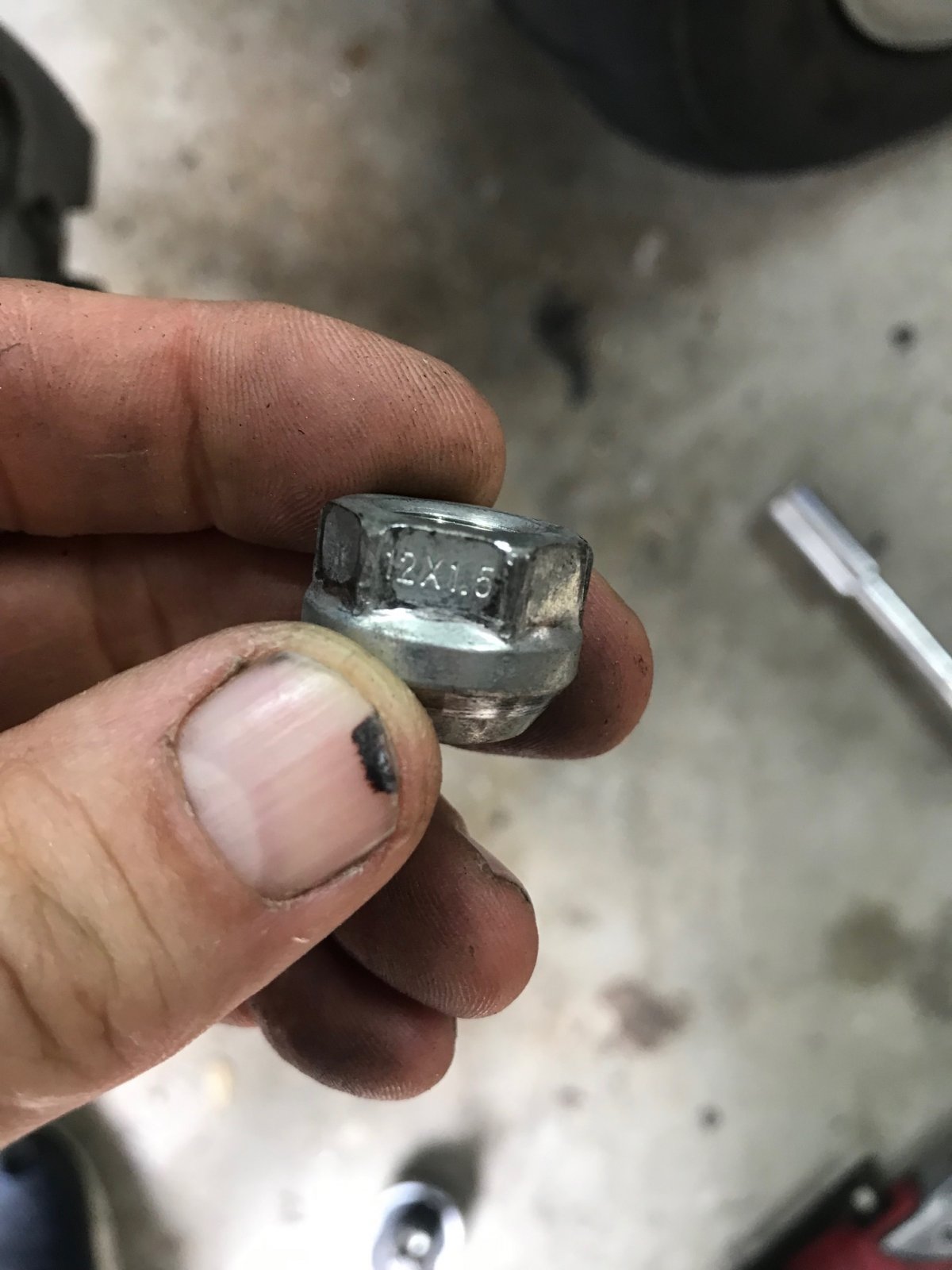

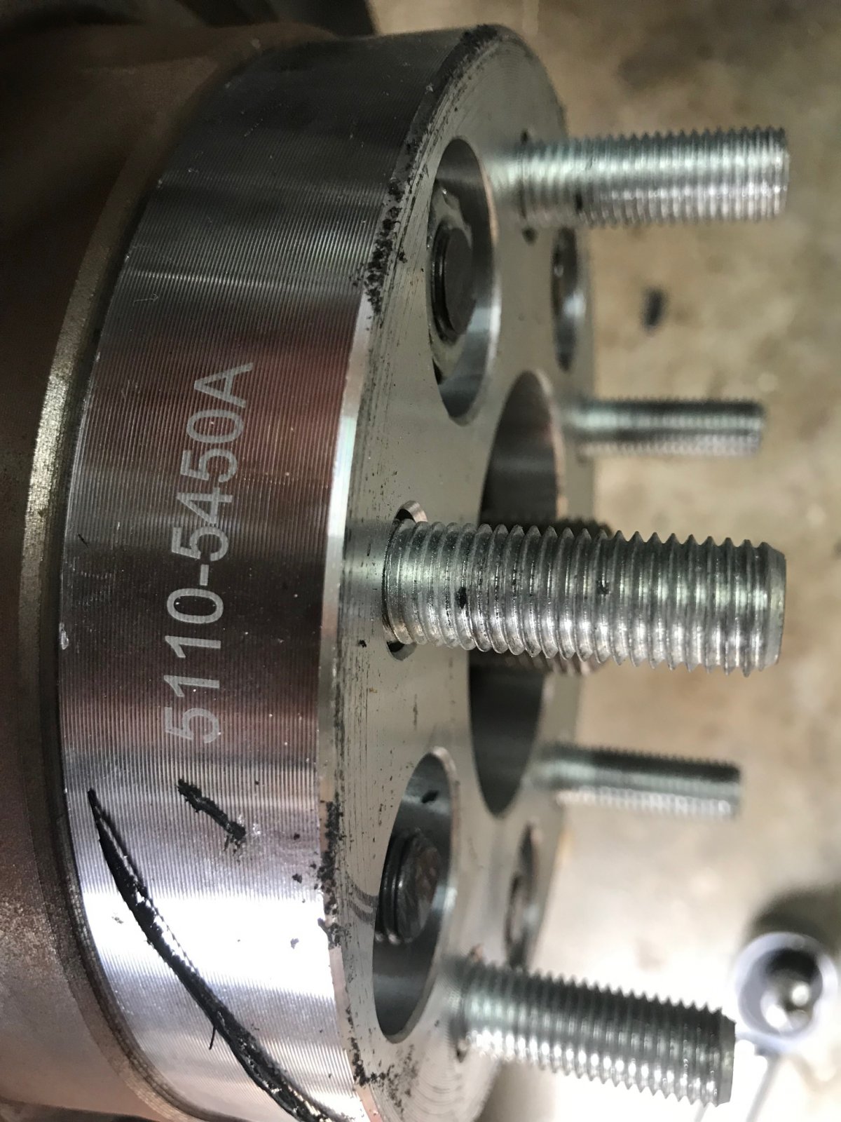

@JBINTX all 4 corners right? Also can you say more about stud size/thread pitch for the studs, and the thread pitch of the lug nuts you used?
Yes, all four corners have spacers and same size tires and wheels.
You will need to trim of the studs a little so they do not protrude beyond the spacer. A grinder and a cutoff wheel makes quick work of it. Be careful to not damage the threads. Not ideal, but neither are spacers.......
Pictures show the part numbers and threads. I am not sure all Cobalts are the same stud sizes. Mine is 2009 tc for those who read this later.
ccgillett
View attachment 27565View attachment 27566View attachment 27567
Thank you VERY much, this is awesome. Really appreciate it.
Don't believe a hardened nut will gain much as a thread chaser, but it may last a few more studs than a standard nut. Personally, I would have a set of nuts for one corner (4 or 5), put them all on the studs before trimming. That set should last through all 4 corners before getting too galled up, standard or hardened.

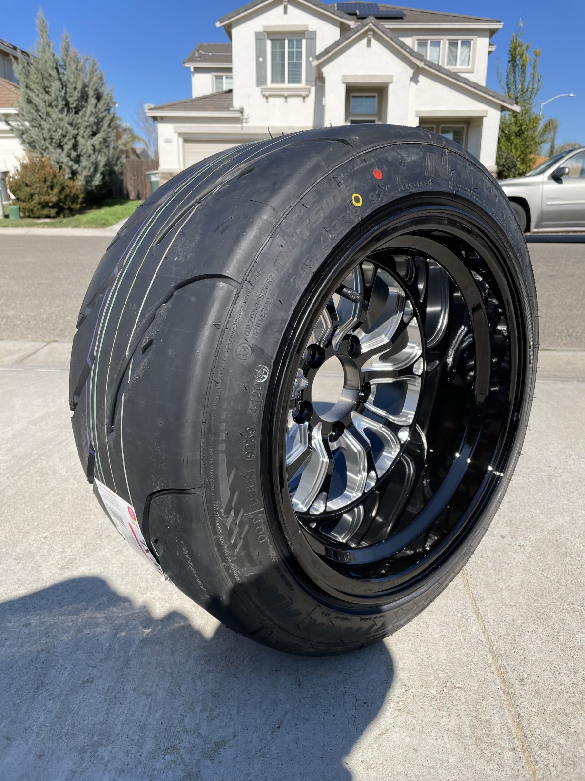

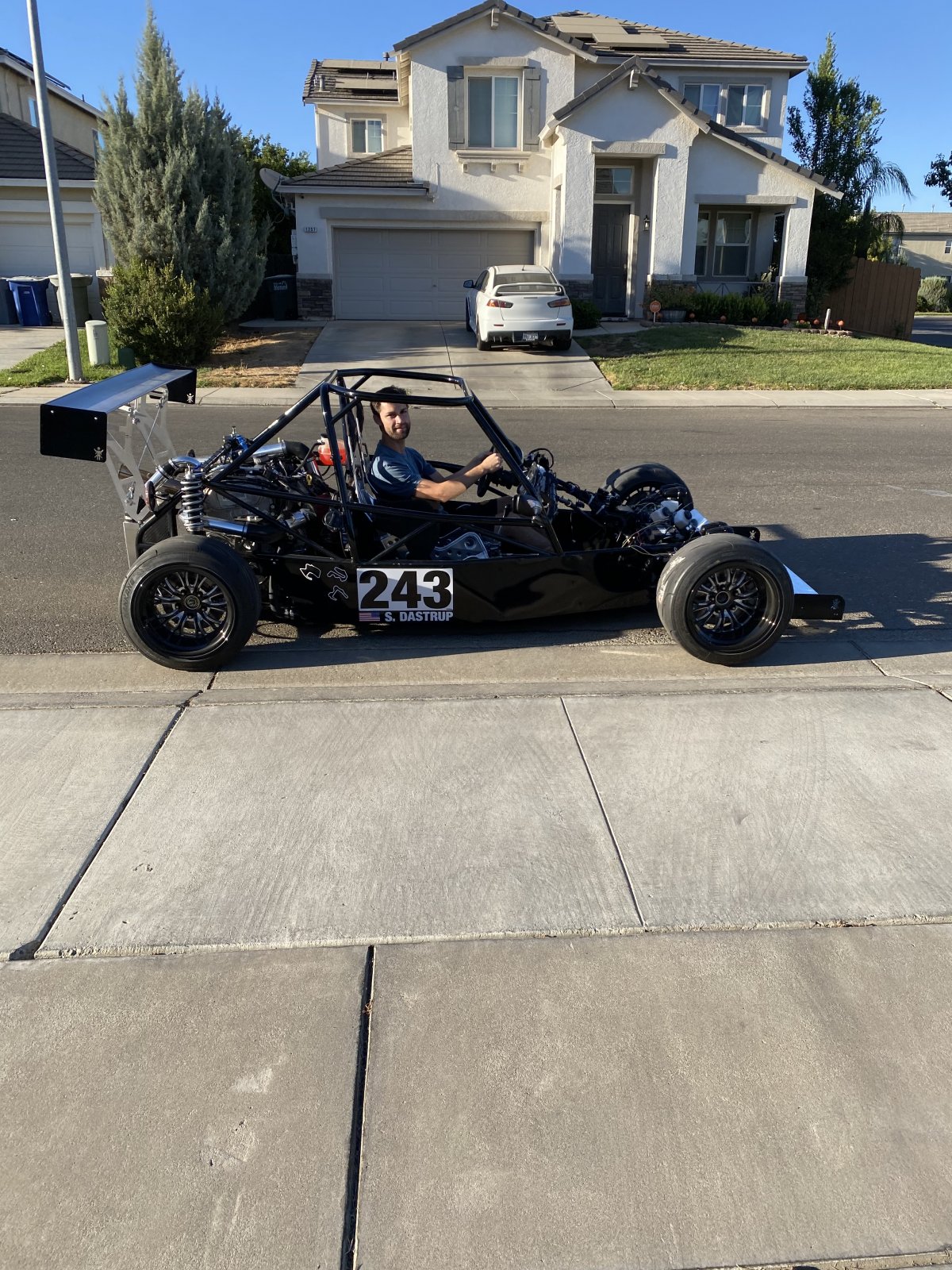

This is the similar to Justin reeds current setup however they now make it in a 275 width which I wish I had. He is now running that. A little too much stretch on my setup. Next set for sure. Also mine is a 4.5 in backspace and I think I would switch to 5.5 in backspace for the front. Can’t speak to how they are in the wet. Probably not great. So many options out there and they probably all work great. Hard to decide.

Hey @JBINTX , when you are installing the wheel hubs referenced here, did you use stock wheel studs or a different size? I ordered this exact part from US Wheel Adapters (nice guys btw). When I went put them on they seem to "almost" fit. I compared the part number that I received to the one you posted in a picture, so I'm wondering what I'm doing wrong or if there's a wheel size difference.
Almost fit? You have a pic?
I did have to cut the studs shorter (see above) so that they did not extend beyond the mounting face. They are stud located so the conical nuts need to center it properly.
ccgillett
@JBINTX grumble grumble I figured it out, sigh. I bought 5x110 which is based on the stock hubs that you have on your car. They clearly don't fit mine so I took a few measurements and dug into the documents that came with my car - I bought this one as a work in progress. In the specs for the donor it's mentioned "5x114.3 hubs". So weirdly I need a custom 1" thick spacer that is 5x114.3 to 5x4.5". I say "weirdly" because 114.3mm is....4.5" .
