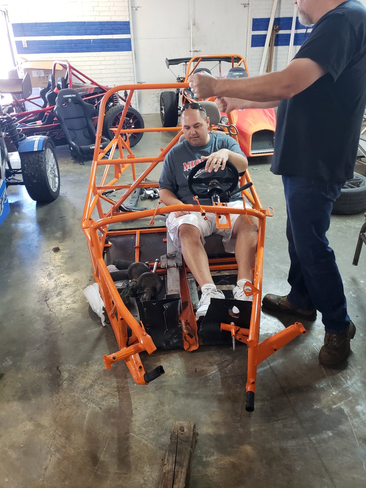

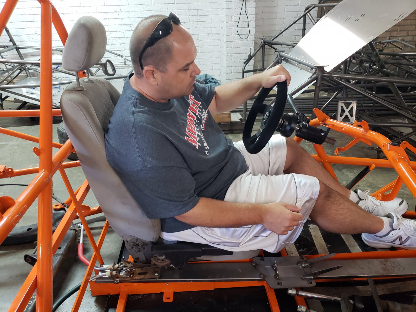

I am 6'3" 300lbs. This is me test fitting myself in ctuinstra's old frame. It is an extended city frame with lower entry bars, and we used a stock cobalt seat. I did not fit in the recommended seats. I sat more on top of the hip bolstering instead of down in the seat. My donor is an SS, so the seats I'm using are pretty comfortable and have good bolstering. The only other option I could see was using kirkey aluminum race seats. They are really thin on the side walls and come in a variety of widths for us wider assed individuals. I just don't know if they will fit in the car. I will have to get a better measurement when I get my frame.

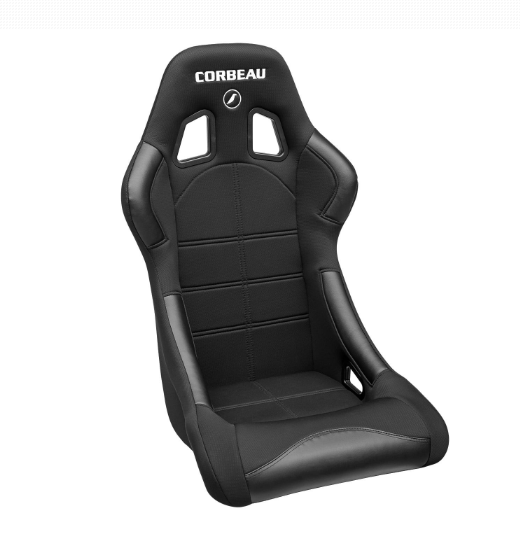

I meant to put a link to them. You will have to use the drop down on the style to see the wide version. Actually they were almost a bit too wide for me. They did fit in the car but we used a custom seat bracket with sliders.
This photo is not of the wide version, looks the same, just a bit wider.
