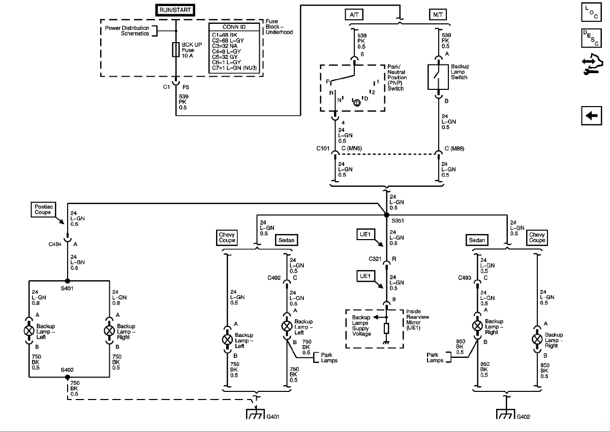

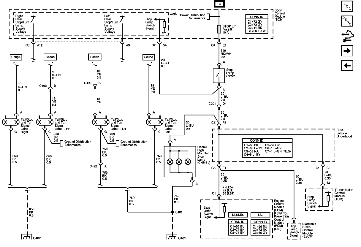

In Organizing the Harness Part 1 @ 7:10, it says to separate the blue and green wires and lay them over the fuse box. Is blue = center brake light and green = reverse light?
