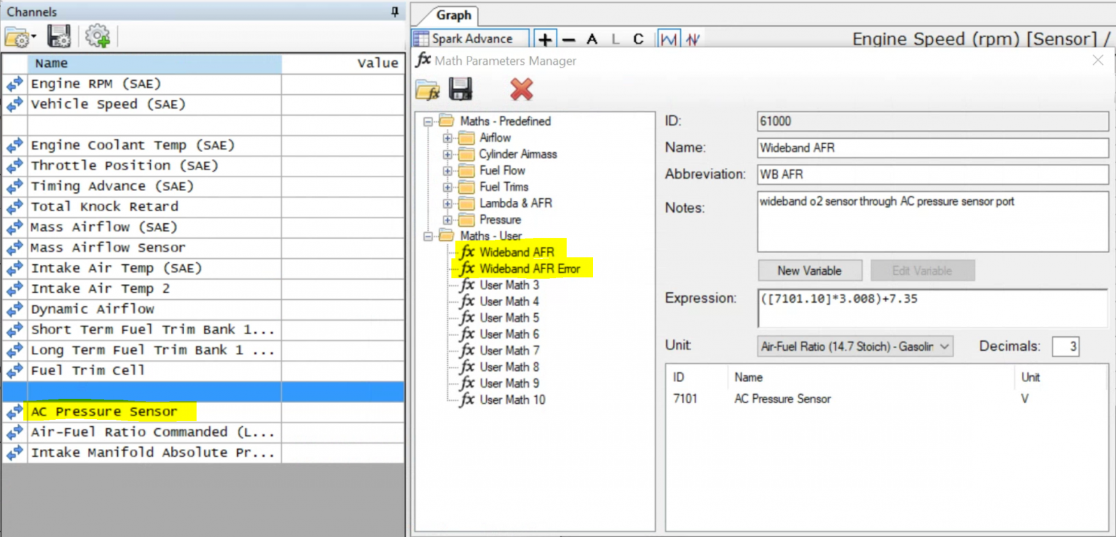

  2. Purchase an HP Tuners Pro interface module with 0-5v inputs on the side. Wire your 0-5v output from the gauge/controller into the interface module. The HP Tuners channel will simply be the MPVI or MPVI2 Pro input.

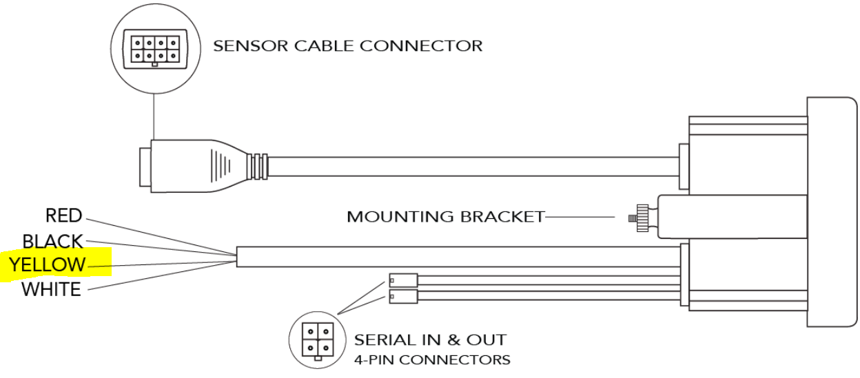

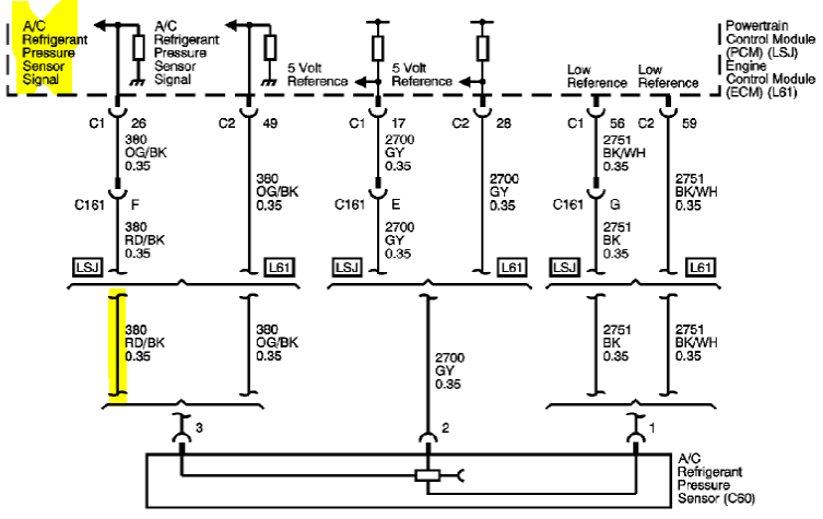

  3. My favorite option, wire the 0-5v output into the AC pressure sensor signal wire. On my setup, the yellow wire coming off the gauge is the 0-5v analog output. When thinning the engine harness, I removed everything for the AC compressor clutch relay, and the 5 volt and low reference for the AC refrigerant pressure sensor. I kept the red/black wire on the engine side of the engine harness and connected the two together. If you don't have an '06 LSJ (like a loser) then your wire color may vary. Then, I take my butt over to HP Tuners, add the AC Pressure Sensor channel and Commanded AFR to my logs, set up Math Parameters for Wideband AFR and AFR error (and gripe about LSJ's in HP Tuners wanting to do AFR in gasoline numbers instead of Lambda).

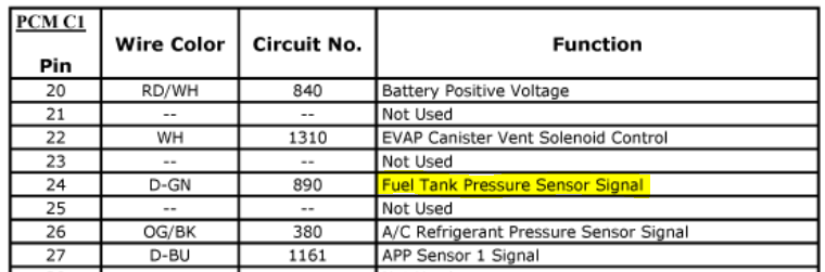

  4. (really 3.1) new edit: LSJ's without EVAP can also use the fuel tank pressure signal wire, which is pin 24 on the C1 connector, a dark green wire. Again, if you don't have an '06 LSJ (like a loser), then your wire color may vary. See Post #13 in this thread for a little more information. Unsure if this works with any other motor, folks are welcome to chime in.

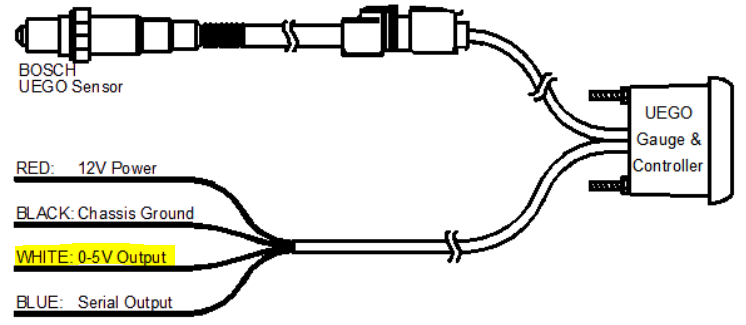

    1. Innovate MTX-L wiring
      31606
    2. Aem UEGO 30-4110 wiring
      41871
      31607
      31608

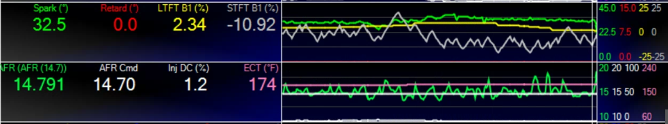

To add to 3.4., all you have to do in HPTuners is repoll parameters and add the wideband. See here:
Just did it for my 2.2 LAP and it couldn't have been easier.

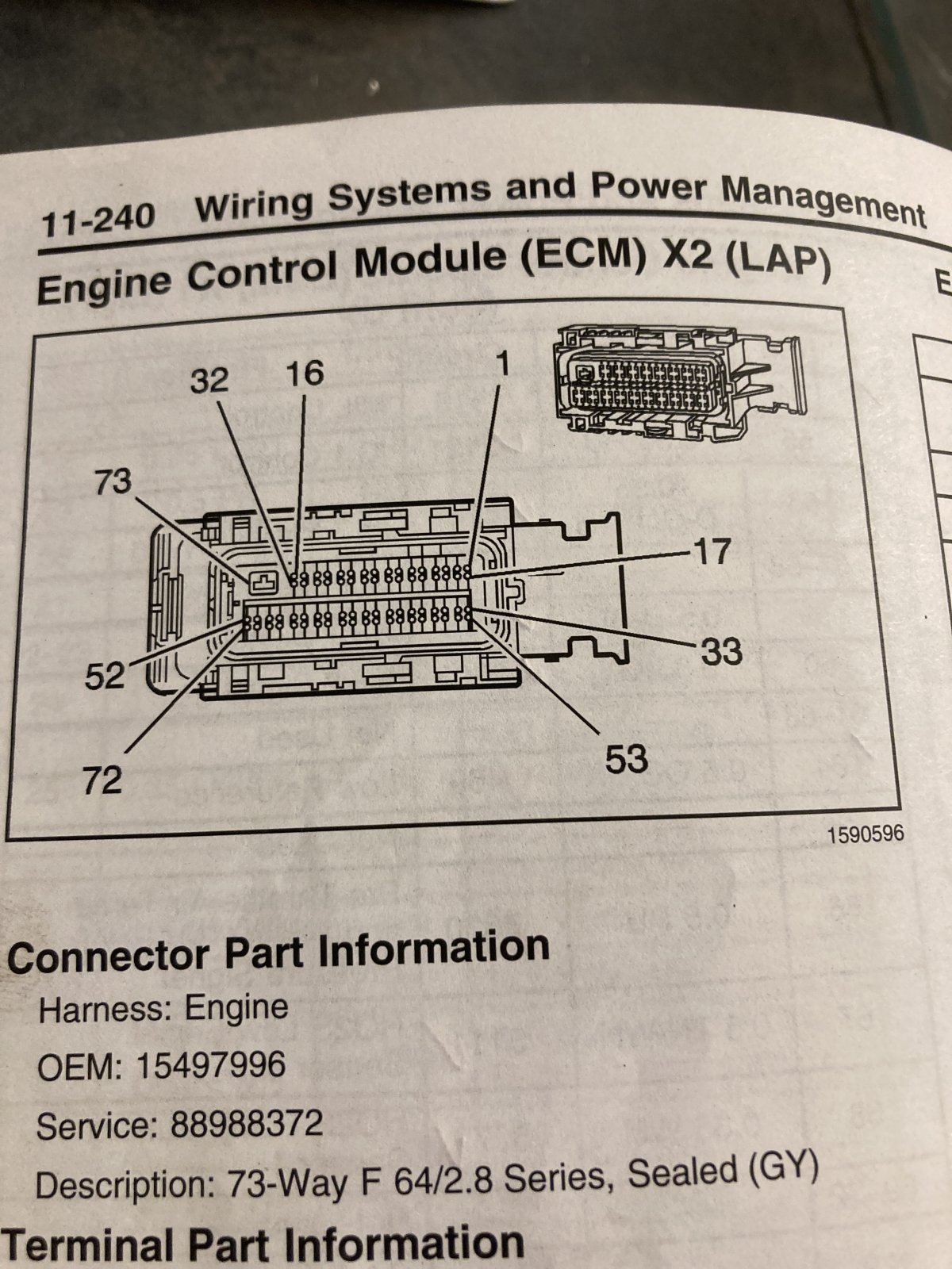

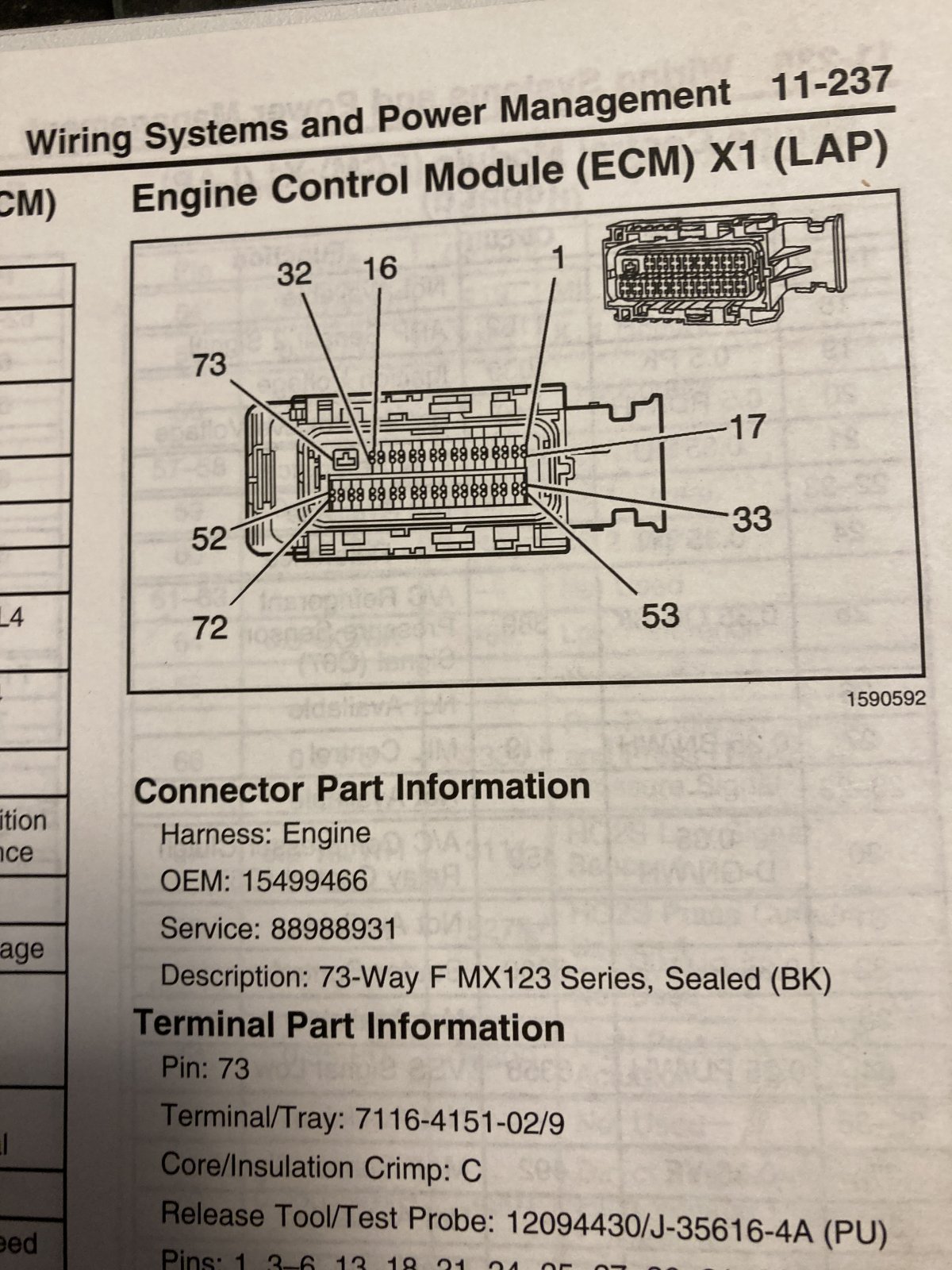

This is super helpful and I'm right in the middle of my wideband install now. Does anybody have the connection diagram to the ECM for an LAP motor? 09-10 2.2. I thinned the wires out of my harness.
I assume you are asking about the ac pressure wiring

I'm using the Autometer wideband where 0 volts is 10.0 and 4 volts is 17.0 AFR. Calculation is ([7101.10]*1.75)+10

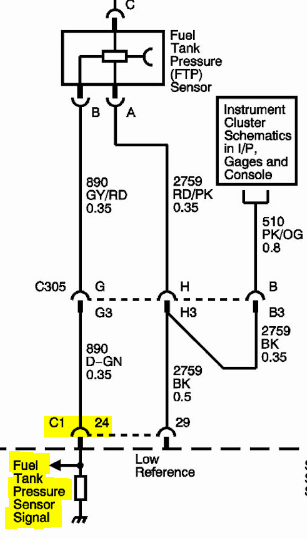

Update: For LSJs, at least, you can also bring your wideband O2 sensor data into the PCM through the Fuel Tank Pressure signal wire on the C1 PCM connector. As my wideband O2 sensor is already connected to the AC Refrigerant Pressure signal wire, I have instead rerouted my Supercharger Inlet Pressure sensor to this input, which is probably only relevant on twincharged setups, so...
I don't think this will work if you are stilll running EVAP, and I don't know if this will work for any other motor, but if you have a need to pull another data point into the computer (oil pressure, fuel pressure, etc.) then here's another possible input point.

My Innovate wideband died. It acted like it needed to be recalibrated, so I did that, and it'd work for about 10 minutes before it started getting really laggy again. I put a new sensor in it, and it did the same thing. I read something about its preheating routine zapping sensors and that there was an updated firmware that addressed that, and it did the same thing with with both of the sensors I had on-hand at that point.
I picked up an AEM UEGO 30-4110 and it works a charm with the original sensor, the one that came with the Innovate controller. So now I have a working wideband gauge with two spare sensors...
Anyway, the white wire from this unit is now attached to the AC Refrigerant Pressure Signal input wire on the PCM. Quick update on the maths parameters in HP Tuners, and we're back off to the races... or HDPEs, I should say.
