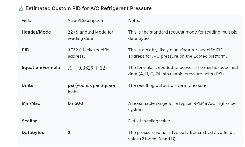

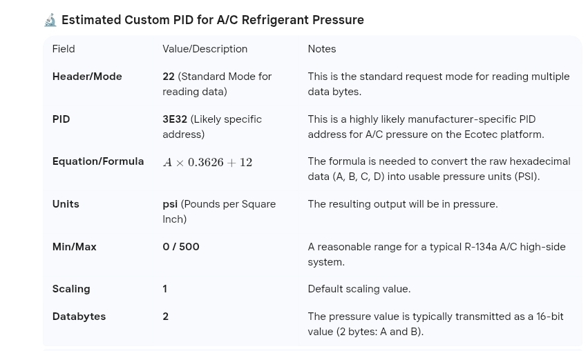

So I did some digging around and some Gemini and I found this PID for the A/C sensor. Now im not sure how to test it to see if it works. Like I said im not a coding guy so this looks Chinese to me.
Nice find! Care to share the location where you found that data?
You would need a tool to read the Canbus, and a way to send a signal on the AC pressure 0-5V sensor wire.
Do you own that digital dash that you can program it to read PID 3E32?

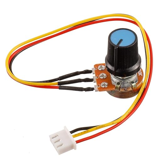

Putting a signal on the AC pressure sensor can be as easy as hooking up a variable resistor. Say 50K ohms, or 10K ohms.
54793
The red wire gets 5V+, the black gets low reference, and the yellow would go to the AC pressure sensor.
On the LSJ wiring, the 5V+ wire is the grey wire, the low reference is the black wire, and the AC pressure sensor is red/black.

I used pretty much the cobalt manual and Gemini to find that PID. I cant on asking particular questions until it responded with that code.
As for the digital dash I physically, don't have it yet.I placed an order, but I could tell the company to program to whatever I want.I should be able to remote program also.
So the way it would work my digital dash can read canbus and ill program to read the PID and it will pick it up.

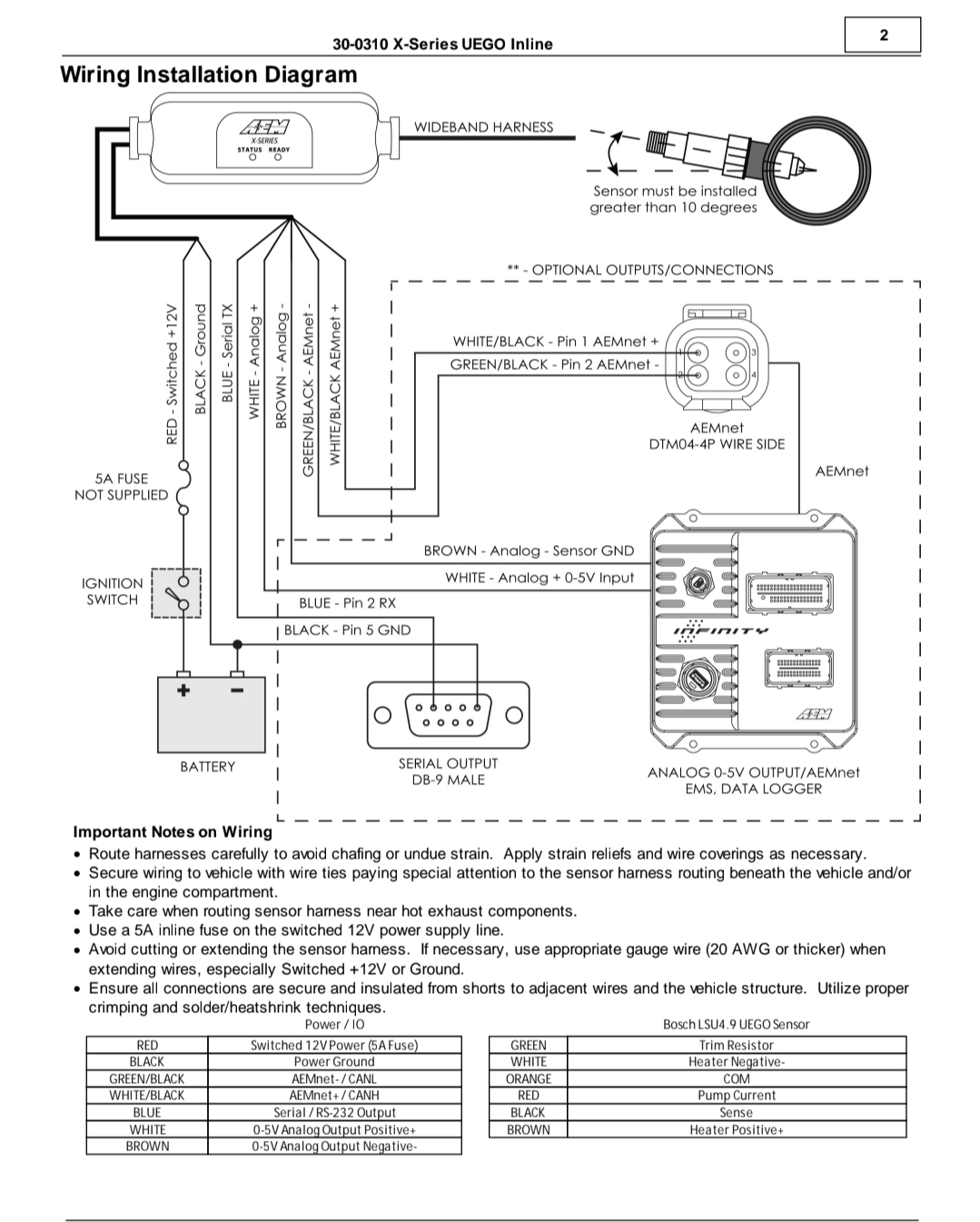

So to wire the wide band to the A/C pressure sensor wire. I would only need to wire the 5v signal from the wideband to the AC pressure grey sensor wire? Seems like im missing something Im crazy confused lol.
Attach is the wideband I will be using.

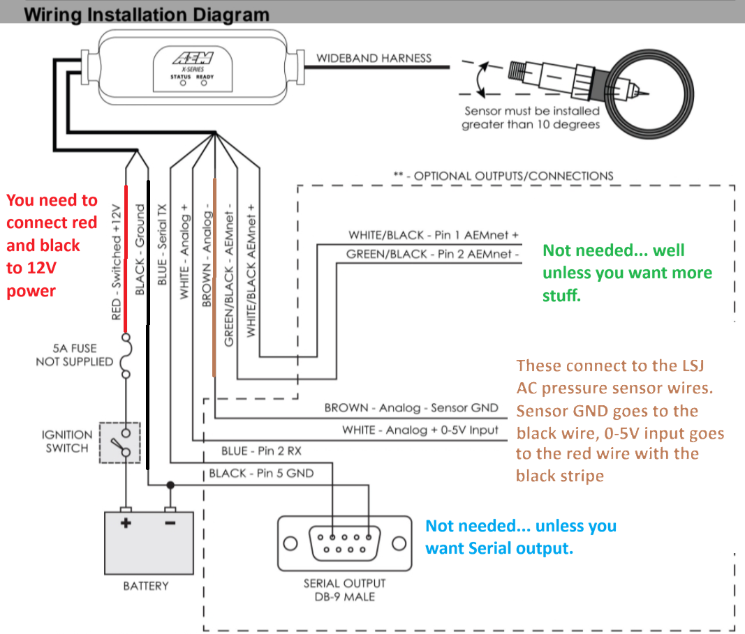

To wire the wideband, you need to connect 4 wires to the Goblin wiring harness. On the AEM harness, those 4 are the red, black, white and brown.
Those 4 wires on the Goblin harness... well you need to find switched 12V+ power, and a ground, then on the AC pressure sensor wires: red with a black stripe, and black. Actually grey is not needed, as it is 5V+ reference voltage, but the AEM has it's own power.
The AEM harness also has a wire harness connector between the Bosch LSU4.9 UEGO sensor, and the AEM dash gauge/ or that AEM controller thing in the top left of this picture.
Excellent break down, definitely will help me out and good for future reference for anyone else.

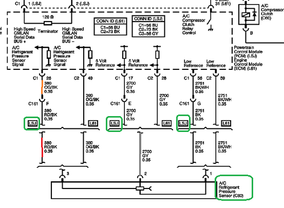

Was thinking about this a little more, regarding the A/C line. Snice I wasn't the one who bluit the Goblin. How can I make sure that the A/C are still connected correctly and that the OBDII will pick them up?
My next project before doing this is going around. Looking for any plugs that are not plugged in, and try to identify. Most likely will have to create a new post will all the plugs.

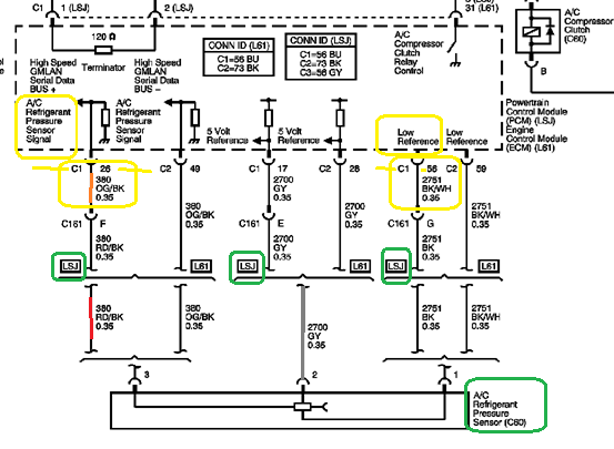

You can trace the red/black wire back to the PCM/ECM using the wiring diagrams, then verify continuity with an electrical meter.
The LSJ PCM has internal circuitry to convert the AC pressure signal to a Canbus signal.
Here I traced the wires back to the PCM.
The red/black wire goes to the PCM connector C1, pin 26, but it has switched to an orange/black wire.
The black wire goes to C1, pin 56.
The Powertrain Control Module (PCM) C1 connector is here.
