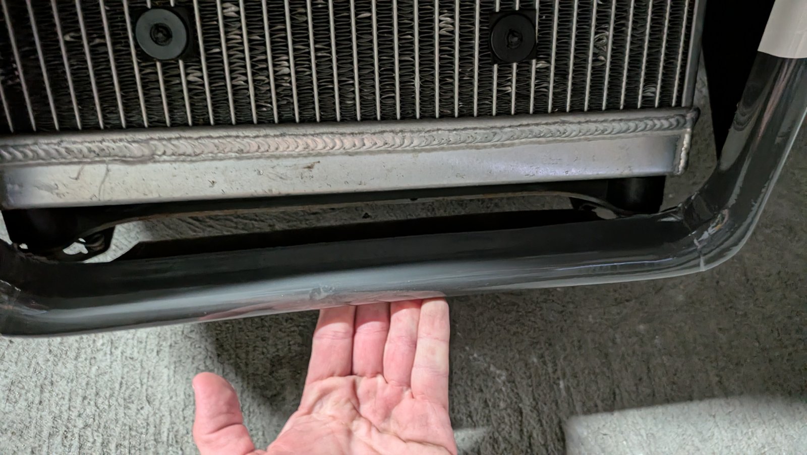

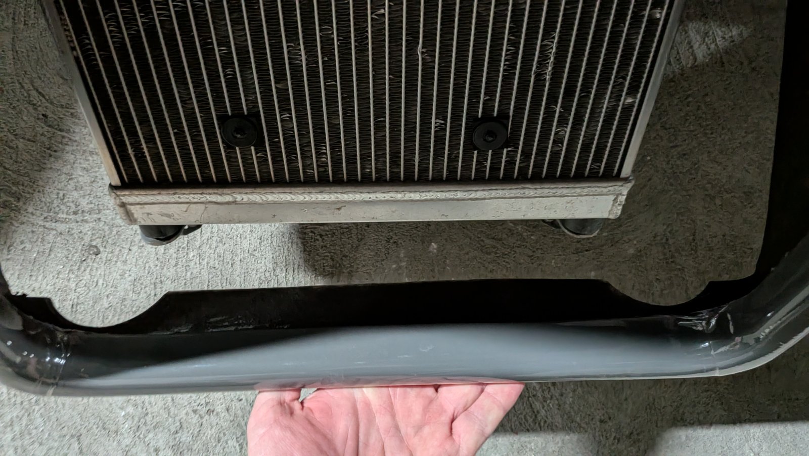

The first thing I noticed is the hood. The rear is mounted in what looks like the stock location and the hood pivots up, but there's nothing securing the front of it. I don't see the front hood plate/DZUS setup, and looking underneath, it honestly doesn't look like one was ever installed.
Is that typical not installed or am I missing something? Either way, I definitely want the front secured before I start driving it.
