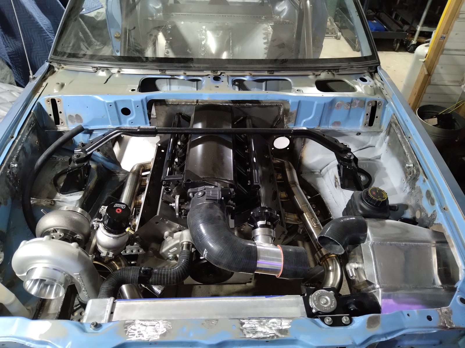

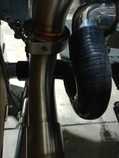

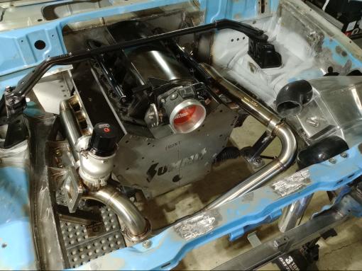

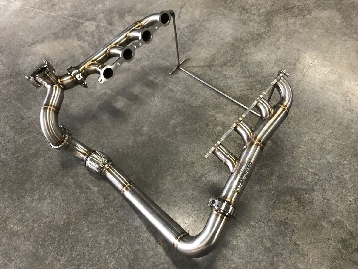

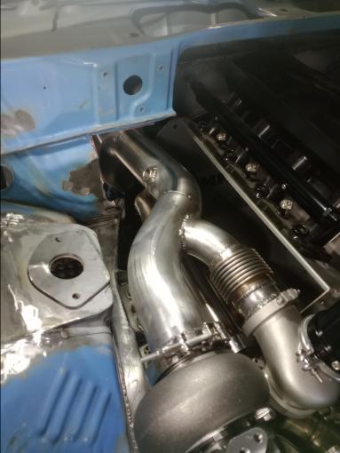

Turbo kit shows up today, 3rd try, pray this fits it was not cheeeeep. gp headers is the company.
52145

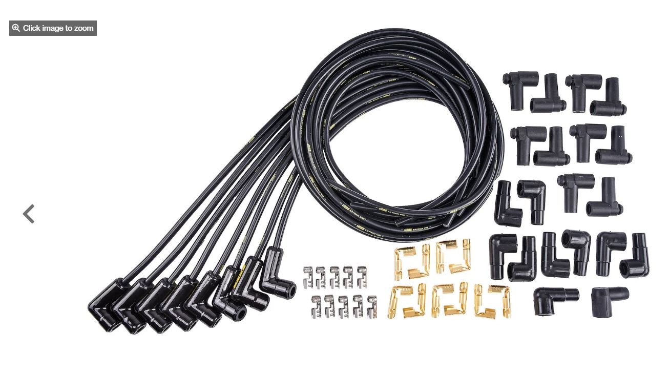

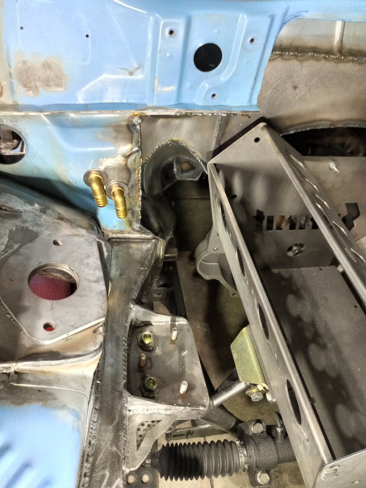

How's spark plug access look with those headers? How well will the plug wires clear? Looks pretty slick, especially for something that wasn't built on your car!
Goblinfanclub1234

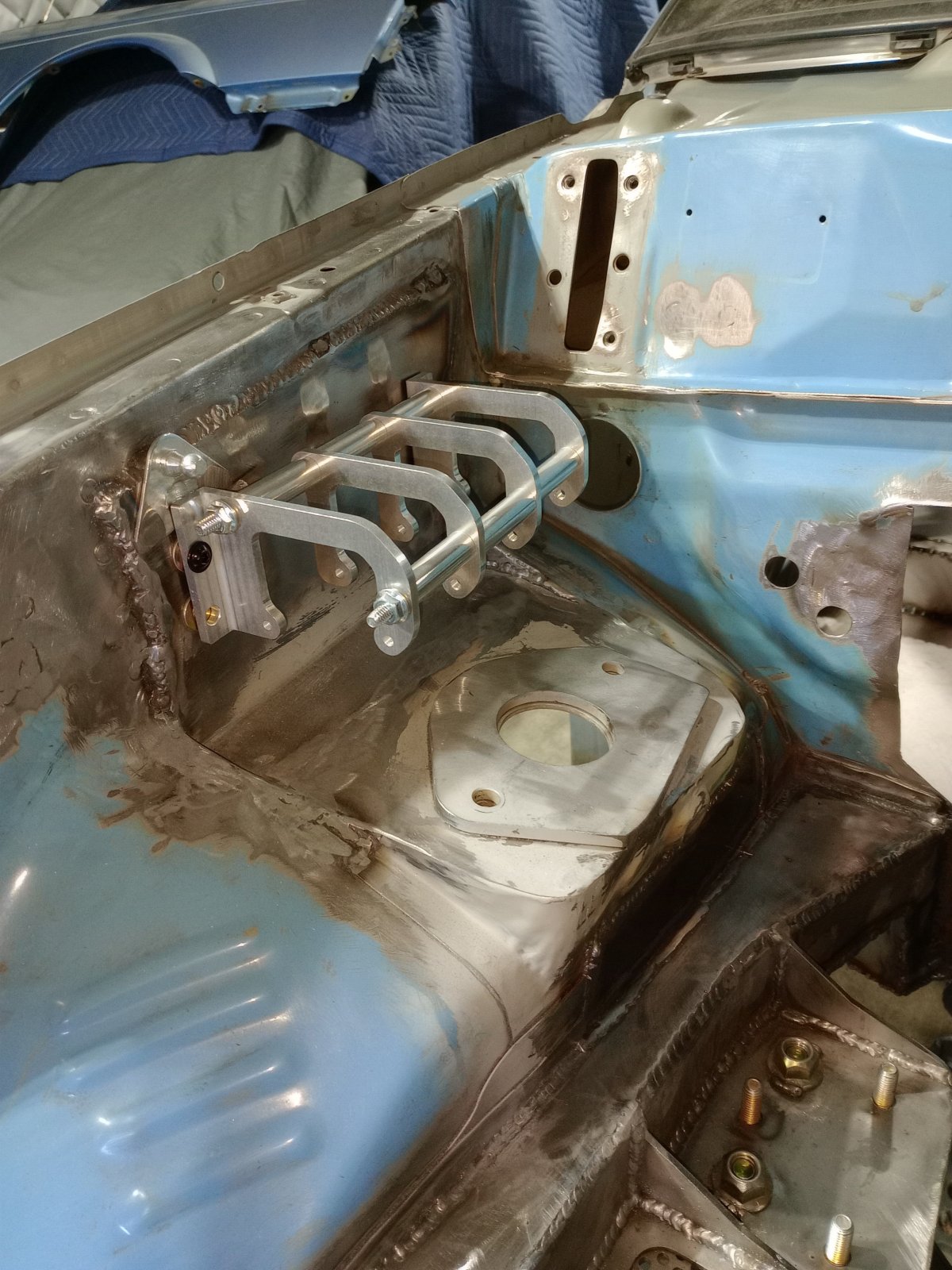

I am going to run 90 degree ceramic boot spark plugs, run the wires under the headers, and over to the coils which are now located behind the coilovers on each side by the fender.
using the "heat sink" style round LS coils

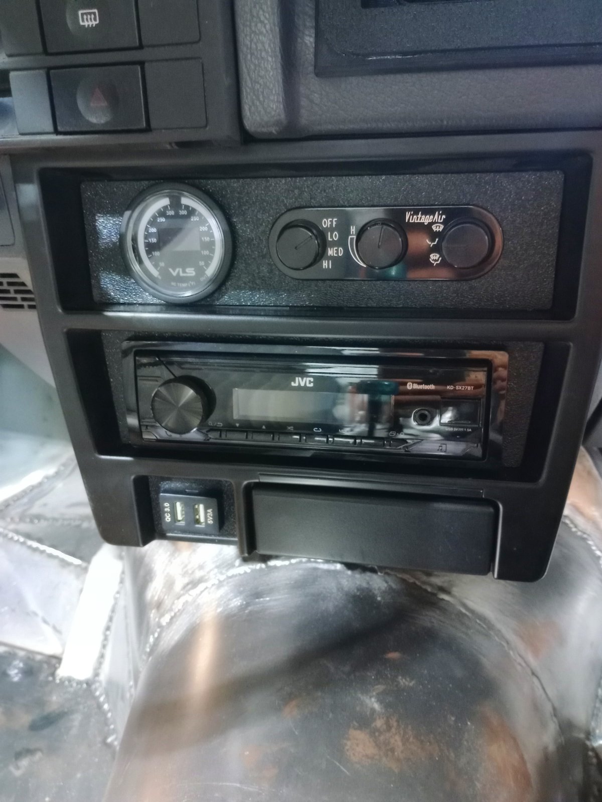

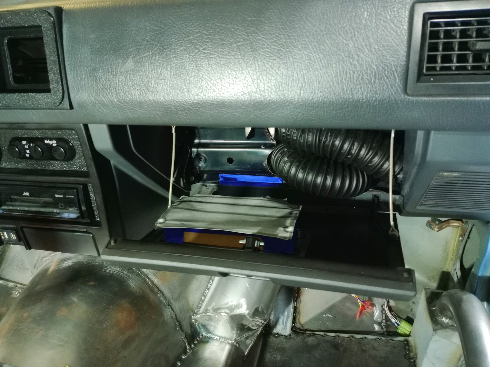

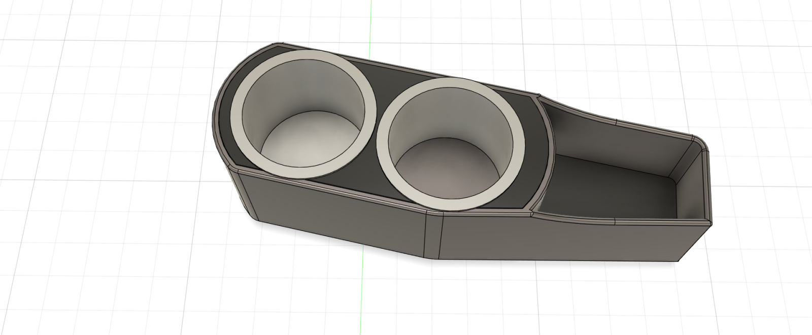

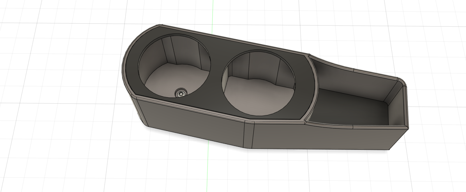

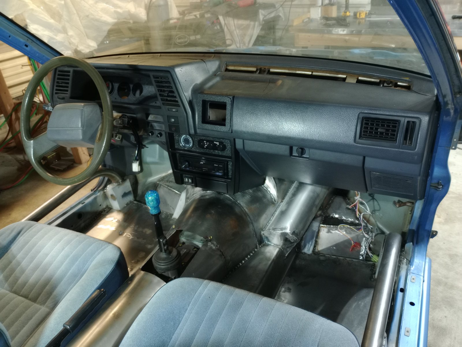

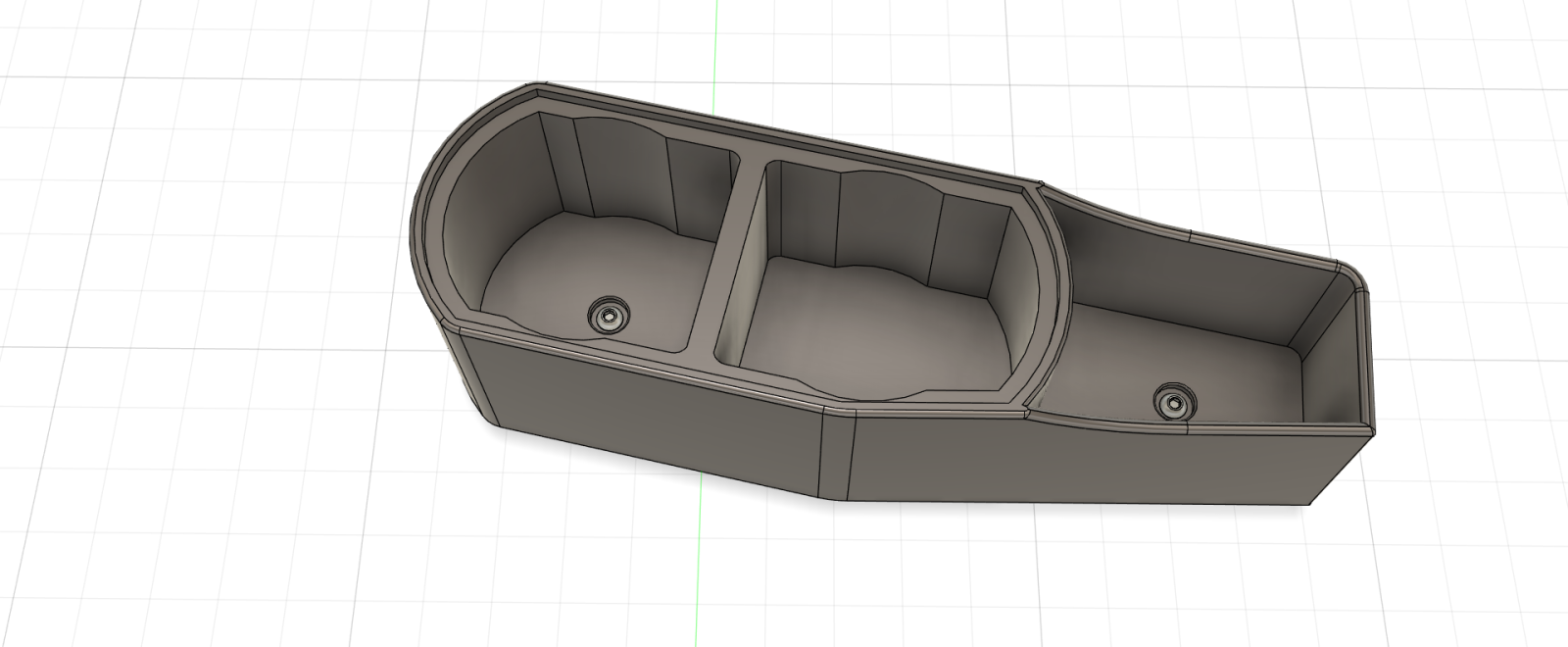

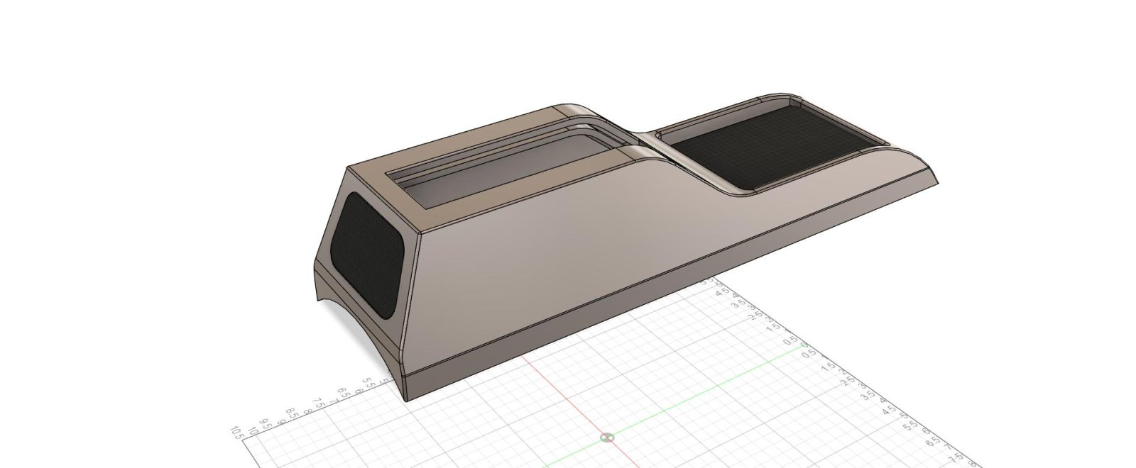

working on a little side console to go over where the exhaust downpipe tunnel ends. If anyone need 3d modeling message me. I order my prints on craftcloud3d
interior is almost done, getting coco mats also going to look amazing.

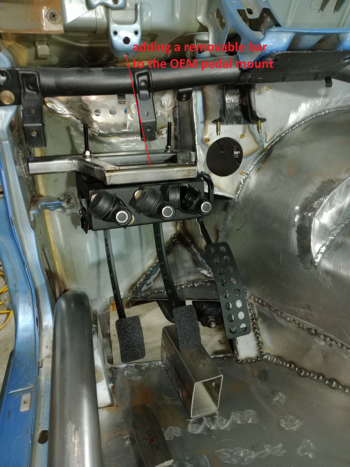

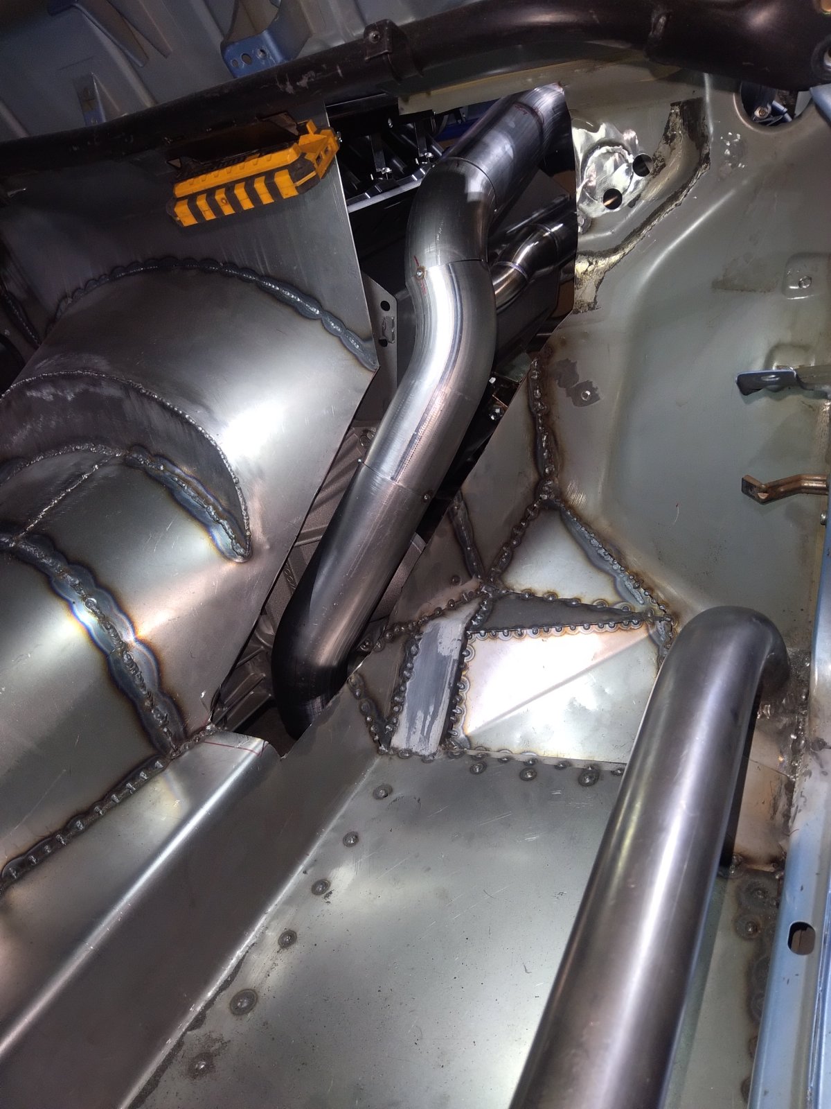

still need to mount the pedals, which requires cutting the tunnel again and making more room.
top panels on this console are the same sendcutsend trextured ABS I used on my dash panels.

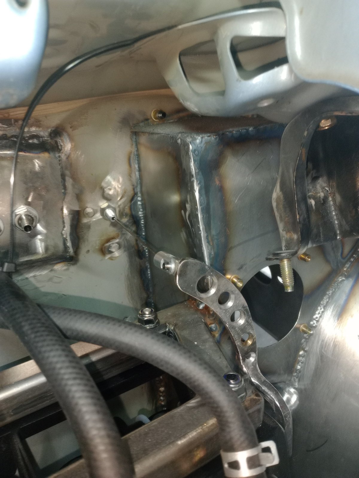

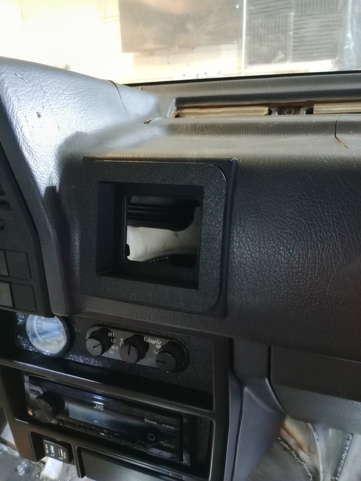

holley terminator x handheld screen holder
53111
Goblinfanclub1234

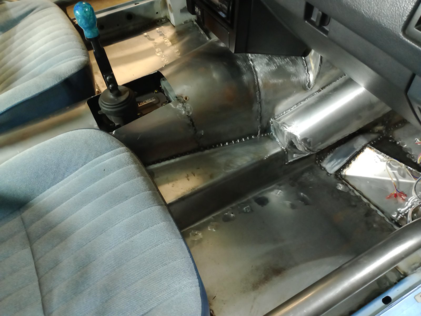

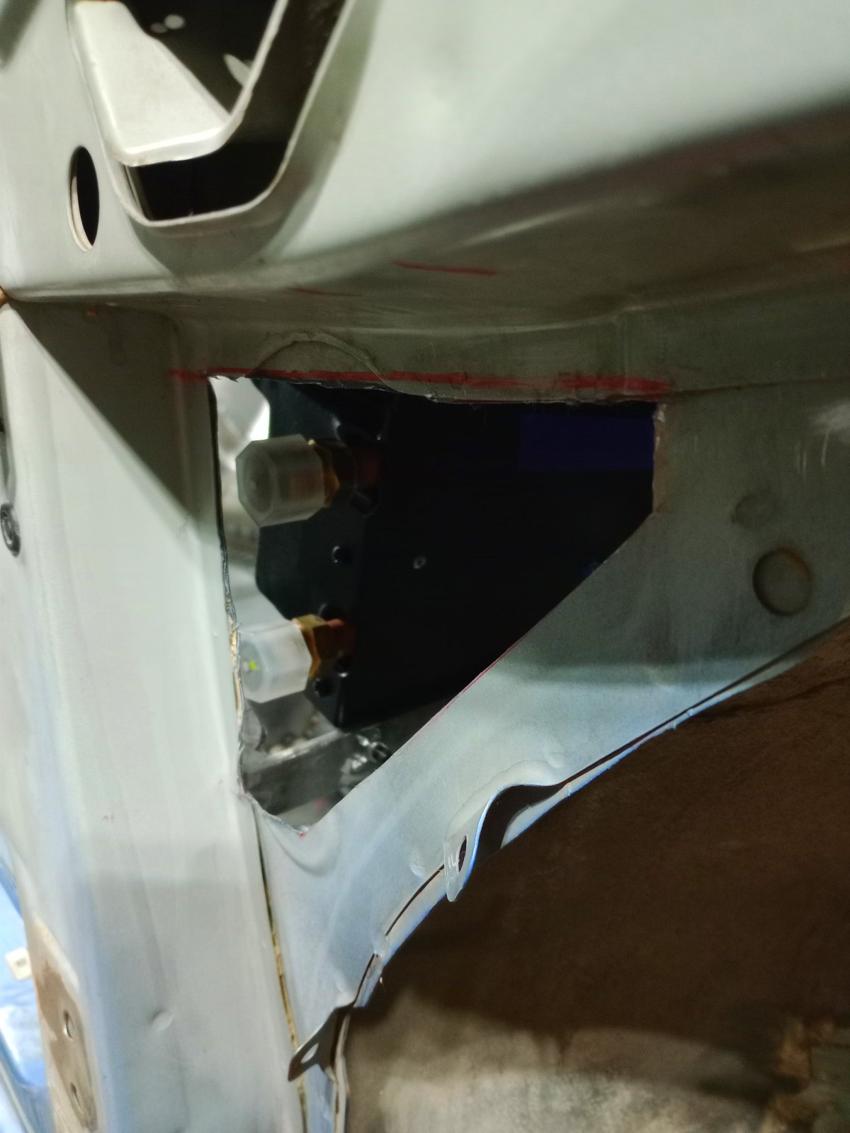

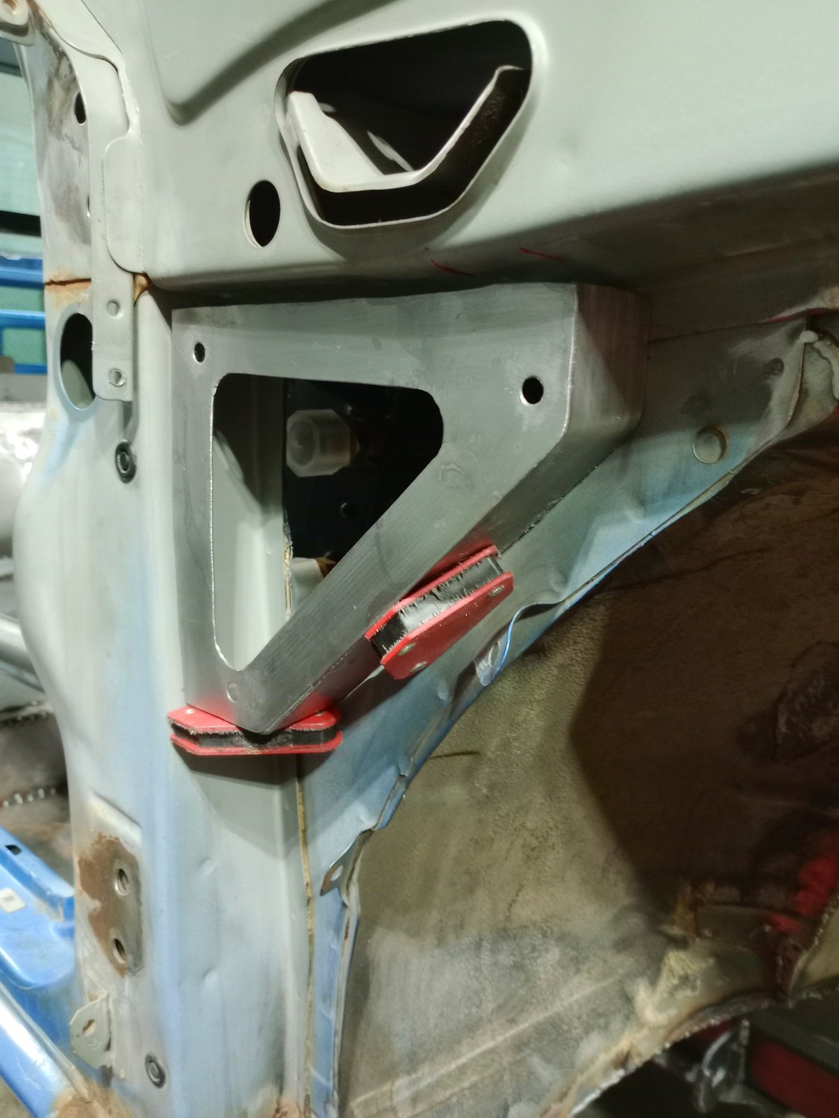

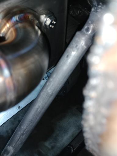

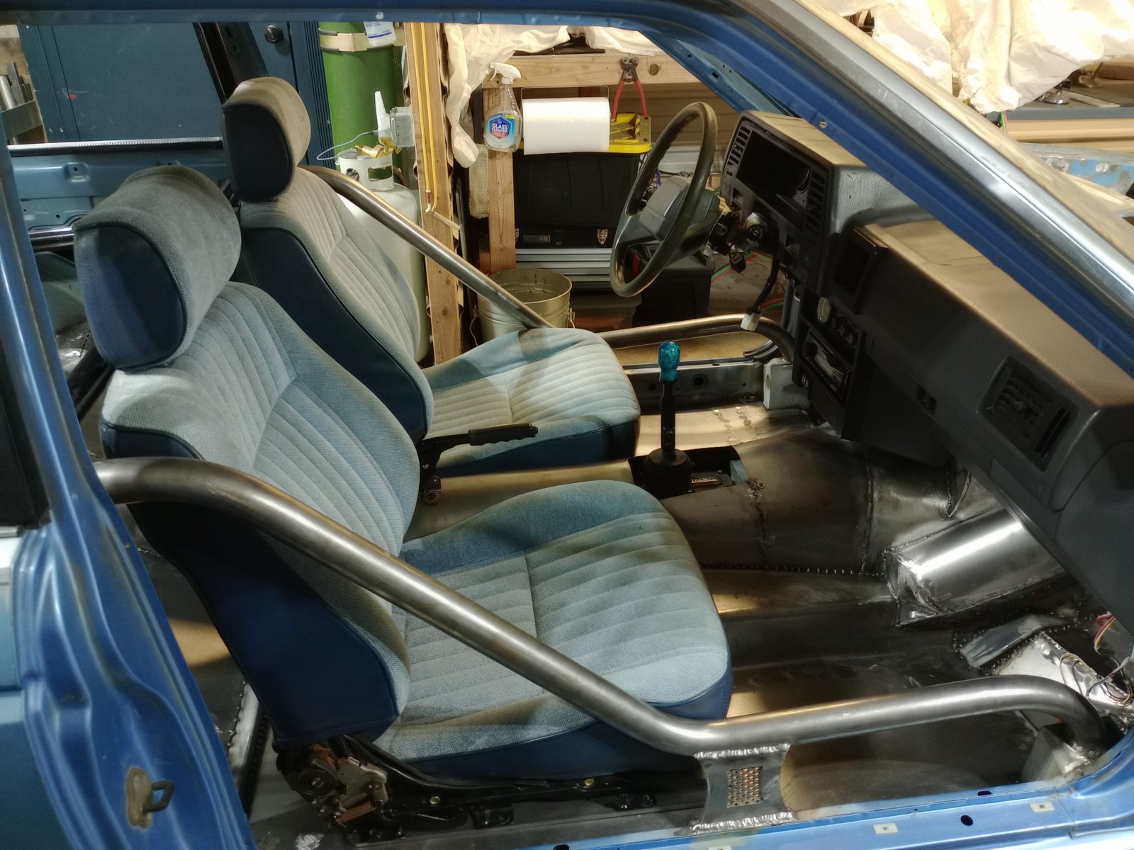

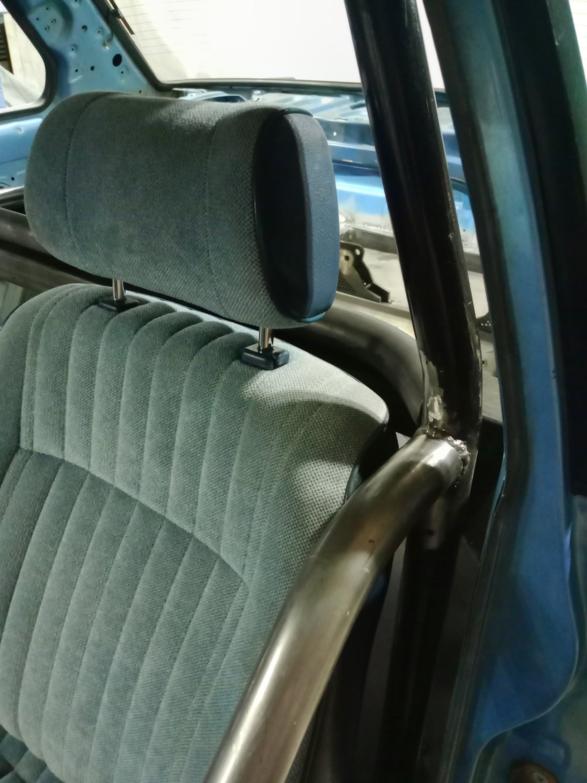

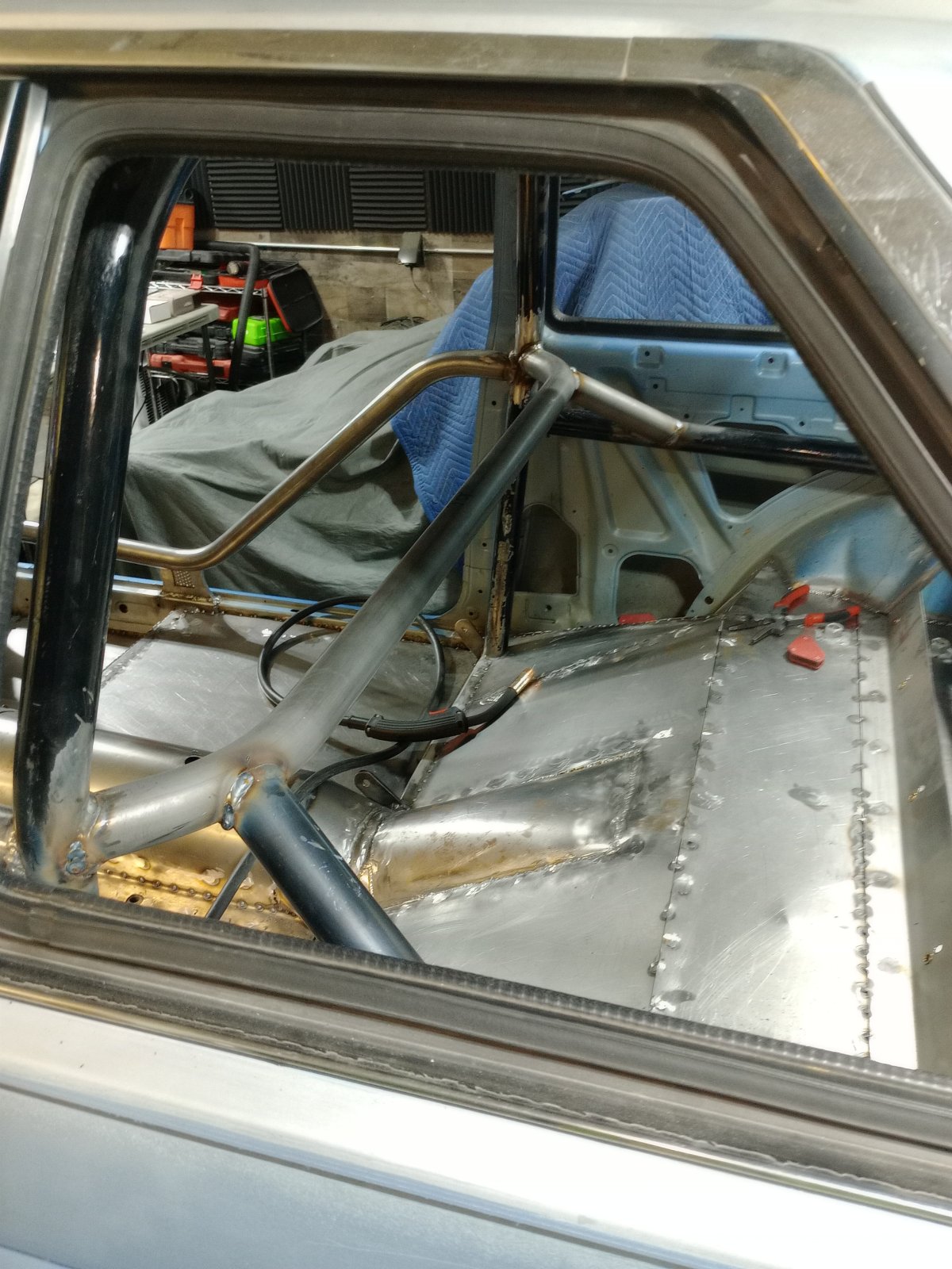

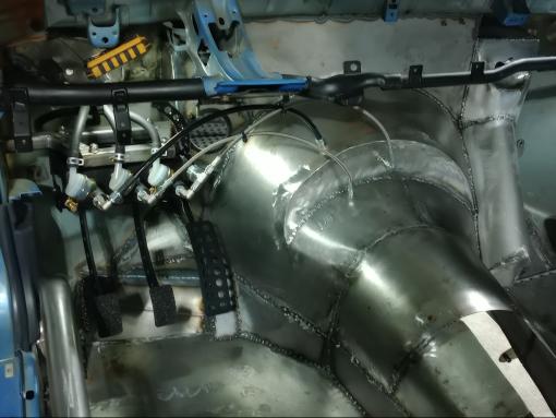

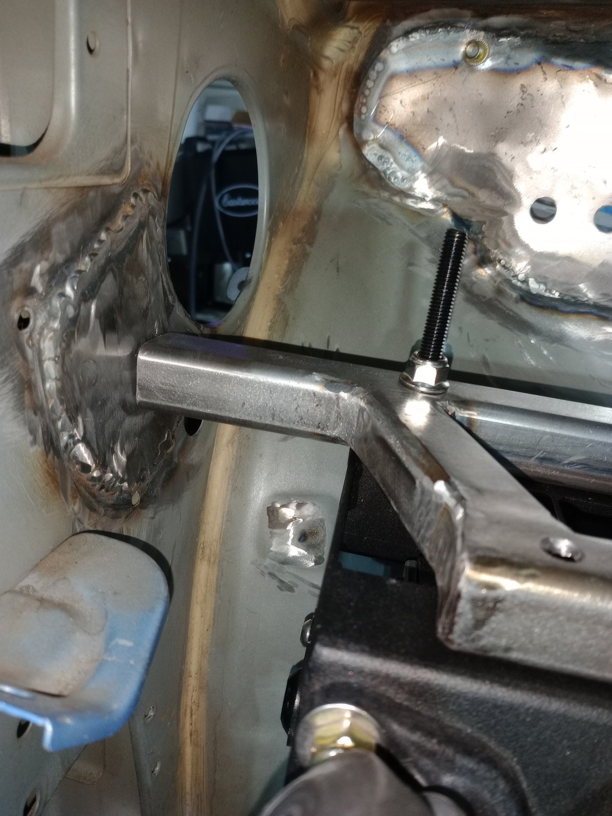

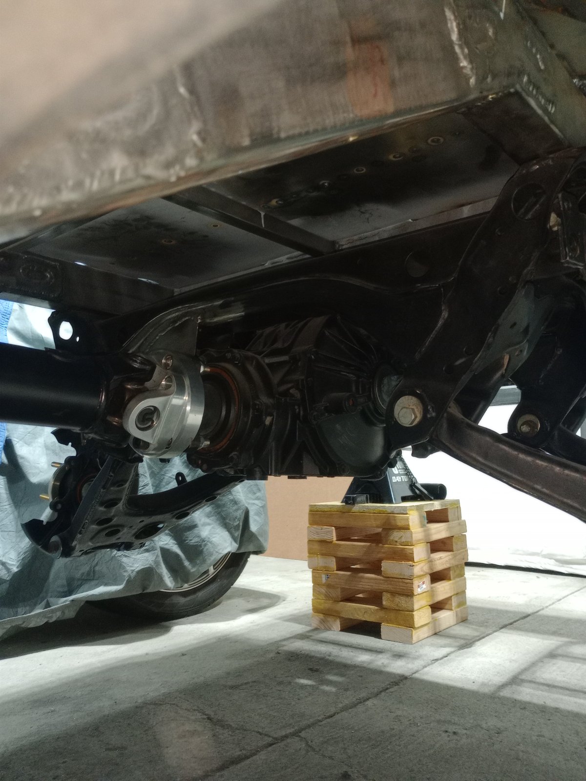

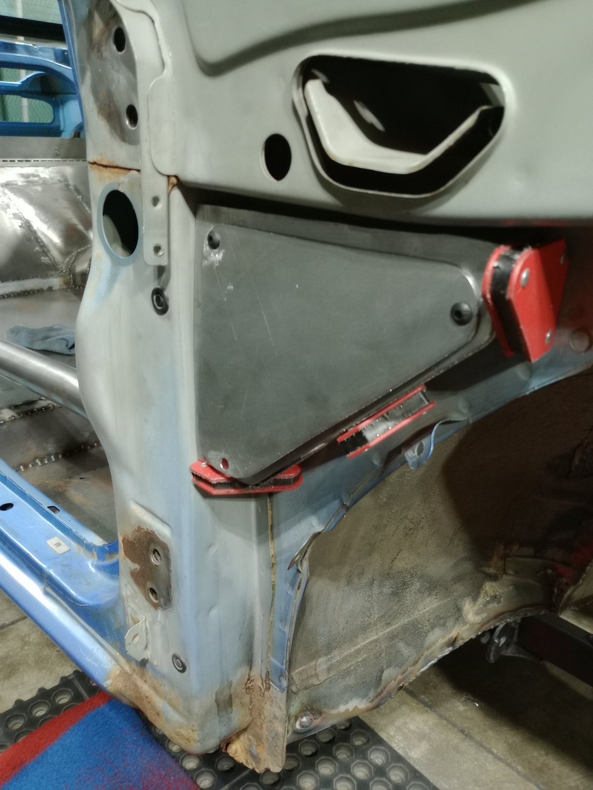

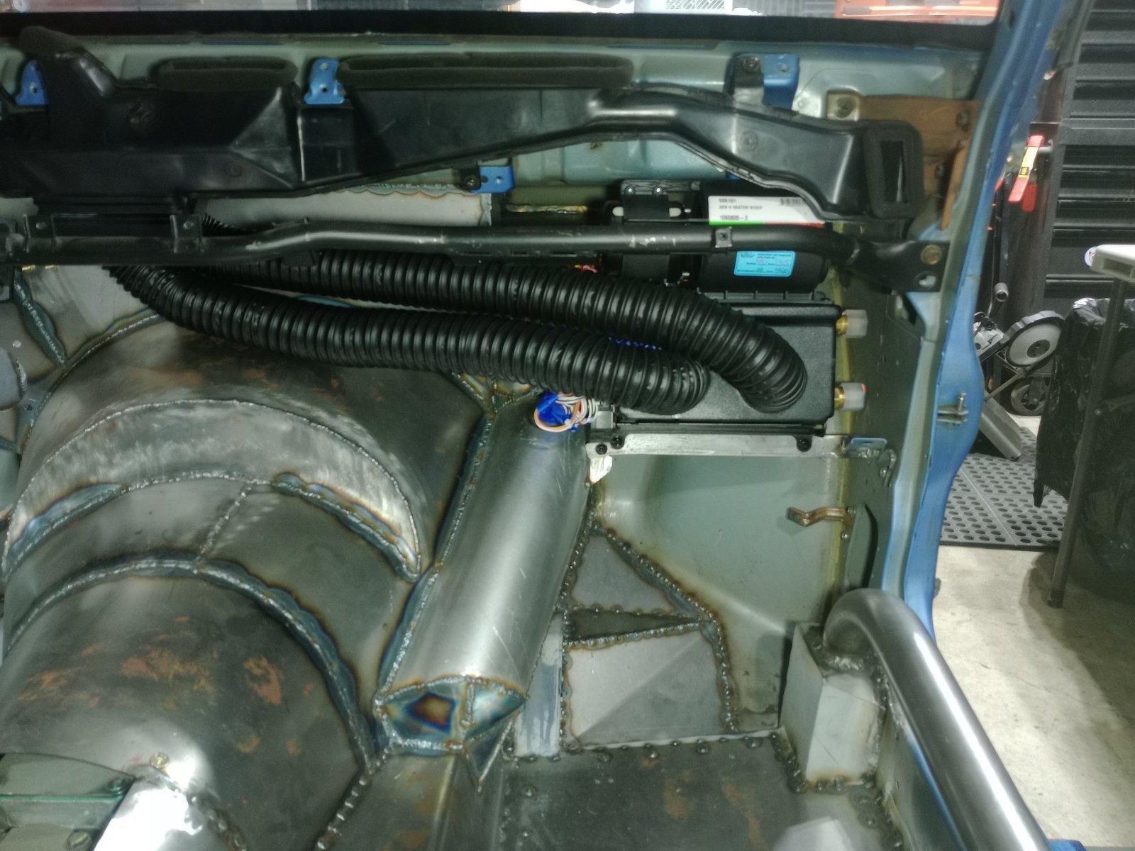

Well thanks! Got my driveshaft in with plenty of clearance for parking brake cables. I cut out my harness bar because it was only 1.5" OD and changed to this 1.75" bar so I can pass tech inspections and also recline my seats. All I have left is the parking brake cable mount under the car and mount the pedals. Had to cut out the drivers side floor to make a recess to allow for pedal travel now I can mount pedal stops in that recess also. Then ready for paint and assembly time. Have all the parts I need to finish except for an engine and Holley Terminator ECU.
3D interior parts are coming out sweet.

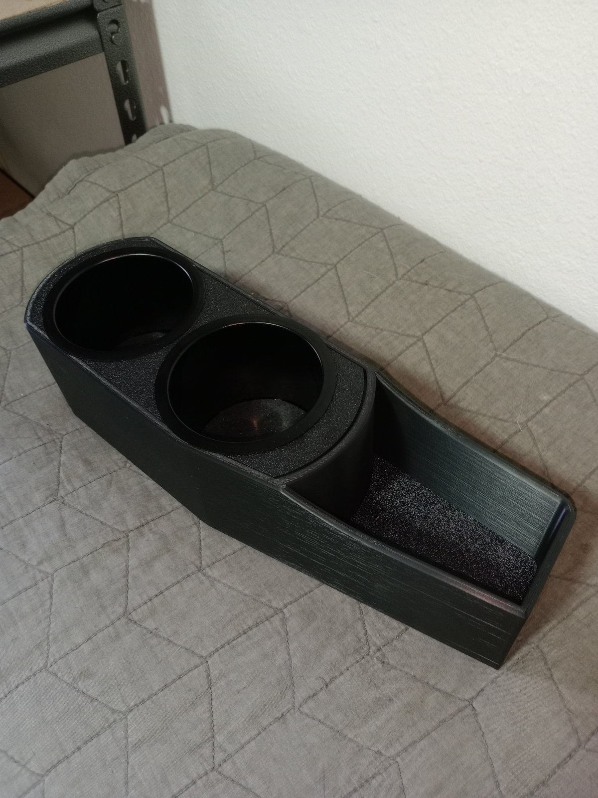

Will be receiving this parking brake console next week and then interior is done!

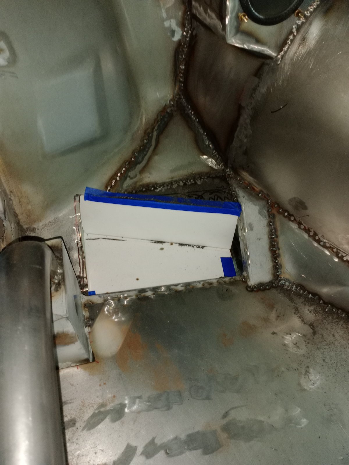

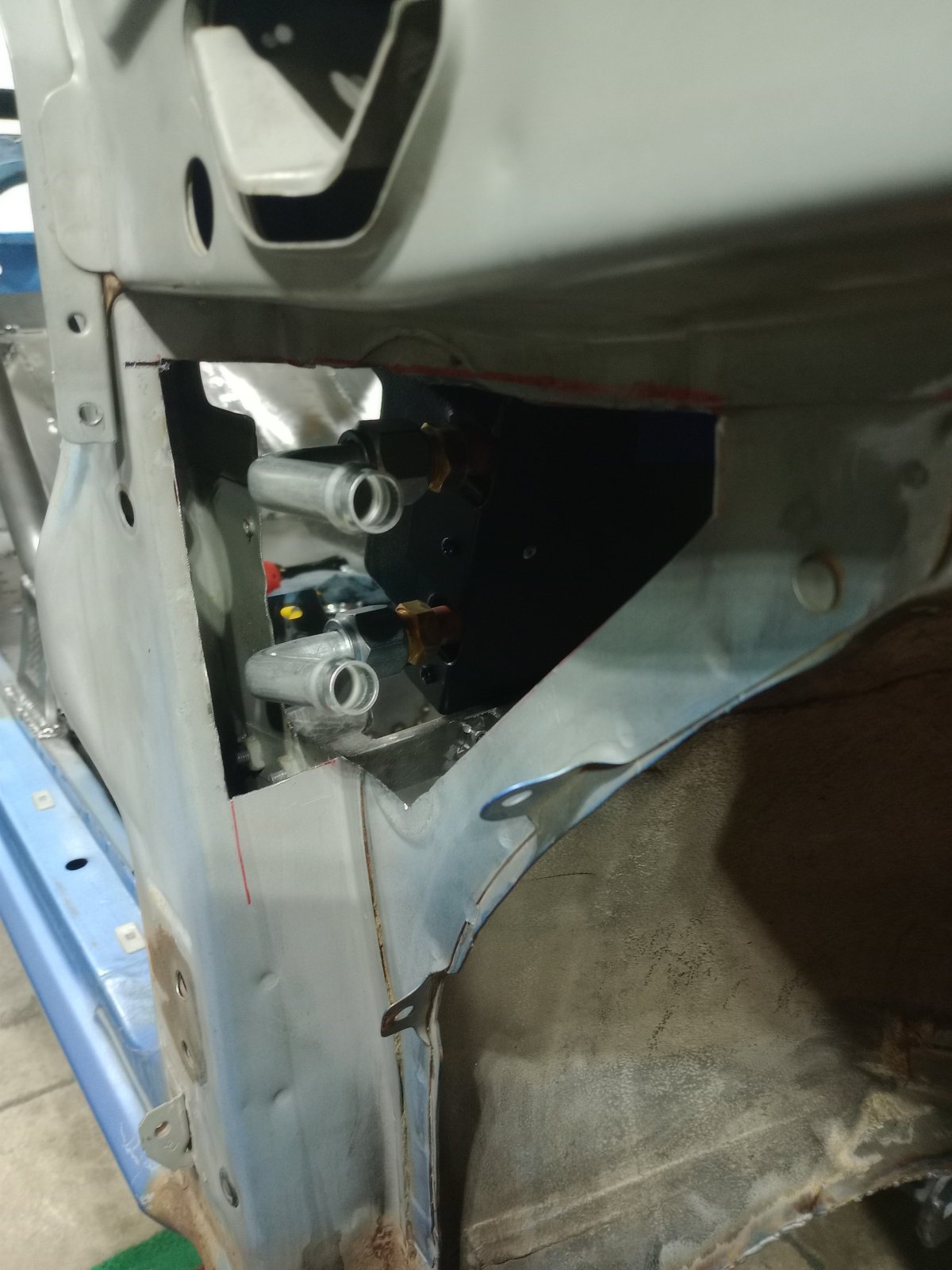

Goblinfanclub1234
last big fab project is done. time to clean everything up and get to paint. Honestly can't believe that all I have left to do is mount brake likes and build a bracket to mount parking brake cables and then done. Not too bad for my first car build ever.
