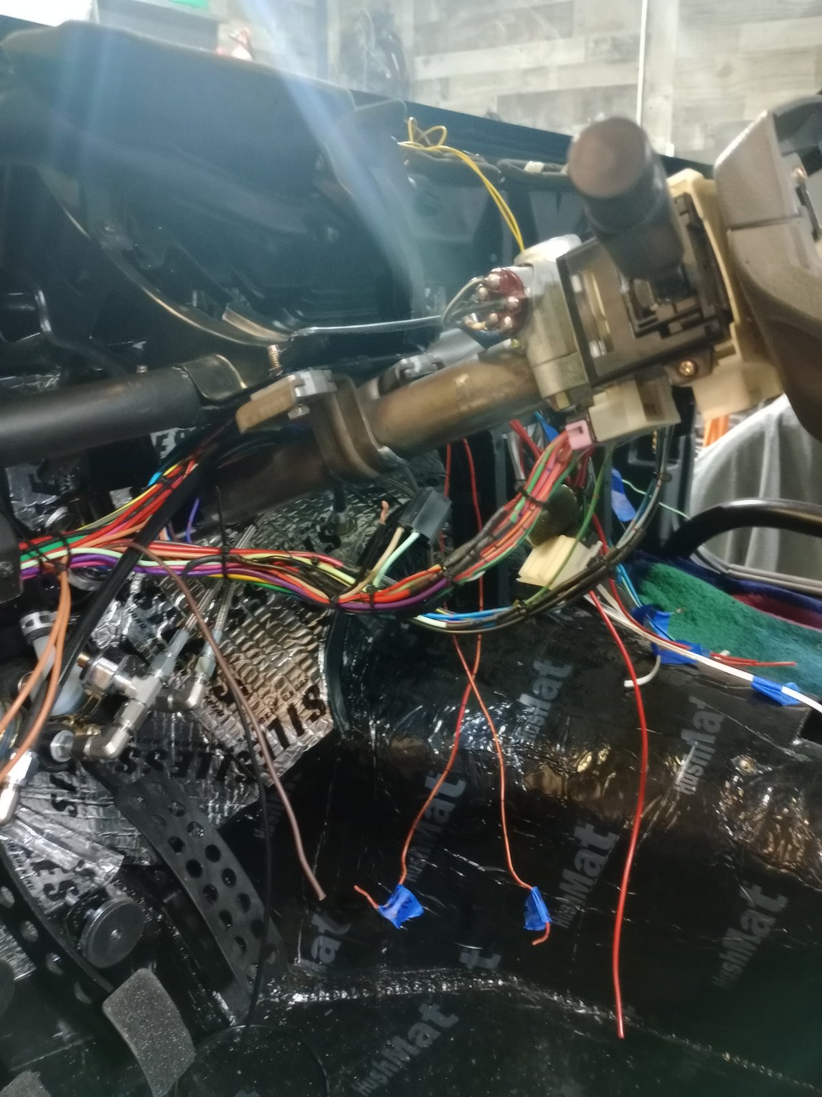

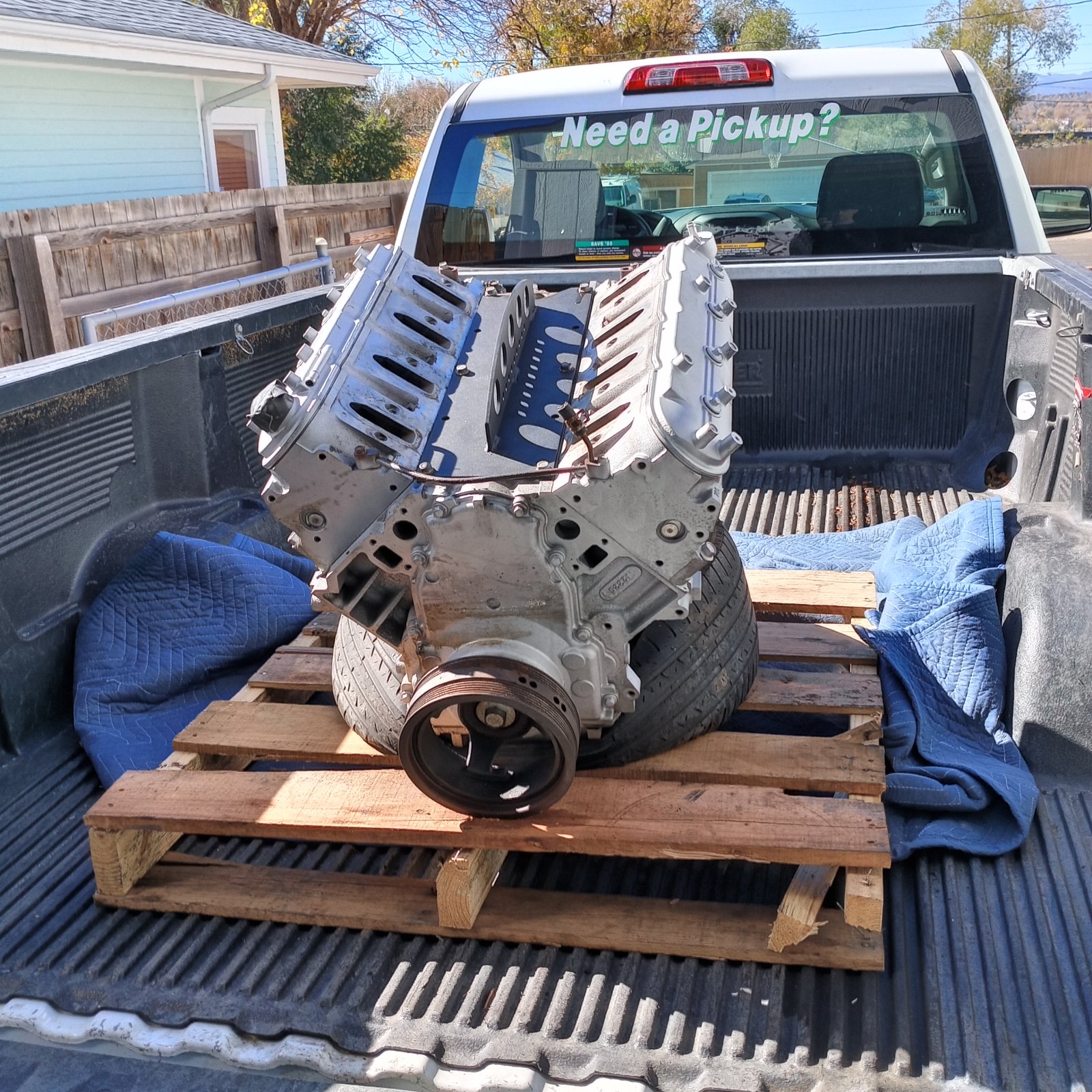

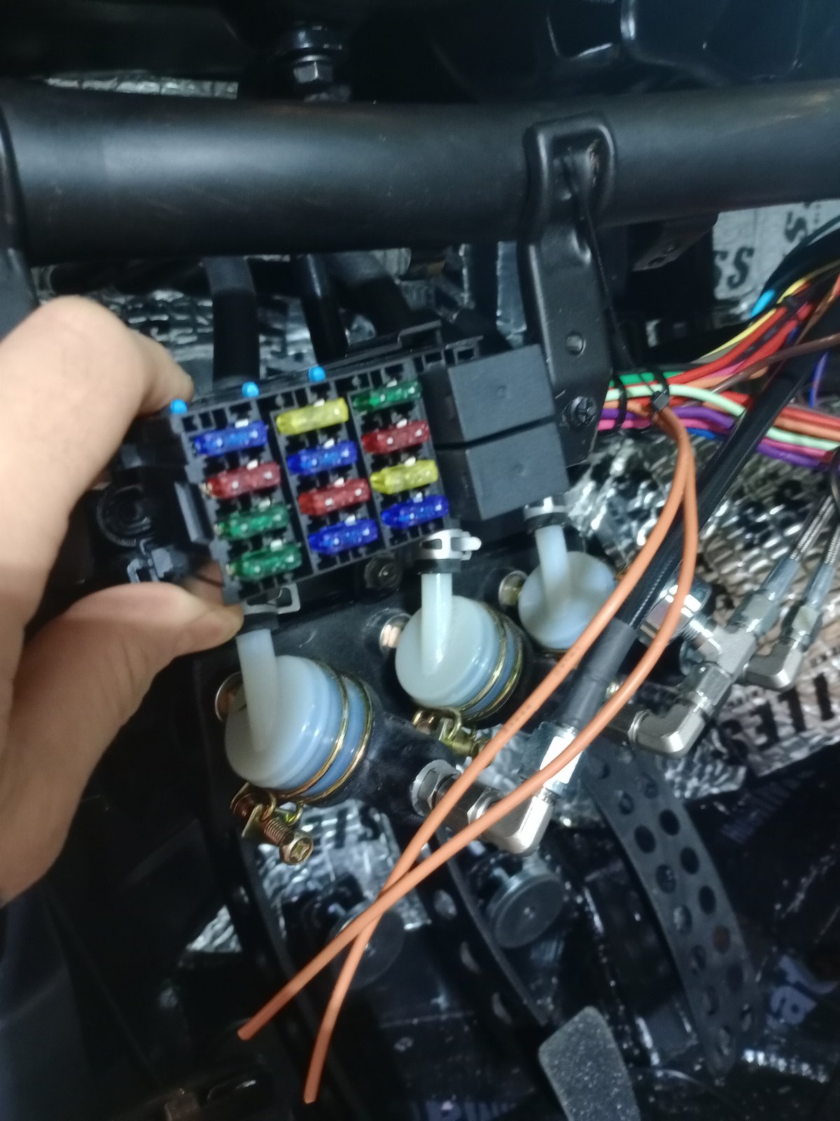

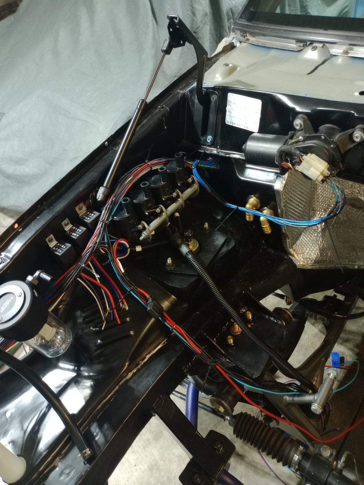

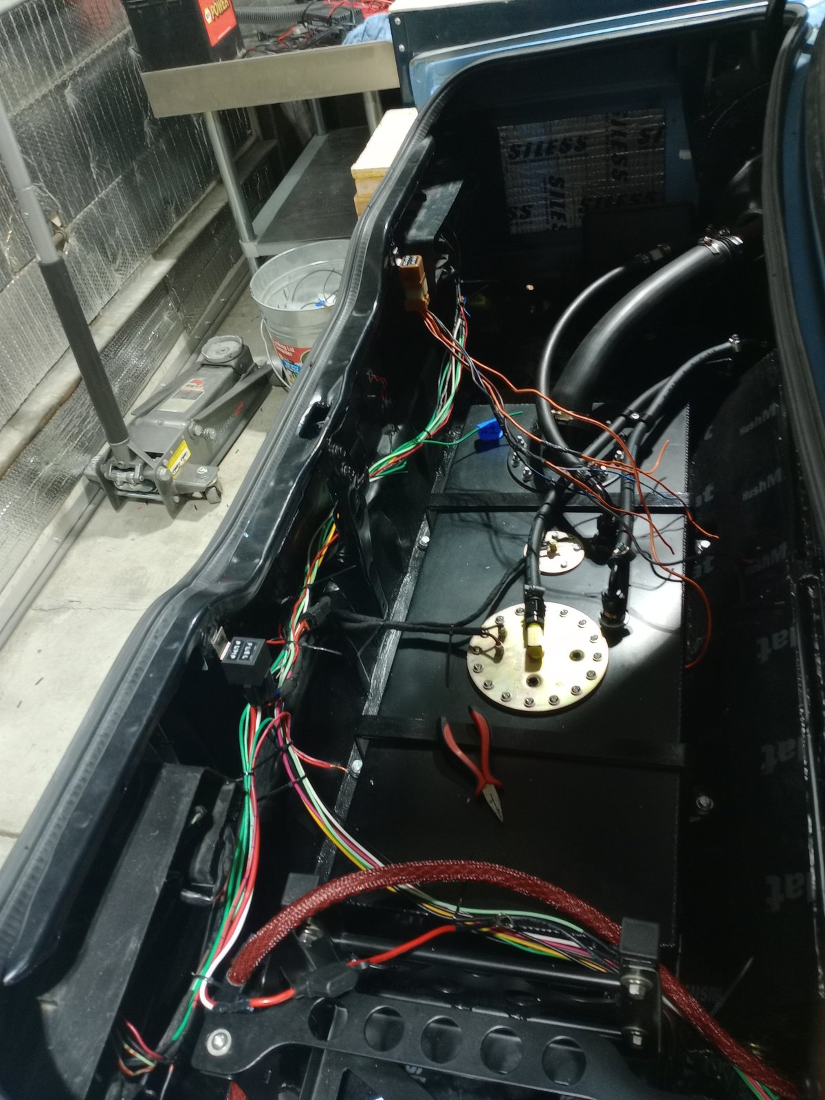

almost done building a wiring harness from this universal speedway motors fuse box. junk yard 5.3 aluminum L33 is showing up in 2 weeks.

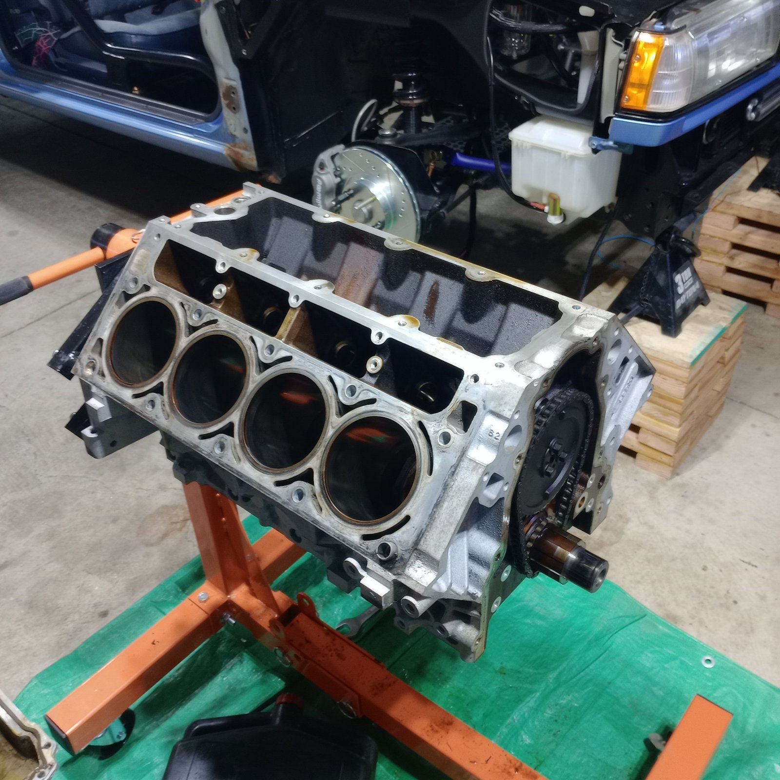

What's in the car now? I looked back and didn't see an answer to that particular question.
Any additional plans for the motor?
Also, is that just a rando sheet metal intake?
Goblinfanclub1234

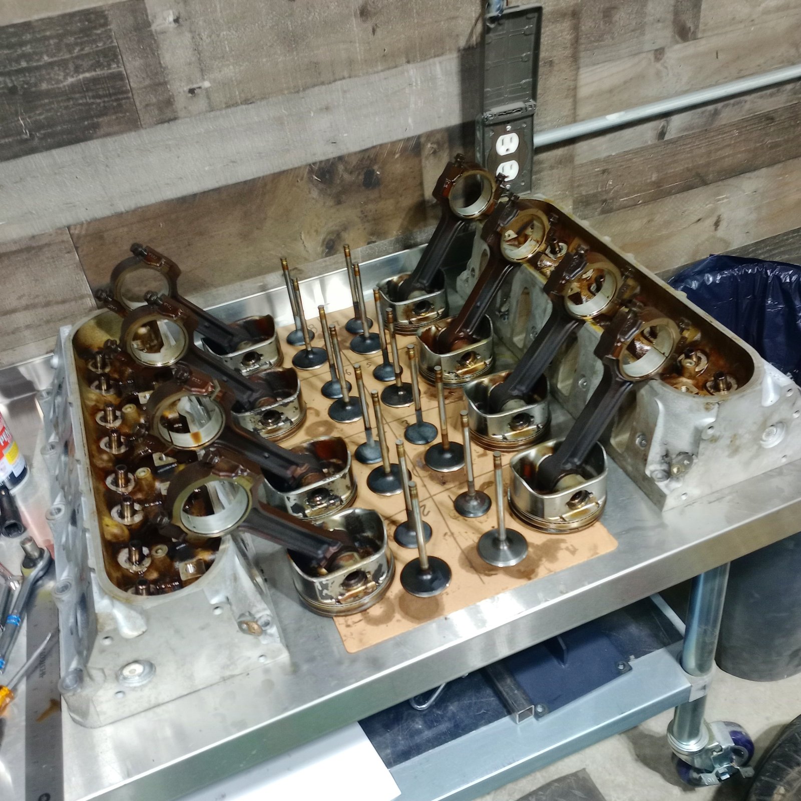

this nissan sentra came with a front wheel drive 1.6 liter 4 cylinder pushing a massive 70 horse power.
soon it will have a rear wheel drive 78mm turbo 5.3 liter V8 with 650 crank horsepower, so only a ~10x gain. starting off with around 10-11 pounds of boost.
engine parts: ARP rod bolts, ARP head bolts, all new piston rings gap for boost, sloppy stage 2 cam, all new gaskets, 80lb/hr injectors, new valve springs seals and rocker arm upgrades, rear sump oil pan, oil barbell upgrade, all new sensors, might do new cam bearings, but need to inspect engine first, keeping stock bottom end.
i am using a knock off sheet metal intake manifold yes.
I went back a few pages again and realized the block that was in there was a mockup block lol

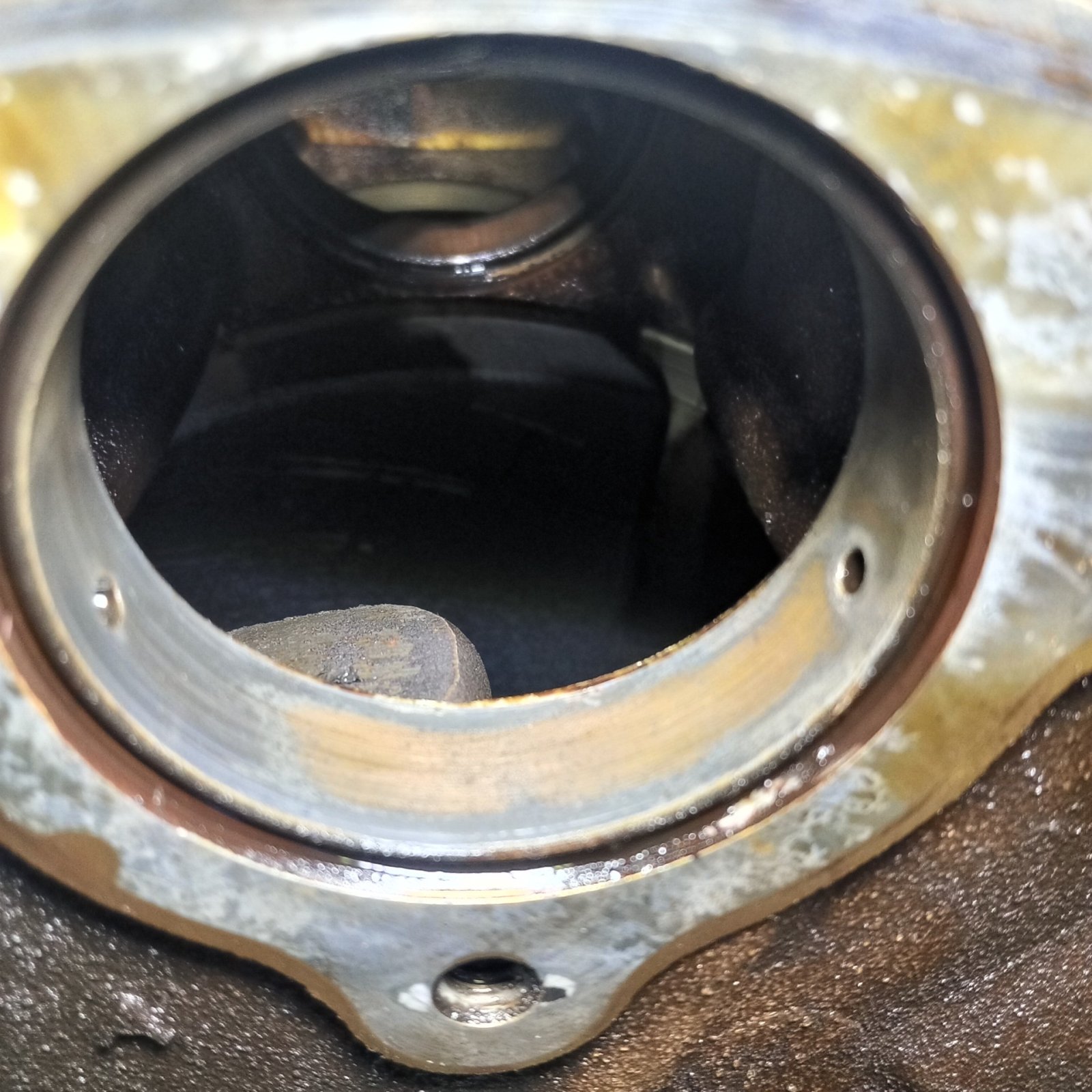

BRUH
Correction, you looked at them. You're not supposed to look at them. They're Schrödinger's bearings, they're both good and not good unless they're observed. If you look at them then they're automatically bad and have to be replaced.
Next time, don't look at them, and they'll be fine.
