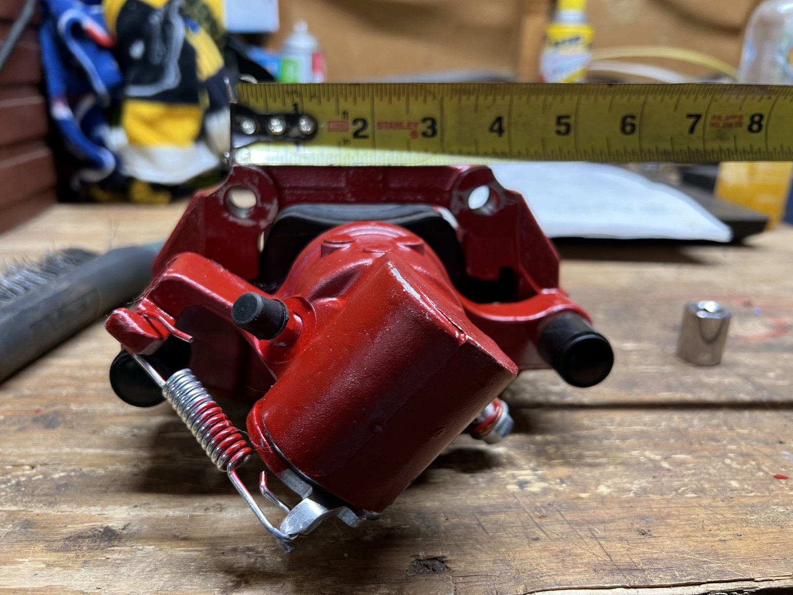

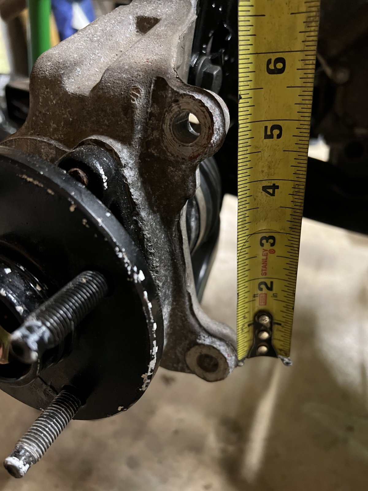

Folks, I need some help. Trying to work on the rear brakes. When I went install the rear calipers, nothing lines up. In the two attached pictures you can see that the spacing for the caliper mounting holes on the spindle is about 5". The spaces for the mounting holes on the calipers supplied by DF is about 3.5". Clearly these aren't going together. What am I missing here?

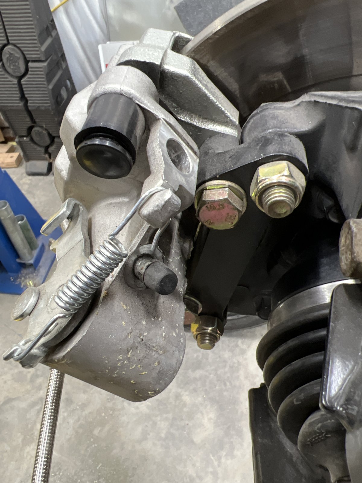

Oh I see now. Those brackets are in the parking brake kit which I haven't starting messing with yet. Thanks for your help.
Don't be confused by the LH/RH cast into the calipers - the LH goes on the right (passenger) side and the RH goes on the left (drivers) side. Just keep the bleeders on top and you'll be fine.
W
Yeah, I figured that out looking at some photos. Originally I had it backwards because I assumed the bleeders would point down but the parking brake levers won't work that way.

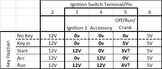

If you dig over the past few months I posted a chart the shows what voltage should be seen when the ignition switch is in the various positions but yours sounds right.

Gtstorey, I found your chart. Here it is.
42188
All my voltages line up with yours, except the white wire (pin 5). I'm getting 12V with the key in. 4V at Run. You didn't list a voltage for Start but I'm getting 3V. I gut tells me that the Start voltage should be 12V. As I said above, the voltage on the data wires coming out of the BCM doesn't change when the key goes from Run to Start, so it clearly isn't sending the correct signal to the ECM. It would be great if one of you all could put a voltmeter on the white ignition wire of your Goblin and tell me what the voltage is in the Start position. That would completely answer the question.

I had posted another chart later in the other thread that showed more info on the voltages at the ignition switch. The question marks were for the older models since I couldn’t tell if the earlier had the same resistors to get the same voltage as the later models.
