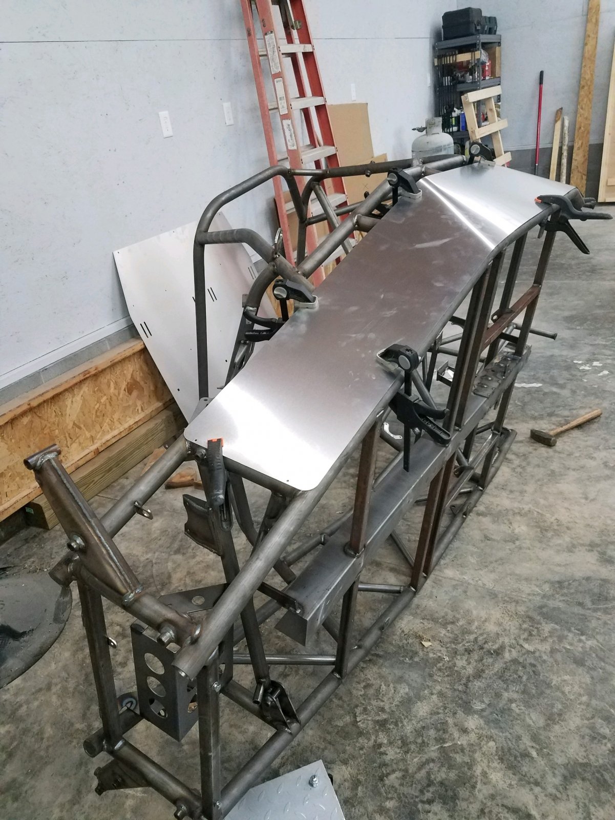

#316 arrived Sunday morning (see arrival pick in ‘A Peek into DF Kit Car’ thread) and after doing a semi-inventory (opened boxes and verified contents matched packing list) I decided to start with checking how I was going to mount the side panels. I’m wanting to powder coat, so if I need to add any mounting tabs, now is the time.
25923
I’m leaning towards using 6-32 aviation machine screws and tapping holes in the frame and tabs to attach the panels. Anyone have a good reason to NOT use those screws?
The panels fit pretty good so I may only add one or two tabs and maybe add one more screw and hole on the top tube between the V area of the upright tubes after the horizontal tube bends from the front to the side.

I finished mounting the side panels and am pretty happy with the fit. It could use an extra tab or two but I’m not sure they would make much difference.

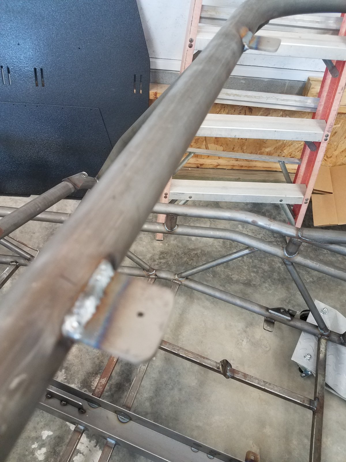

Fabbed up some mounting tabs and had a friend from church weld them in. Planning on putting in some form of roof panel to keep the sun off my bald head. I'm leaning towards using tinted plexiglass but may just use aluminum. I left the tabs about 1/4 inch below the top of the tube hoping what ever I use will be slightly below the top when installed.

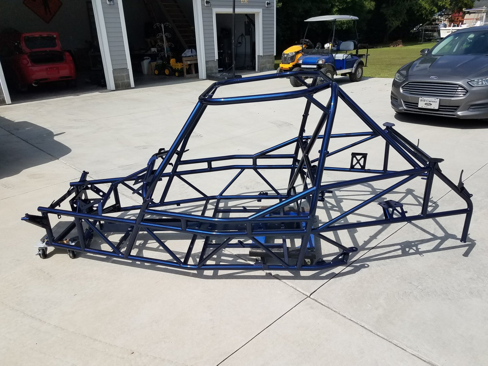

Dropped off the chassis to get powder coated last week. Hopefully, it will be ready to pick up Friday.

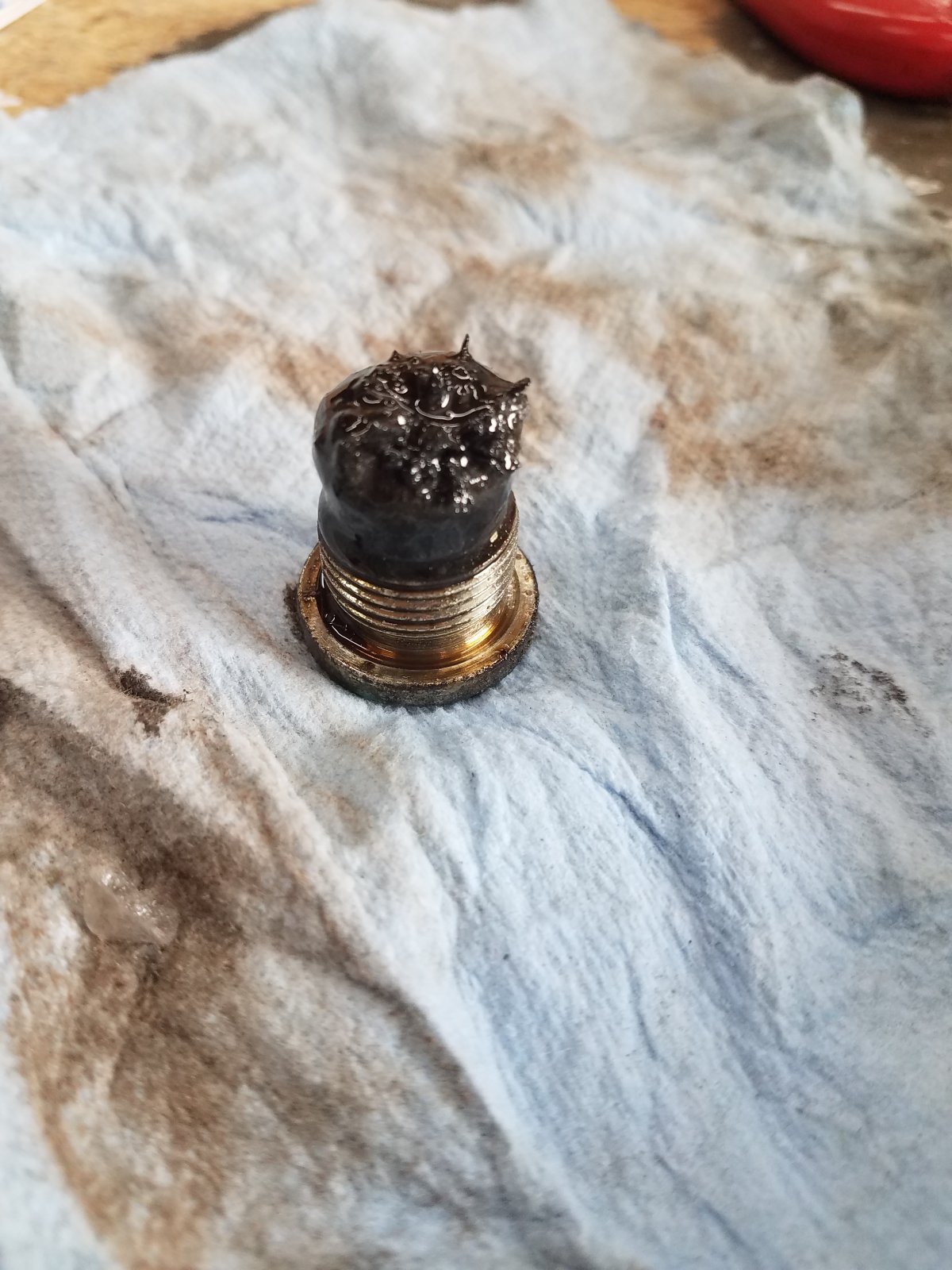

So I haven't exactly been building my Goblin in the typical order of the videos. I've started construction w/o finishing stripping the donor. However, I did finally get around to getting the drivetrain pulled yesterday. The engine started and ran, but I've always been suspect of the transmission and after draining some fluid, I'm 100% sure I'll be using the back up one I purchased.
Drain Plug
26653
and yes...the trans fluid color was that dark. I've seen diesel engine oil look better. Add in the cracked end cover with a JB Weld patch that was still missing a huge hunk of metal and I'm very glad I bought the other tranny.

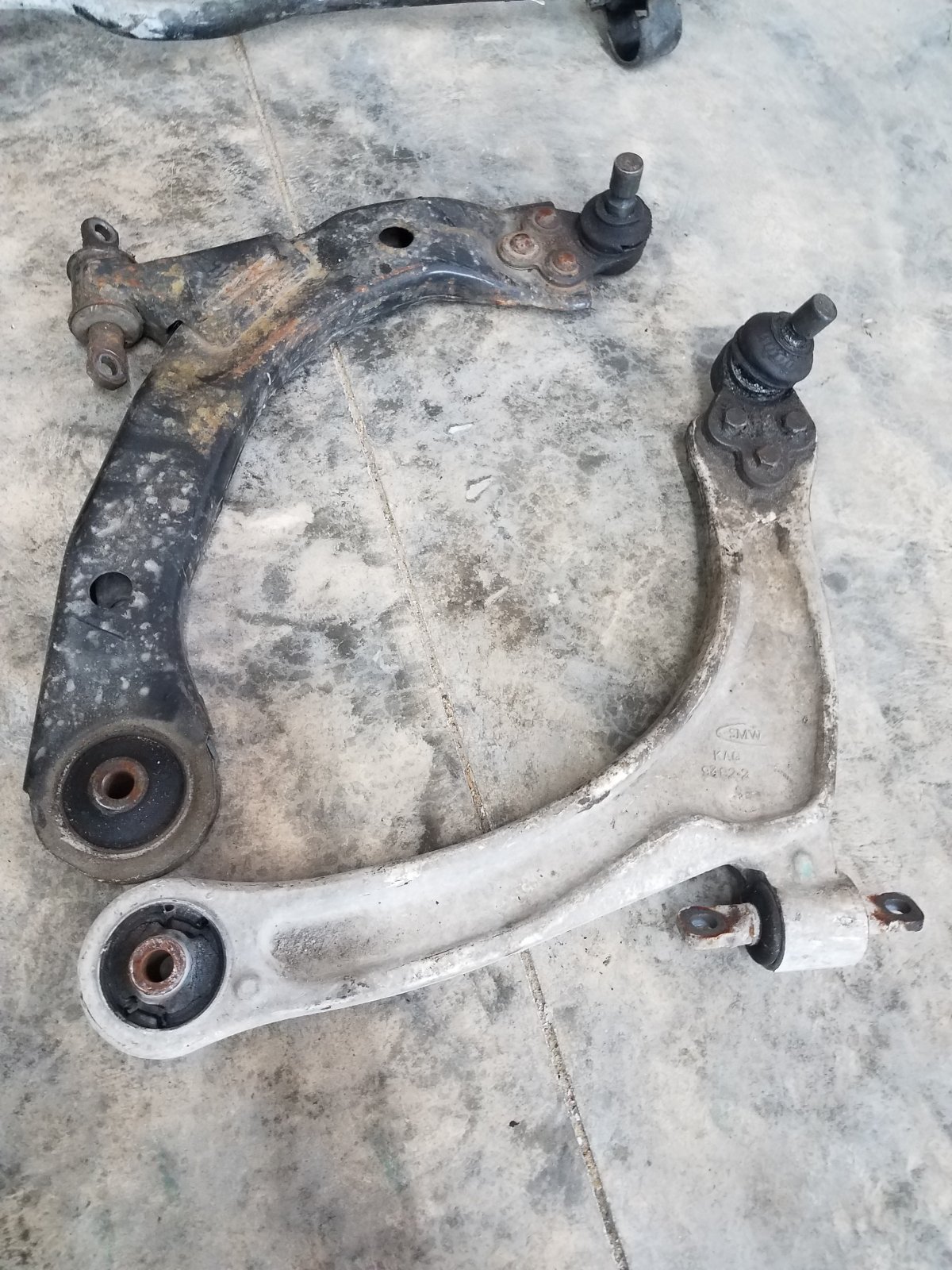

Also found another surprise - the control arms don't match. The passenger side was missing a fender, so I'm guessing this was a junkyard temporary replacement.

The control arms are fairly inexpensive (when compared to the overall build). Since you have a miss match, I would just replace them. Given your donor, they should have a 19.5mm ball joint stud which are very common.
That drain plug looks bad. Given the other damage to the tranny, it makes sense to replace.
