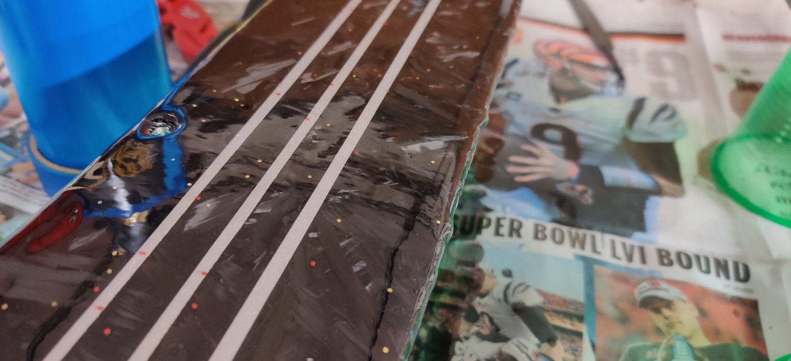

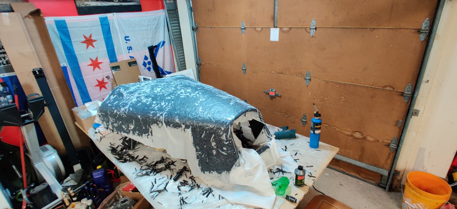

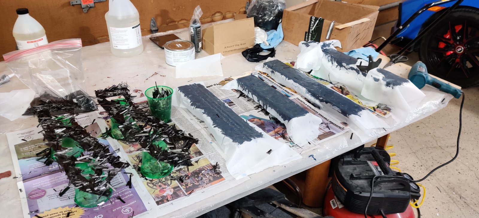

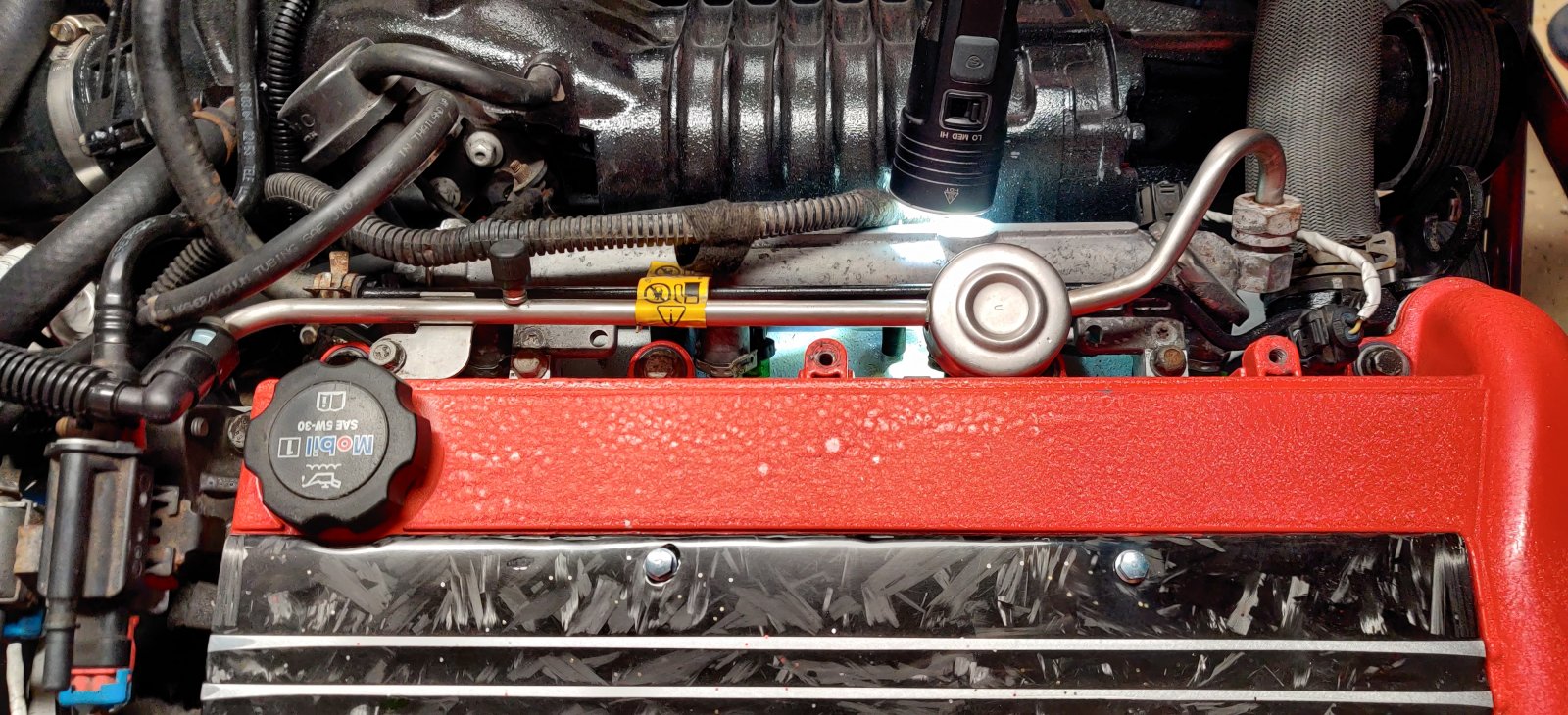

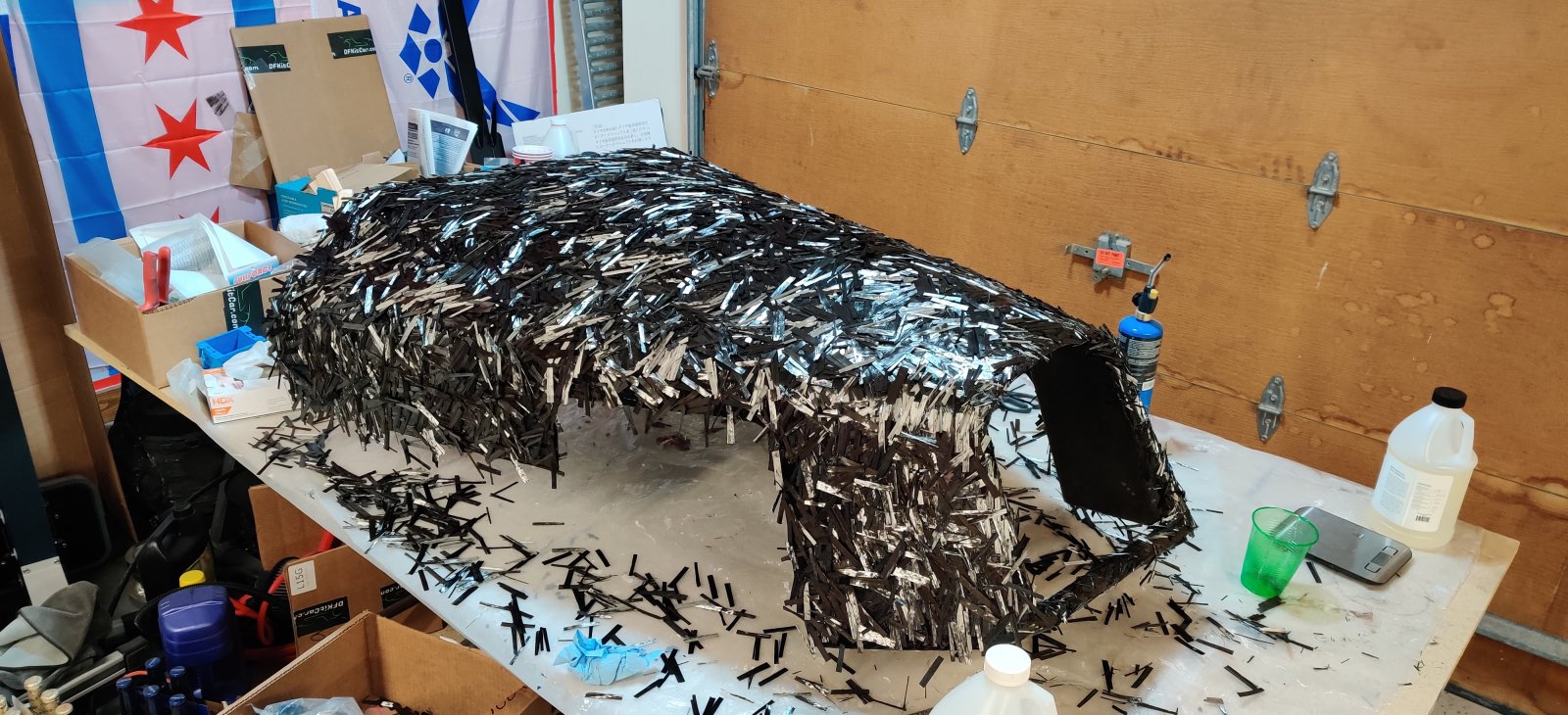

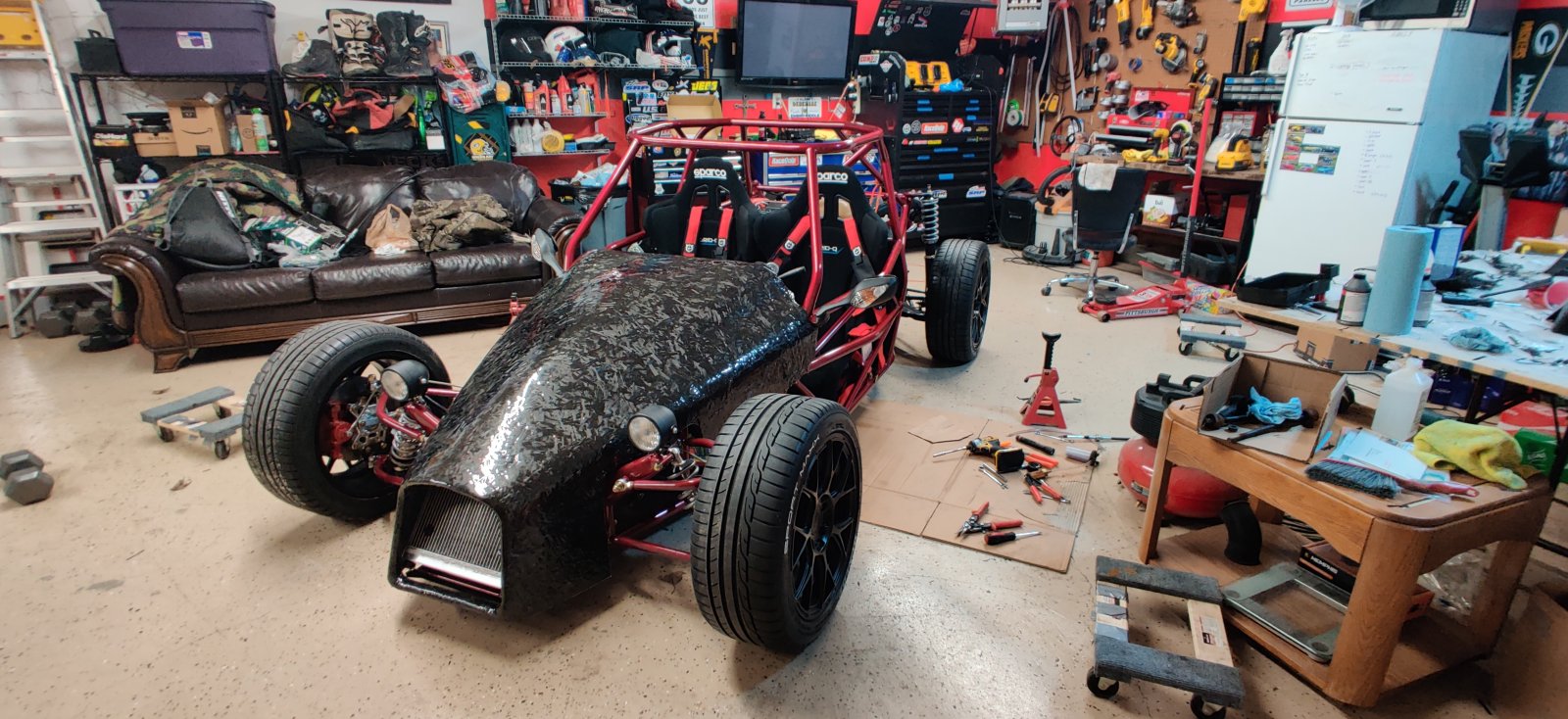

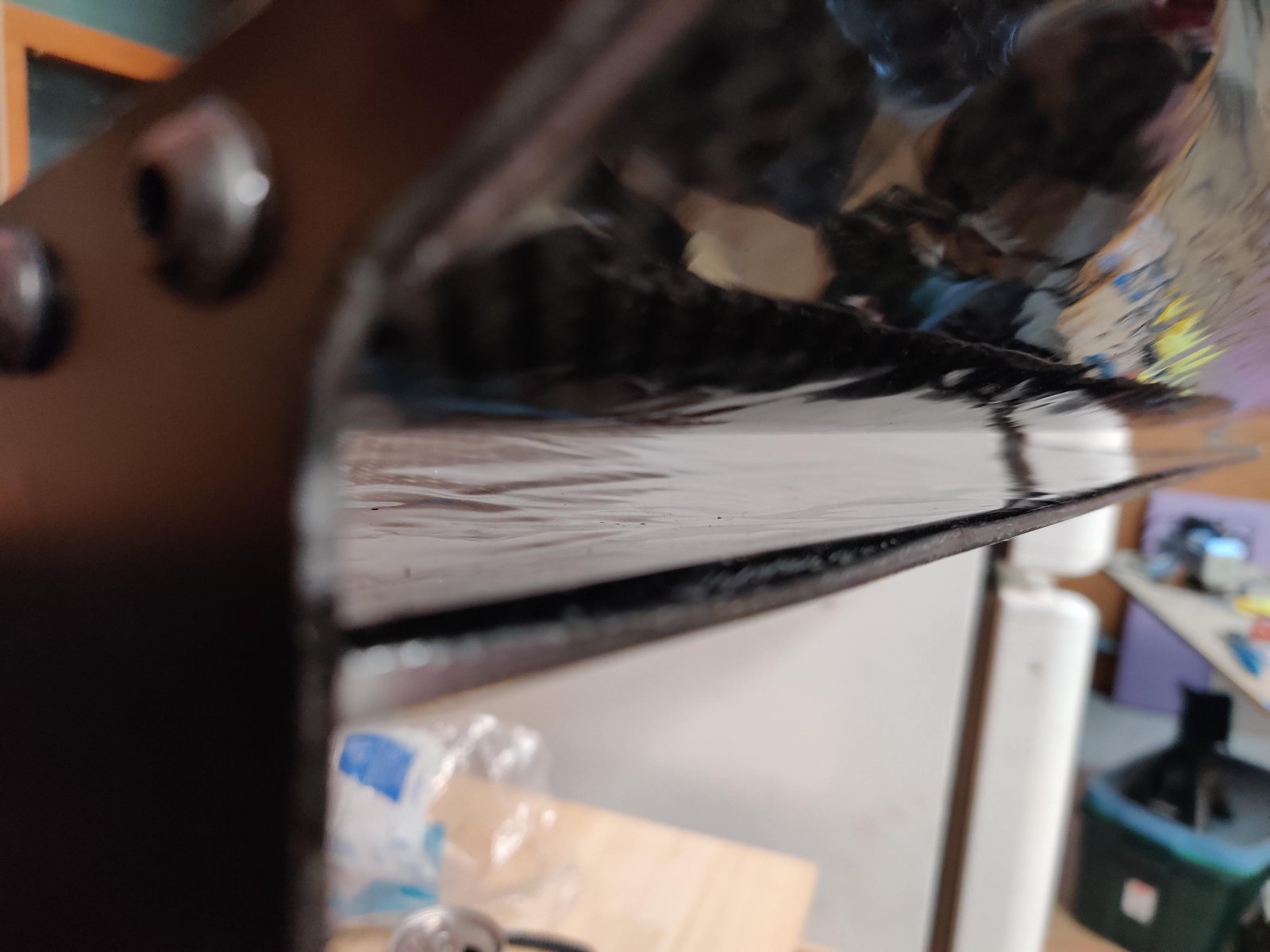

Need to finish up some bodywork next. Decided to not go the typical vinyl wrapping route and wanted something a little more exotic... "Forged" Carbon fiber skinning. Couple more sanding sessions and it'll be ready for clear coat, but the progress looks awesome so far.
Forged carbon looks amazing, but it is hard to capture in a picture. A video would do it more justice. What part am i looking at in your 4th picture? The pic with the blue tube in the backgroung.
jcdman
That's the coil pack cover!

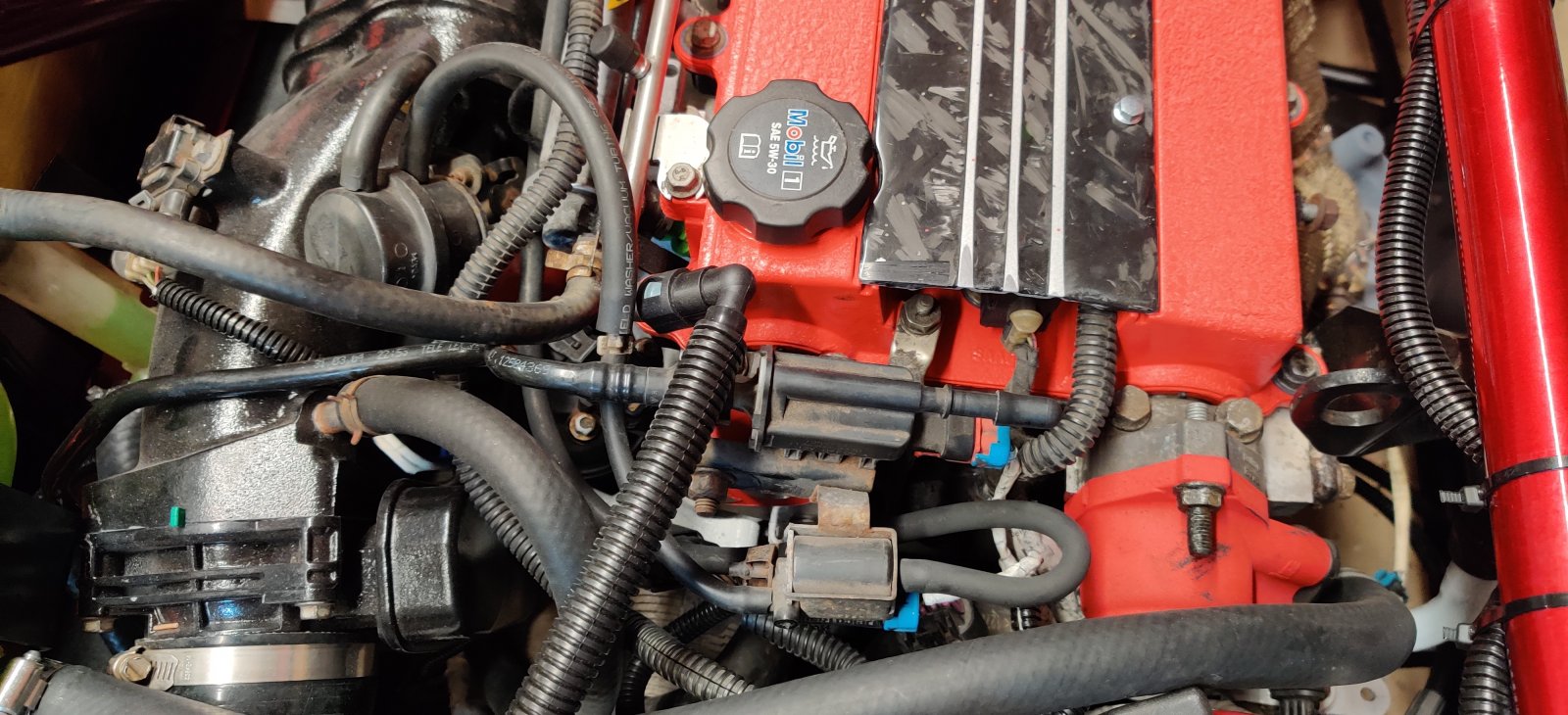

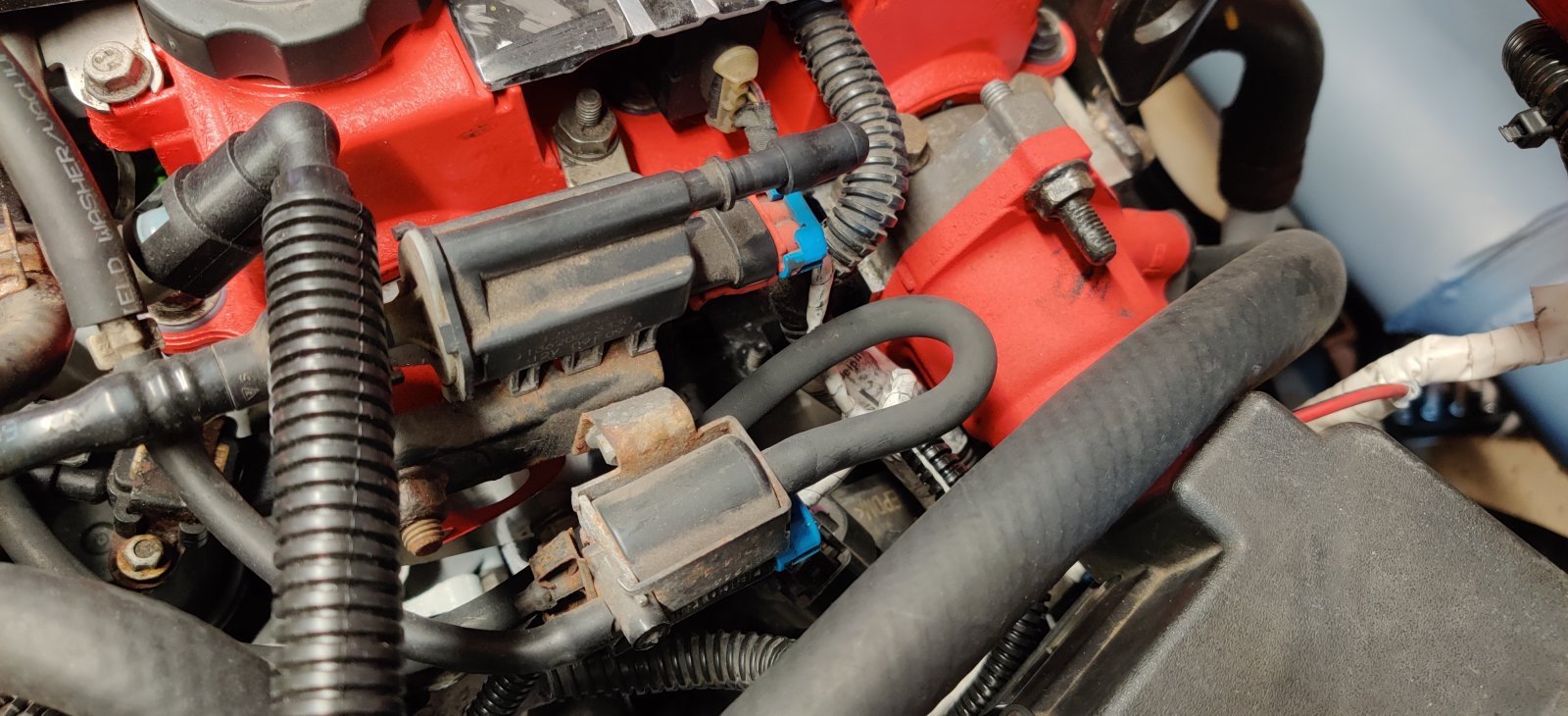

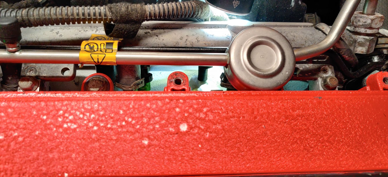

Went to bleed the coolant system, and the motor just doesn't have a very good idle, actually gets worse as it goes on and motor eventually stalls. Looks like the bypass valve in the supercharger keeps opening and closing. Possible I don't have that system setup correctly. Can someone check my setup?
Top valve I capped off, was told that was for the evap system. Maybe I just need that to vent to atmosphere?
Rear side of the boost solenoid hose loops around and is plumbed onto the intake manifold nipple. Other side goes to the boost actuator (bottom).

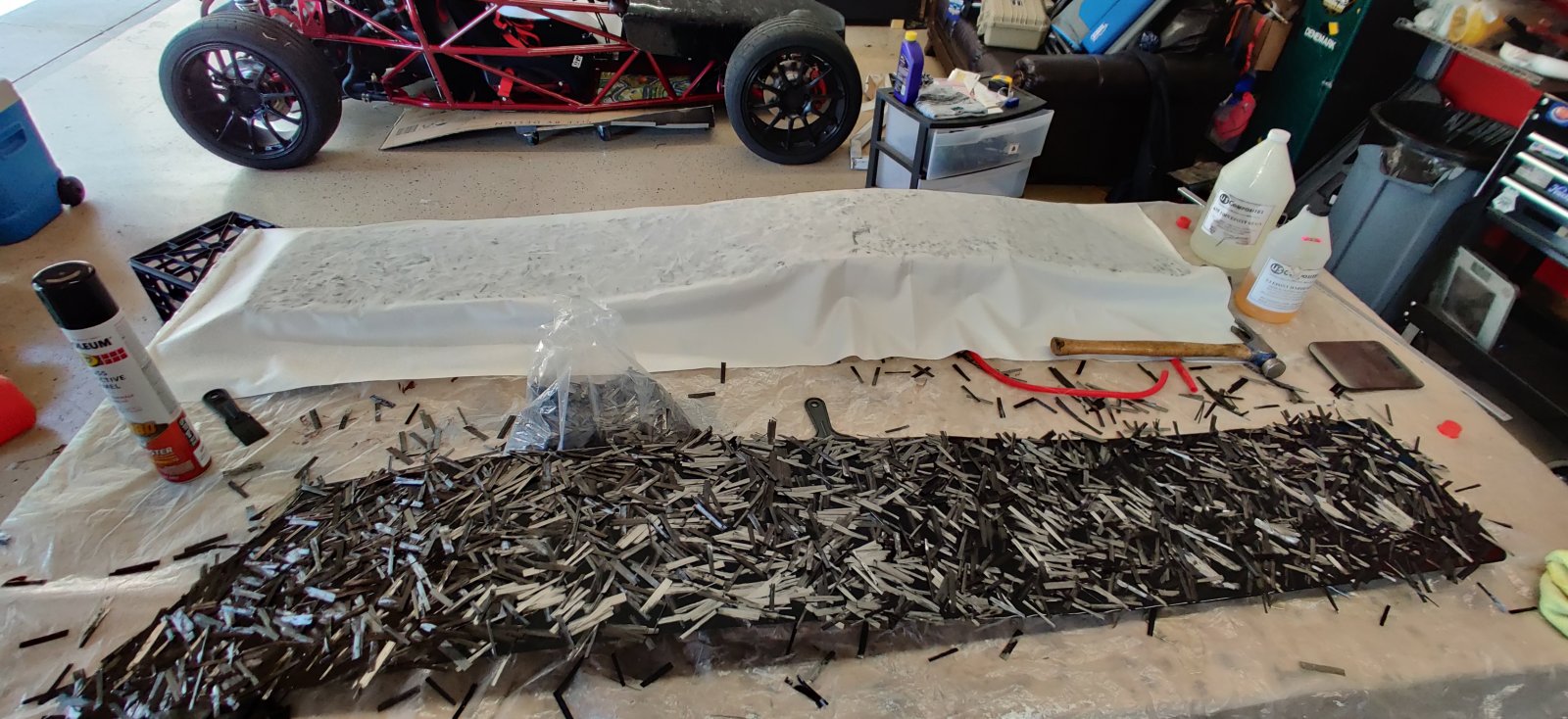

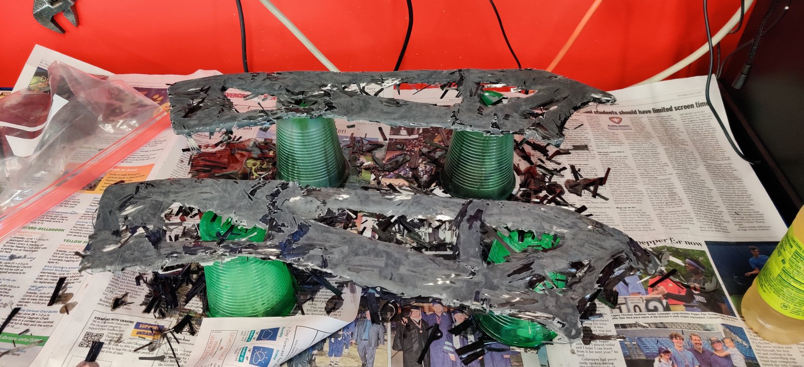

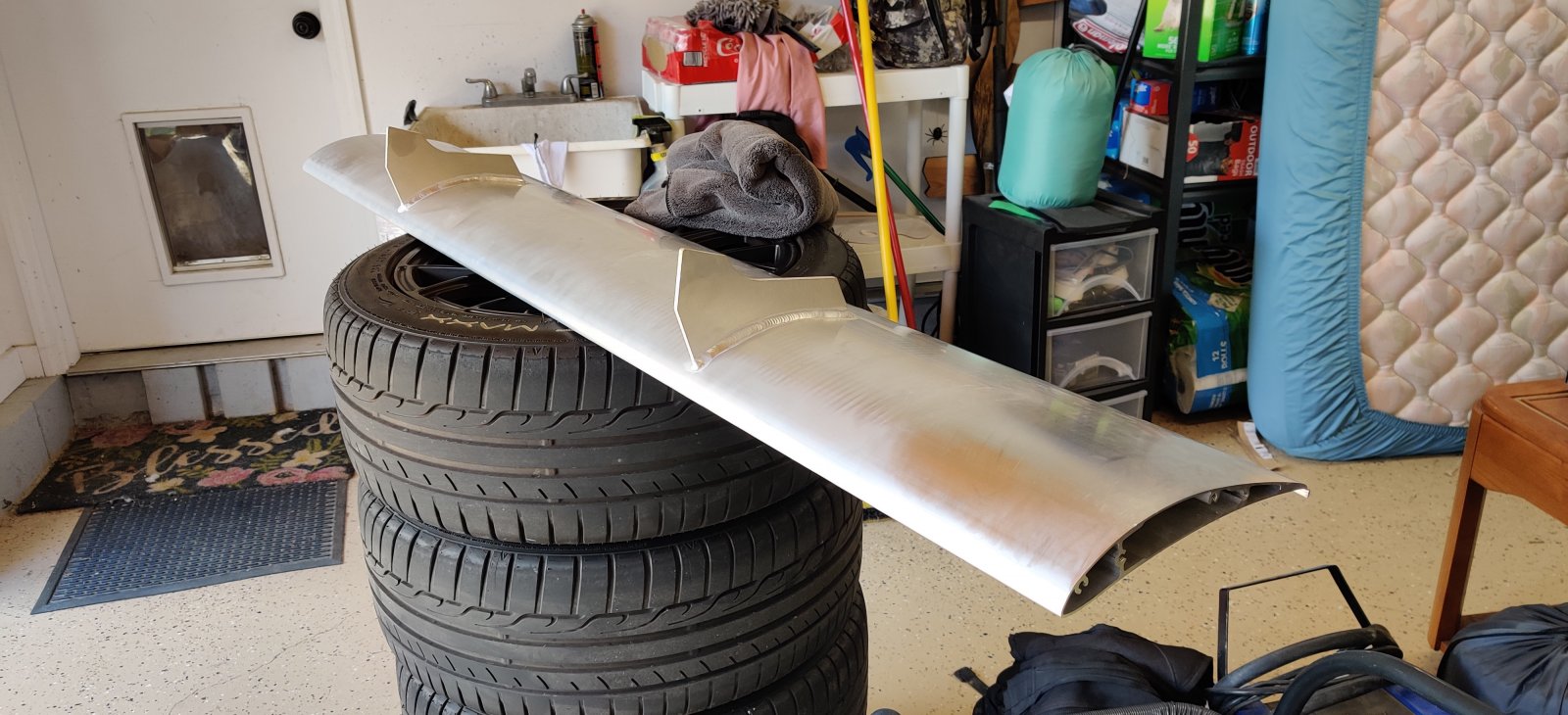

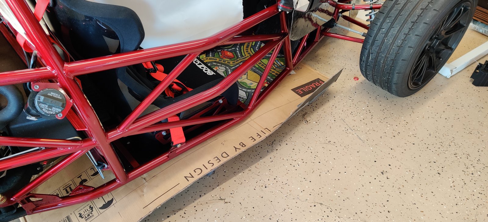

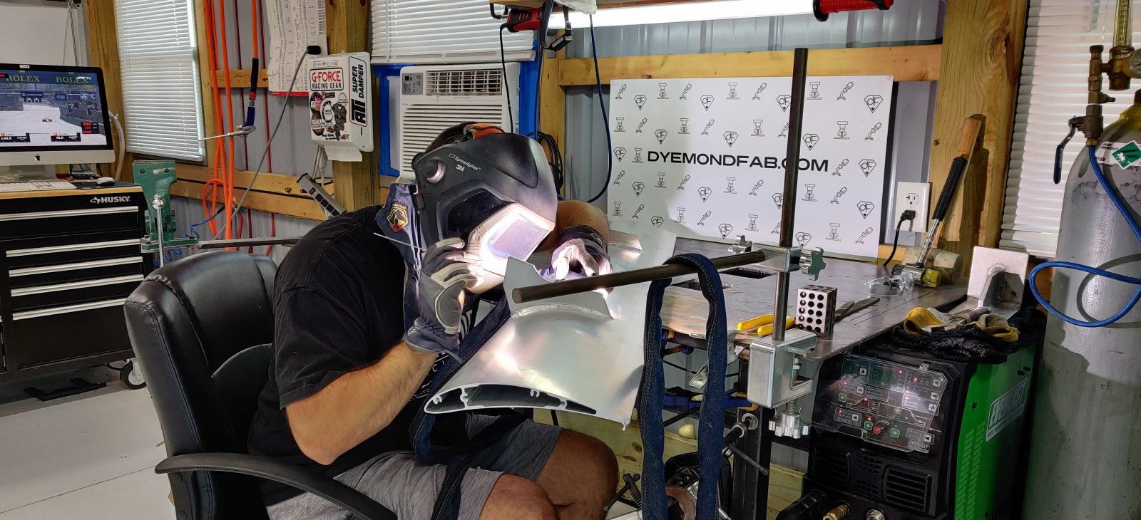

Working on getting the wing mounts and side panels carbon forged. Recently ordered the 60" wing logic aluminum extrusion wing and pretty happy with the quality! Mounts were welded on this morning by Dyemond Fab.

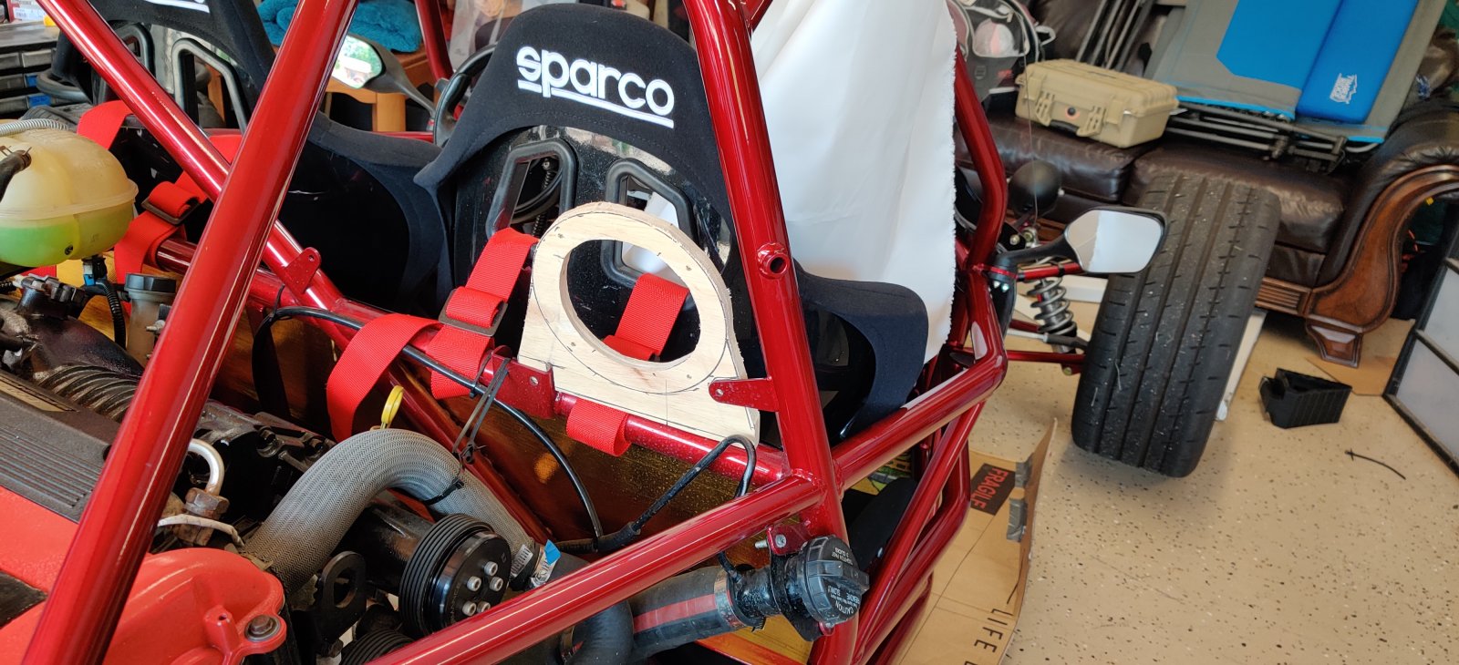

Mocking up some side skirts and forward firing speakers right behind the drivers seat.

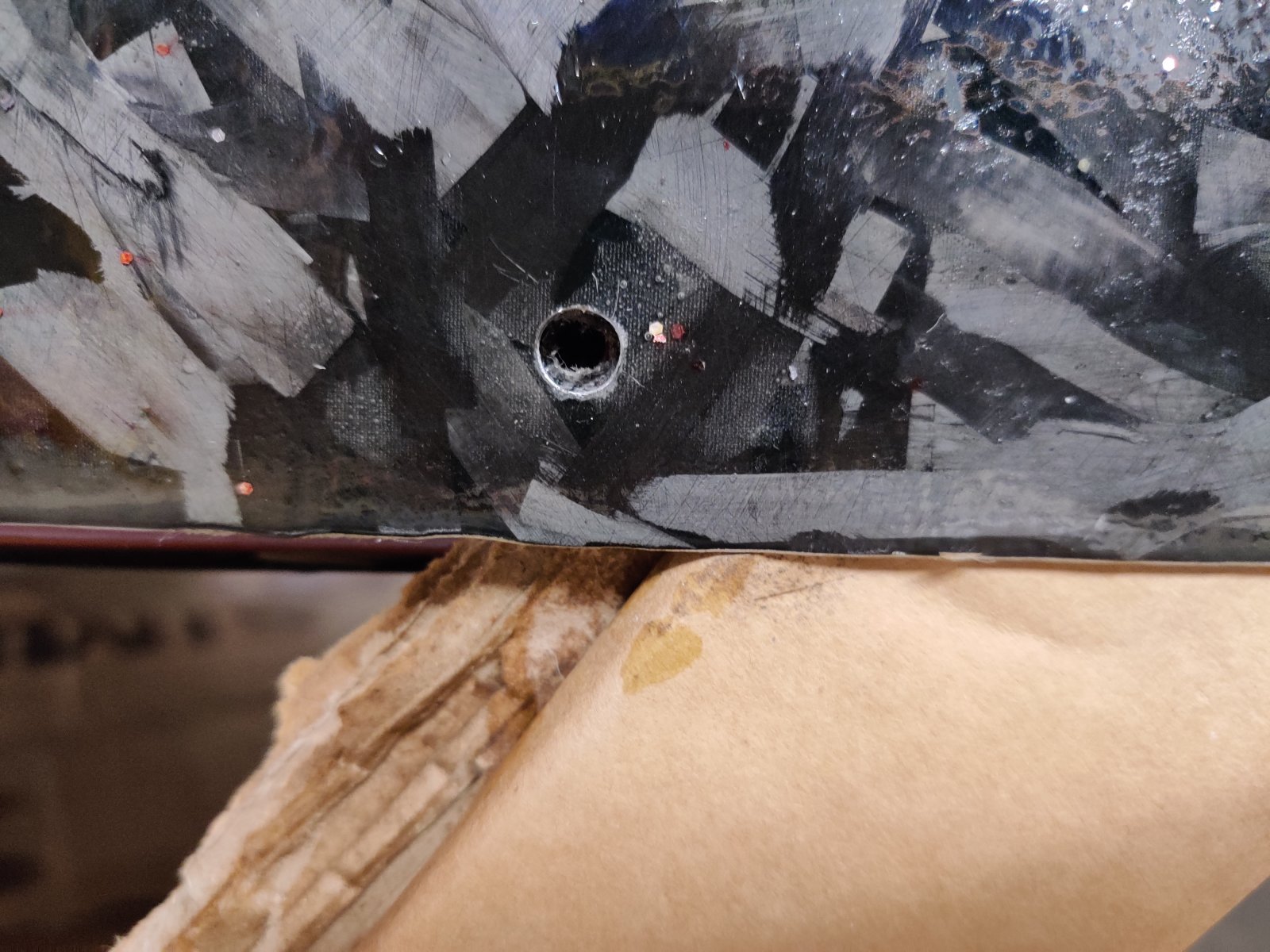

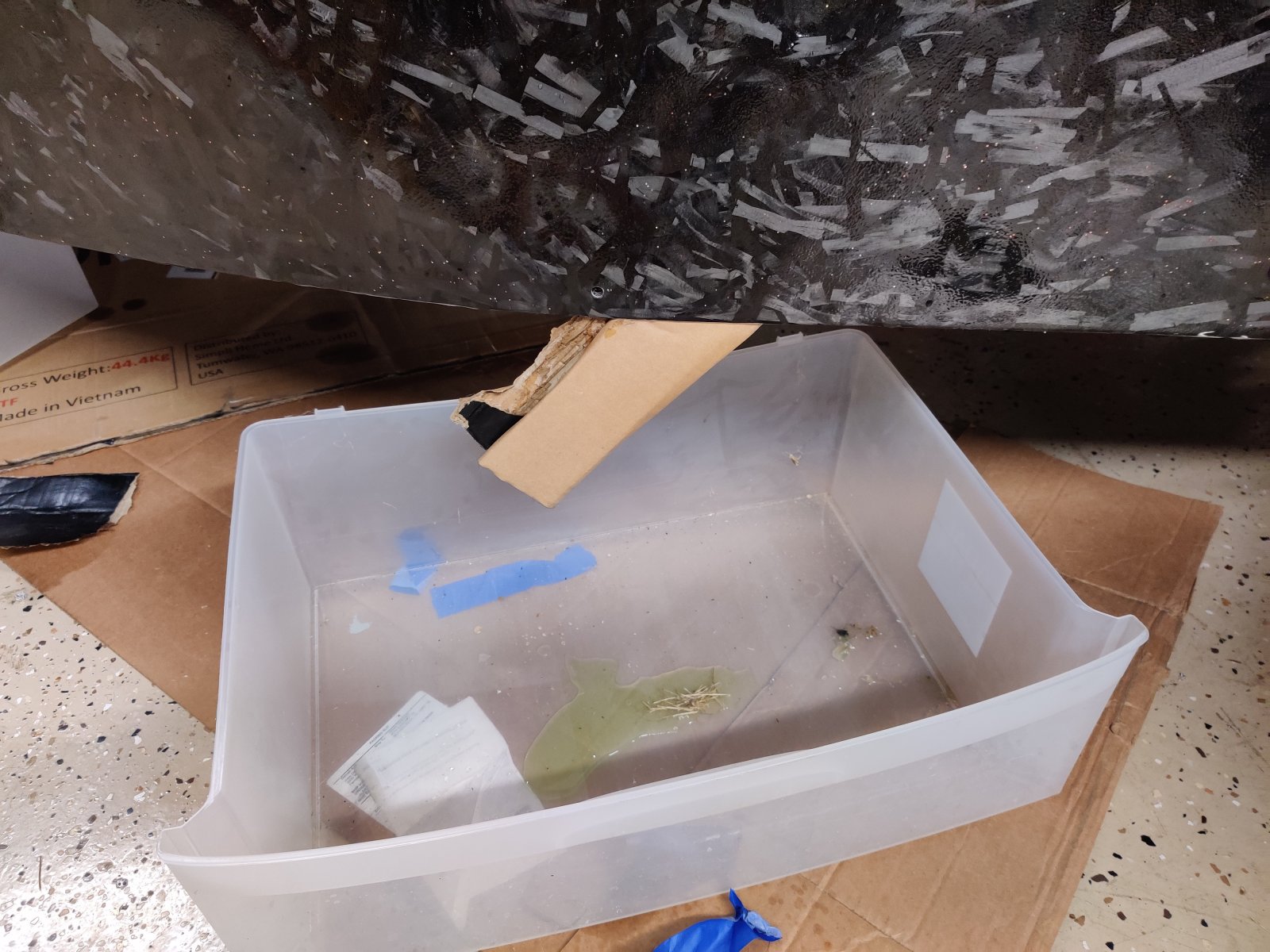

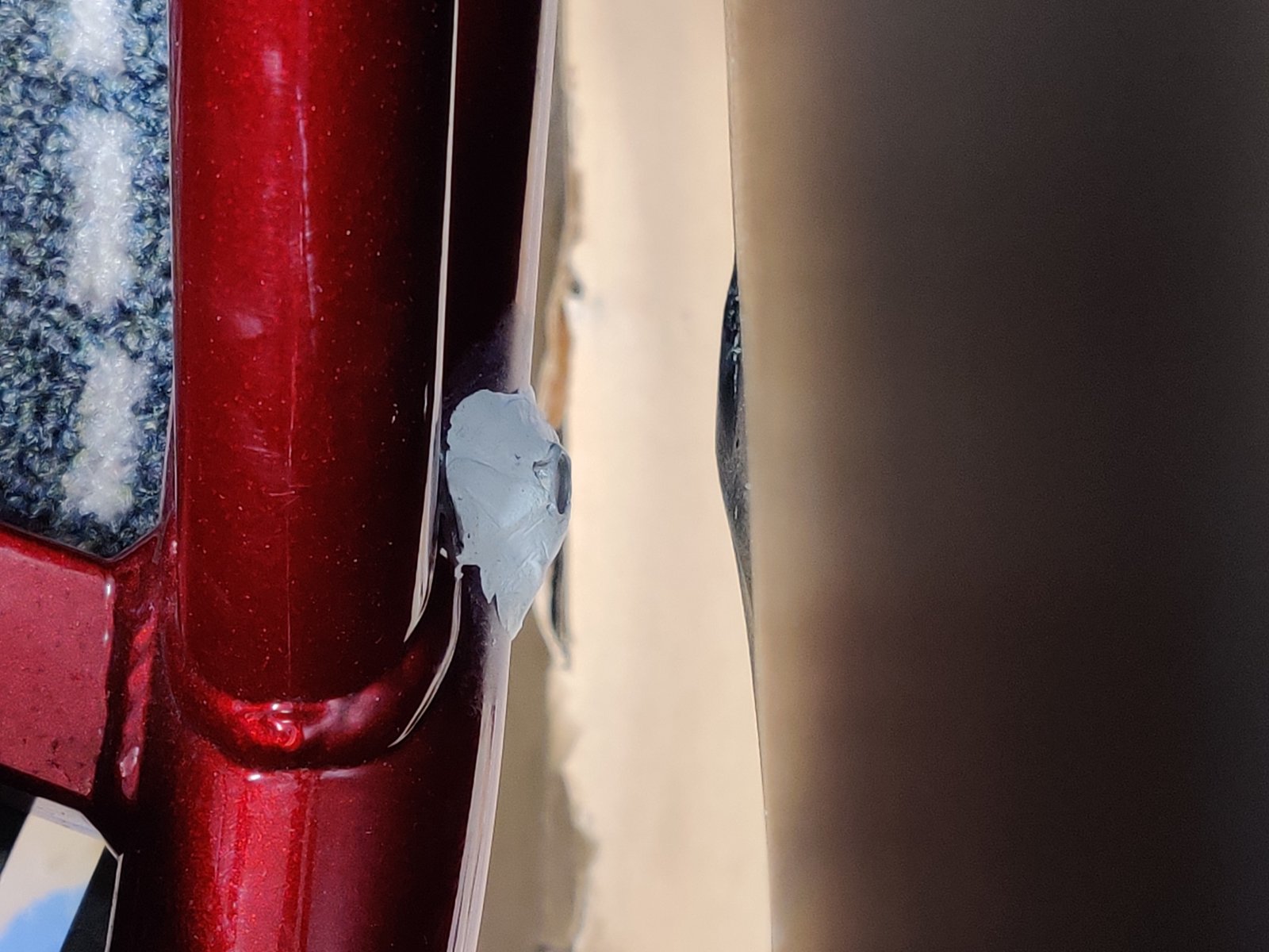

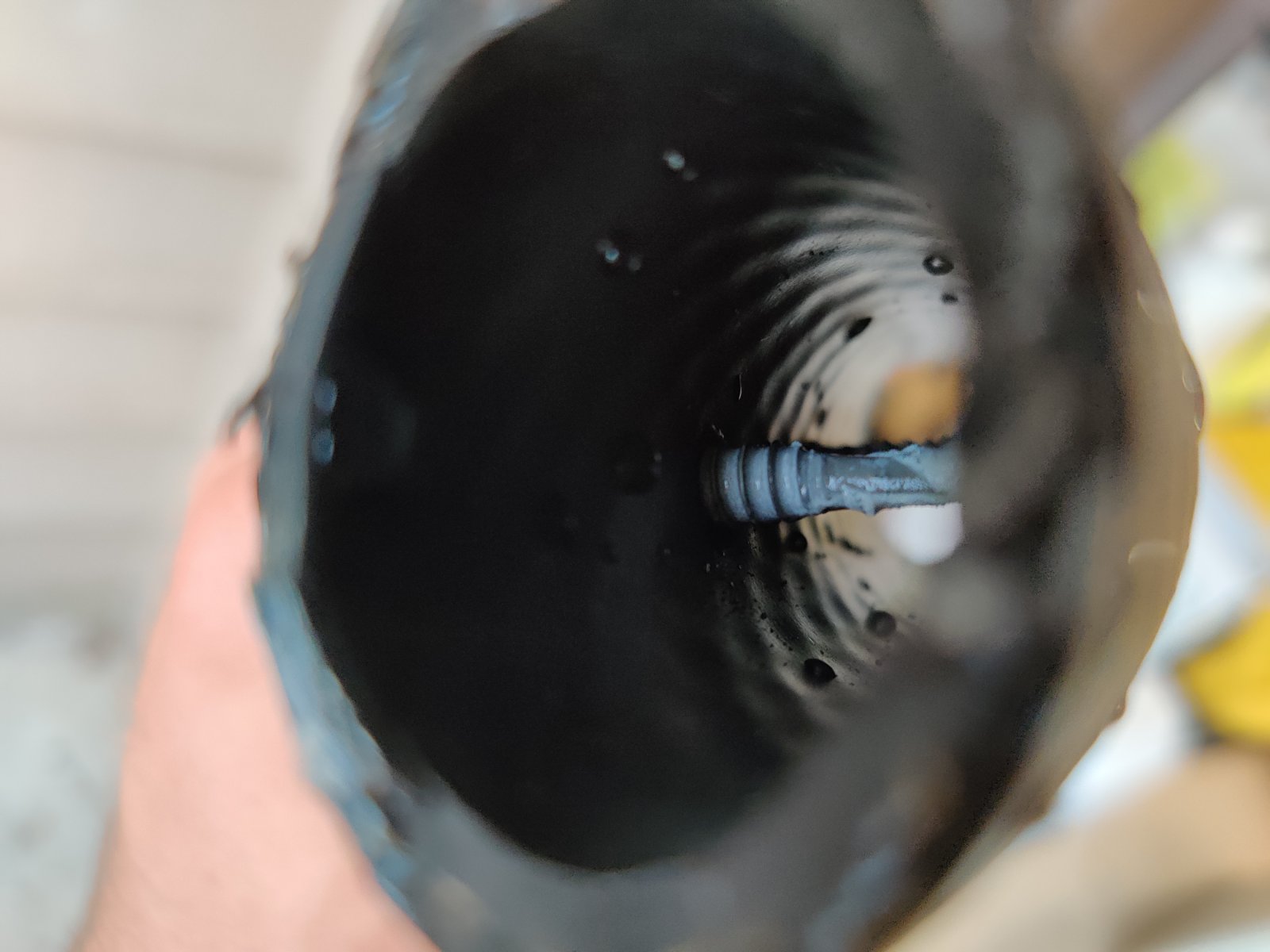

Word to the wise, follow the pre drilled holes on the side panels, unless you wanna punch a hole in your coolant tube the night before a car show... Home Depot opens at 6am and JB water weld cures in an hour, maybe I'll be able to patch this up temporarily in time.
jcdman
Made the show! JB weld saves the day. Made a test piece to see if the concept would work and that held together great. Fully cured in an hour, ran it to operating temp and pressure tested no problem. Add to the list of things to fix over winter.

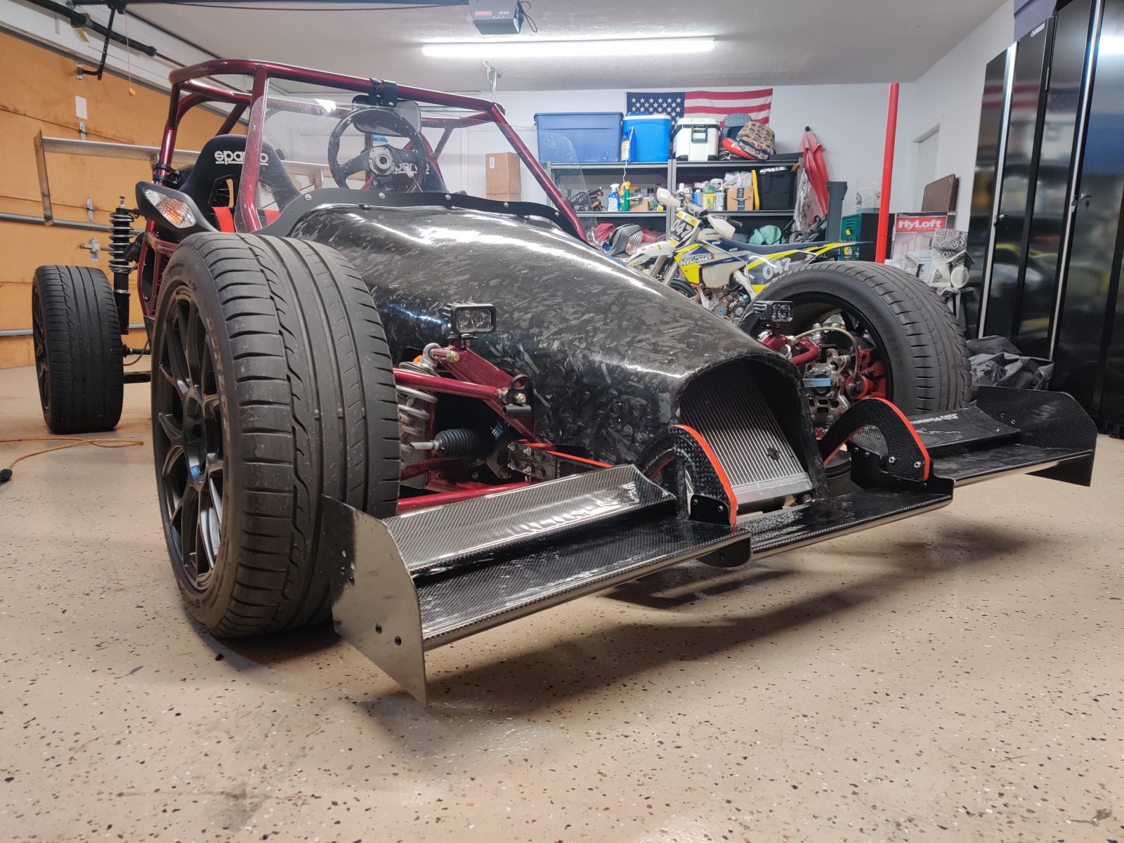

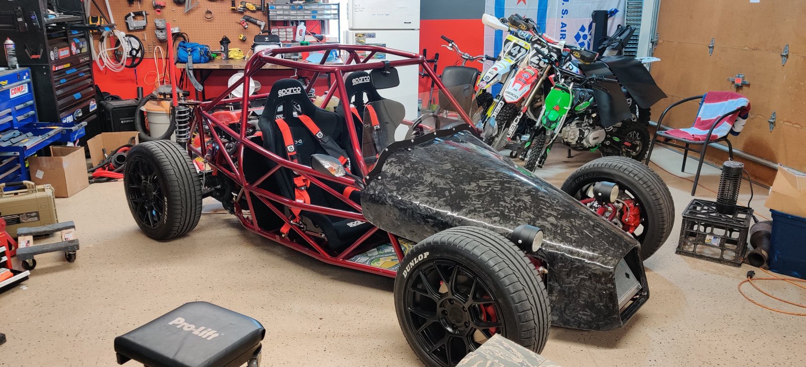

Been working on something pretty exciting over the last 6 months. Here's a sneak peak, should be on the car tomorrow!
