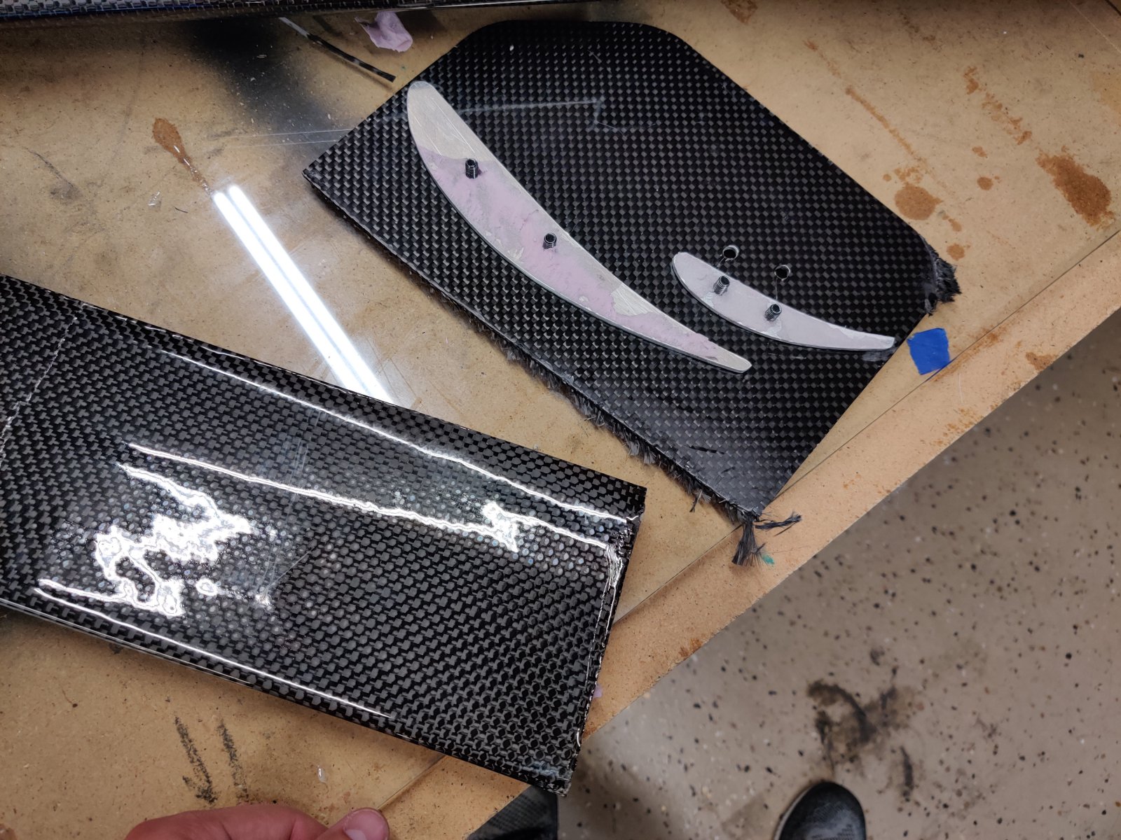

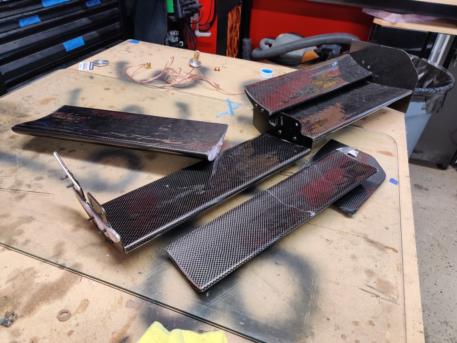

Well, the 6 month prototype lasted 6 minutes... back to the drawing board haha.

Tire clearance is tight but it did clear. Both this and the rear wing are adjustable, and I plan on just running a front wing at autocross type events so lower to mod speed environments <65mph. Alignment is something to consider but difficult to tune on the road.
Sorry to see all of your hard work in pieces.
Just have variable sized weights to push on the front end while checking the alignment - suggestion: kid - 50lbs, supermodel -100lbs, jockey - 150lbs, normal American male - 200lbs, sasquatch -250lbs (ok, a small squatch). It would take some time to accomplish but would probably be worth doing if you plan to have significant downforce on the front end. :D

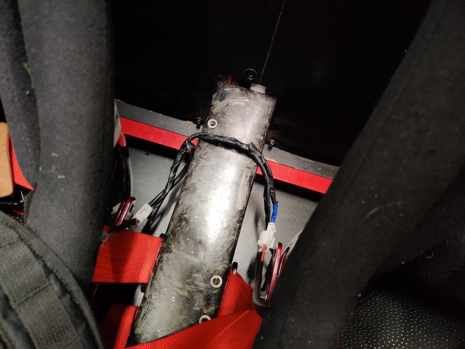

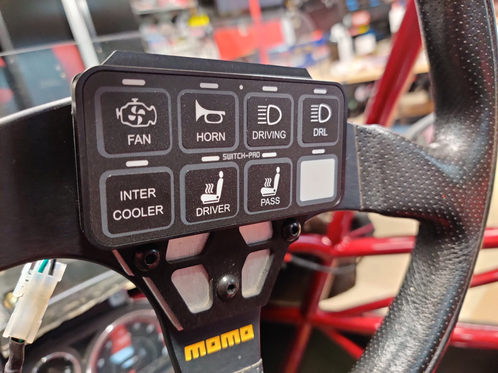

On the plus side, my new heated seats work great! Now to clean up the install
