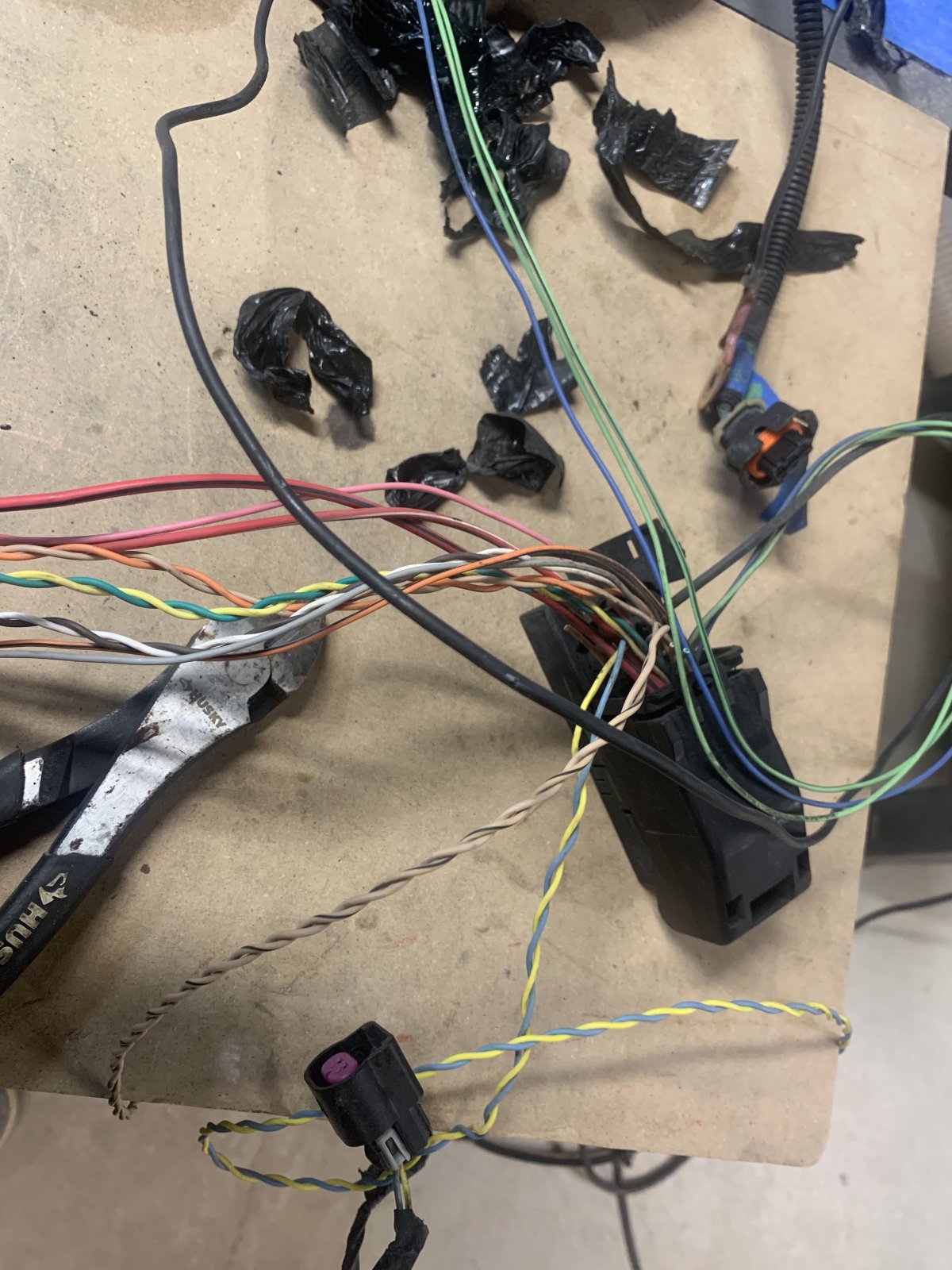

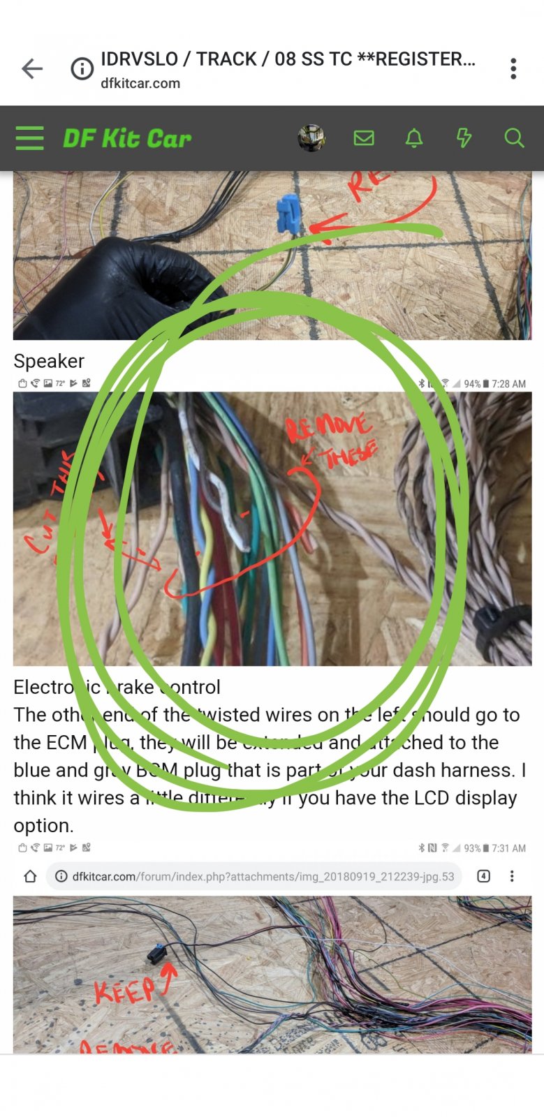

Hi guys I know I have quickly gone over this a few months ago but I just want to clarify that I understand. I already cut the brown twisted wire that goes to the other ECM plug and rolled it up. Left, would be these wires. Do I cut the plug off and trace all the wires back and remove them? That’s my understanding. There is also those green wires that go to a plug that came out of the brake booster. Rid of those also? Thanks for the help in advance!

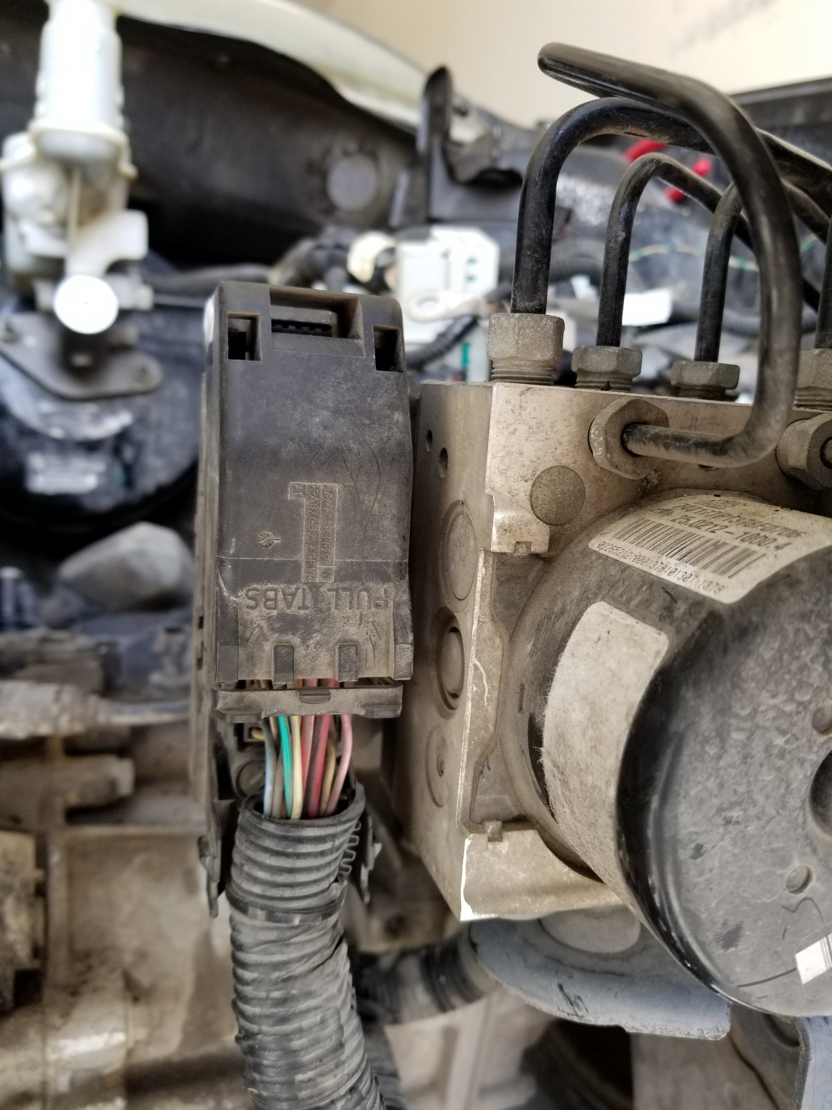

HELP! I've gotten to the ABS module and cannot determine how to remove the electrical harness connector (intact) from the module. I'm sure there is a trick to this, but I cannot see any obvious locking mechanism that needs to be tripped to get it off.

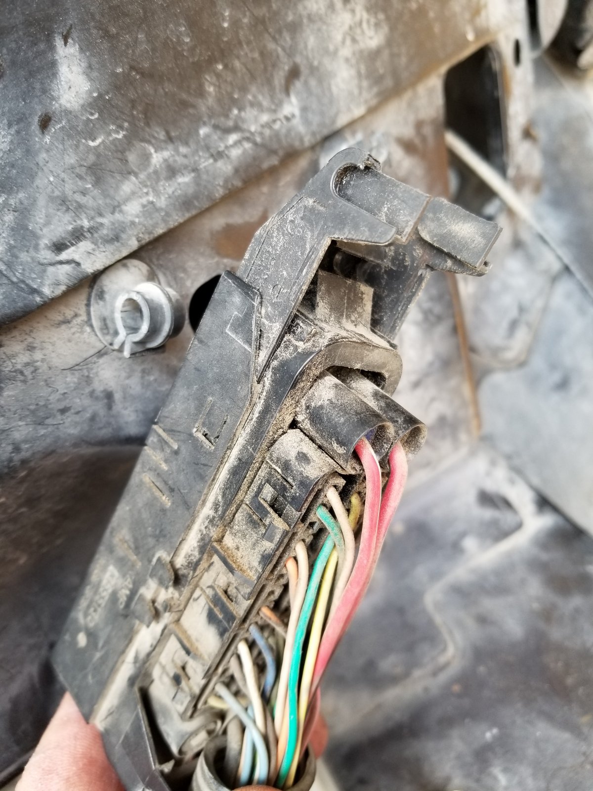

UPDATE: got it. I removed the cover and found tabs on the cover that pull up and slides out of the sides of the connector. In the photo the tabs are shown extended above the connector. Hopefully this will help someone in the future.
