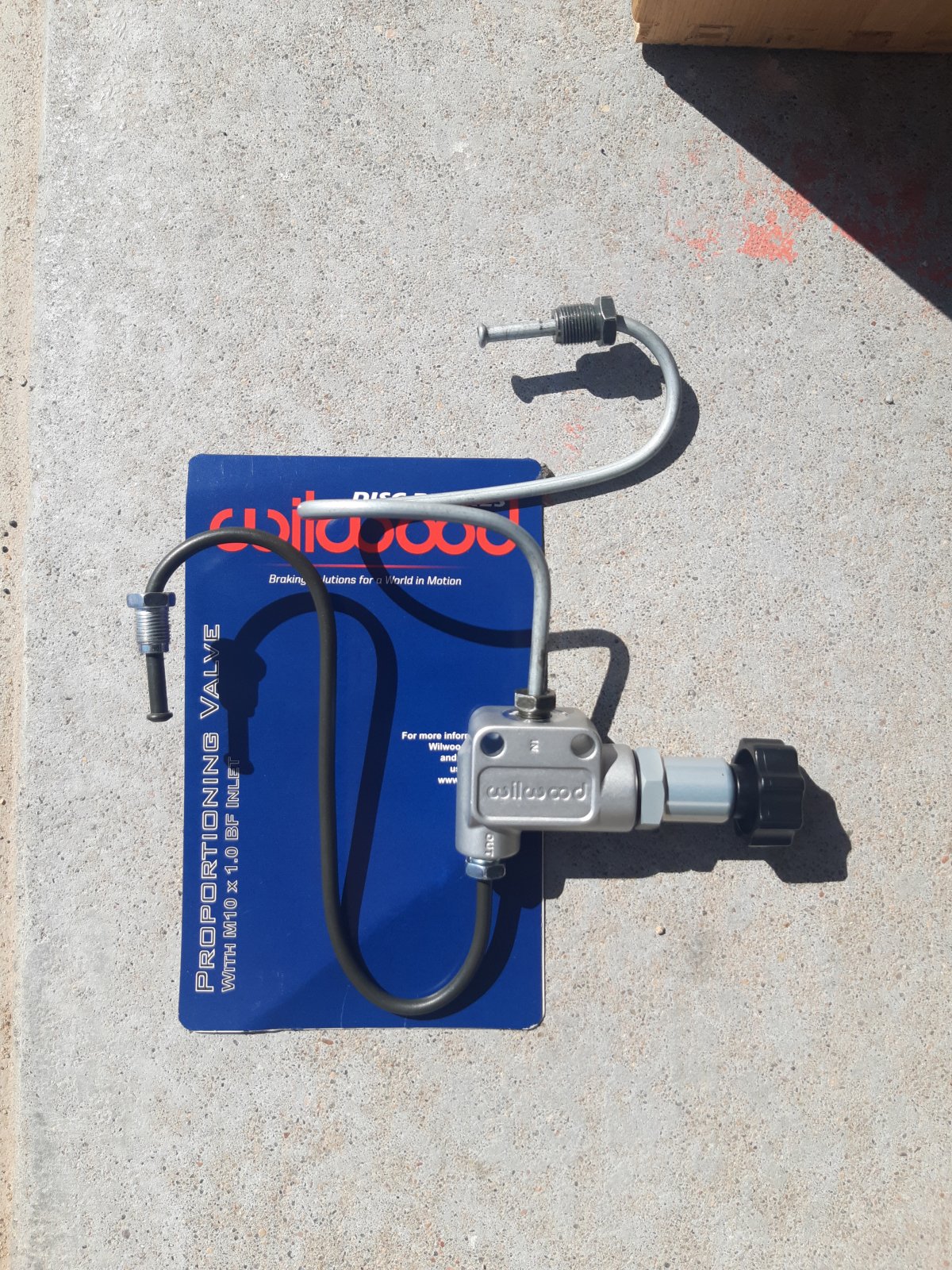

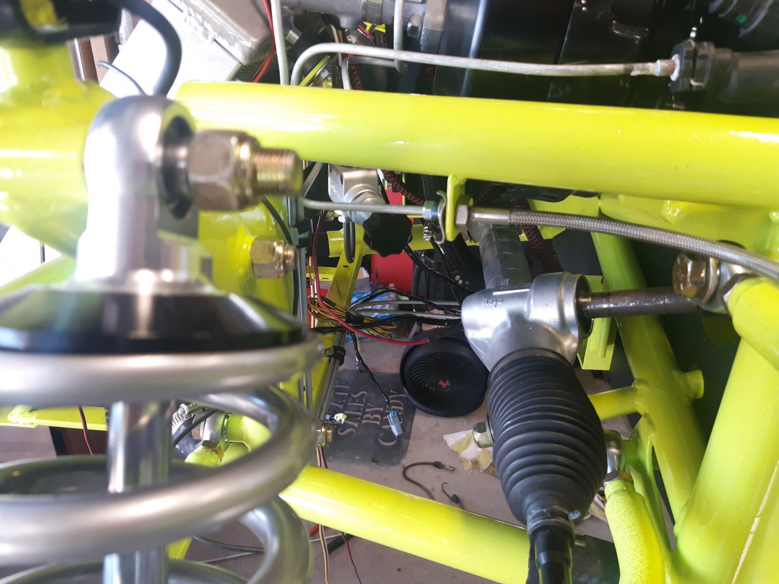

Added a proportioning valve. Like many I did not wish to purchase a bubble flare tool for a single use and could not locate one for rental or to borrow. Purchased a 12 in line (CNE-312) and bent the existing line and new line as shown. Valve is hidden but adjustable without raising the hood and the plumbing was only 6 bucks.View attachment 27140View attachment 27141
Great idea buying an off the shelf item instead of making a new line!
It’s been over a year since I added my brake proportioning valve and to tell you the truth, I have pretty much set it and forgot about it. 12 autocross or so and it performs exactly how I want it too.

I finally got around to installing mine. Like a fool, I don't have any pictures (I'll try to get some), but I mounted the valve where it can be easily reached through the driver's suspension, just behind the radiator. Maximum restriction (and therefore less front brakes) is with the valve all the way out, and I went 2 turns in from that.
I think it's just luck, but the brakes seem perfectly balanced with that setup. The rear starts chirping a bit, and then the fronts lock, which tells me they are pretty close. I will probably turn the knob in another turn, so the fronts lock just a bit earlier. Obviously I want balanced braking, but I also don't want the rears locking first and putting me in the ditch. A little safety is necessary.
