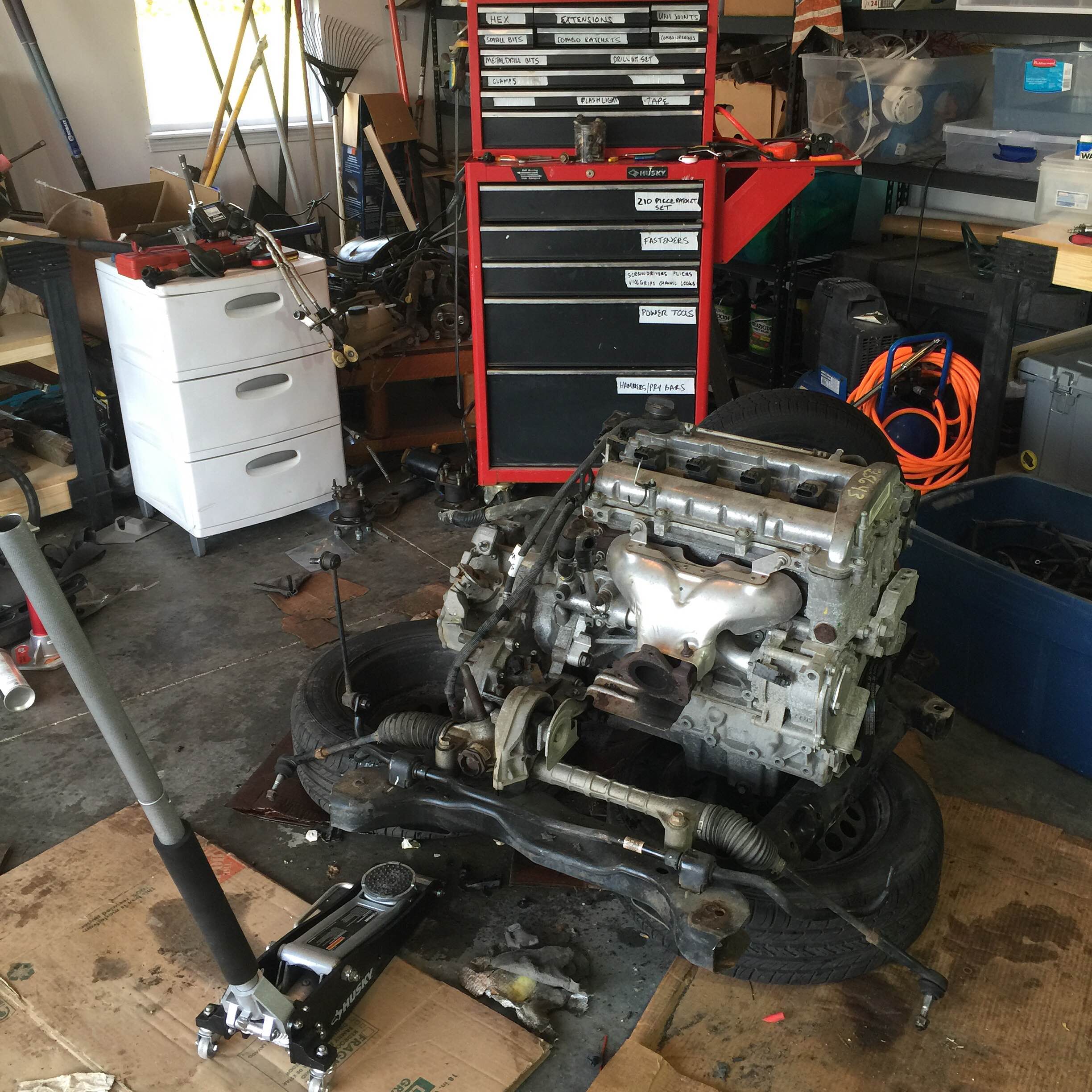

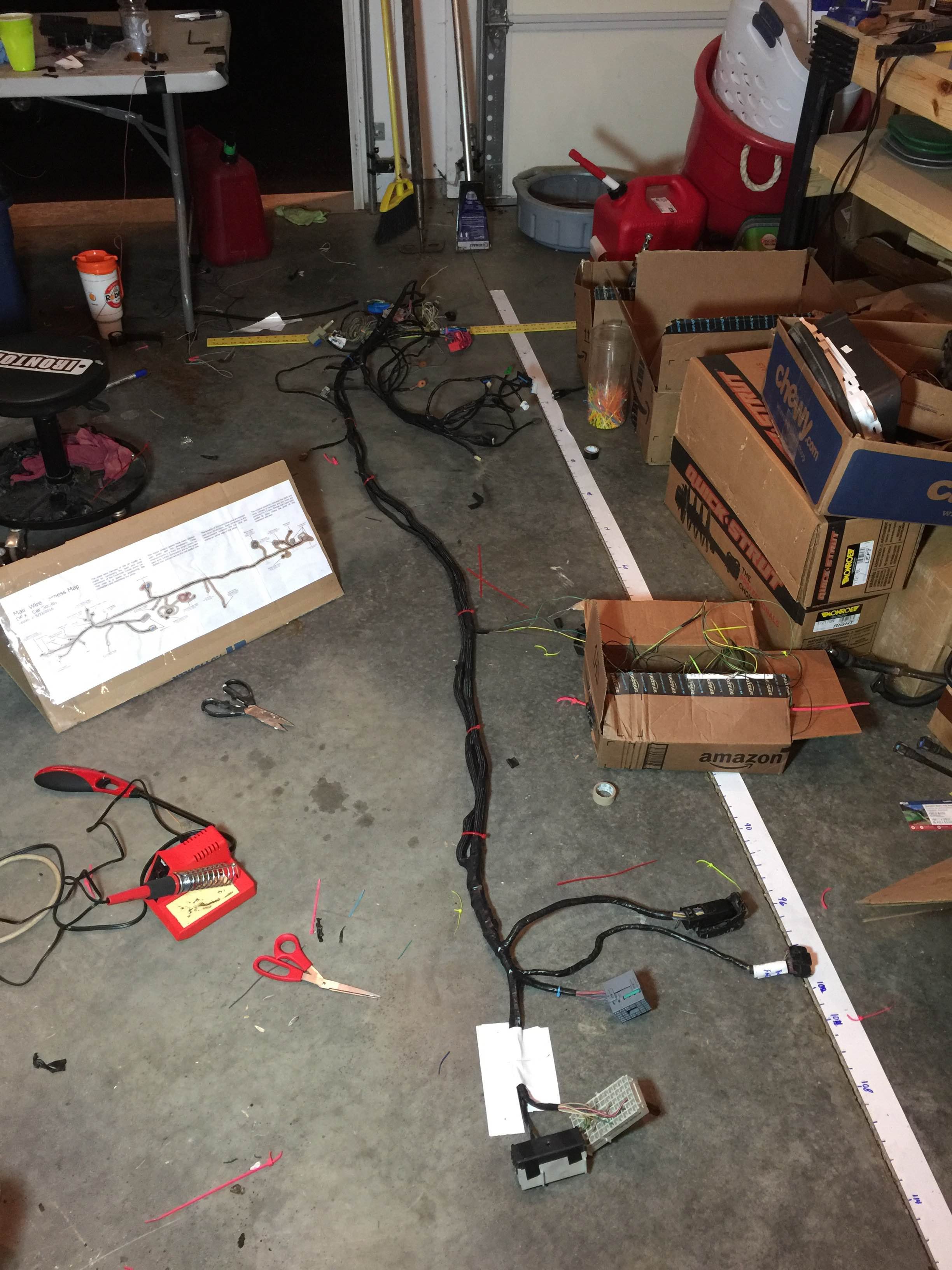

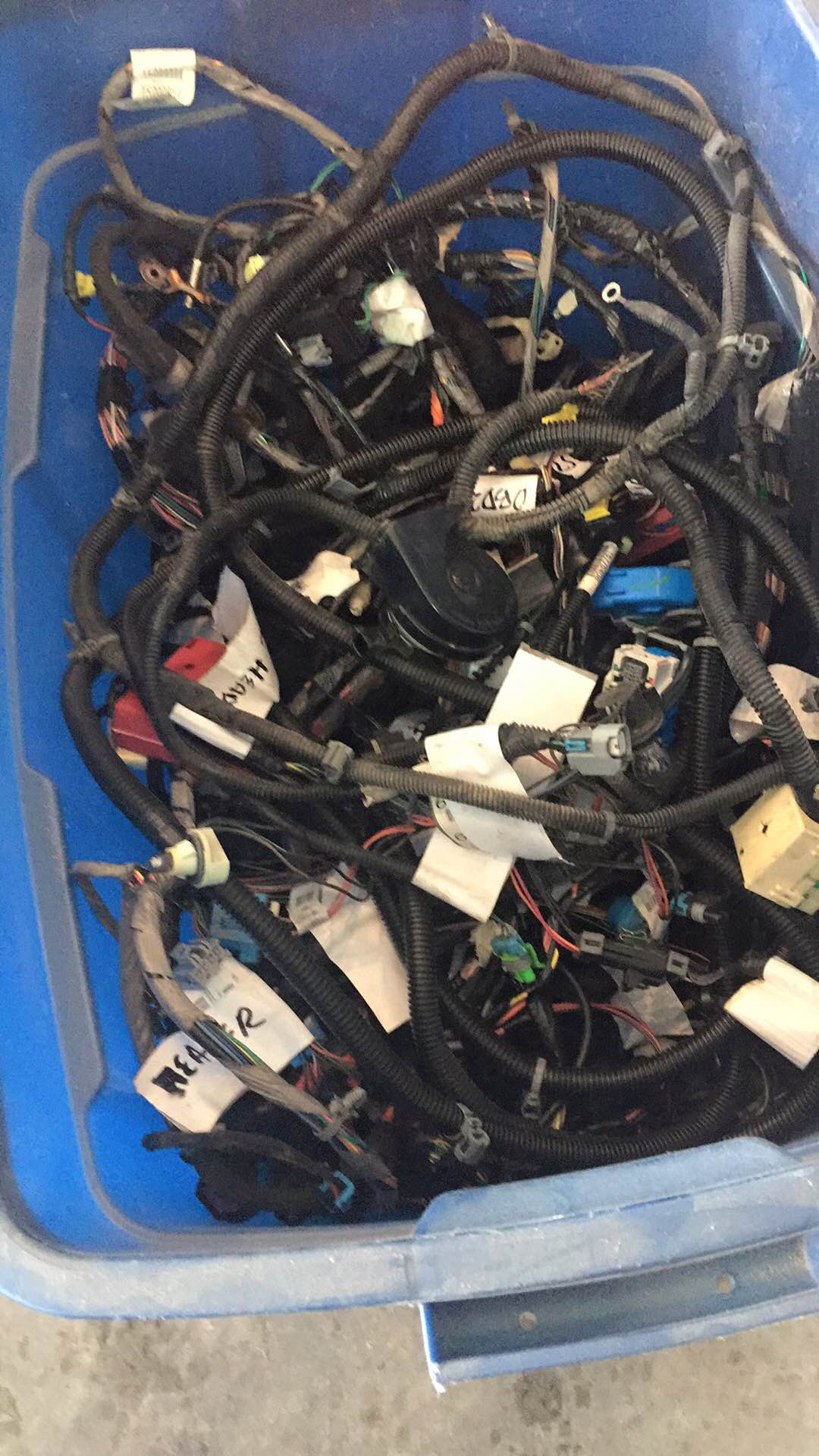

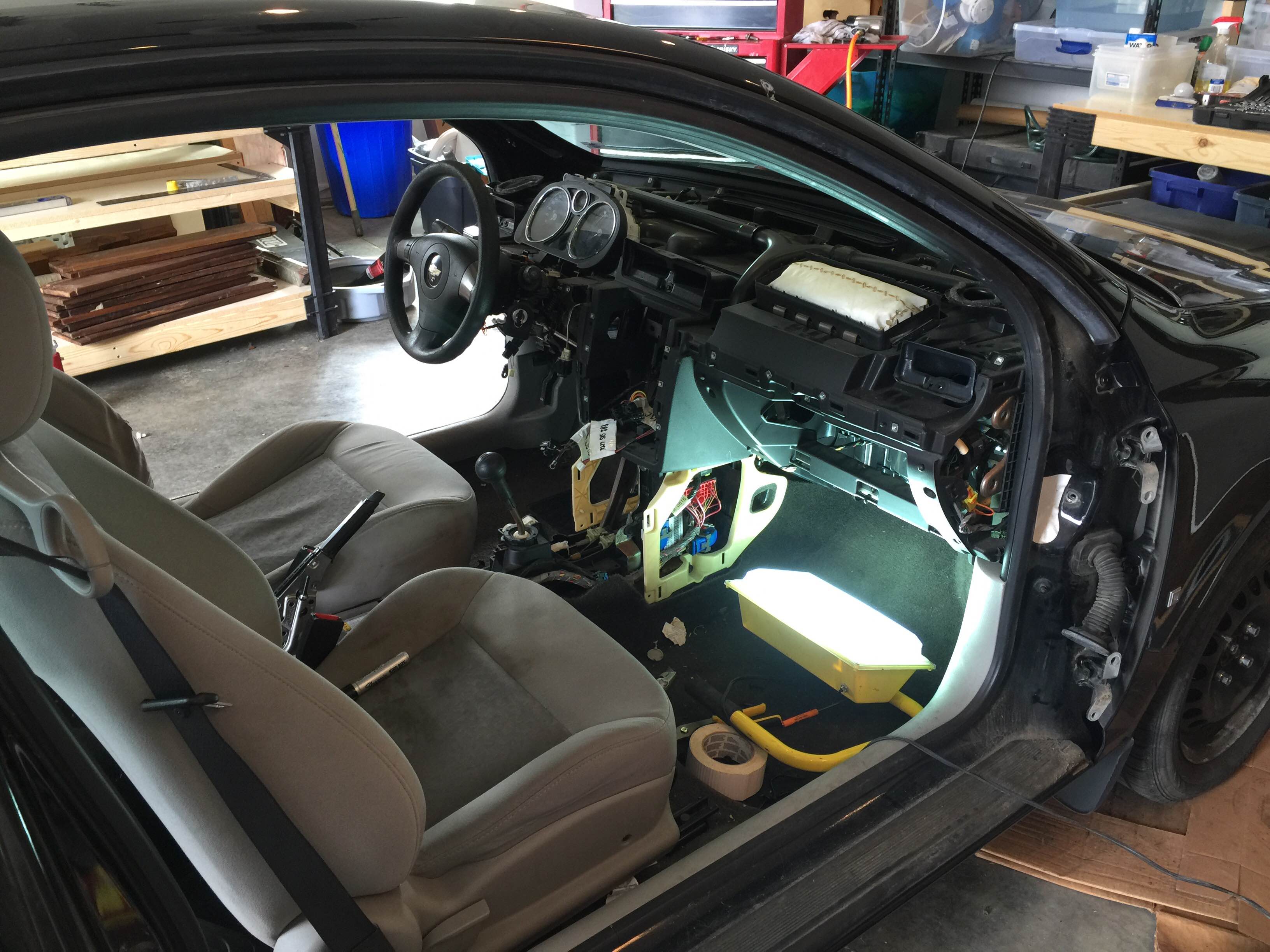

smithvmi
Donor car disassembly is complete.
Not looking forward to the wiring harness. I was considering a painless performance custom harness.
http://www.painlessperformance.com/webcat/10308
Any thoughts?
smithvmi
While the car was on jacks I placed tires under the subframe with the engine/tranny still attached. I then removed the engine mount bolts and put the rear of the car on an engine hoist and lifted the front of the car over the engine (with assistance of course) and rolled the body away.
Redneck engineering can't be beat!

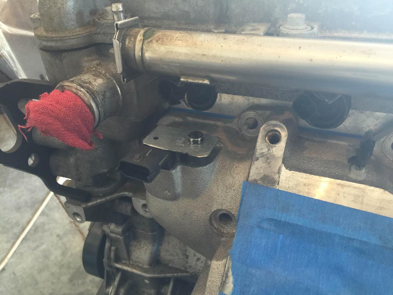

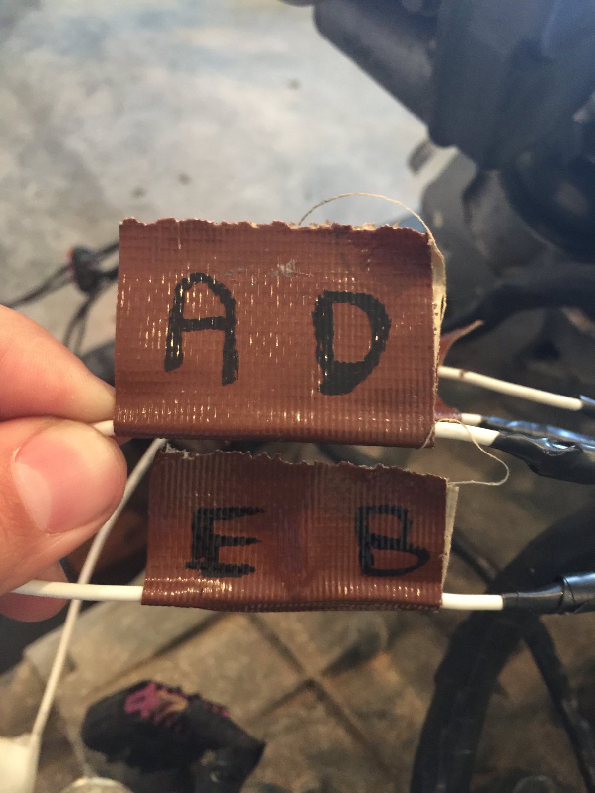

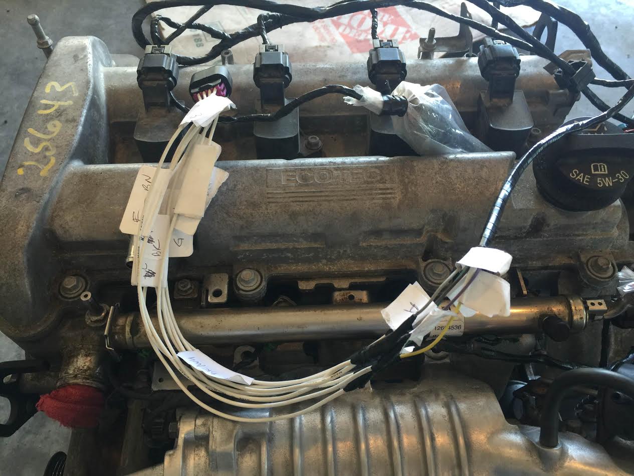

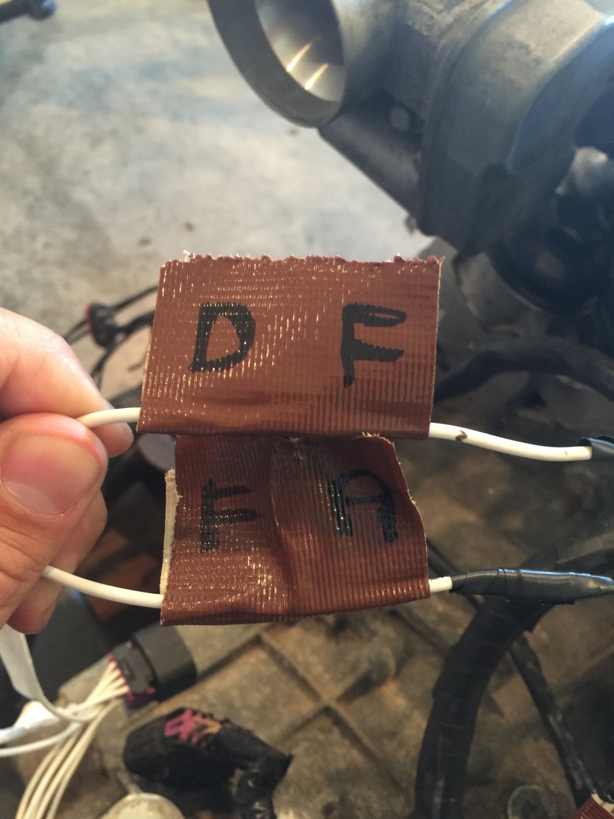

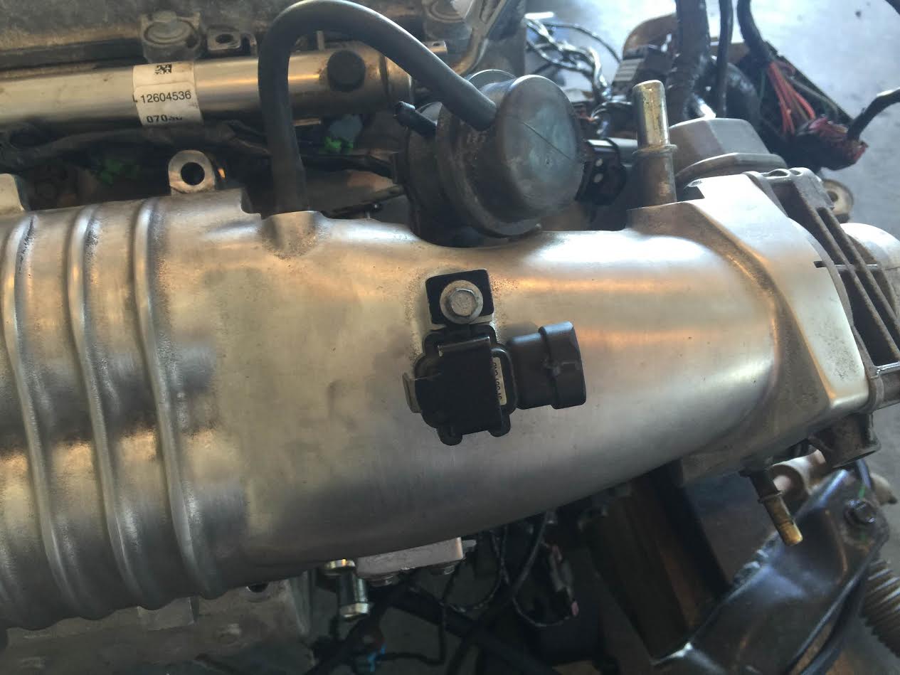

So since I didn't think the degree of difficulty was high enough for my first major automotive project :'( , I decided to add a supercharger. If anyone is thinking about supercharging a 2.2L LE5, here are some things you may wish to know.
If you choose to run an LSJ TB, it has 8 pins. Your LE5 TB has 6. so....either buy an adapter from ZZP which may or may not work, or splice the 6 wires into 8 using an LSJ TB pigtail.
You may find guides online that go by wire color but GOOD NEWS EVERYONE the aftermarket LSJ TB pigtail I purchased had ALL WHITE WIRES so it was super fun figuring out the ABCDEFGH and color combinations. My advice is buy the ZZP adapter. They told me that if I was nice to it I could return it for a full refund if it didn't work. (I received this news 10 minutes after the point of no return on my 6-pin pigtail.)
This link helped a great deal: http://www.cobaltss.net/forums/2-2l-l61-performance-tech-45/6-pin-l61-8-pin-le5-tb-235114
Also, the LSJ(S/C) inlet pressure sensor has nowhere to go on a LE5 PCM, or so I've been told, correct me if I'm wrong. As of now I'm left staring at a sensor that does nothing except plug a hole.
Finally, you can use your LE5 MAP sensor on the LSJ intake, but the hole doesn't quite line up. I fabricated a bracket out of some metal as a test.

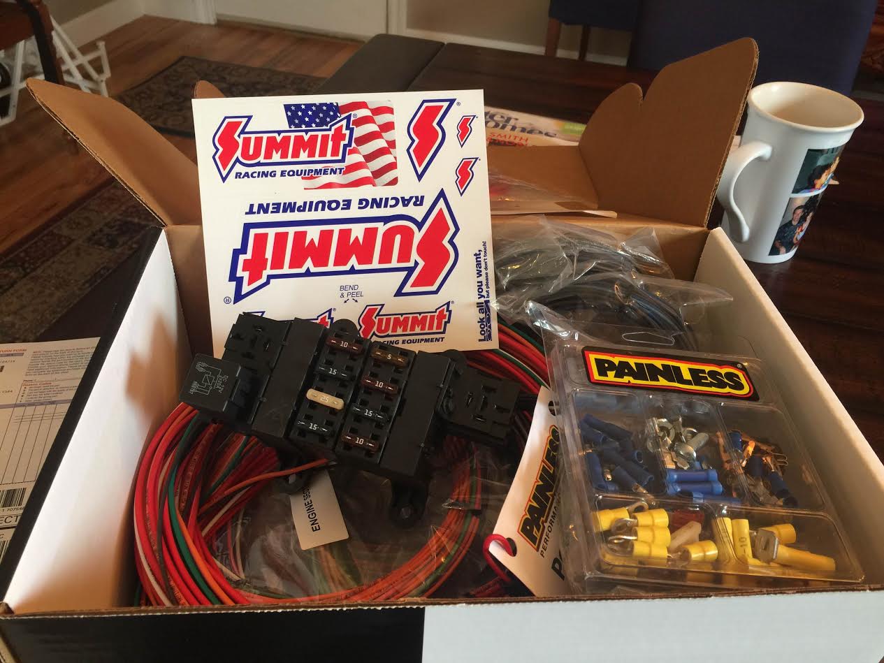

On an unrelated note, I picked up a painless performance aftermarket chassis harness. 18 circuits, and all the wires are designated in writing. If you order in April you get a free box of braided wrap, which is about $25 retail.

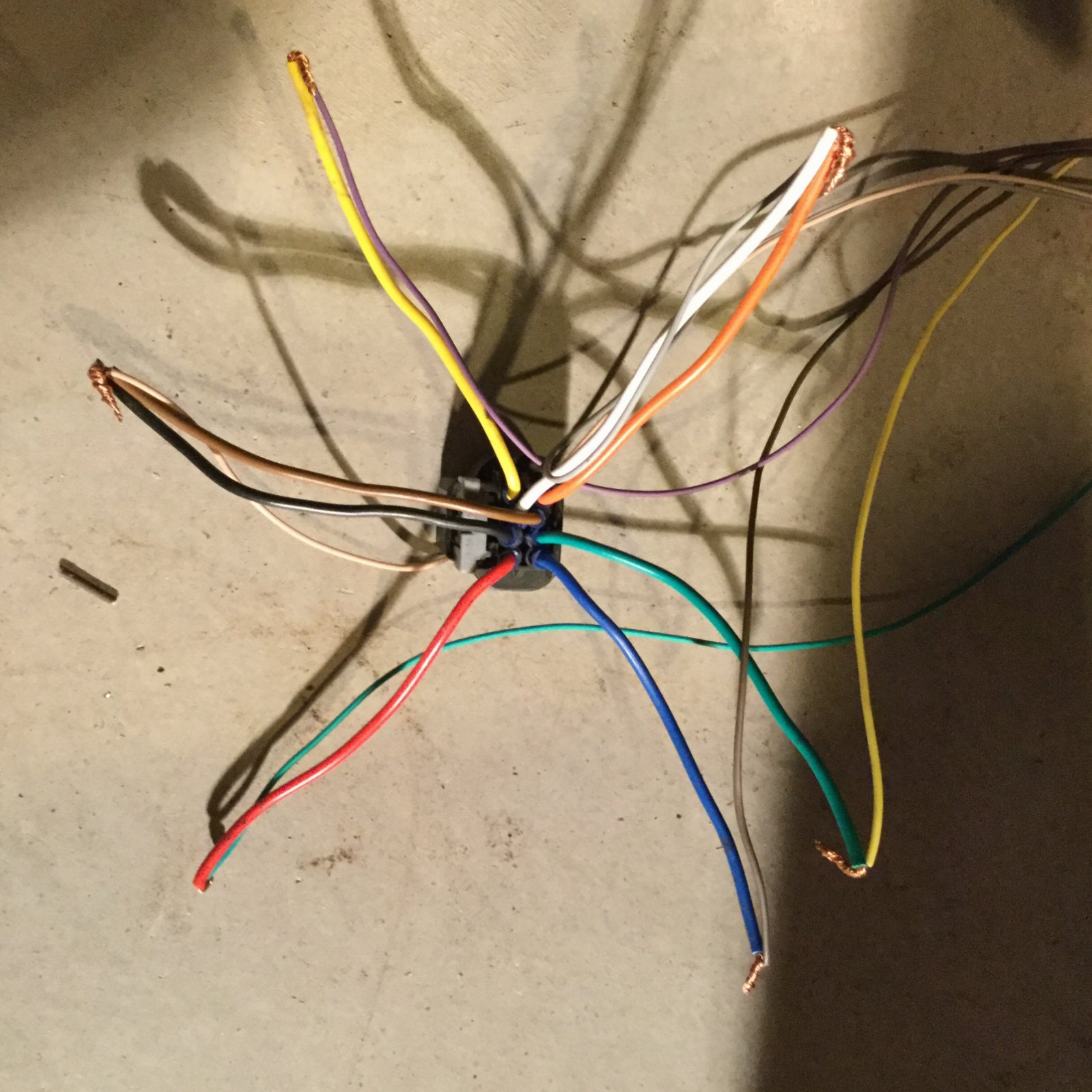

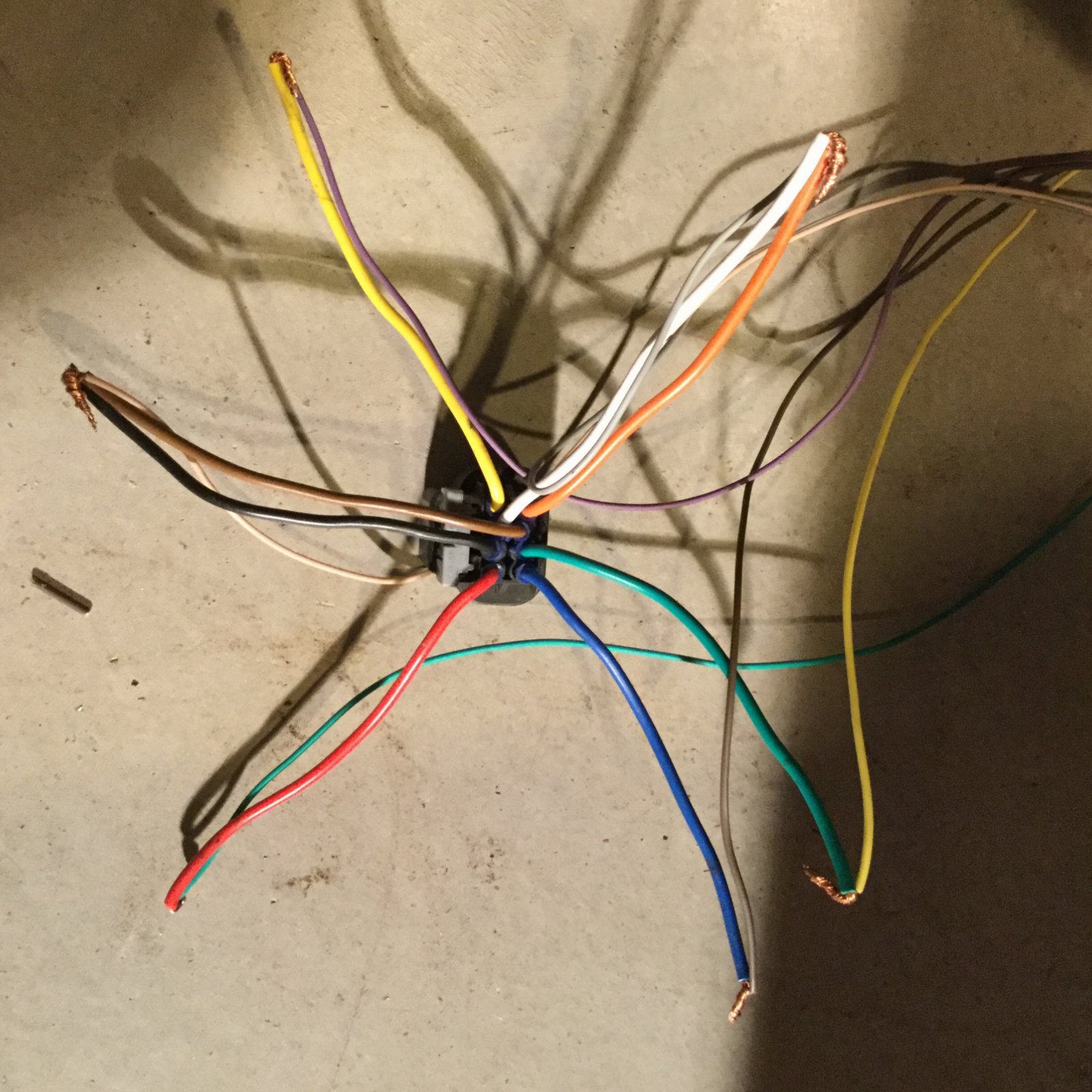

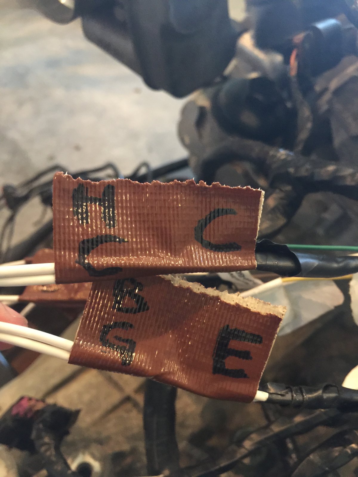

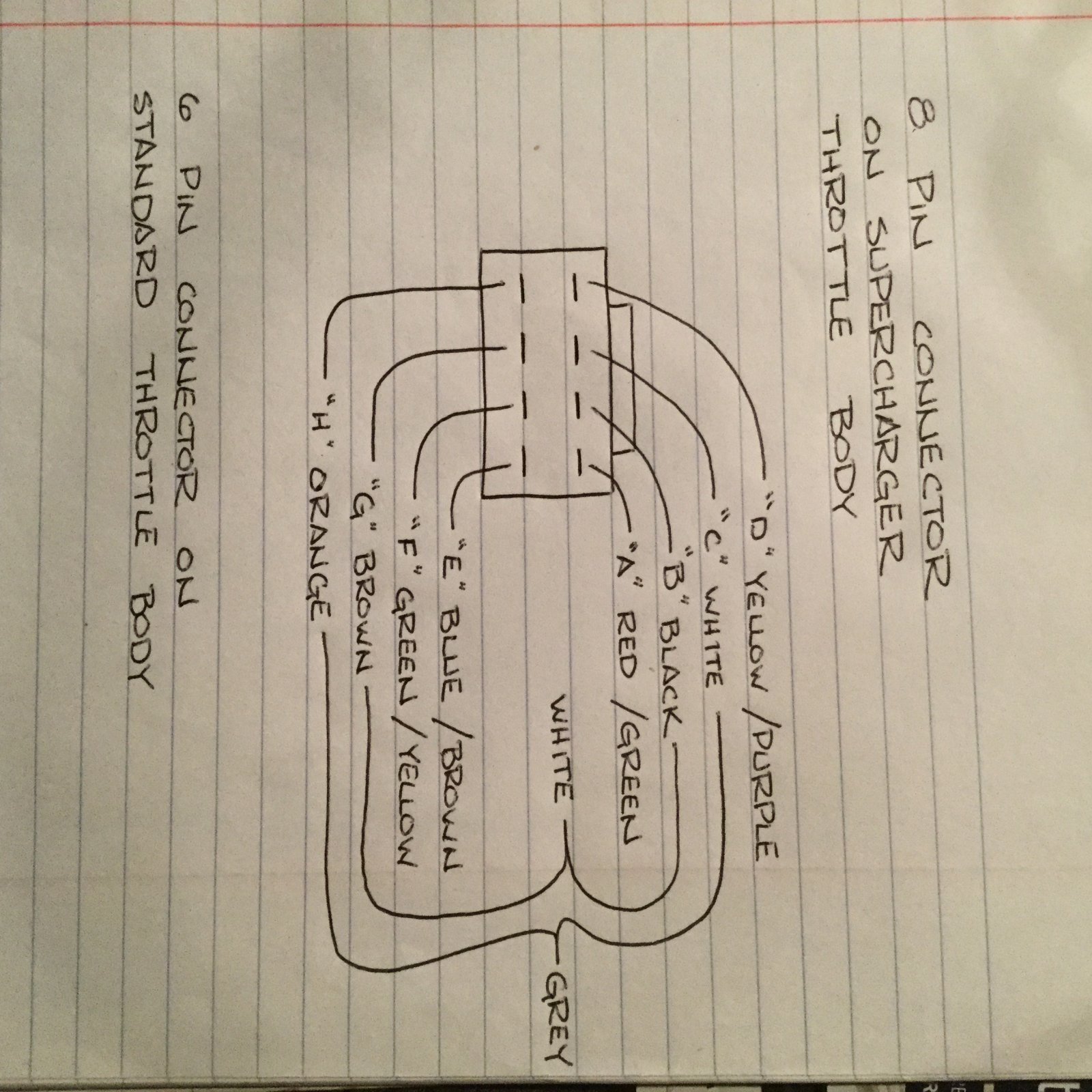

Smithvmi,
Just getting ready to hard wire my 6 pin to 8 pin for the ZZPerformance supercharger. Luckily all my wires aren't all white but they are not factory color coded either. If you could check my work against yours I would appreciate it. Hate to have to redo.
THX, BAR-AIR

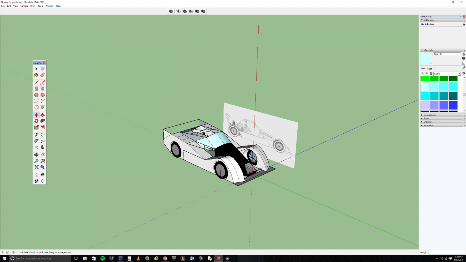

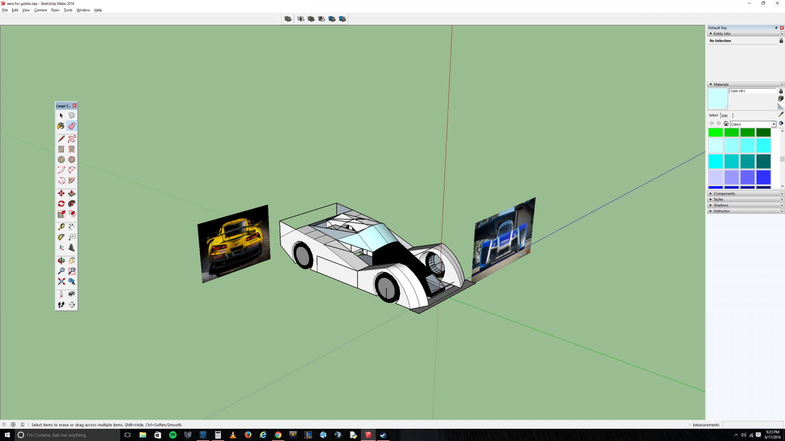

Alright yall, anticipation has given way to mania, and I've started playing around with sketchup and designing a body/aero kit for the track goblin. Real seat of the pants stuff, very rough and not complete, but cool. Feel free to take it, change it, poke holes in it, etc.
I can only attach the png's, the sketchup files aren't supported by the forum. If you want the file pm your email.

rallyracer
Nice!
Now if you can just find a company to make that body out of CF, as to not add a bunch of weight :)
Made it easier to view the images too.
smithvmi
BAR-AIR, see the pics below.
Let me know how it works. From what I can tell the color code is almost factory but your ABCDEFGHs seem to match mine. I plan on attempting to start it up prior to soldering the wires.
BAR-AIR
THX Alex,
I'm in the process of actually wiring the car now. I had modified the harness a couple of months ago. Appreciate you checking that for me.
