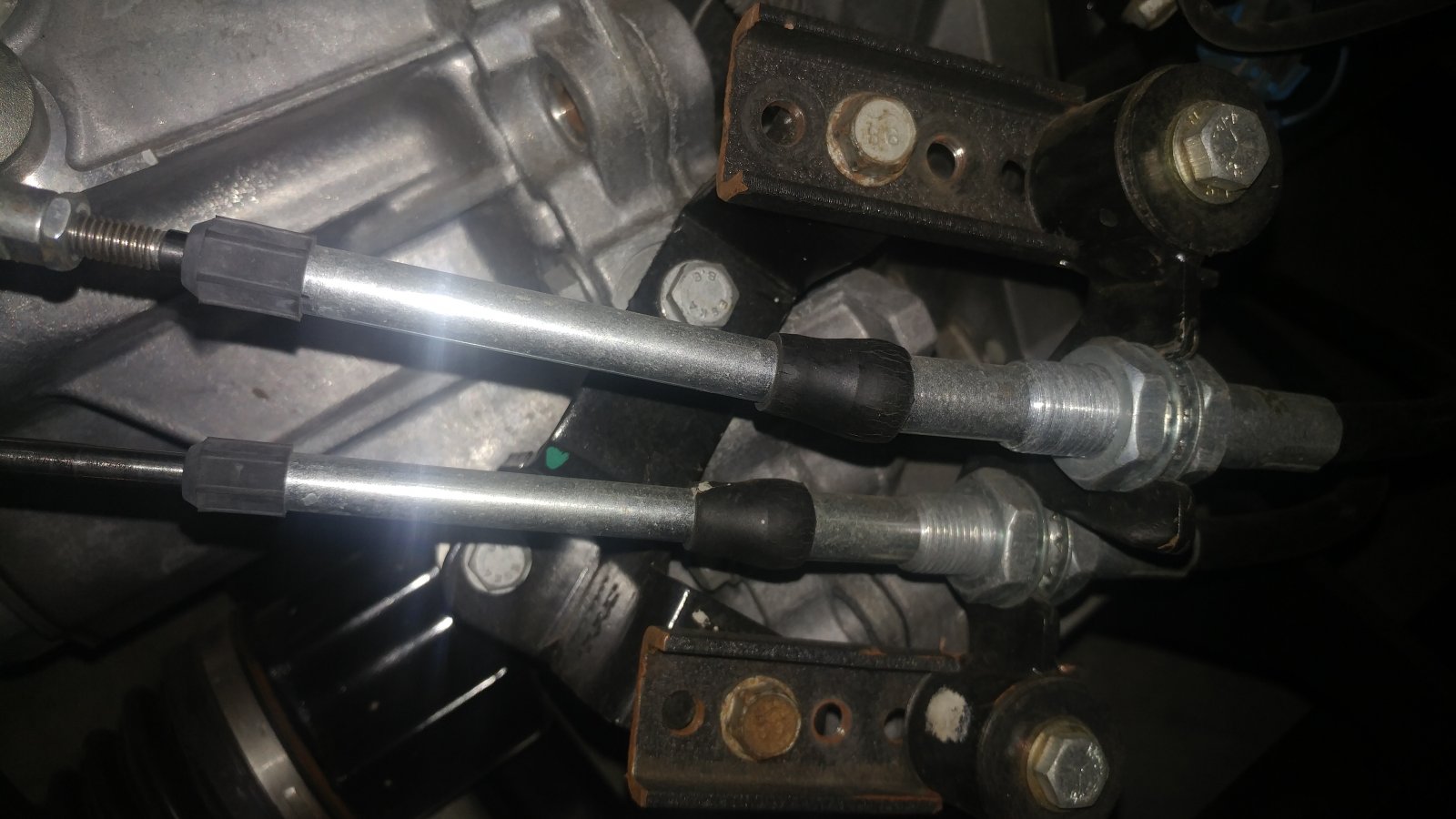

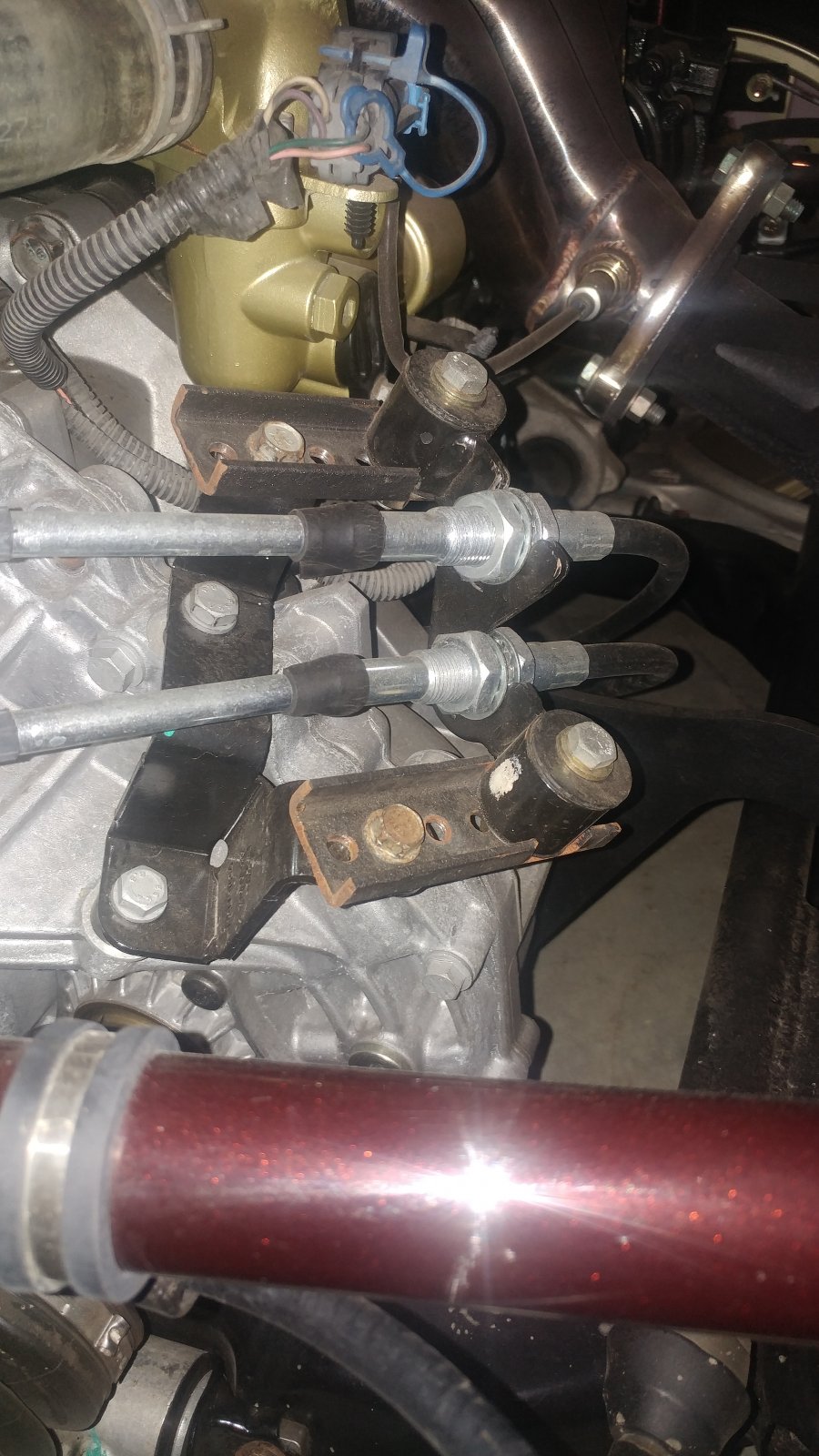

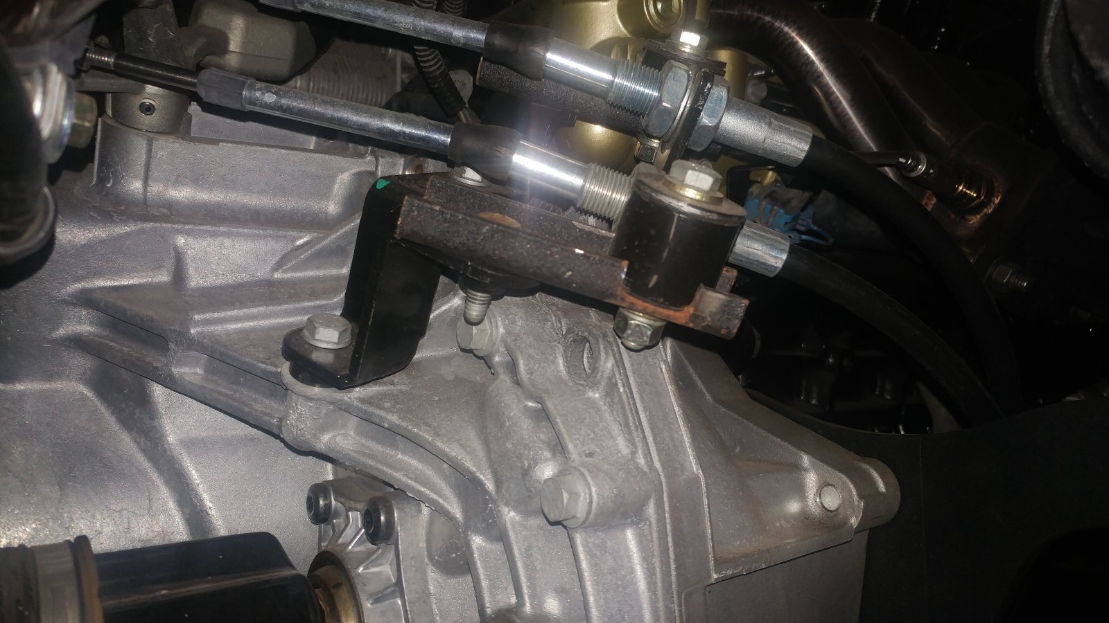

I never posted these pictures, but for my shifter I ditched the cable bracket from df and used the stock bracket with some scrap I had laying around the shop that way I could get the cables routed a little closer inline with both shift arms. I think @Ross did something similar.
