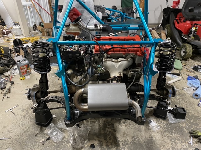

Bunch of progress over the last couple of evenings. I've got all brakes mounted around the car, finished up the font steering links, the rear suspension and toe links, got both my seats mounted, put the shifter and tunnel cap in place and changed out the transmission fluid.
Couple of minor items to do (bleed the brakes, solder extensions for the shifter wires that turned out too short after I finished the harness, and get the axle nuts onto the rear of the car).

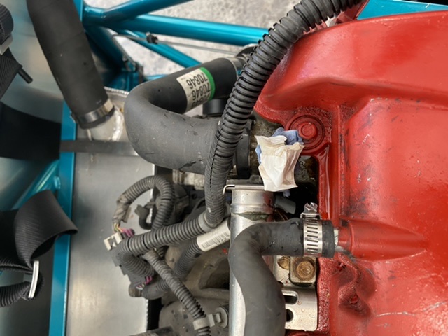

The coolant port - under the tape? - goes to the coolant recovery tank small fitting near the fill cap. BTW, your main coolant hose going to the radiator looks like it is kinked, this will severely restrict coolant flow.
Anks329
Thanks... then what gets connected to the port where you see a hose currently coming out of that is on the valve cover?
Y

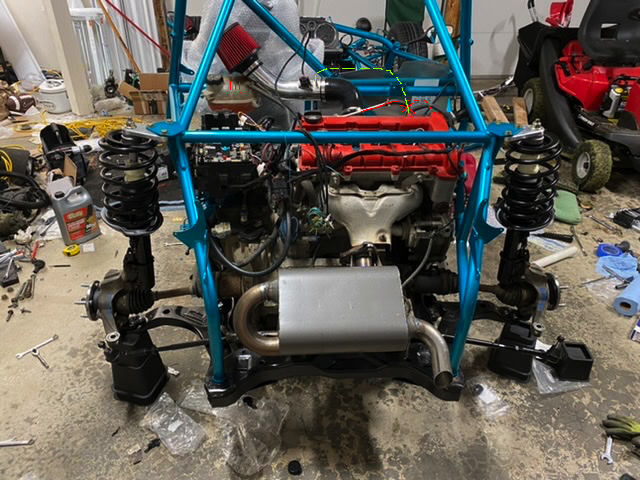

@Anks329 Port on the valve cover - it is breathing port to release extra pressure from the crankcase. It can be attached to the intake right behind MAF sensor. There is a hole designed for that (See green line). Or, as an option, you can put filter there to breath fresh atmosphere air as many people on forum do.
I see the reservoir is half full. Hope engine didn't taste it. Do not fill engine head with coolant!!
Port on the coolant line - is topmost coolant point. It releases extra air (if any) and coolant to the coolant reservoir, sort of self bleeding. It should be connected to coolant reservoir port, small one (See red dotted line). It is connected through small diameter aluminum tube . Not sure why so.

Got it, thanks for all the help! And no, I’ve only turned on the engine very briefly thus far. I’ll fix this issue before going further.
Pull the dipstick to see if the oil is milky. If it is you should change the oil. Check it again after you run the engine.
Anks329
Fixed the problem :-) And the oil isn't milky, so I think I dogged a bullet there.
