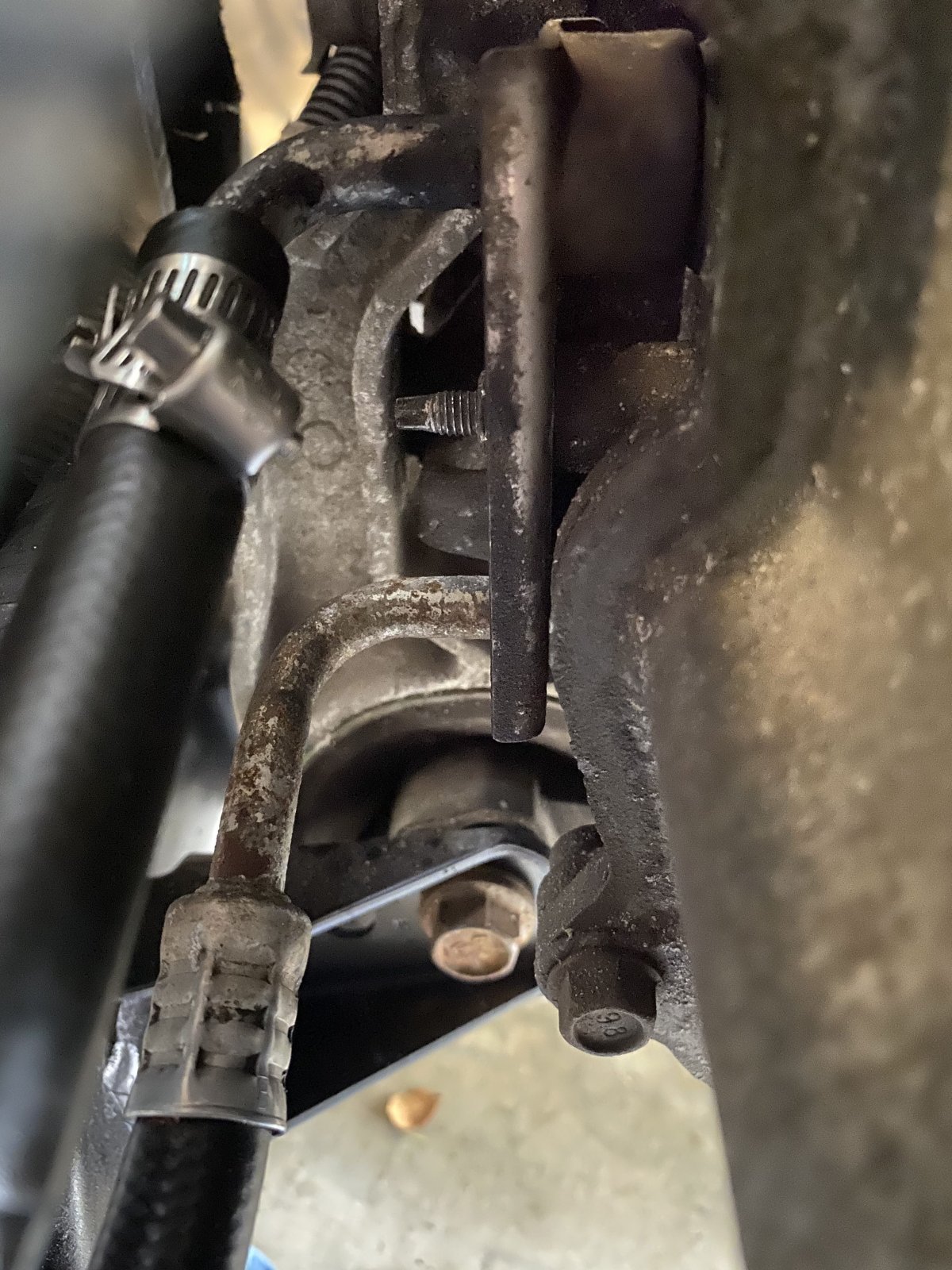

- I'm leaking automatic transmission fluid from the loop that I created. Is there a better way to create this loop or is there something else I should be doing here?

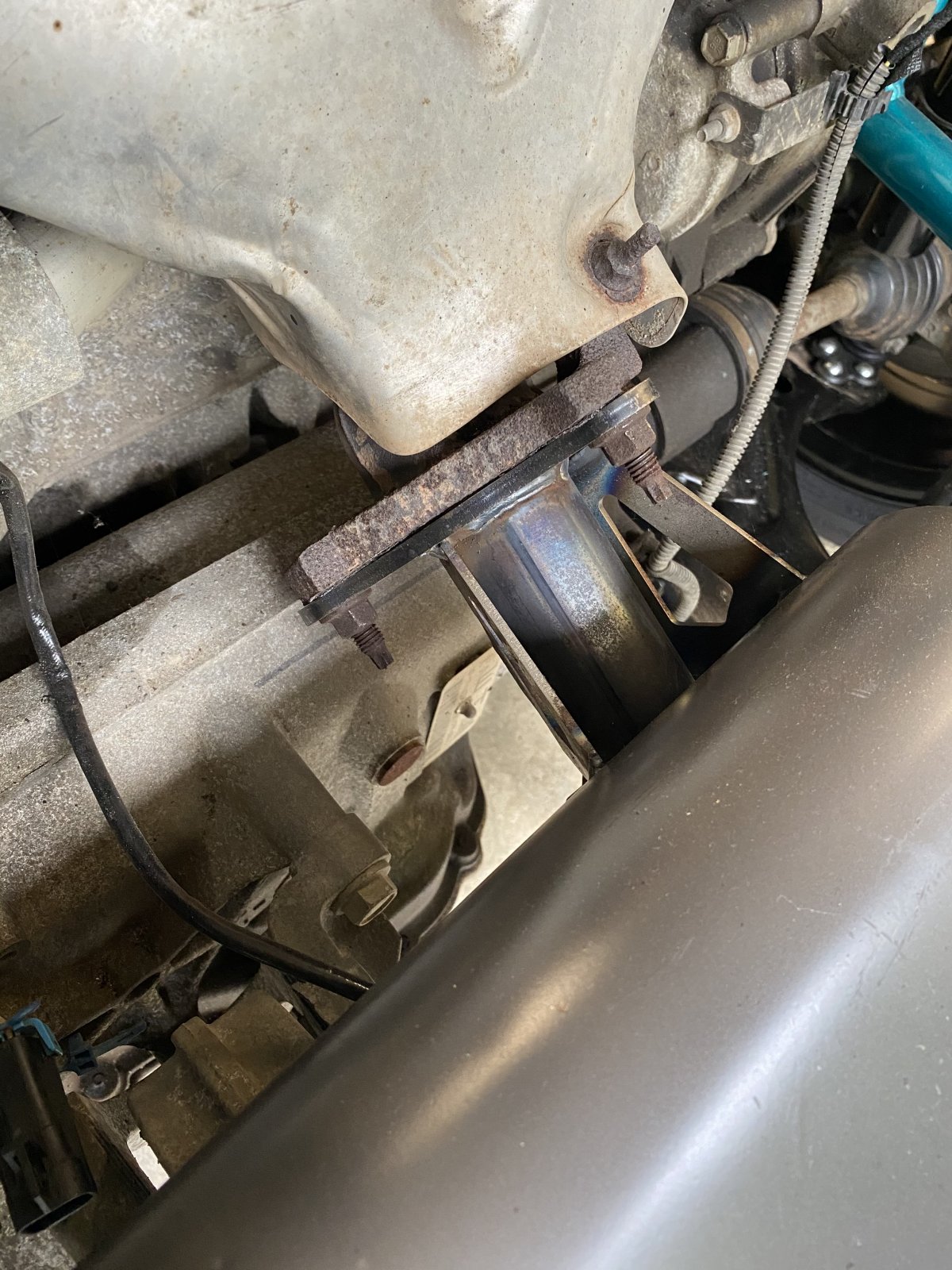

- My exhaust seems to be smoking where it connects to the engine. Is this normal?
16228
If your exhaust is new, and burning off a thin layer of oil, then it is normal.
If your exhaust is able to move a feather or cotton ball on a string, then it is leaking, and needs a new gasket, or it is warped.
Leaking exhaust will throw off your O2 sensor, and cause the engine to run rich, or throw an engine code, and run in VE (volumetric efficiency) mode only, and not use the MAF (mass air flow meter) mode.

Think I might have missed the gasket... I’ll add that in.
With the transmission loop, I’m going to add more hose clamps and tighten them down more.

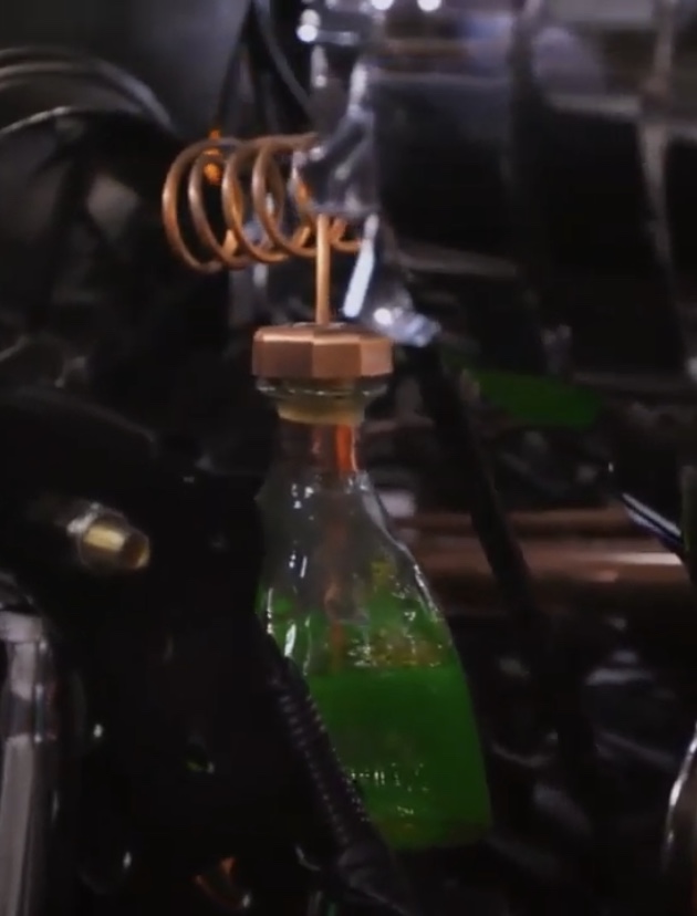

While I'm waiting for some supplies to come in, I was watching Gotham Garage. They built a car with a tequila bottle as the coolant overflow tank. Anyone done anything like this and change the overflow tank? Anything specific to looks for before changing the tank?

I don't think that that would work with our systems. That bottle is just functioning as an overflow only. Our cars are set up with expansion tanks. If I'm mistaken, surely someone will correct me.
jennam
That would be quite dangerous on a goblin. I could see the pressure forcing the stopper out and showering the car (and everyone in or near it) with hot coolant.
