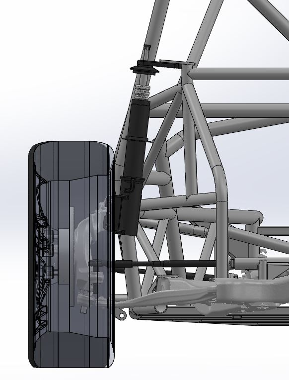

The conclusion I came to with my forum research was level tie rods. I do not have a stock setup though so take it with a grain of salt
44262
Several of us have swapped to longer shocks either for the extra clearance or so we can have more shock travel in one direction or another. My front tie rods are level with the longer shocks.
I have done the same and use 225/475 springs up front. I’m not sure if he wanted to go that far.
