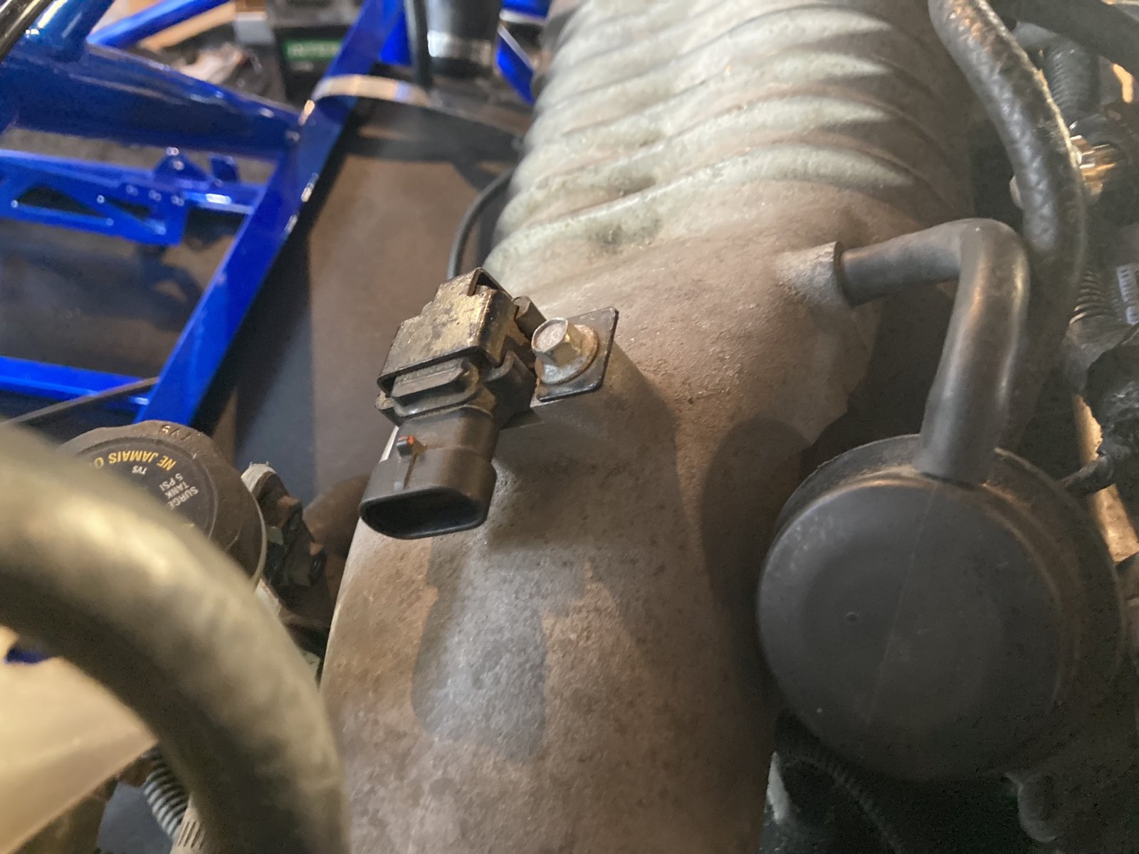

Some other notable things about my electrical system is I do not have the receiver up front by the BCM that controls the key fob. I also cannot find the connector that goes to the top of supercharger, nothing seems to even reach up there.
36860

that connector should be on the engine harness, not touched in the wiring harness modifications.

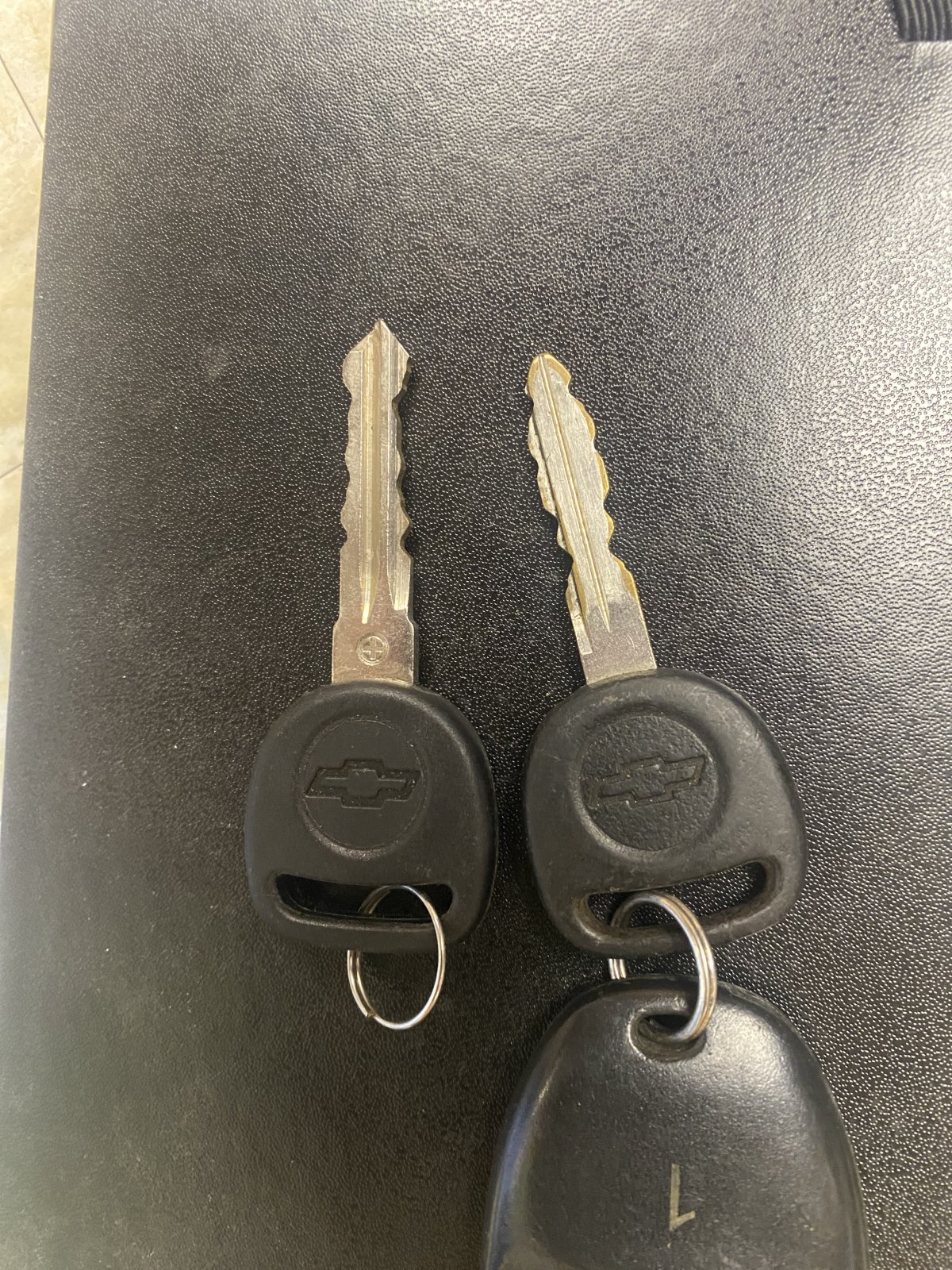

Another thing to note. Look at these “identical” keys. One can be programmed to the VATS (security system) and one can’t. The one with the “+” is the only one that will work with VATS.

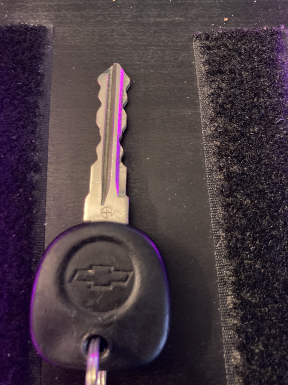

Ok just looked at my key and it has the +

Could be something else wrong. The “chip” in the key is simply a resistor In the handle. when programmed, the vats is just reading the key‘s resistance. It can store 5 of them, then start to overwrite ones not used. Theoretically a new key shouldn’t matter compared to a old key, but I have seen stranger things happen.
