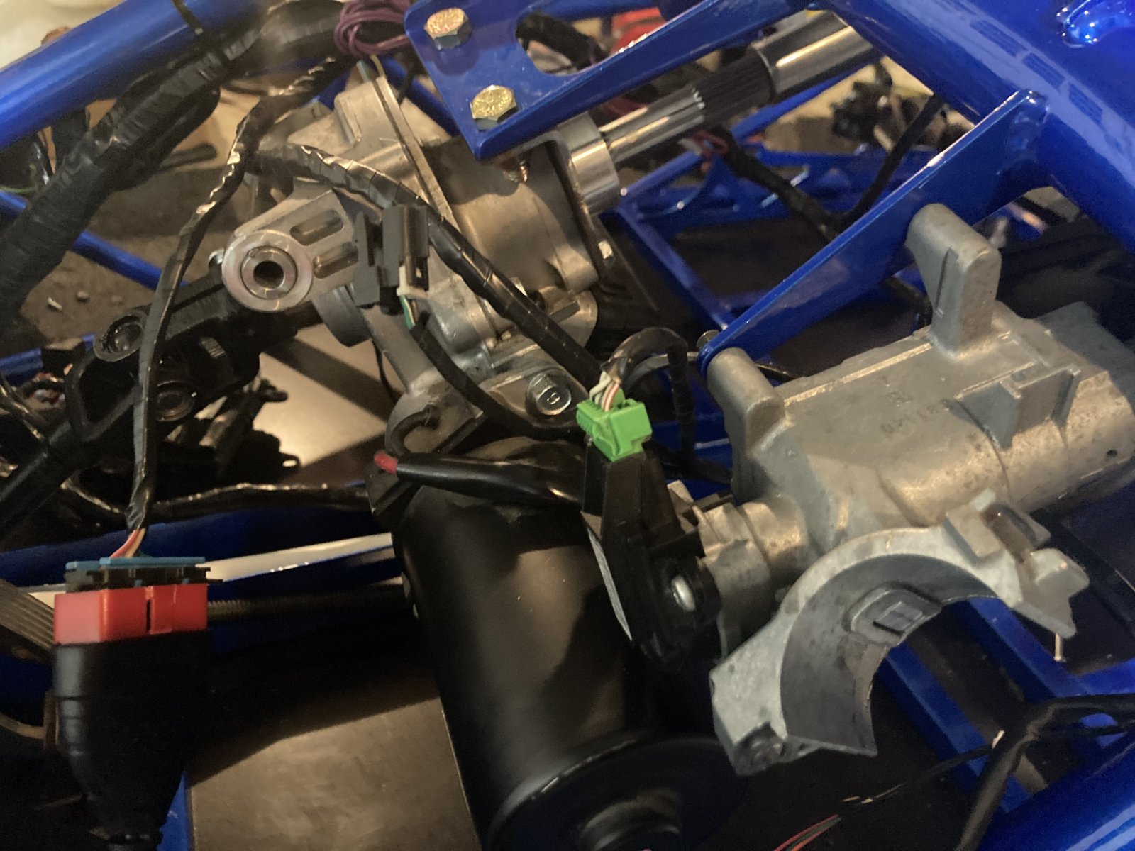

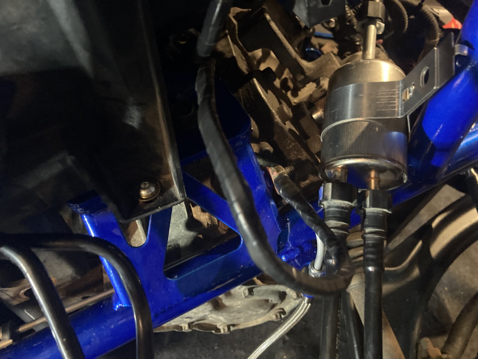

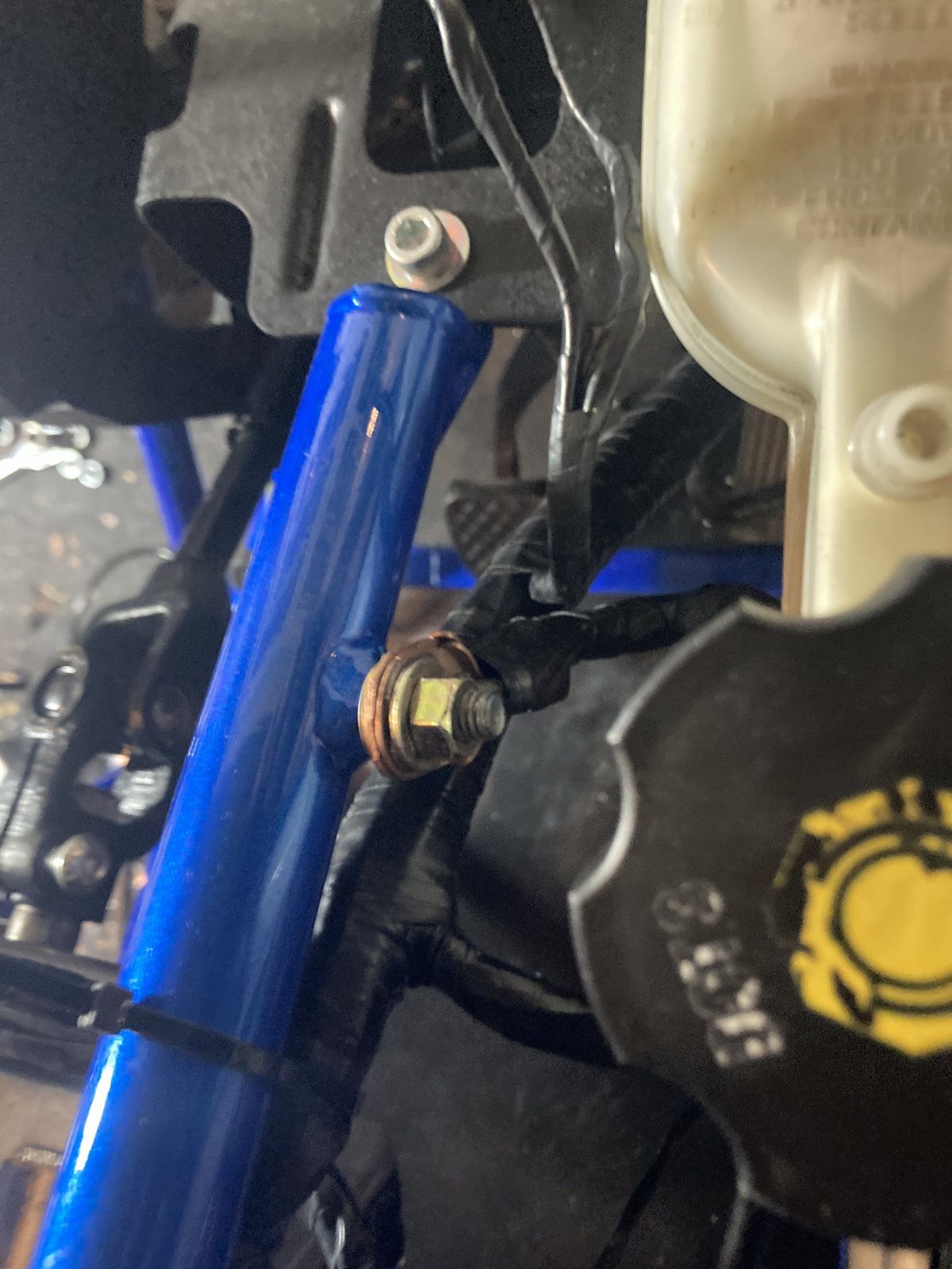

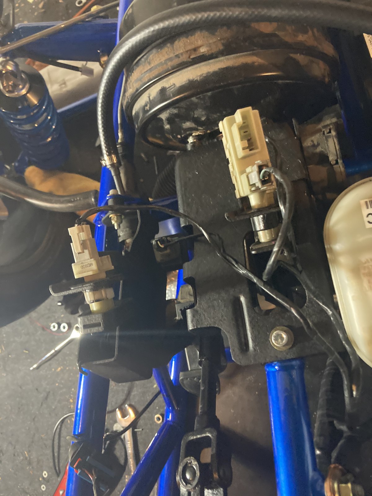

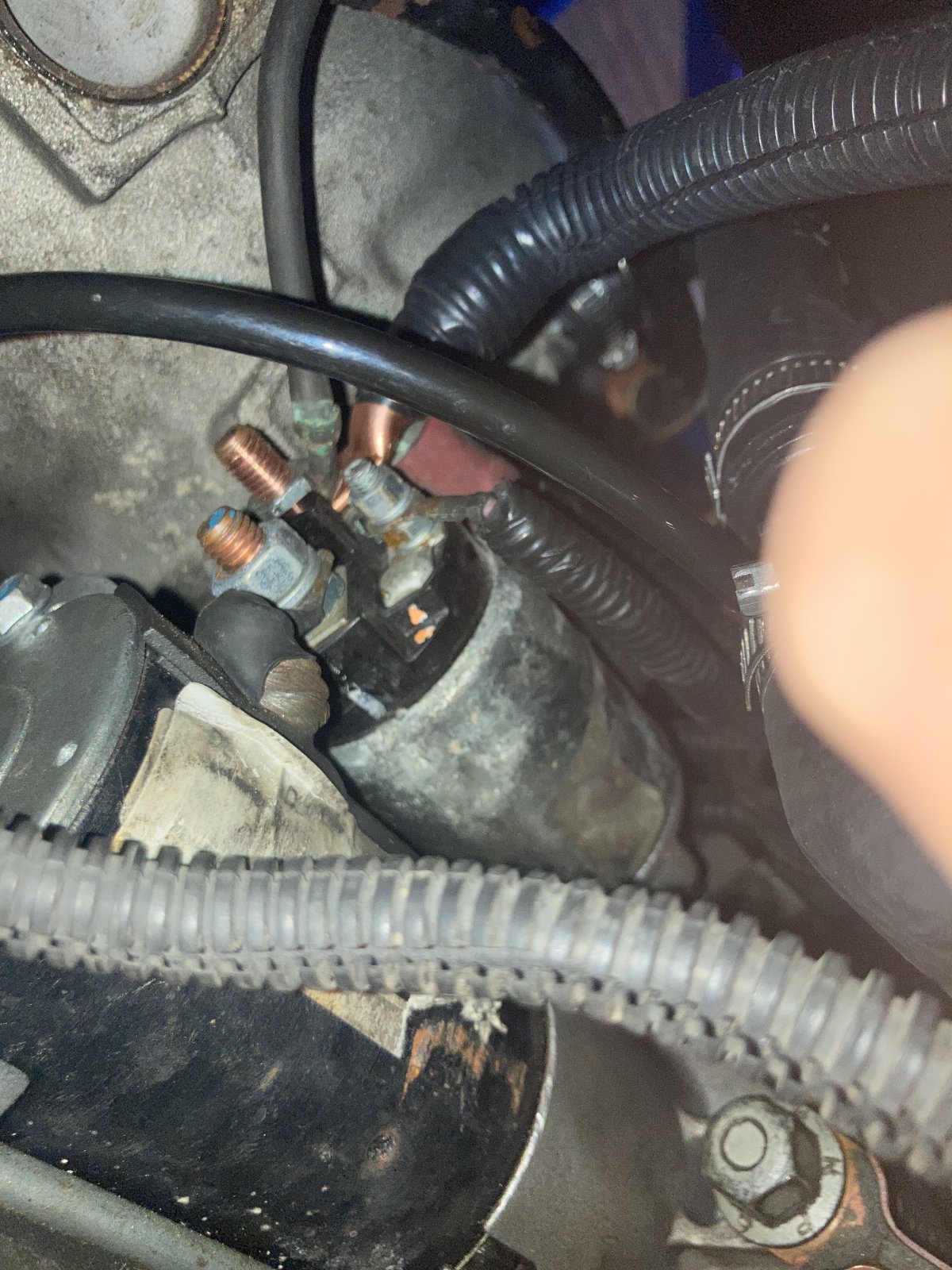

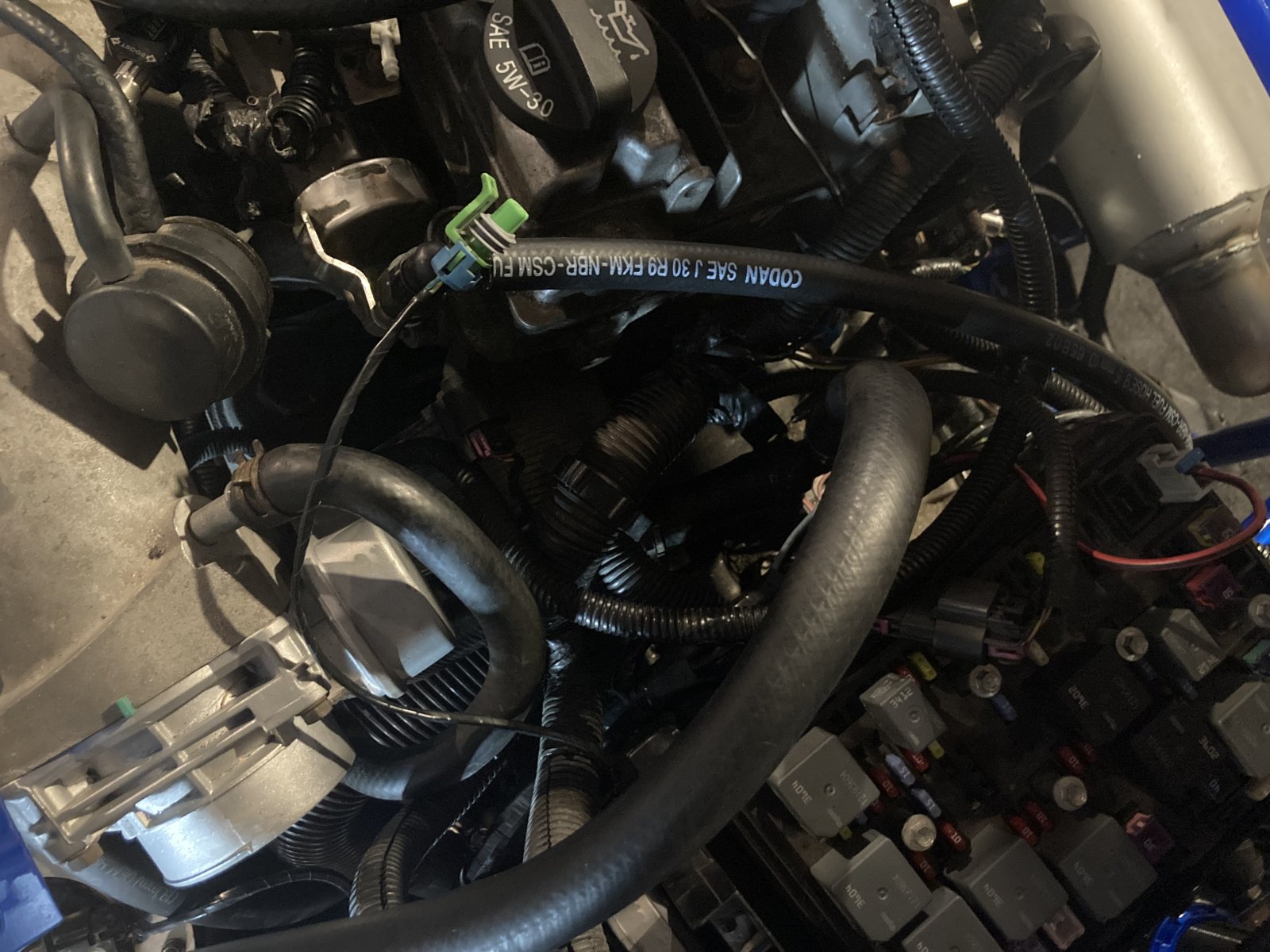

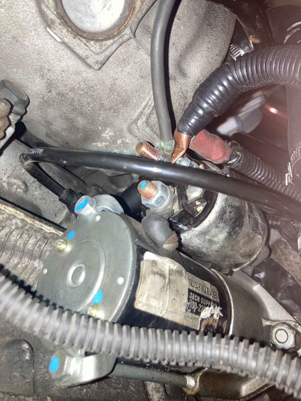

can you take some pictures of your engine and ground bolts and alternator and post them i will look over your wiring
the wiring around the ignition and pedals also please
also want to check to see if you have the transmission to frame ground installed
K
here are some photos:
Also the anti theft light just turned off after doing the other reprogramming procedure, I have only gotten through the first two and I am on the third. When the light turned off the relays started making a lot of clicks again, not sure if that means anything.
