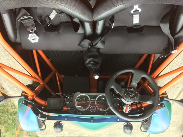

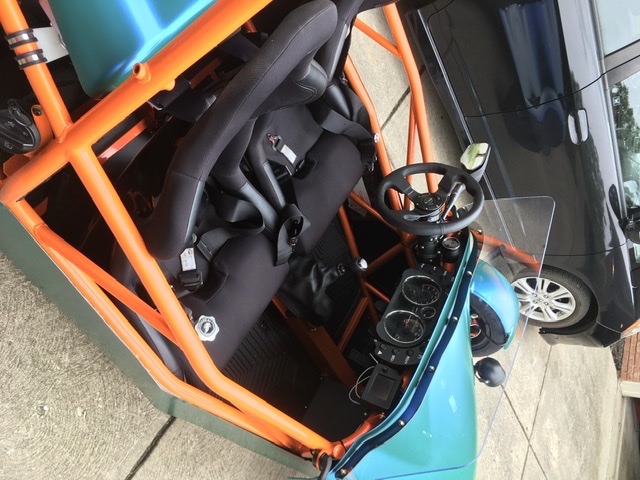

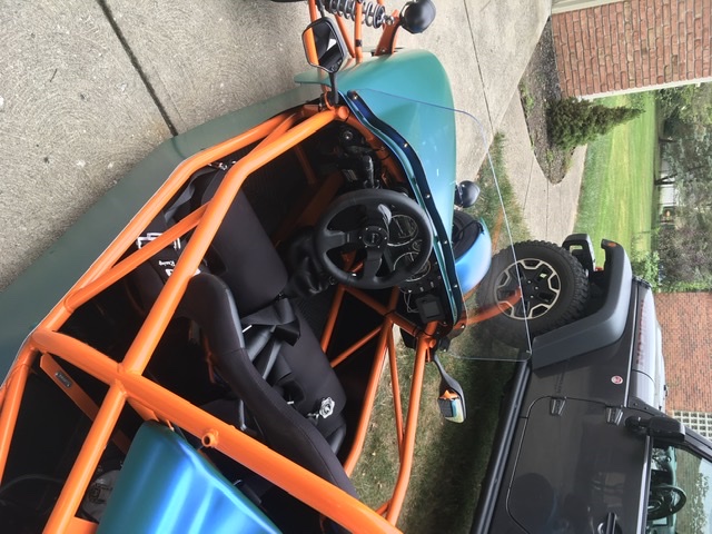

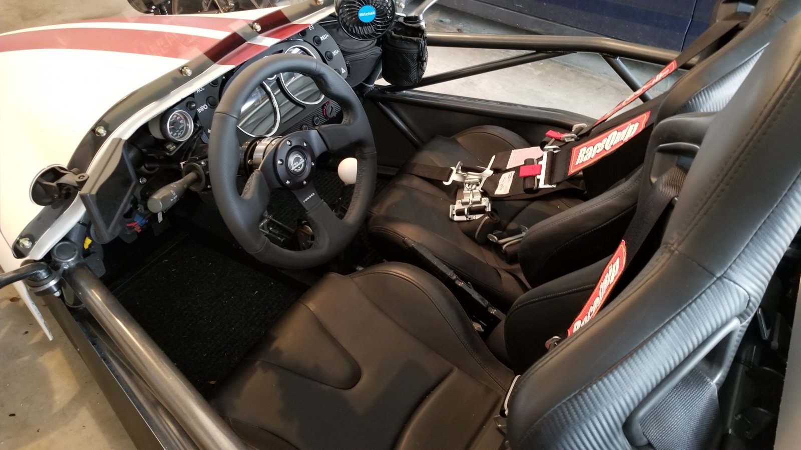

I purchased the quick release setup for ease of release and comfort. I do not use it as much as I thought I would, I got used to the in and out of the Goblin. The main reason I still love it is the distance from the steering wheel to the turn signal. With the steering wheel from DF the gap between the steering wheel and turn signal was very tight. I would hit it accidentally frequently. The steering wheel is very comfortable and it feels good - and looks good.
NRG Innovations RST-012R 320mm Race Style Leather Steering Wheel with Black stitch https://www.amazon.com/dp/B01MRHGXLO/ref=cm_sw_r_cp_tai_FRvEEbTWFQ36T
NRG Short Steering Wheel Hub Adapter (Boss) Kit - Chevrolet Corvette (2005-2013) - Part # SRK-177H (Black) https://www.amazon.com/dp/B008FT5ZLW/ref=cm_sw_r_cp_tai_VTvEEbAHMMGN3
NRG Innovations SRK-200BK Quick Release (Black Body/Black Ring) https://www.amazon.com/dp/B007ZG6TUC/ref=cm_sw_r_cp_tai_xVvEEbK1D3WPS

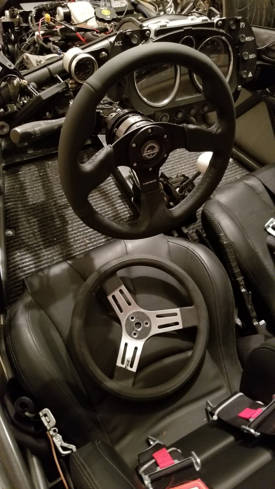

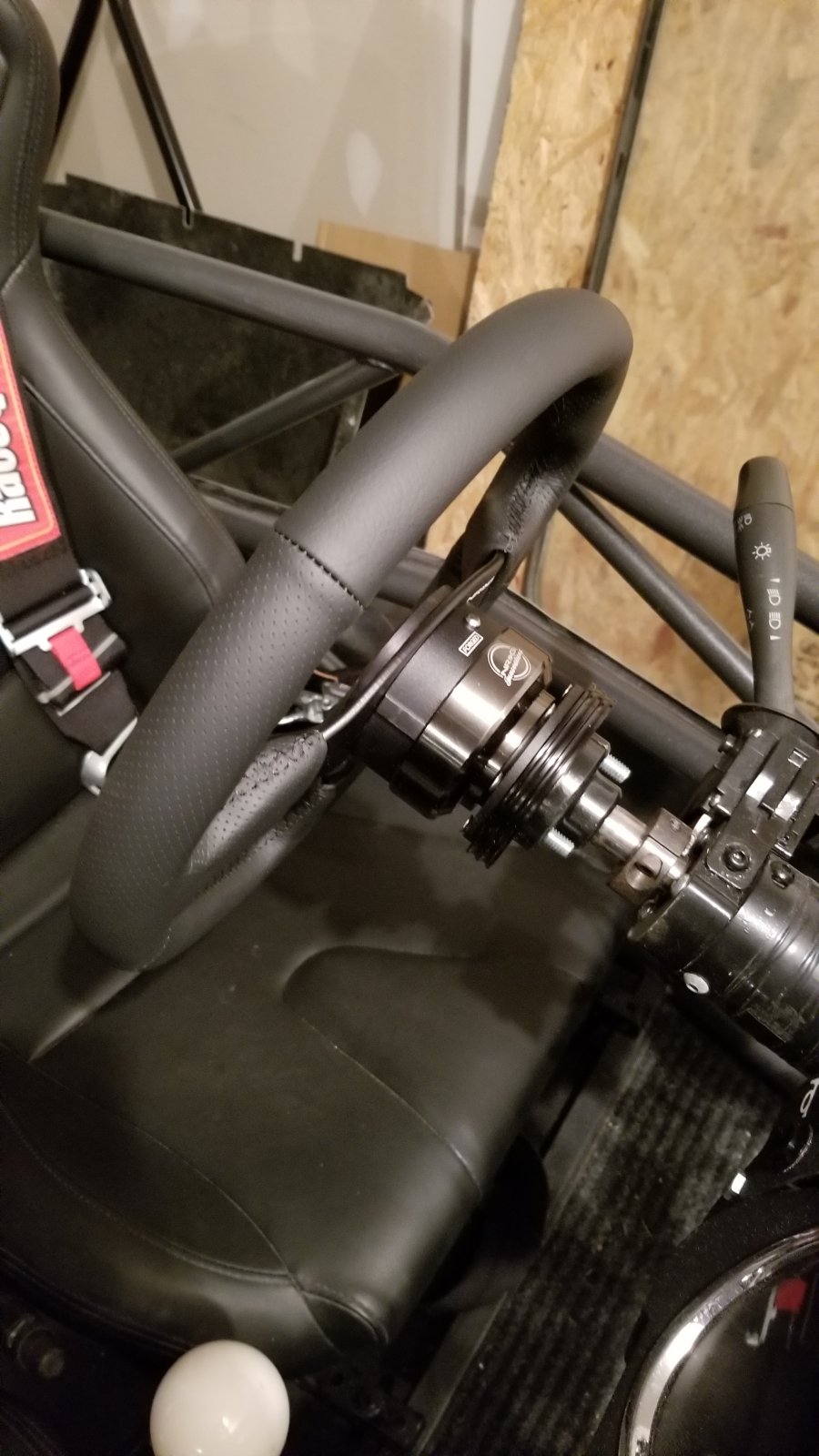

Old thread, I know, but I wanted to add my setup to hopefully help future builders find more options.
I used the same wheel and quick release that Indy Lonnie did in his car, but I instead used a cheap 3-hole to 6-hole adapter along with the provided DF spline adapter, rather than paying over $100 for a new hub adapter. It works fine, but I had to drill out the 3 holes a little wider to accommodate the bolts supplied by DF. Links to the items I bought are HERE.
