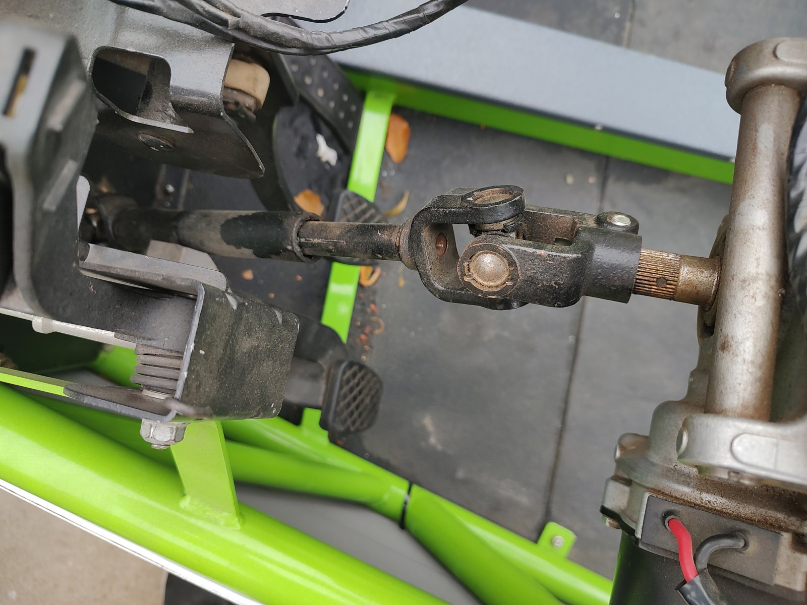

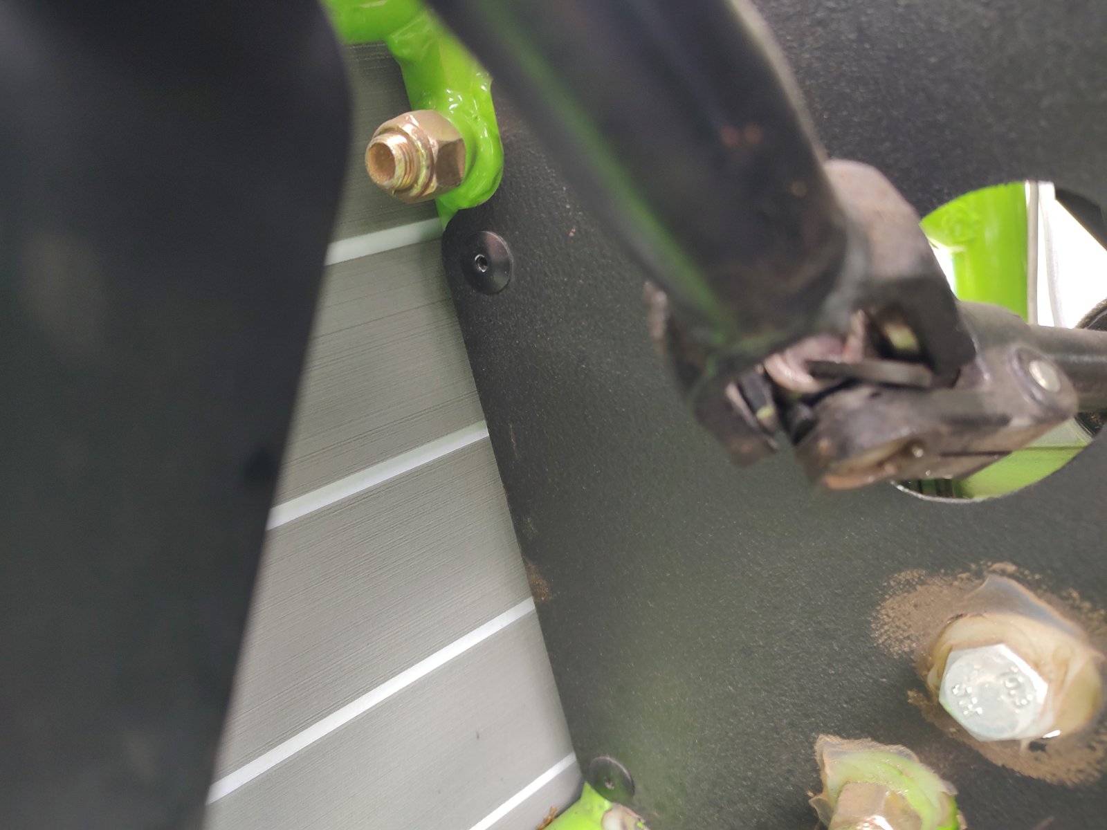

I am finding that even after my 4 wheel alignment, the steering can be bit touchy still .. I have looked over everything and from what I can tell , the steering knuckles on the shaft appear to be worn, is that a stock cobalt part or something from DF?
