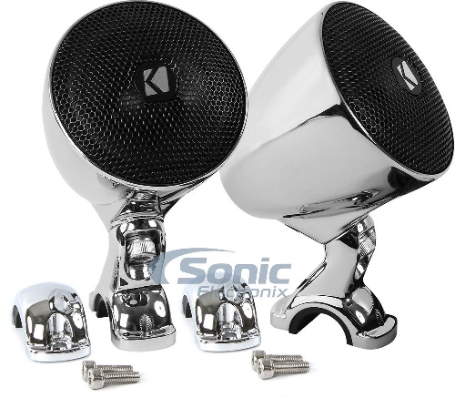

Kenwood KAC-M1824BT 4-channel amp and Kicker 40PSM34
Links:
Kenwood KAC-M1824BT
Kicker 40PSM34
I liked this option a lot originally, because it would be well-hidden and less obvious of a target for theft. Since the amp is 4-channel, you can add a second set of Kicker speakers later if you desire, perhaps clamped to the roll bar.

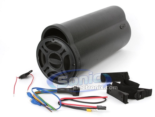

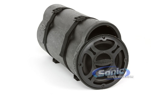

Bazooka BTA6250D 6" bass tube (or BT6014 if you go with an option like #3)
Link:
Bazooka BTA6250D
Bazooka BT6014

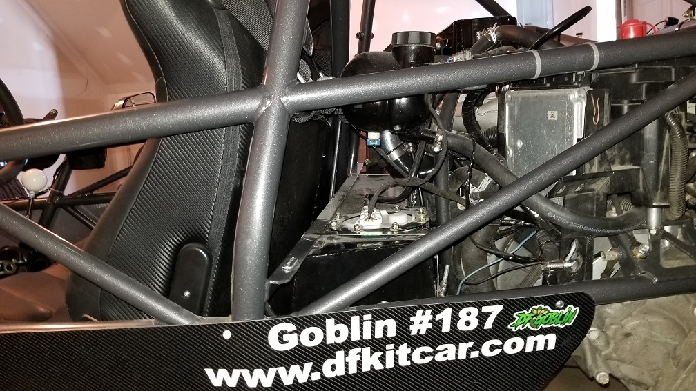

I like the idea of adding an external subwoofer to these cars, but for guys without the extended frame, it would be difficult. I have yet to check into whether this would work in terms of dimensions of the tubes vs. the available space above the fuel tank, but I do think it would fit.
The first link (the BTA6250D) is a self-amplified version while the second link (the BT6014) is non-amplified and would need external power amplification. You would want to use the BTA6250D with a sound-bar-style system like options #1 and #2, while you would want to use the BT6014 with a separate amp/speaker system like option #3.

  1. Durability concerns: would the tube hold up to the engine heat?
  2. Fitment concerns: does it actually fit above the fuel tank? How would you mount it?
  3. Sound quality concerns: open-air car ... would it actually sound decent?

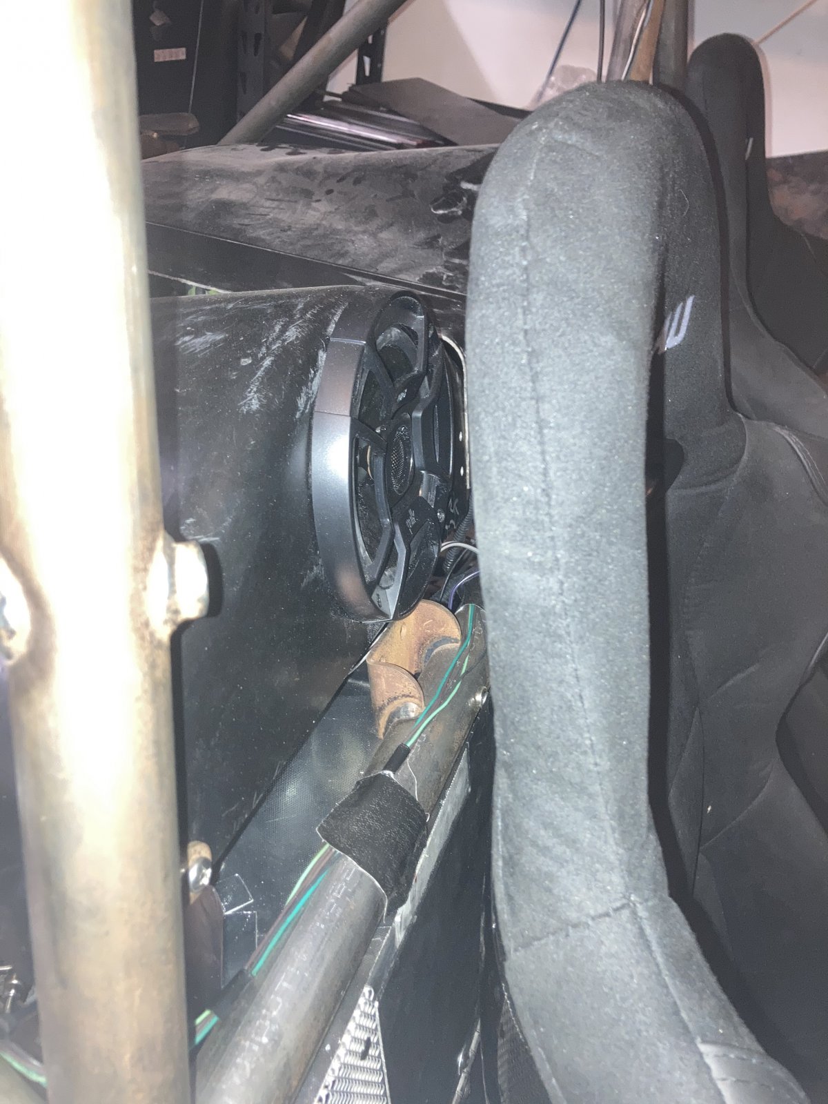

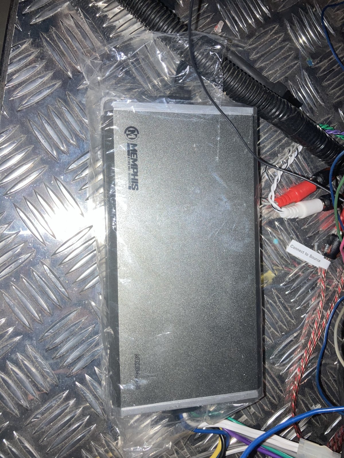

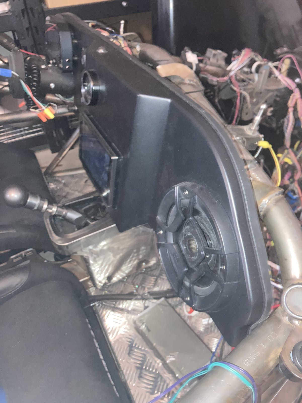

6.5’s fit great in the rear cowling humps and they’re right behind your head. I’m running a 10” kicker hideway sub right behind the driver seat. I had to dynamat the firewall & inside of the tunnel cover to eliminate rattle. I’m running 5.25’s in my dash, but these could also be put in pods. The 4 Polk marine mids are powered by a small 4 channel Memphis amp. This system is extremely loud and exceeds all of my expectations.
Interesting on the 6.5's in the engine cover, I must have missed that in your build thread. How do you think they would sound as the only two speakers in the car? I suspect the highs would be a bit muffled, since they're behind the seats...
Brian74
They sound great, but I certainly wouldn’t make them the only two speakers. Definitely need a front soundstage. Before I decided to do a dash, I was simply going to mount 5.25’s in pods and fasten them to the forward frame. I wanted to keep the install as stealthy as possible.

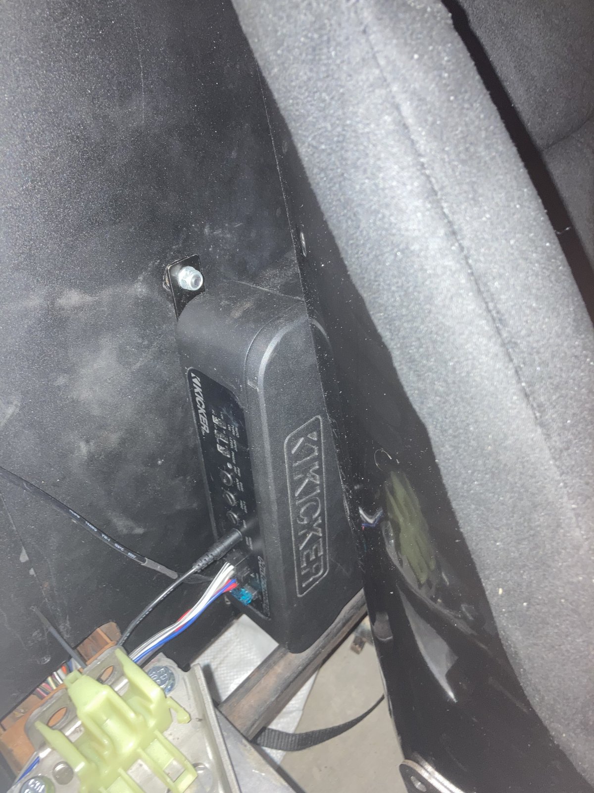

I would also absolutely recommend a sub. This Kicker is simply amazing and it makes all of the difference. With how limited we are on space, these hideaway style style subwoofers are a great option to go behind the seats.
In hingsight, I would have gone with an extended frame and built a low profile box with an 8” sub, but this is good enough.
I'm thinking about using my footwell cover as a mounting point for the midrange speakers in a component set. I'm going to try to find out how much clearance there is between the footwell cover and the hood ... should be enough space to fit a shallow speaker in there, particularly toward the front of the cover.
