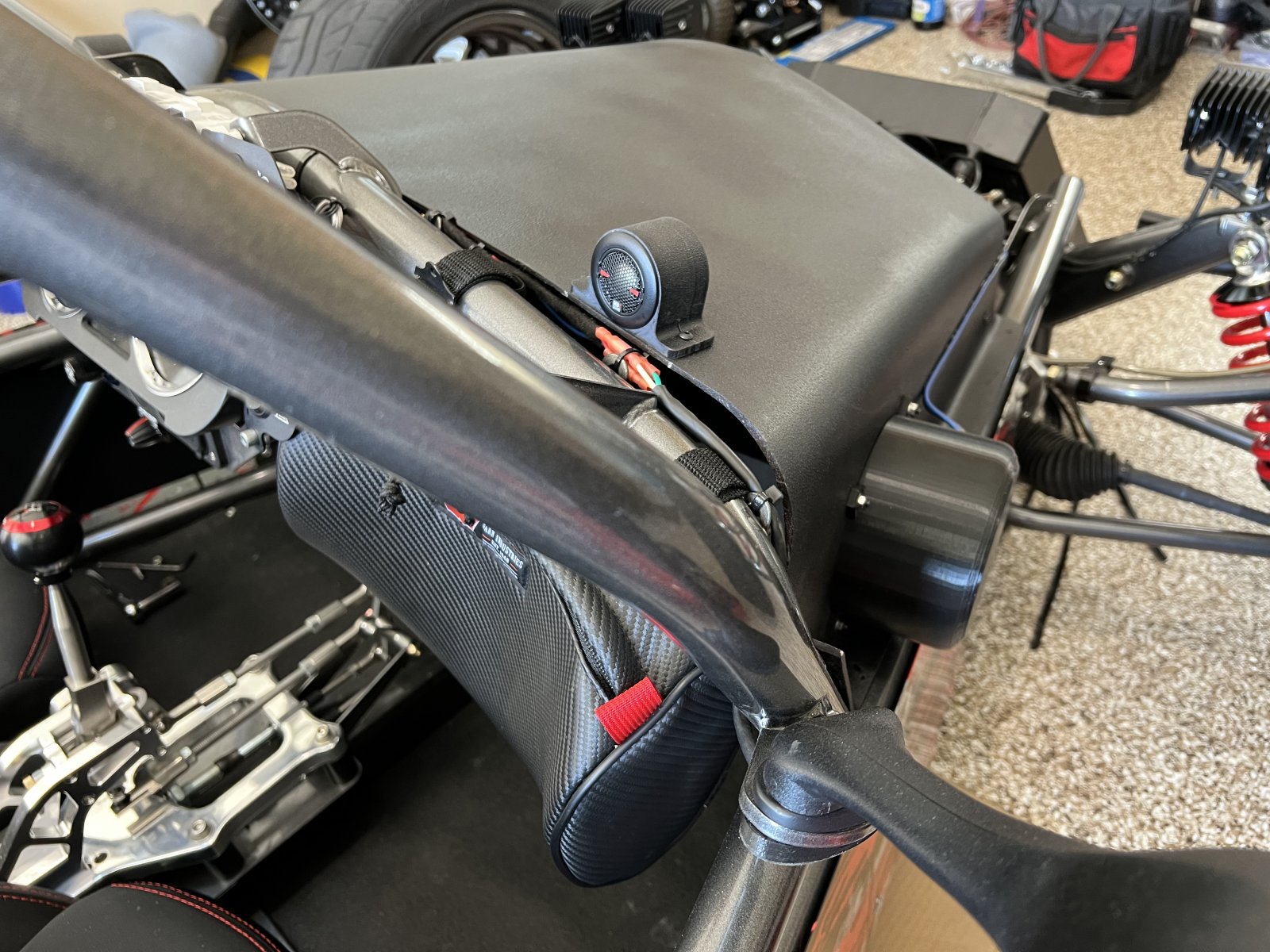

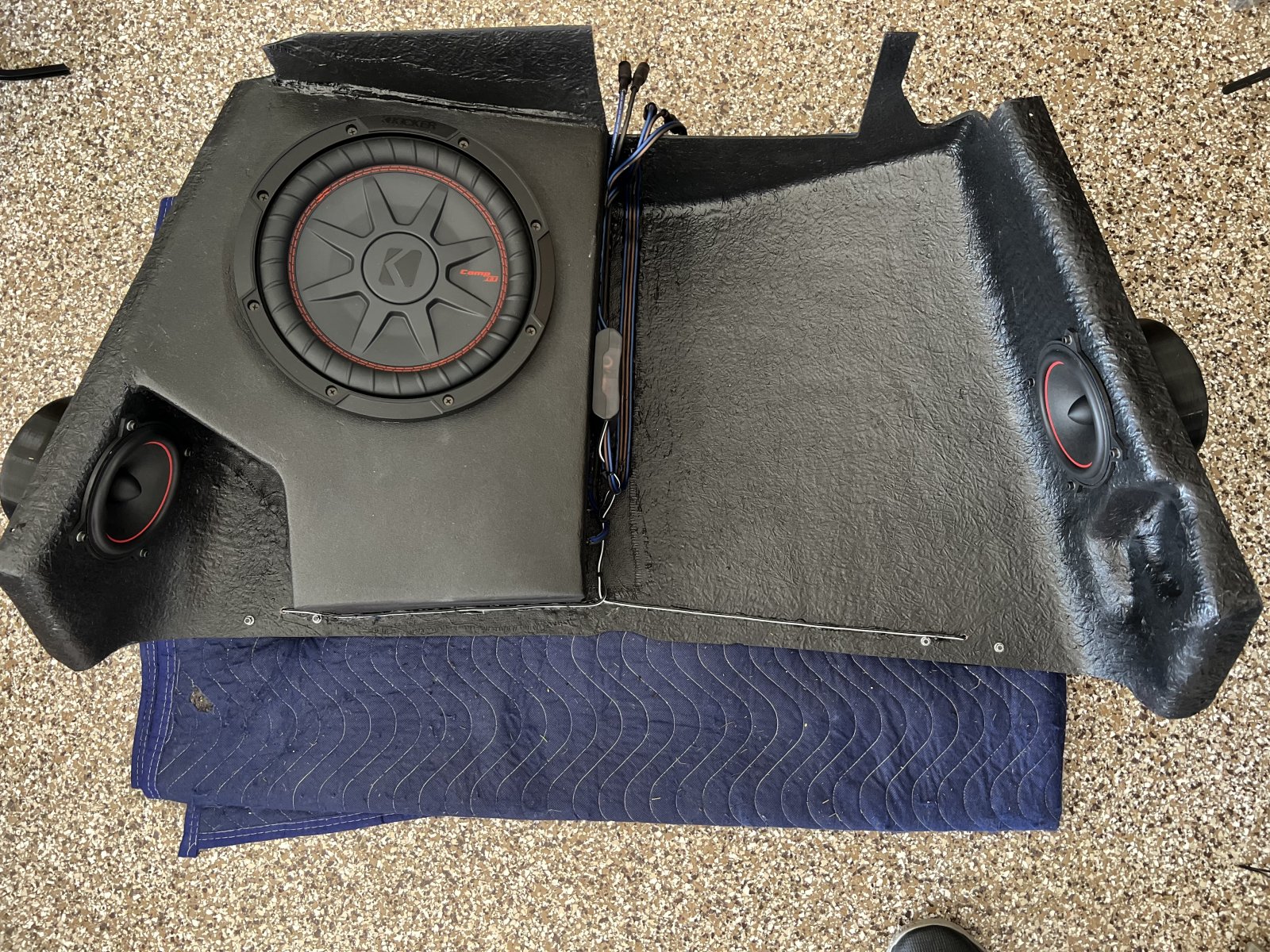

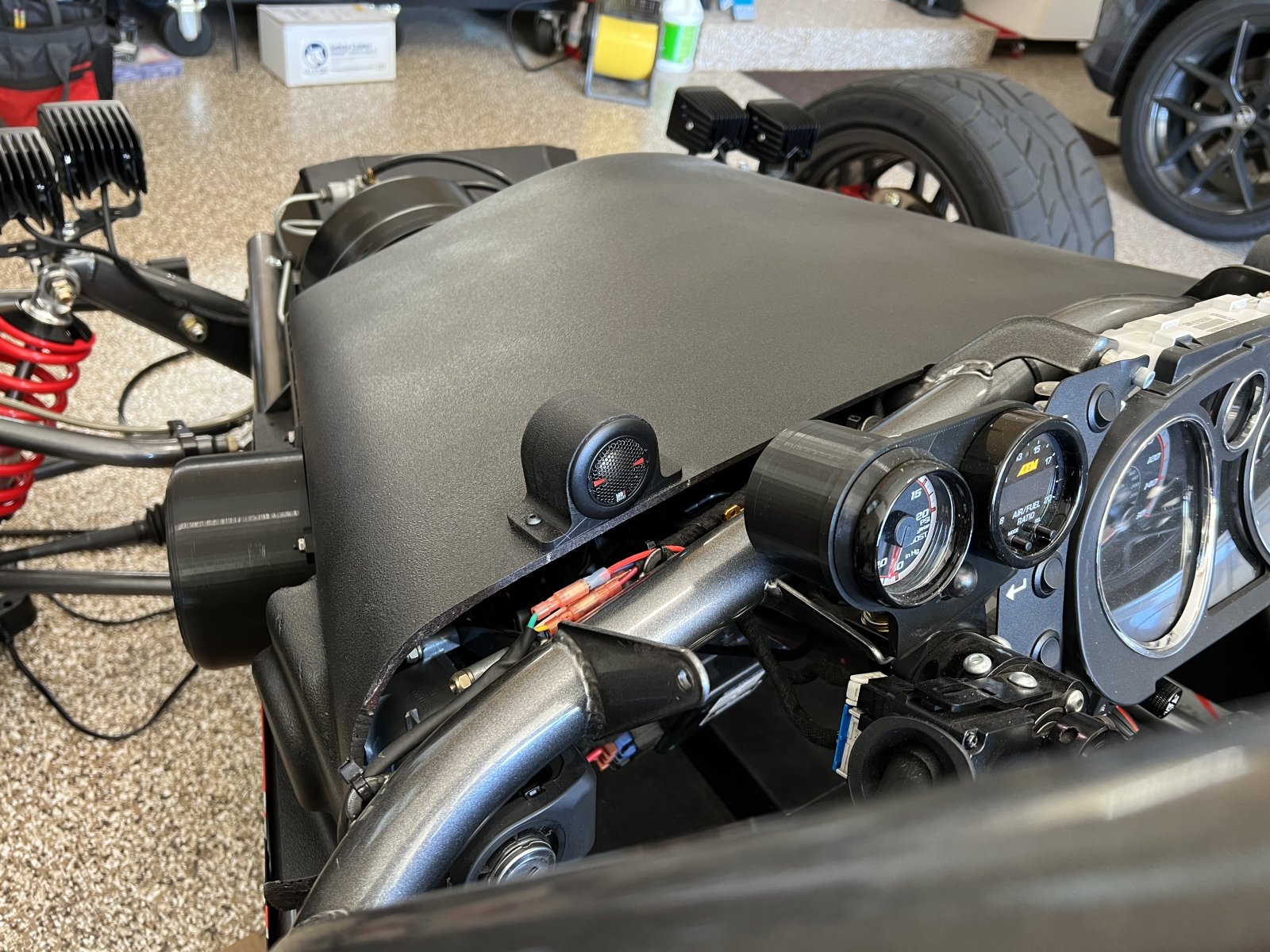

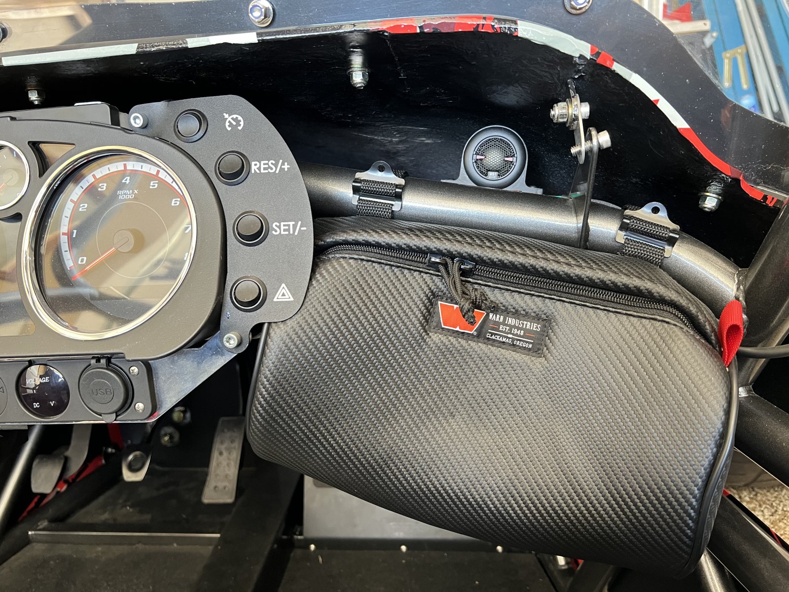

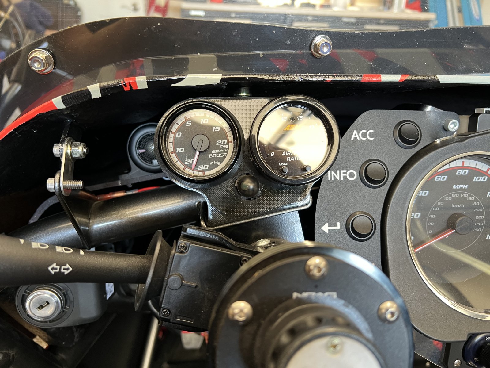

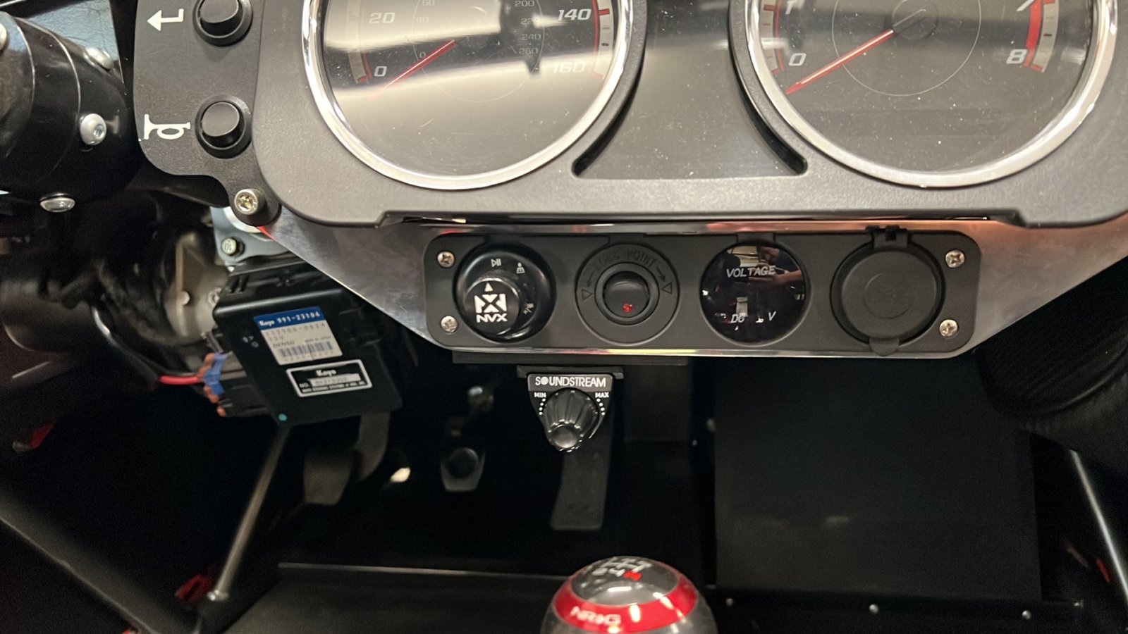

I just recently finished up adding a stereo into my Goblin. Used a NVX Bluetooth receiver as a head unit. I used the footwell cover and built in a fiberglass box for a 10” sub above the passenger foot area, and added 5.25” speakers into the sides of the cover. I 3D printed some pods to protect the back side of the speakers and seal them off more for better mid-bass response. The tweeters were mounted to the top of the cover and face the driver and passenger, so the sound is pretty clear.
I mounted a 2000w marine amp behind the driver seat, and was able to use banana connections to make the cover and speakers removable if needed.
Overall it turned out pretty well, and sounds great for in-town drives. At 55 you can still hear the radio, but it does have to be turned up quite a bit more due to road and wind noise. At highway speed the sound really gets drowned out, and going louder with the stereo is probably not something I’d want to listen to for a multi-hour drive.
So, does the hood fit over that box? This looks great. Did you make a mold? Or is this purely one off craftsmanship?
RITDR
Thanks Paul.
There is no mold for this. I just built walls that close-matched the profile of the footwell cover, and then used fiberglass to mold it to the cover.
Yeah, the hood does still fit over the footwell cover. There is maybe 1.5” of clearance between the hood and the covers over the 5.25” speaker pods. The clearance to the tweeter pods is tighter, but there is still clearance there.
One thing to note for the tweeter clearance is that my hood is raised up about an once at the back of the hood, which adds clearance for these speakers and my gauge mount.

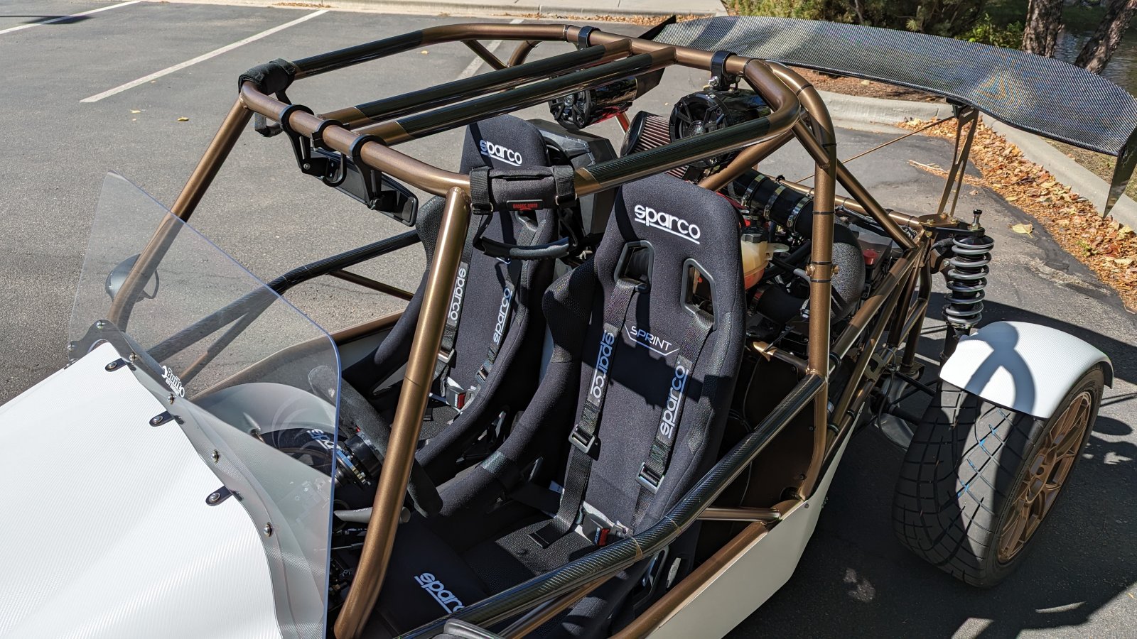

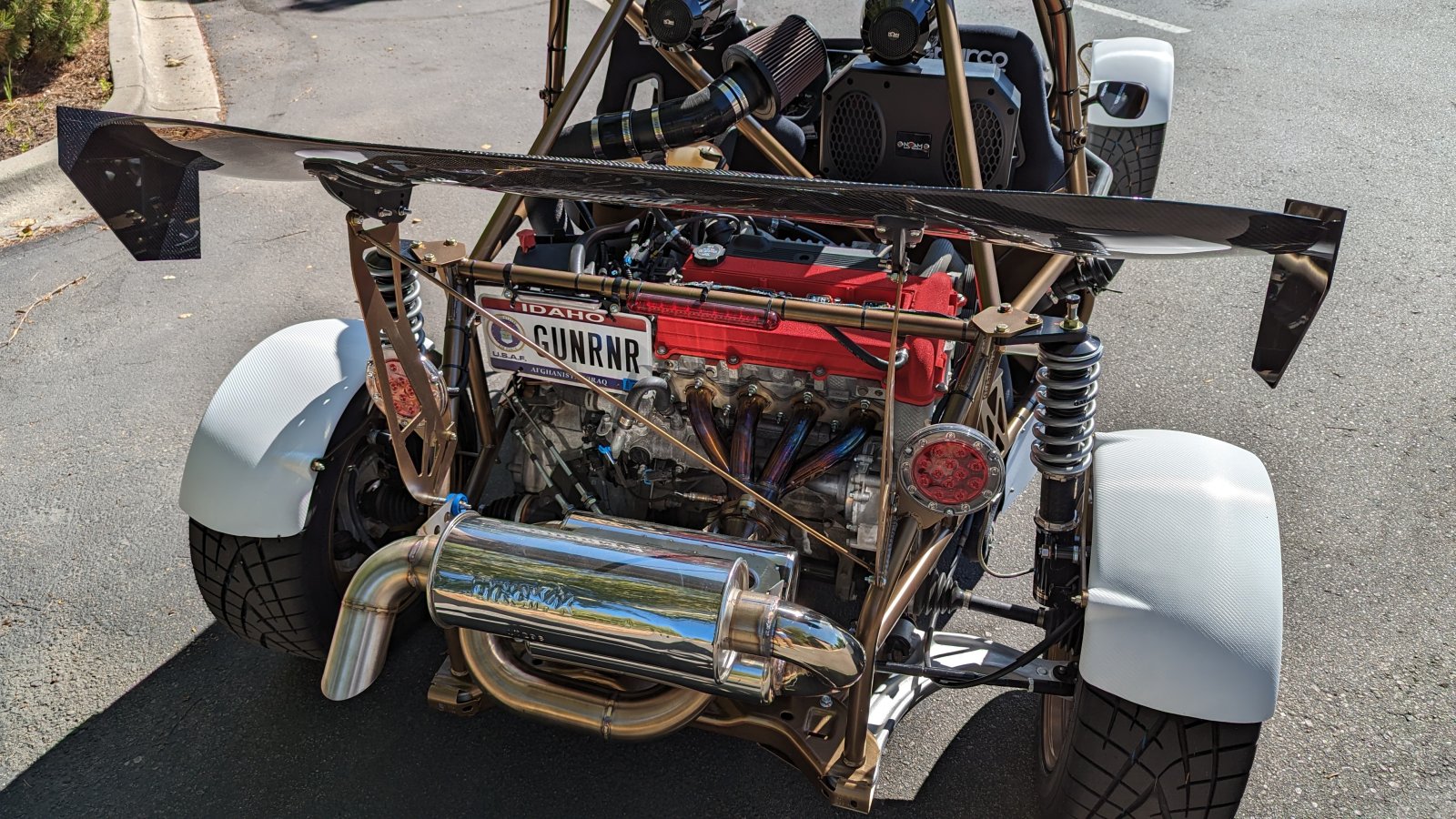

I'm running the NOAM NUTV5 for the second season and really enjoying it. I placed the sub behind the passenger seat and head unit near the ignition. The older head unit is round and fits perfectly in a 3 inch intake tube so I used that to suspend it from the frame.
