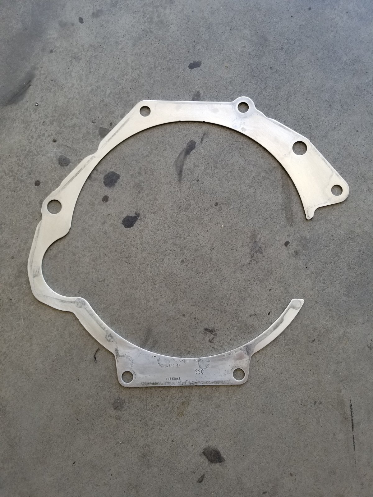

Stupid question for you all but is there a gasket that goes between engine and transmission? Or do you use some form of gasket maker? Just purchased a service manual but it is not here yet.

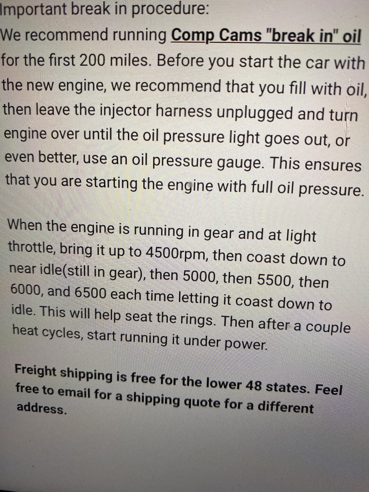

Also any advice on engine break in procedure is much appreciated. I have been doing some research on varying rpm's and break in oil/frequent changes but I am a newbie.

I have some sort of aluminum midplate/spacer guy between the engine and trans (LSJ here), I'm sure someone else will have a more correct name for it. I can get a picture when I get home tonight. But no gasket or silicone or anything like that.

there is an aluminum spacer plate that goes between. It has a cutout on bottom no gasket or silicone
This is what I did to break in my ZZP engine
One of these. Yes, the aluminum spacer is required to correctly mount the manual transmission.

Do you know what it means when they say "after a couple heats cycles" and "start running it under power"? I feel pretty stupid for asking. I think I know but I want to be sure.
A heat cycle is starting with a cold engine, bring the engine up to full operating temperature (drive 5 miles or more), then let it cool down to cold again. That is 1 heat cycle. Repeat this a few times before going on to the next step.
Start running it under power means to start using more throttle, and applying more torque to the engine and drivetrain. When you first start running a new engine, don't go over 25% throttle. Later in the break in, use 50%, then 75%, etc.
