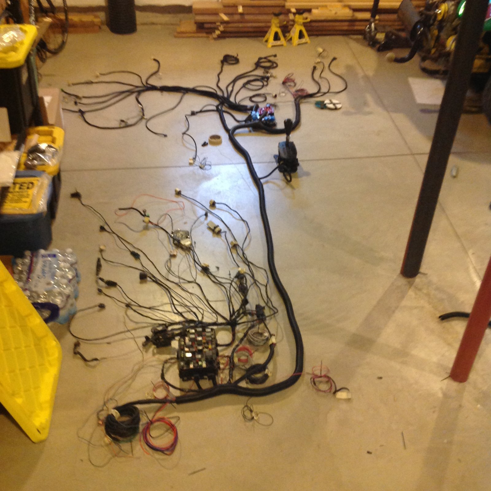

Electrical after reworking. Looking forward to getting it into the car.

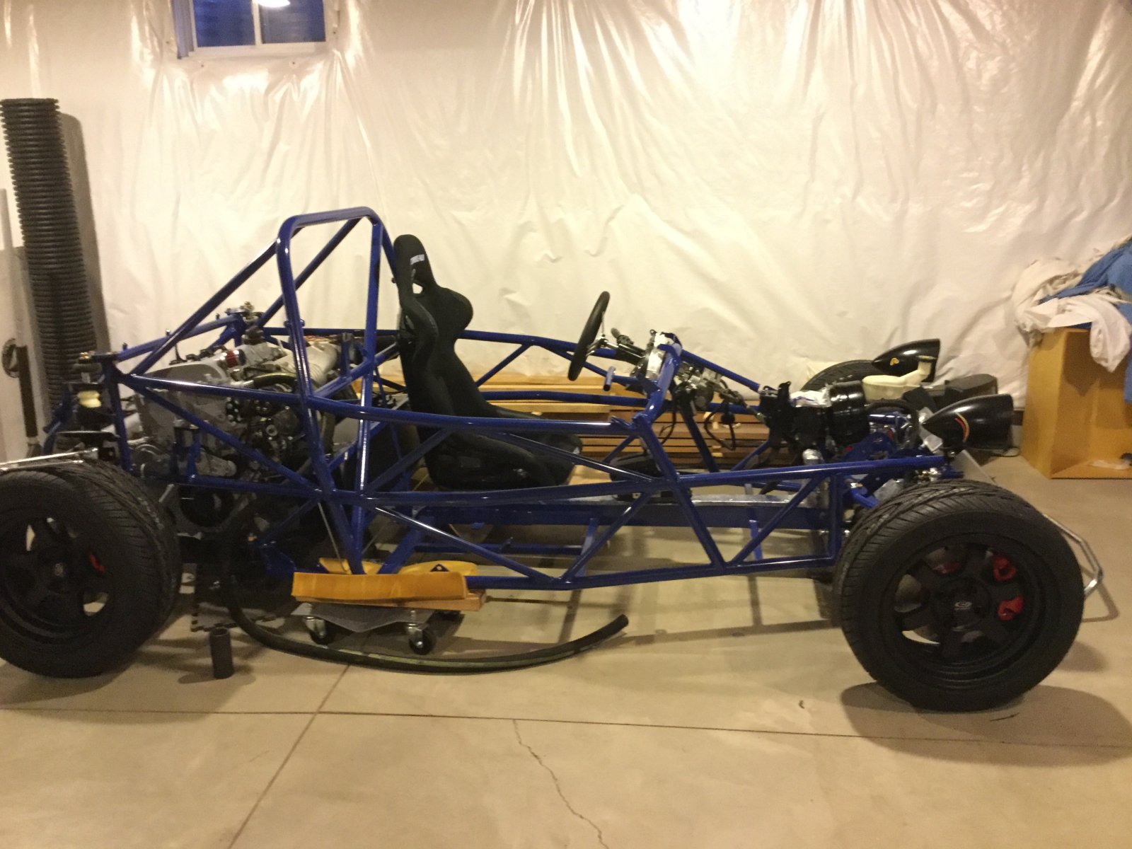

Here is a quick photo of the "blue" goblin up on is wheels. Just waiting on some spacers and that will complete most of stage 1&2. Will be getting into the electrical next week.
Adam
BAR-AIR didn't receive all of the engine mount spacers for the automatic setup. You should have two engine mount spacers that are 1/2 inch long and three that are various lengths, all over 1 inch long. He is also waiting on the strut mount spacers for the rear. We mailed those out to him and the rest of you first builders so expect a package soon.

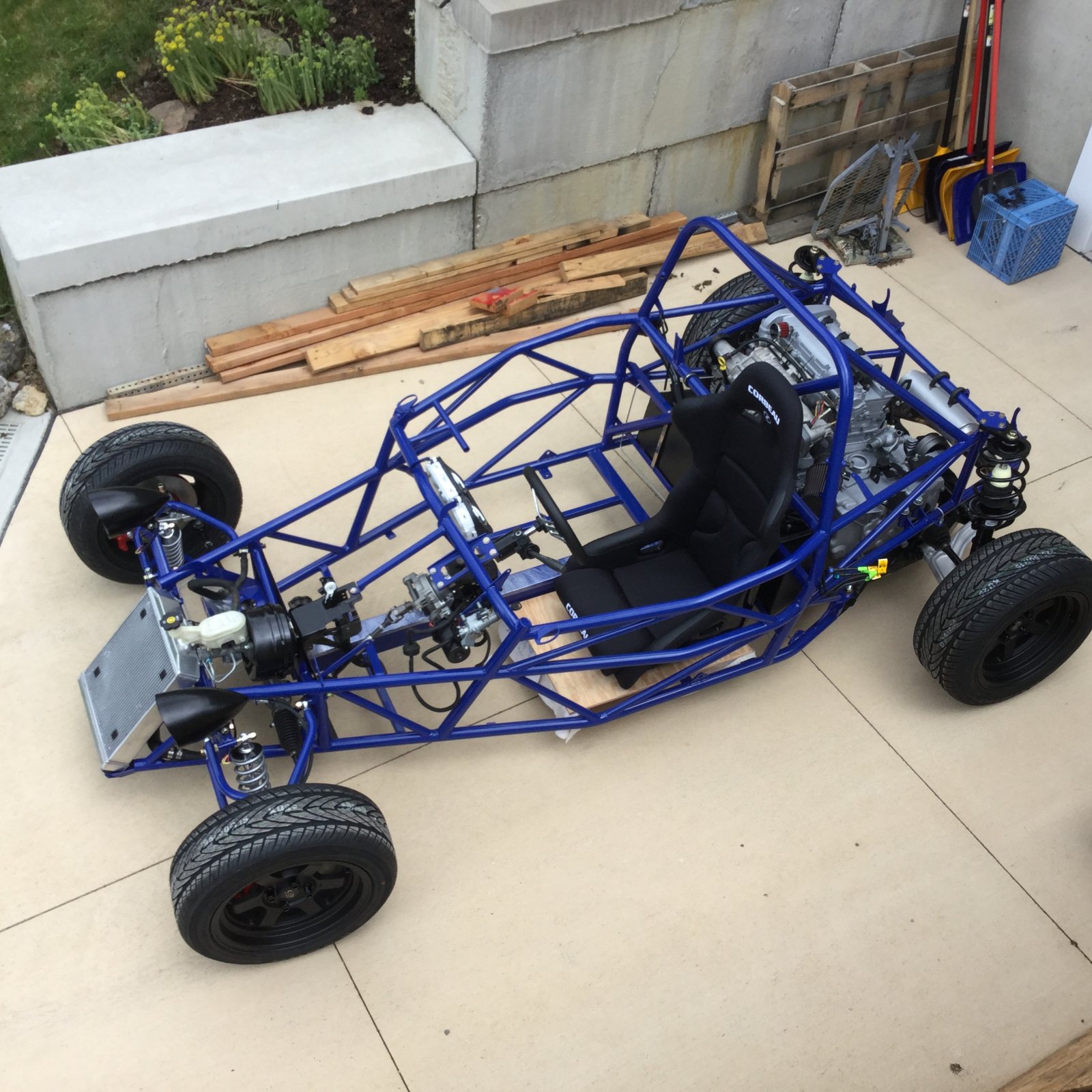

Here is a photo of "Blue" sitting all on her own. Spacers showed up in the mail today. (Just a quick note... I would like to thank Adam and crew at Doyle.... getting all the parts and pieces made sorted bagged and shipped is an enormous task especially on the first couple of kits. Realistically I am amazed at how little that was missing and that Adam has gotten everything that was missing to me as quickly as he could.)

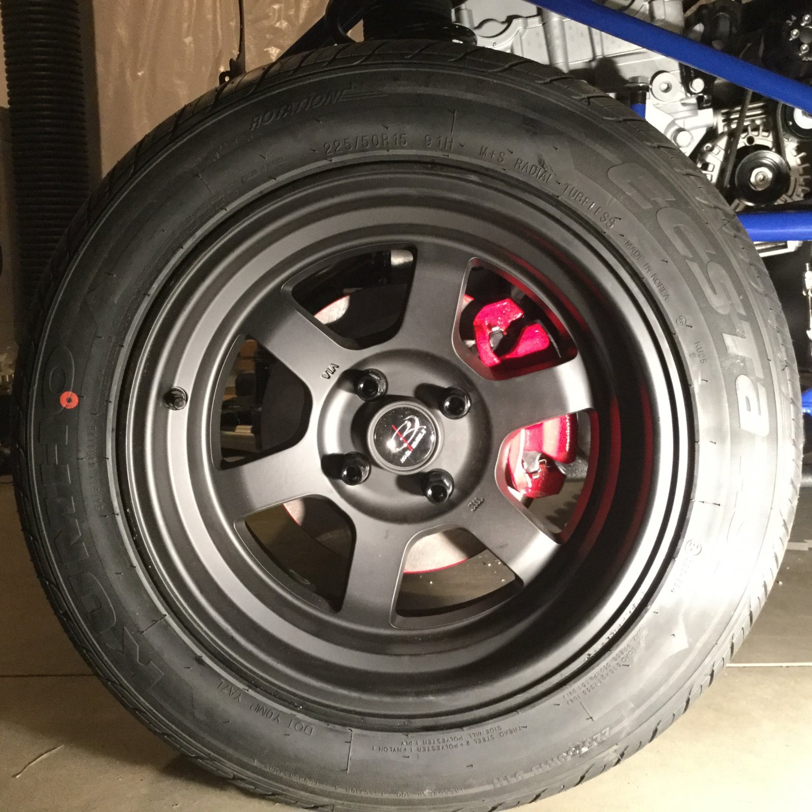

Here is a photo of the rear rim. Again Rota V rim 15x8 with a 0 offset. (Was trying to get the tires to line up better with the 1" (26 mm) wider rear. I pushed the fronts out with the 15 offset and the 3 mm shim). Tires are Kumho 225/5oR15. As I said in an earlier post if I did it again probably would have went with 16's in the rear there are a lot more tire choices with the 16's.

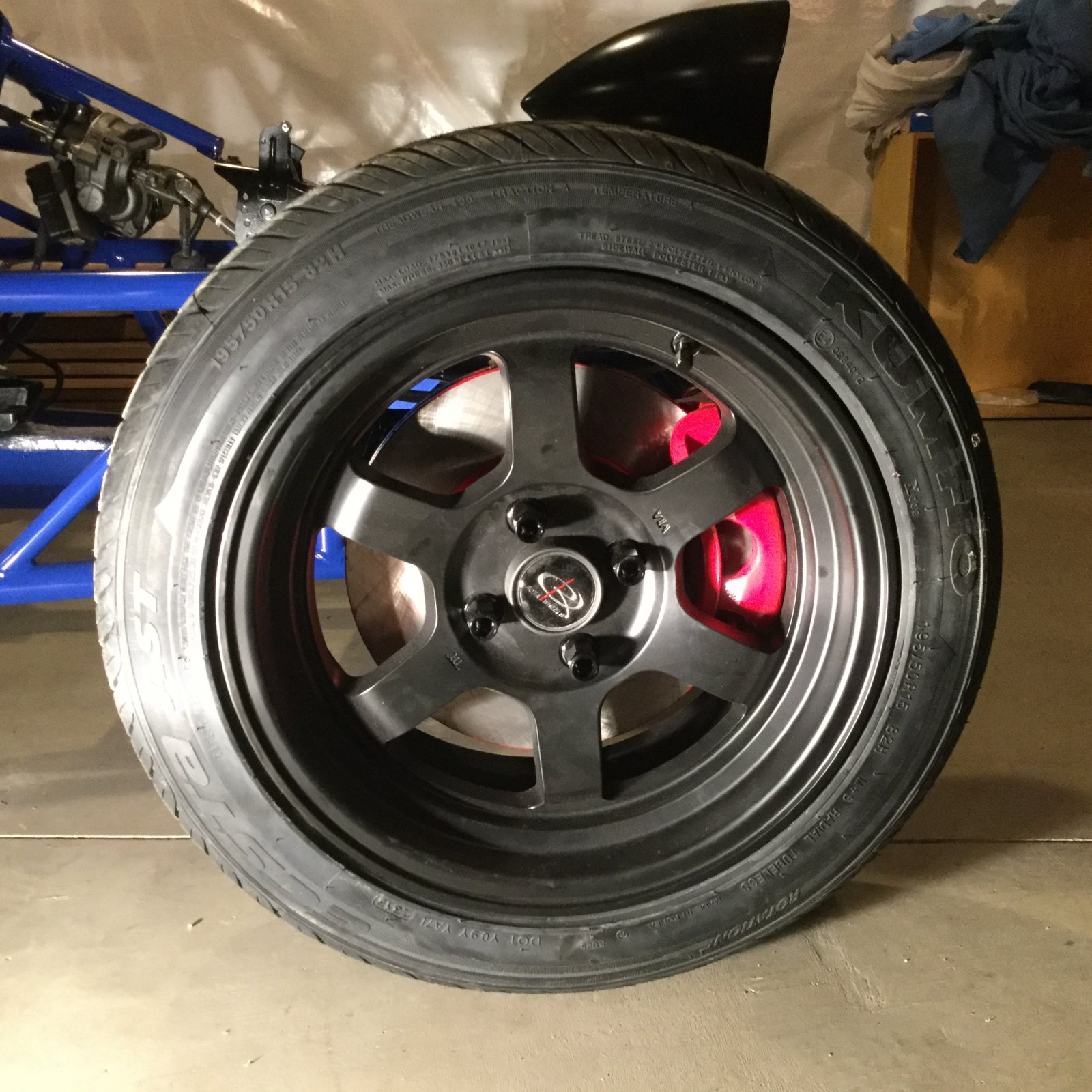

Here is a photo of the front tire. It has Rota V rims 15x7 with 15 offset. (Rims are nice) The tires are Kumho 195/50R15 they look good but the balance on them was terrible. Also I did have clearance problems with the caliper. Ended up re shaping the caliper and adding a 3mm shim to the rim.

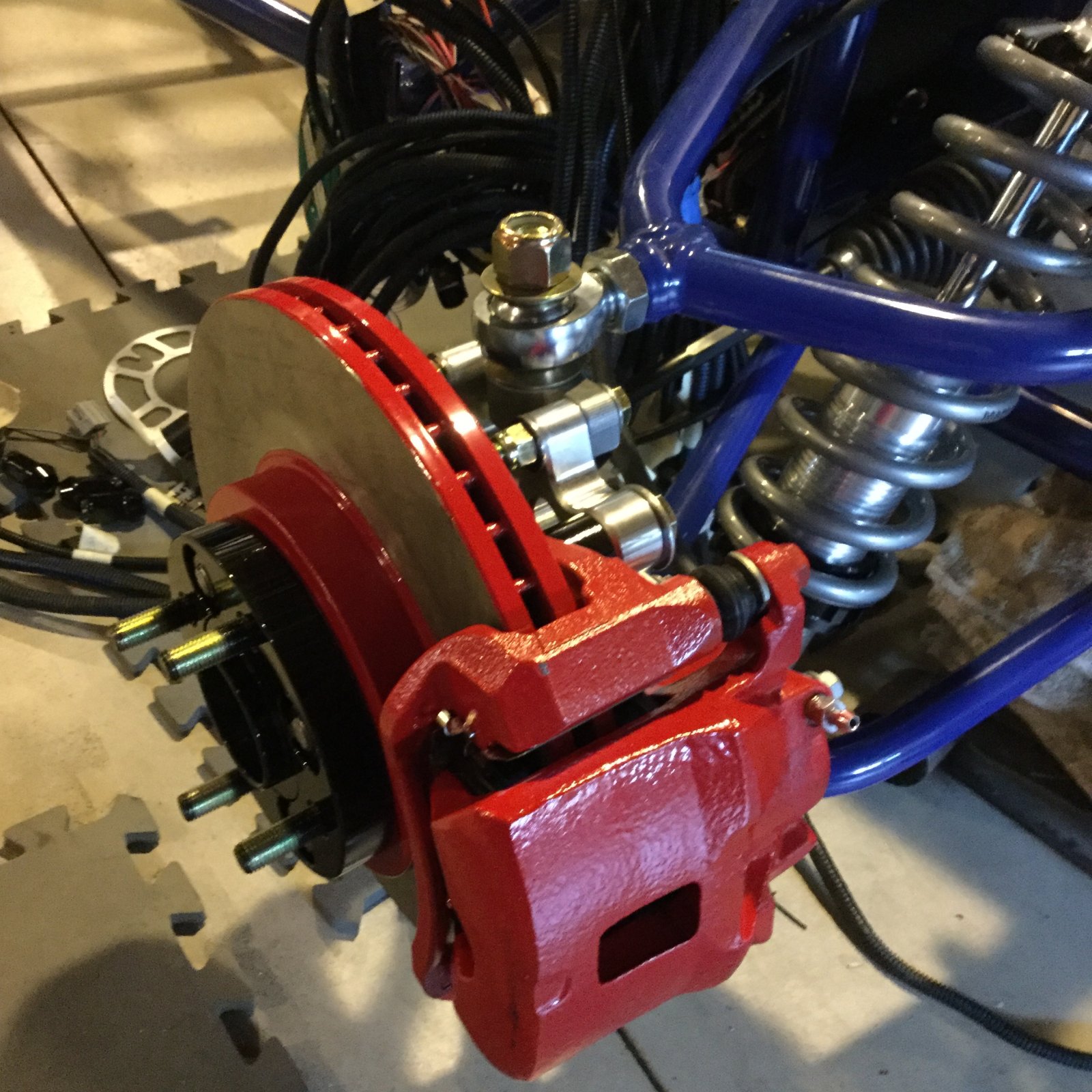

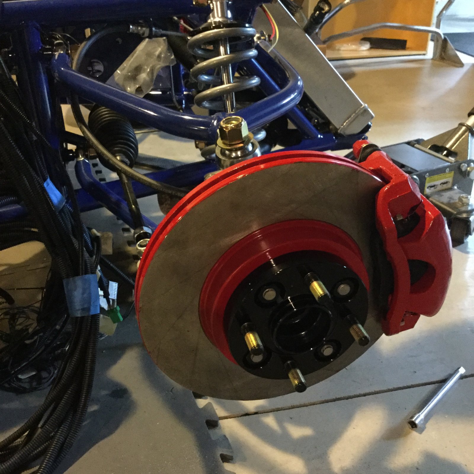

Just wanted to give a quick update with the wheel combination on the BLUE goblin. Ended up having an issue with the length of the wheel studs I believe (Adam would have a better knowledge) that the steel wheel studs are shorter then the aluminum wheel studs. That being said with the new aluminum wheels I was only having about 6 complete turns of my lug nut before they were tight. So I was going to have to go with longer studs and still use 5mm shims for clearance with the calipers or go with bolt in spacer plates. Ended up going with 20mm spacer plates and cutting the unthreaded part of the stock stud off for clearance with the rim. All and all not real noticeable you see a little more of the caliper not a bad thing.
