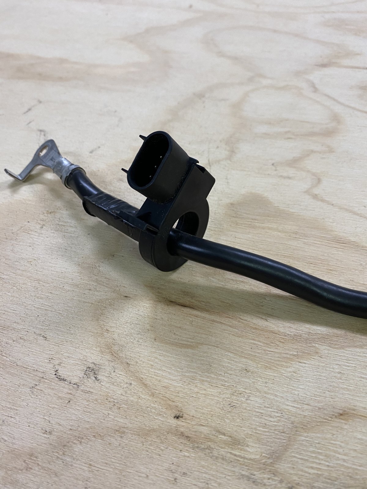

I thought that the ‘09 SS/TC did not have the battery current sensor. But when I went to install the negative battery cable, there was a ground sensor installed on it. When I thinned the harness, I don’t recall having a connector for it. Can I remove it from the negative cable?

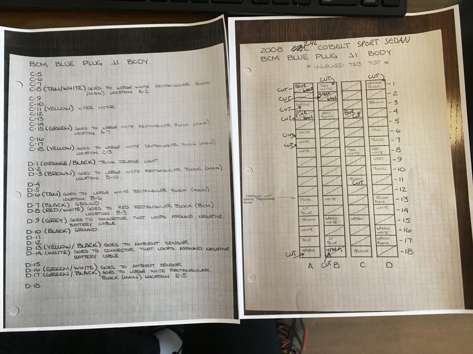

I have the sensor and from what I heard, is that you do need the sensor. I will have to check but it is connected to the BCM. Give me a moment and I will send pictures and the pin outs if you have to re-insert.

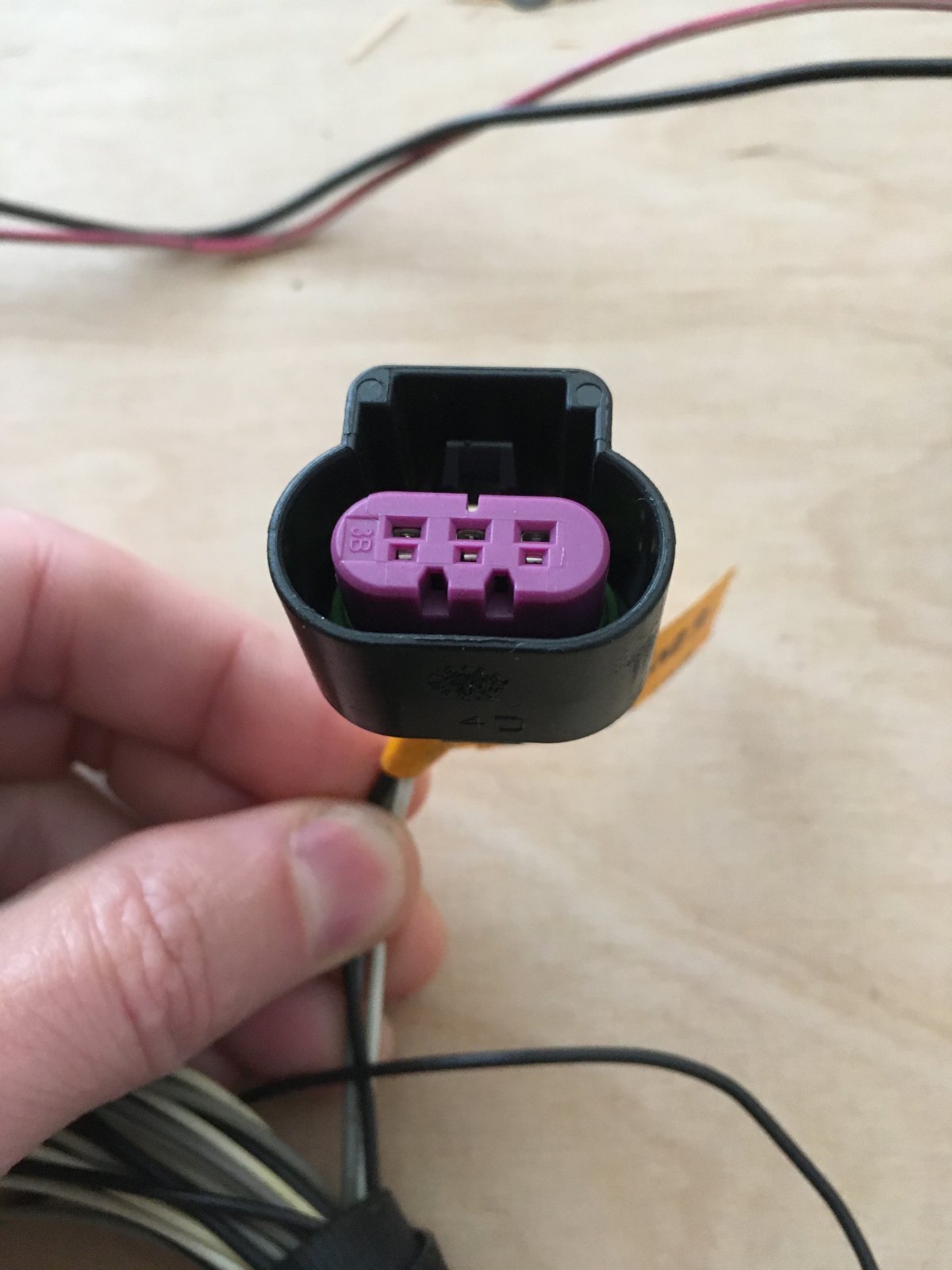

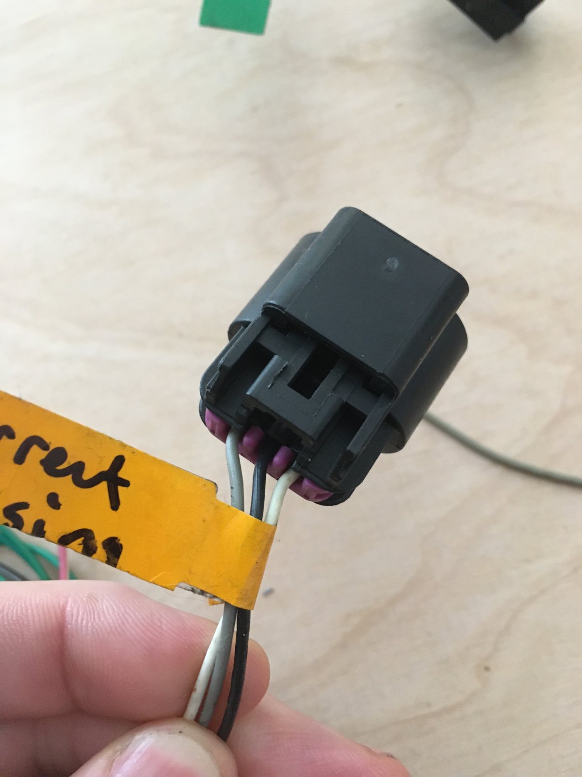

Below is the picture of the sensor plug.
The white and grey connect to the Blue chassis BCM plug at D9 and D14 and the black ground to a grounding lug.
I hope that helps.
Joe
View attachment 20580View attachment 20581
I hope that helps.
Joe
Thanks Joe. I’m sure that I didn’t remove the connector. I’m thinking that when my ‘09 TC was built they just used a battery ground cable with the sensor already installed. However if I run into issues, I’ll use your document to connect it.
