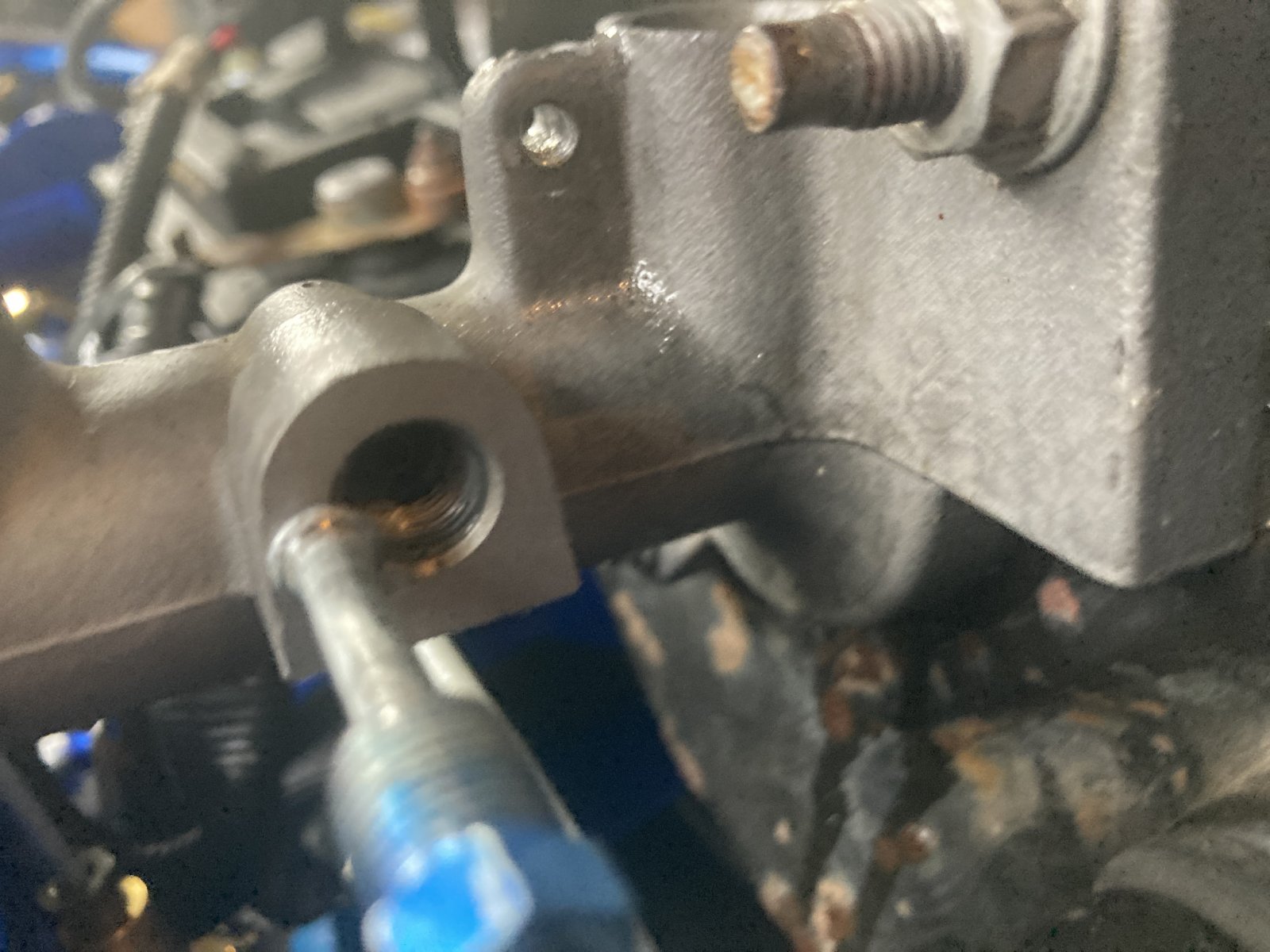

Tried bleeding the brakes today and couldn't get much to work. Found a few leaks that have been taken care of but when I try to bleed them I cant get any vacuum on the hand pump, I have to countinously pump it to get much of a vacuum at all. I am assuming there is another leak somewhere but wasn't sure if it could leak only air on none of the brake fluid. I also turned the bleeder valve 1/4 turn.
The vacuum bleeder I use is driven by an air compressor. Just go back to the basics like sluggo said. Loosen the master connections and wait for fluid to come out. Then open all the bleeders at the calipers and wait for fluid. Close them all off then roll the old school way of push and hold the pedal down, then open one bleeder at a caliper. the system is empty. It takes time.
K

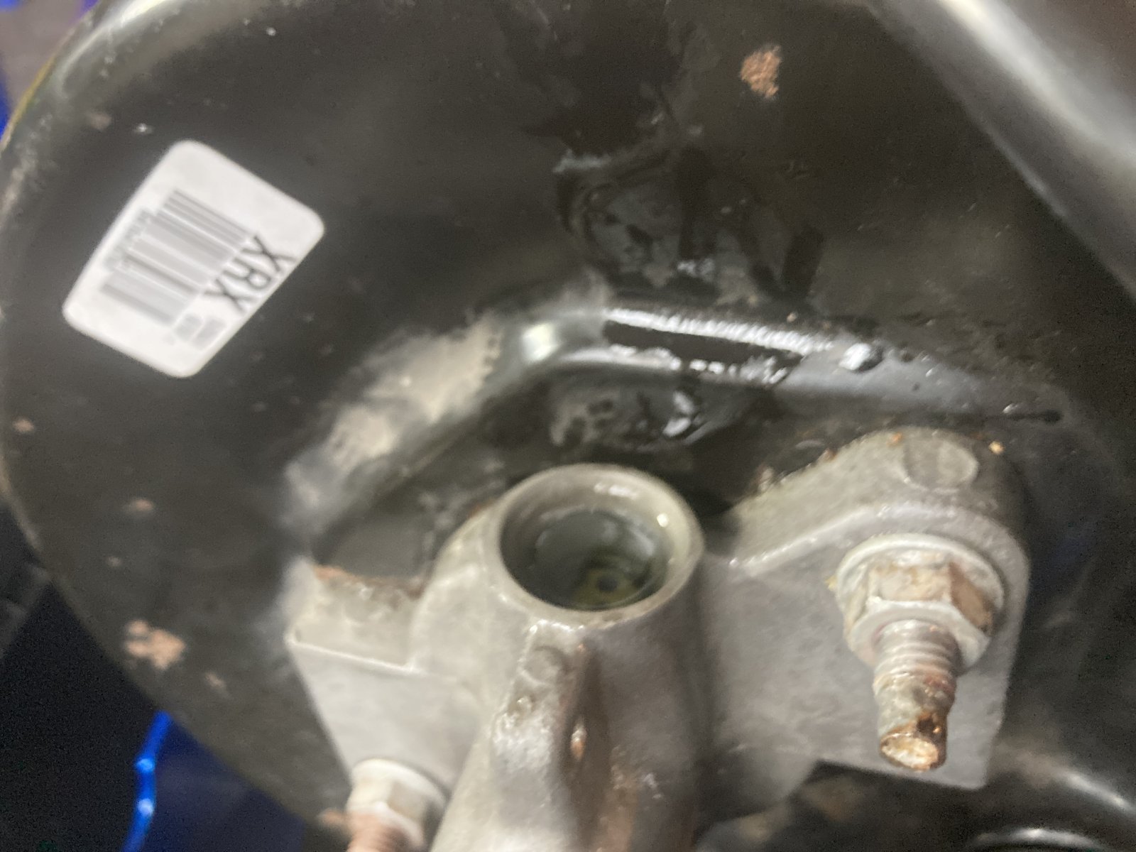

Tried cracking the screws on the master cylinder and found that the line that connects to the front brake is getting no fluid while the line the the rear brakes is getting fluid. I have fluid pooled in the connection point and the connection unscrewed and no brake fluid is coming out of the connection.
Not sure what is causing this.

You can take the MC off and bench bleed it. See if you get fluid that way. Just Loogle Bench Bleeding for a video.
If that doesn’t work, you may be in for a new MC.
Also, make sure the brake lever is fully retracted. If the plunger is pushed in at all on the master cylinder, it will not flow fluid.

Thanks for all the suggestions, I ended up ordering the hand pump kit and it is coming today and I will try using it probably sometime this weekend. I used some TFE paste on all of the connections and they are starting to seal up better but I am pretty sure there are leaks because I keep pulling air through when I am bleeding it.
TFE paste on the fitting threads? The threads are not the sealing surface for the brake lines, the flare on the tube against the chamfered (cone) surface on the fitting is what seals the line. Unless you get the flare to seat 100% against the fitting chamfered the lines will leak - fluid or air.
The lines need to be very tight to achieve thIs. Sometimes by tightening and loosening the line can help it seat better. And this is the reason I posted the flare lapping tool.
The lines need to be very tight to achieve this. Sometimes by tightening and loosening the line can help it seat better. And this is the reason I posted the flare lapping tool.
When I installed mine clutch and brake lines, I tightened them and then loosened them. Then I re-tightened the lines until they were tight. I did not have any leaks on my hydraulic system using this method. Lonnie mentioned doing this in the videos, so I did it as well.
