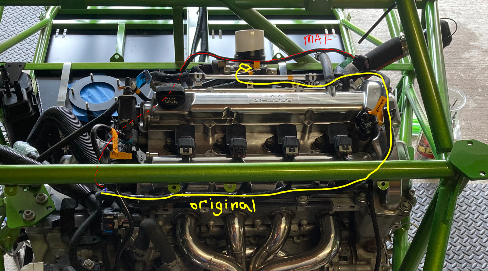

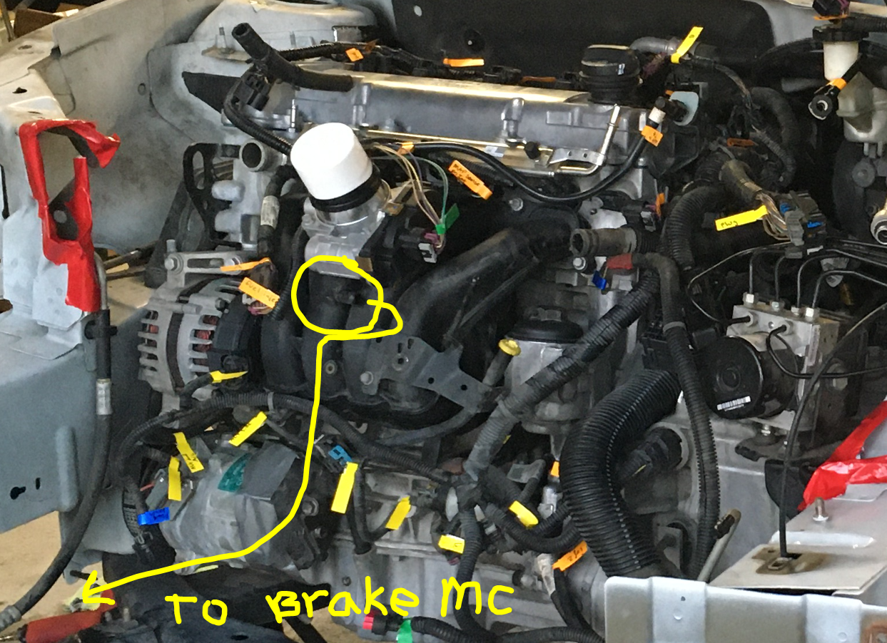

This is how I unwrapped my MAF wires. Yellow was original routing and the red is current which allows the intake to be anywhere.
39384

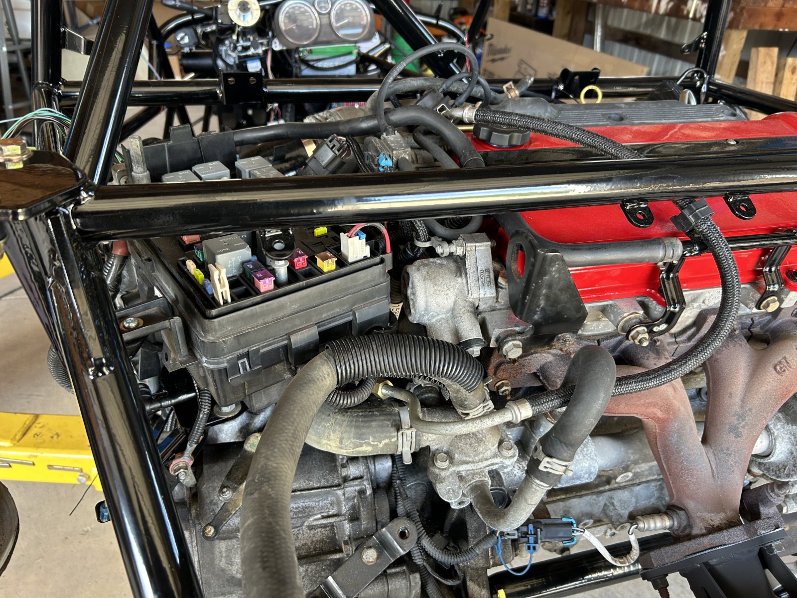

The brake booster vacuun hose goes to the front of the intake manifold below the TB

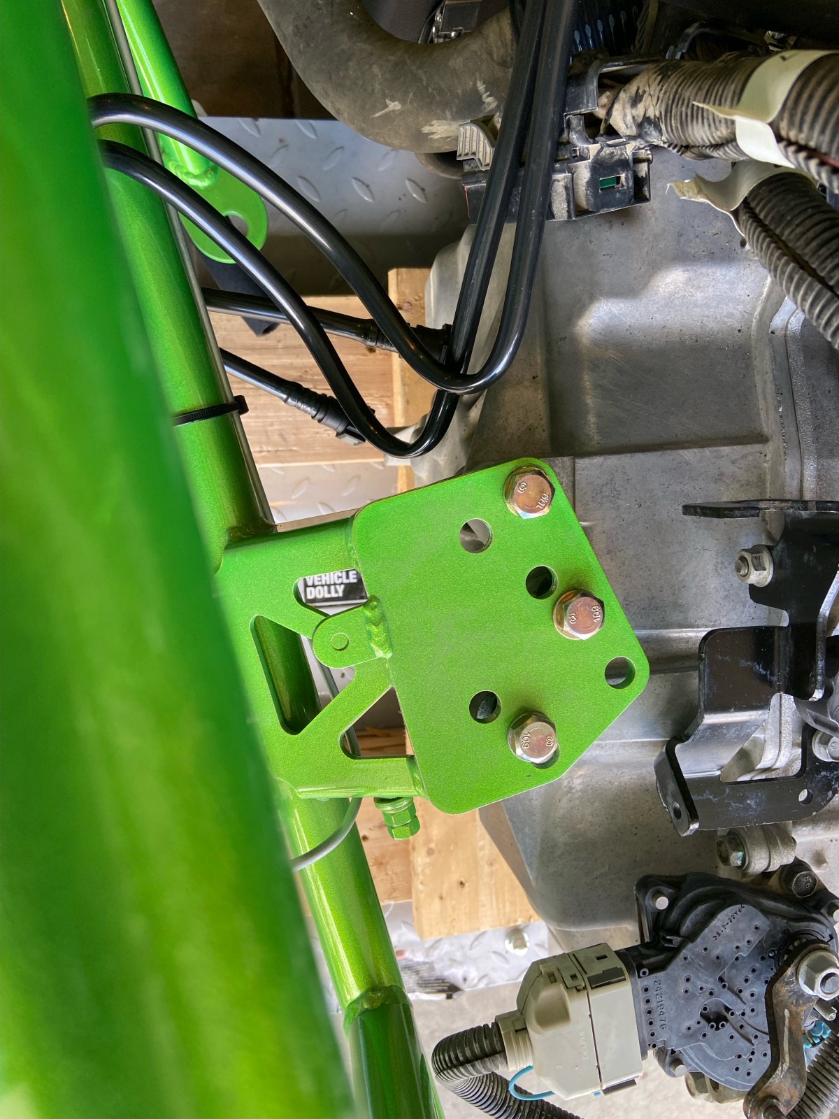

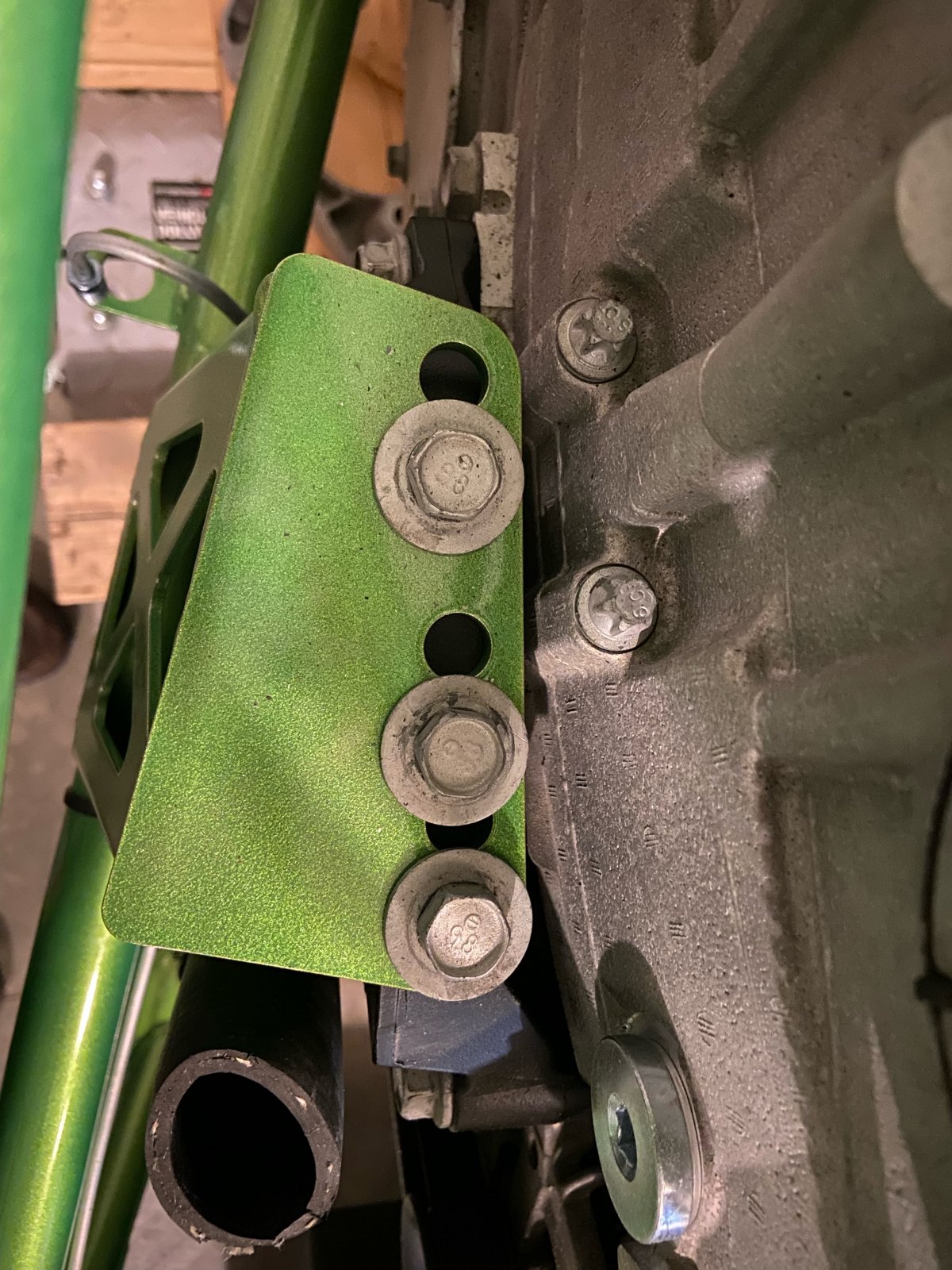

For example, we just put the engine on . . . mostly. Here is our problem today, and I think it is a big one.

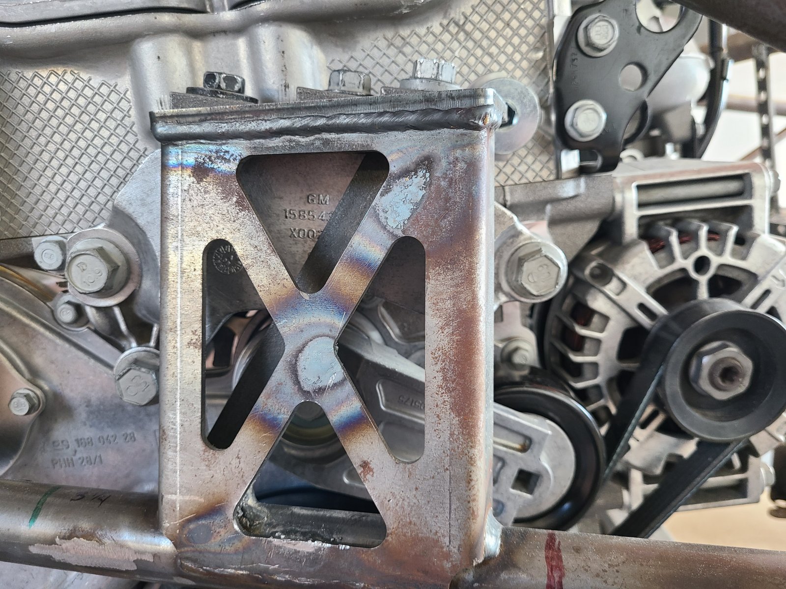

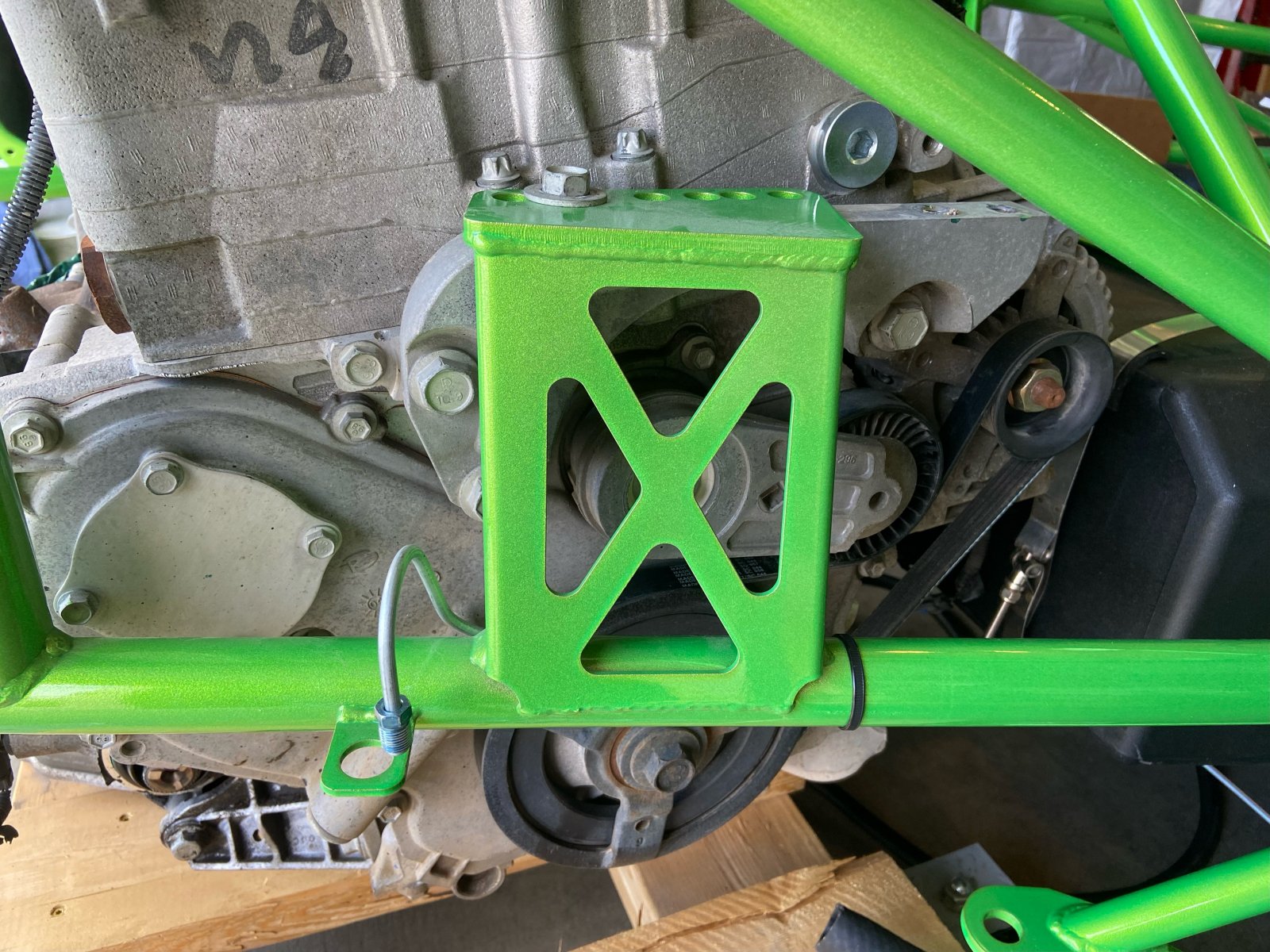

Only one hole on the engine mount side fits in the frame attachment. Seriously!!??
The transmission sides fits and mounts perfectly.
We run into this all the time with our car. I think it must have been one of the first ones off the line in '05 and they hadn't specialized parts and fittings to the cobalt yet.
Anyway, what should we do? I'm guessing one bolt on the engine side is not enough. Please advise . . .
Blue Man
Okay, moment of panic and frustration over with. I went online and ordered a new engine mount. According to some of the reviews, they changed the engine mount design early on and we have the old style.
No biggie, just too bad. This was the only time for the next three weeks I had to dedicate to the car. Wanted to start it this weekend. Oh well, we can start on other things.

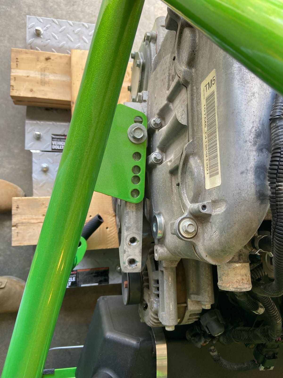

Okay. Got the mount and installed it. That taken care of.

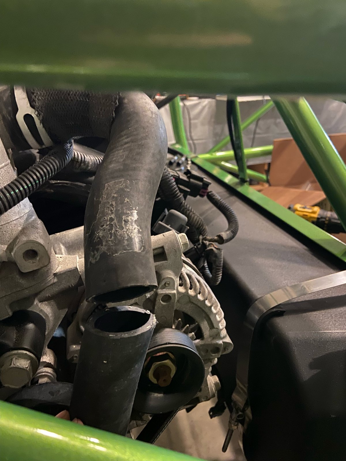

I got confused by a lot of that too. Here's what I did for the passenger side:
39834
Pretty sure the video says to cut this hose and use half on the drivers side and half on the passenger side, but they don't supply enough couplers or clamps for that. I found that the supplied hose fit without cutting it. Haven't figured out what to do on the drivers side.
