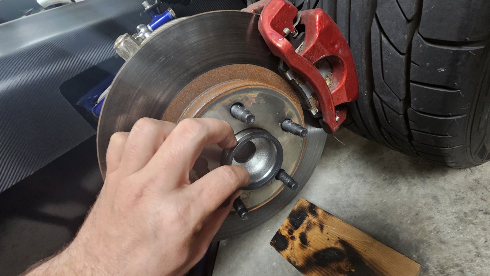

Hi Forum,
I noticed when I worked on my rear axle that the wheel hubs have no hole/thread for the liittle counter sunk screw to secure the break rotor. I guess that's normal?
Another question: The outside diameter of the hub is a little bit smaller than the inside diameter of the rotor. Is there usually a spacer which makes sure the rotor sits concentric with the hub?

Got my delivery from DF with the centering rings. Please see this video of the rear breaks on my Goblin. The Center rings are to small. They have the same outside diameter as the hub.
I pulled the front wheel and checked that as well, same thing. Center rings do not fit.
