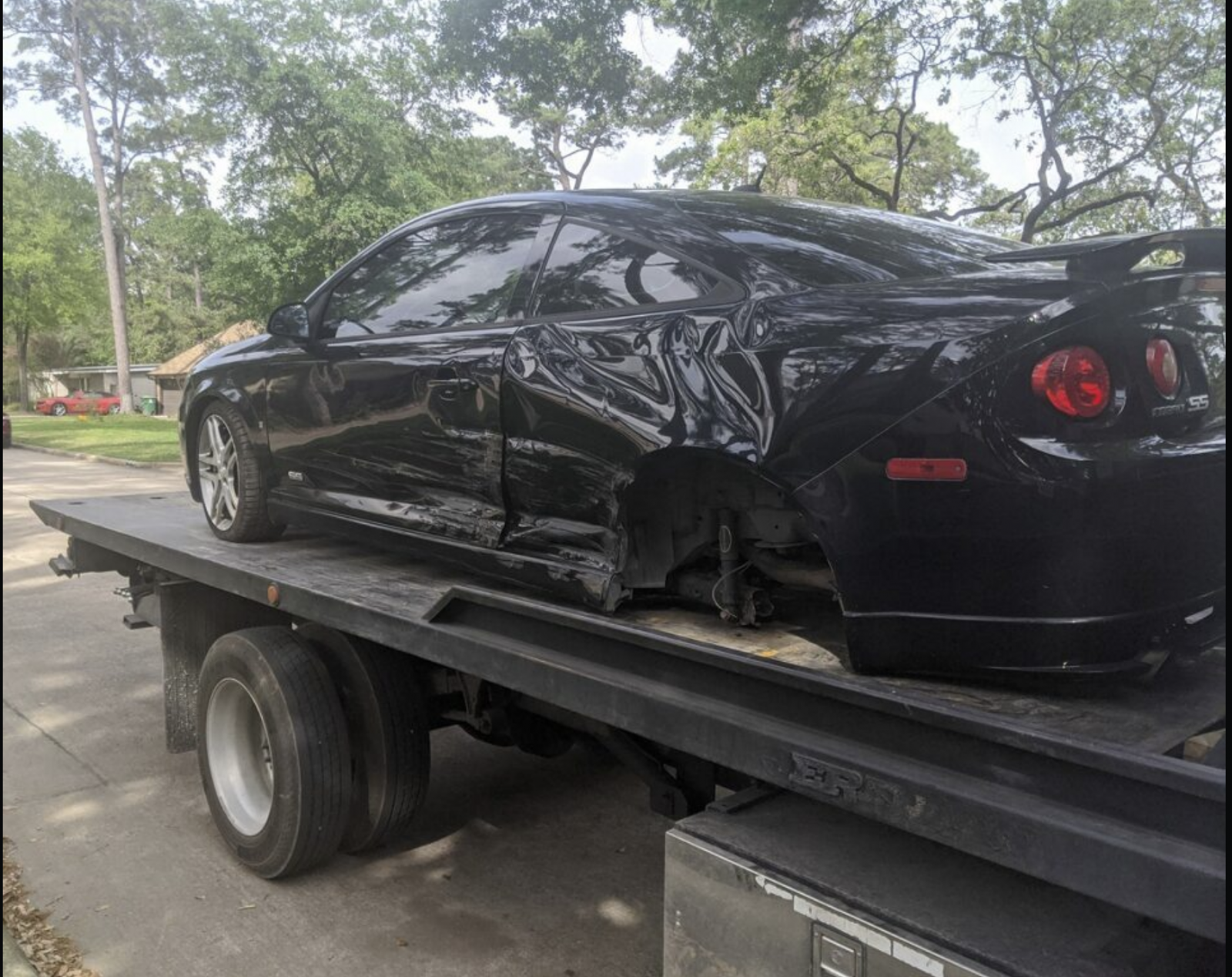

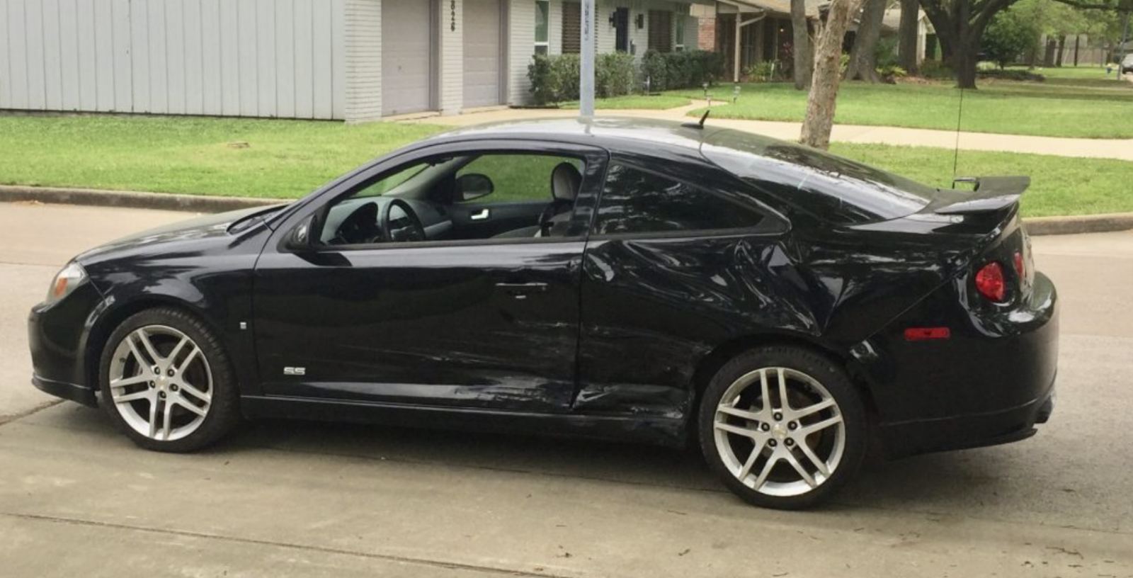

Initially, I started searching Facebook Marketplace / Craigslist for a TC donor however the prices were more than I wanted to spend. I setup searches on Copart and IAAI for the Houston area and eventually a 2009 Cobalt SS became available. I believe that was in February 2020. I noticed that with Copart and IAAI, when a car was listed it might take several months for the vehicle to be schedule for auction. I assume that this is due to insurance / legal issues that are waiting to be resolved. However, for the vehicle I found, an auction date was listed after about 5 days. Now I had 2 weeks to figure out how to bid with IAAI.
In my case, I chose to go with SalvageBID for the broker to purchase the Cobalt. They were easy to work with and I won the auction with a bid of $1,400.00. After fees, cost was $2,204 for the vehicle. Delivery was another $196 for a total of $2400. I ended up with a 2009 Cobalt SS that had be t-boned in the back left. The left rear wheel had been ripped of and the rear axle was broken.
18050
After a quick trip to the local pick-a-pull junk yard and picking up a replacement axle. I was able to get the Cobalt back on all four wheels. However, I was unable to find a spare rear axle for an SS with disc brakes (at a reasonable price). Due to this, the rear brakes were plugged with a bolt and the brakes were kind of sketchy. Once I checked the fluids and charged the battery, the car started right up.

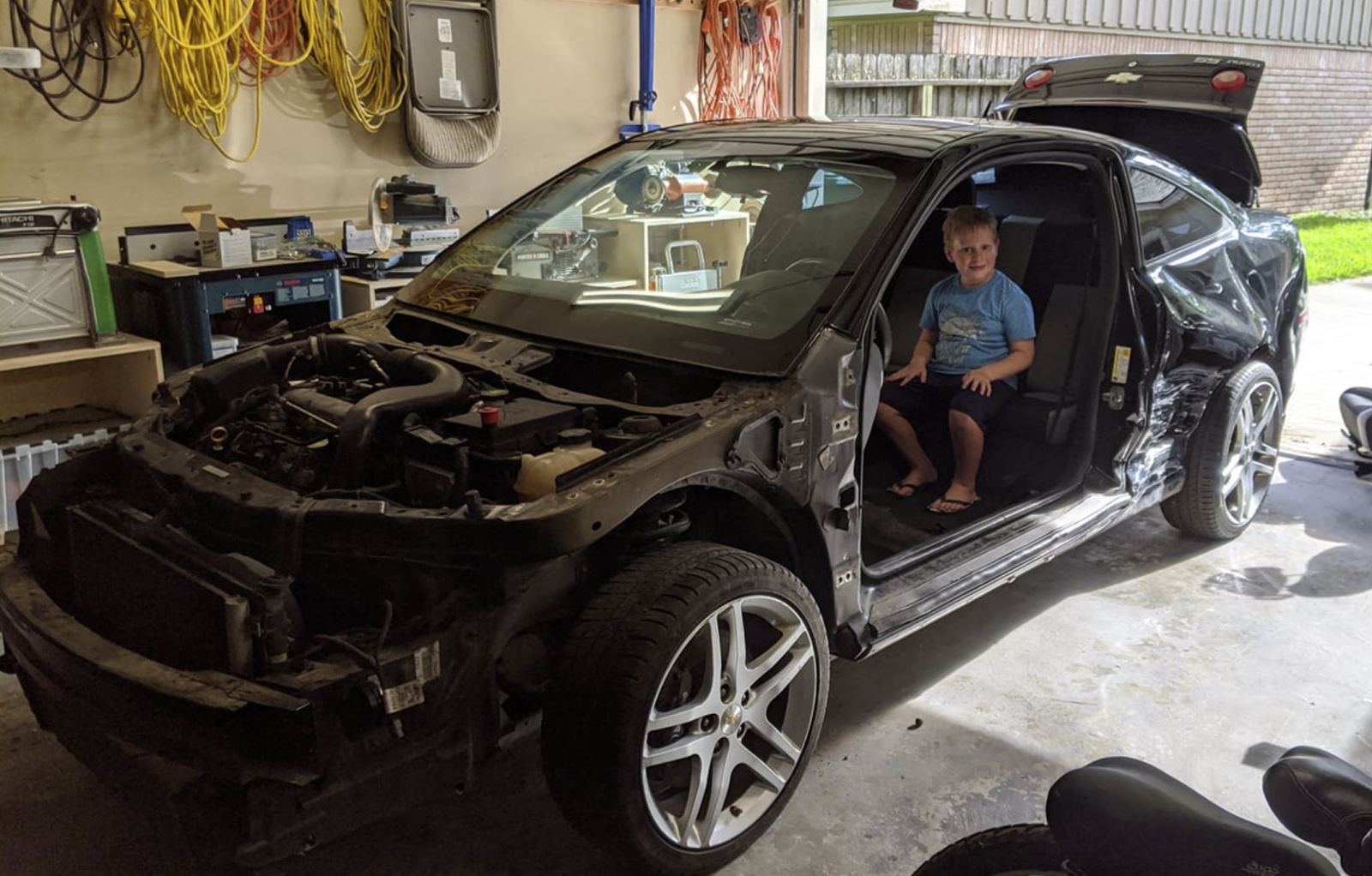

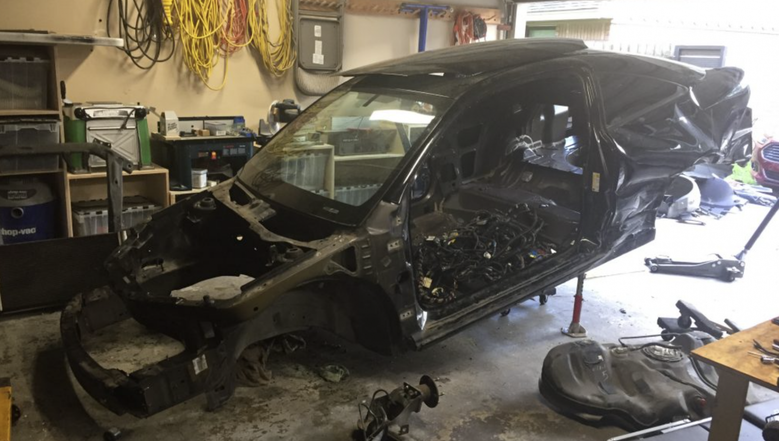

In July of 2020, my son and I spent about a week stripping the donor. We were able to sell off several parts and netted about $600 in revenue. Honestly, I was less concerned about recovering cost from the donor and more concerned about my HOA complaining about a vehicle without plates.

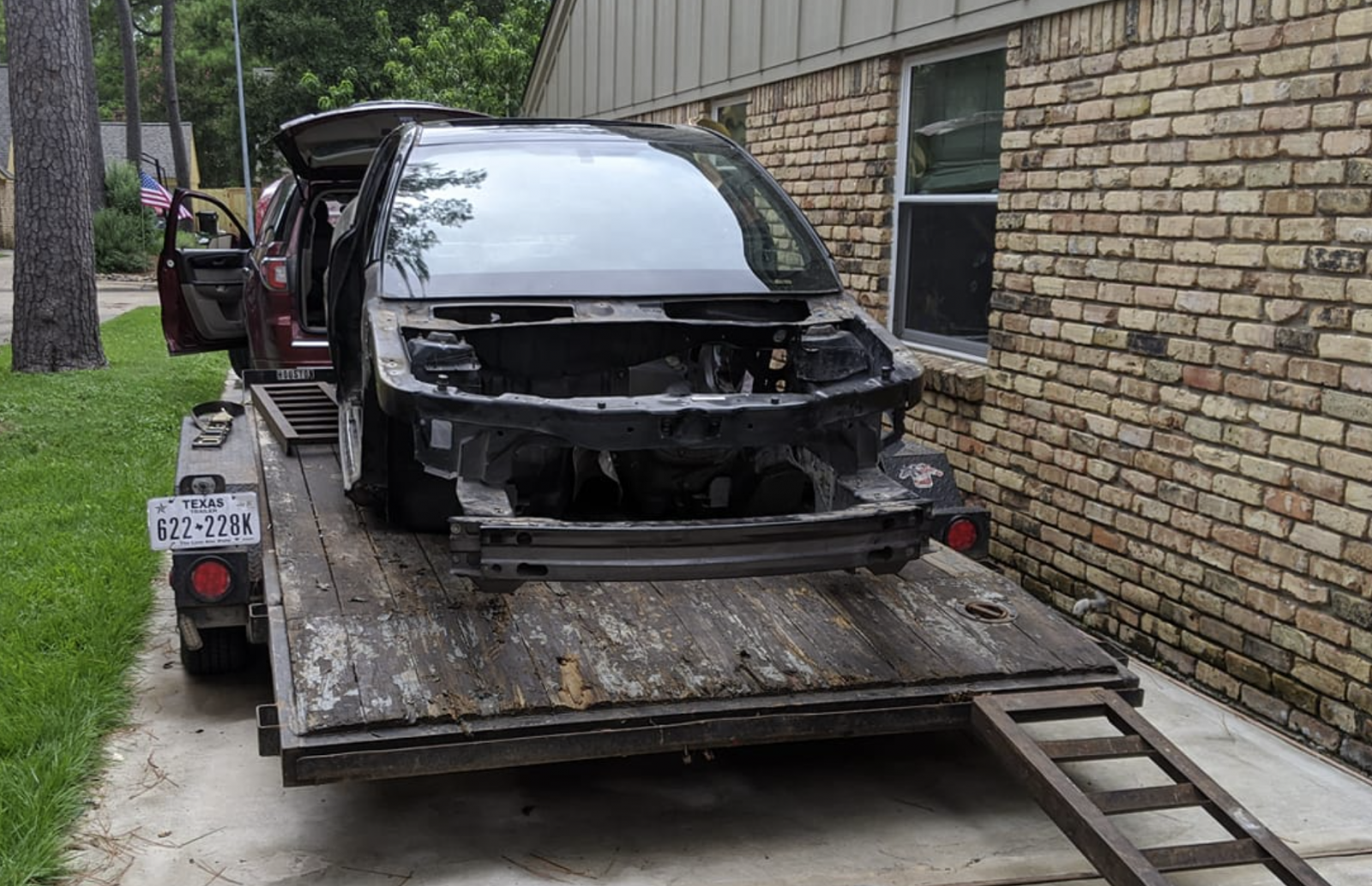

My wife took out an add on facebook for a “free shell” no title and, after filtering through the trash reply’s, a gentleman came and hauled off the shell. Zero cost to me and minimal effort. With the current low cost of scrap metal, I felt this was a win / win.

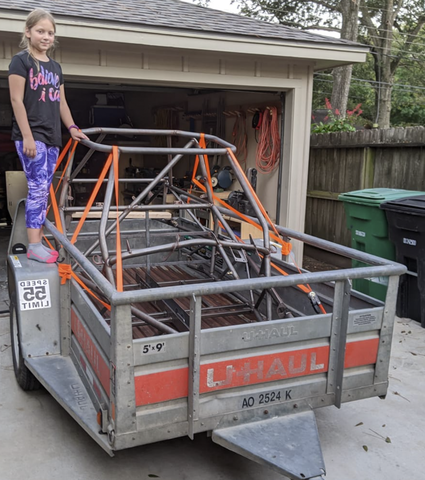

I ordered my kit in the end of July and was able to pick it up on October 17. I rented a 6x12 U-Haul trailer and pulled it behind my wife’s Kia Sedona minivan. While the gas mileage suffered, the minivan handled the 500+ mile trip with no issues. Here is a pic of a buddy of mine that made the trip with me, myself, and my father that drove down from north Dallas for the pickup. As always, Lonnie and his team were great host and we ended up visiting for about 1.5 hours before having lunch and heading back home to Houston.

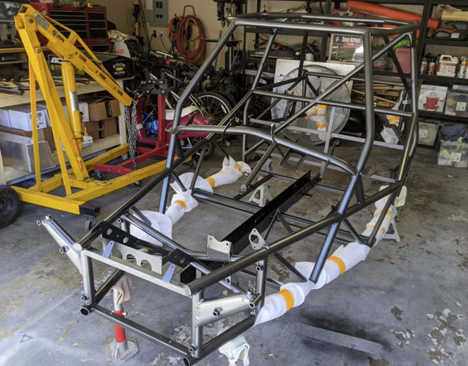

While waiting on my kit to be ready, I started researching powder coating companies in my area. I ended up taking my frame and 23 other parts to get powder coated. While this was an expensive option, Cutting Edge Powder Coating did an outstanding job on the frame and various brackets. If I were to do it again, I think I would go ahead and get the sheet metal powder coated along with the fuel tank. I went with Graphite Charcoal from prismatic powders. Total turn around was 7 days. The following are a couple of pic’s of the frame headed to powder coat and the finished product.
18056
18057

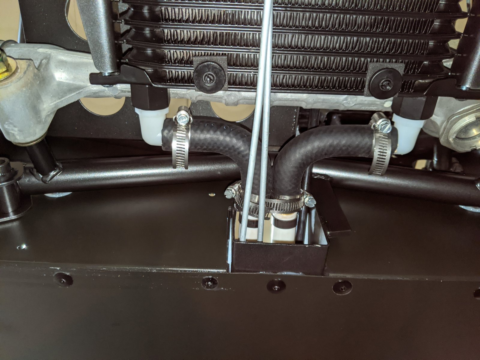

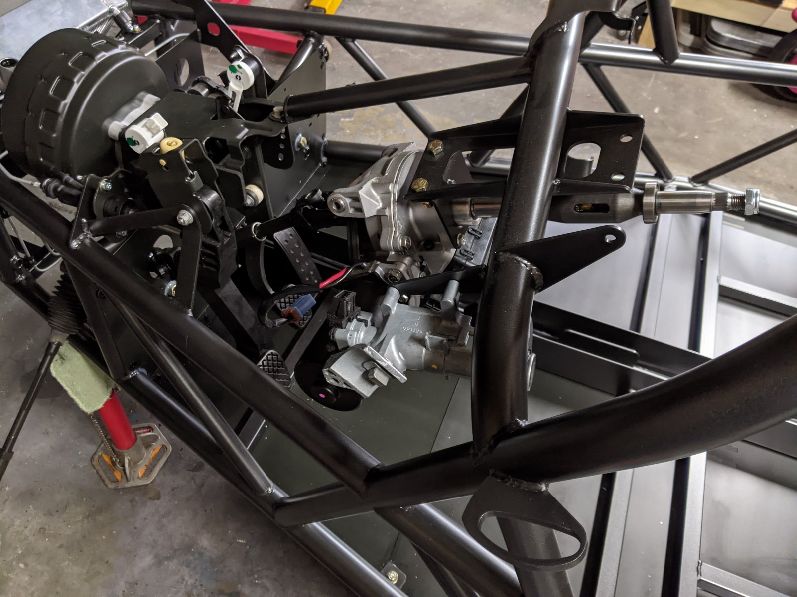

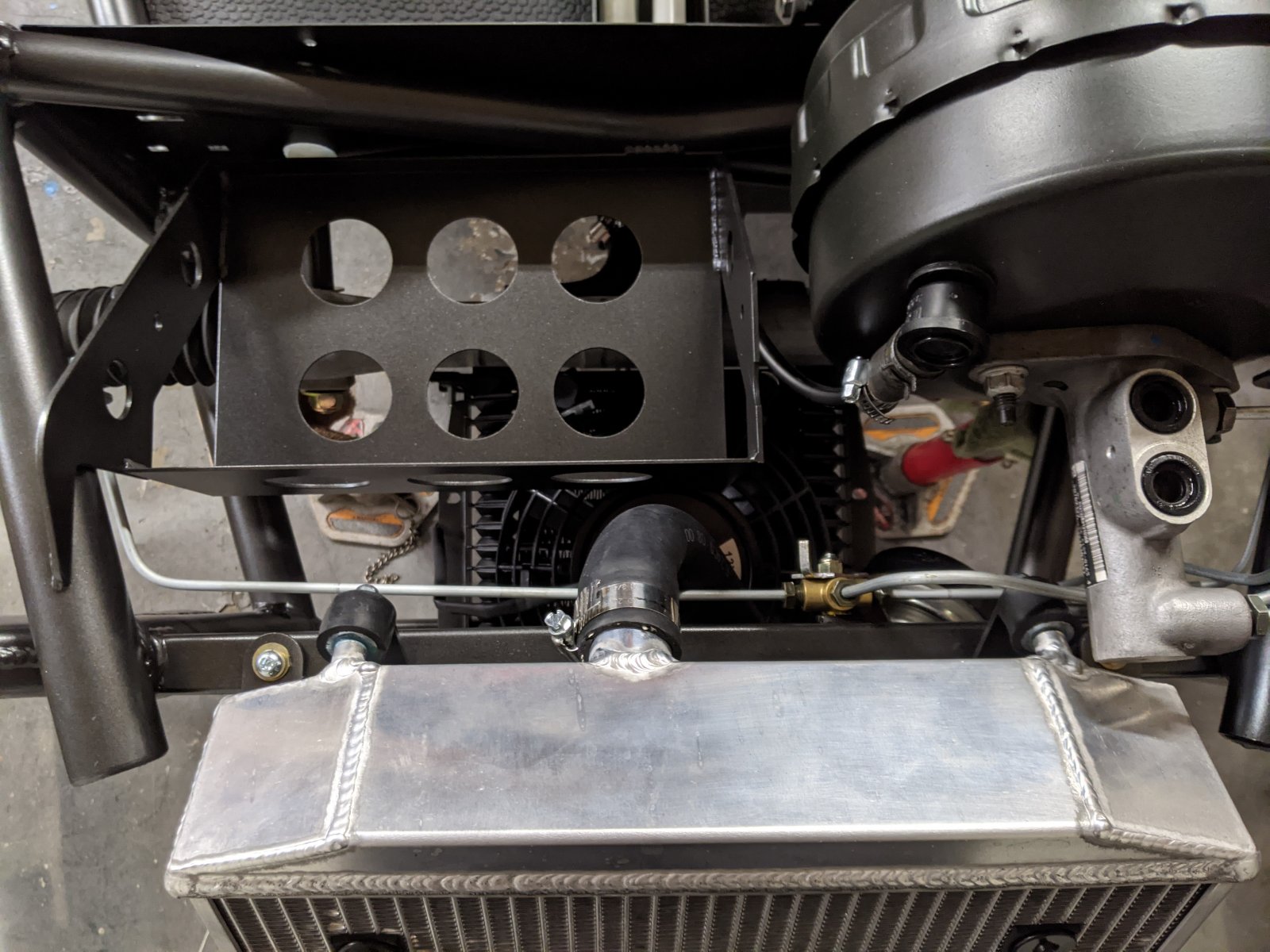

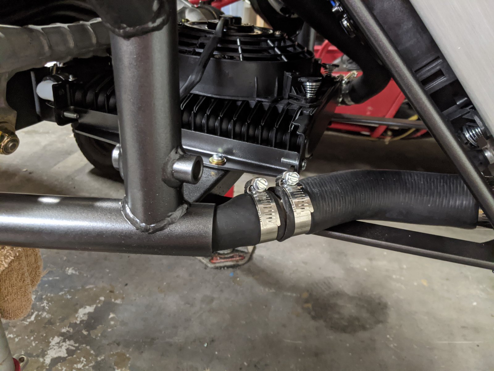

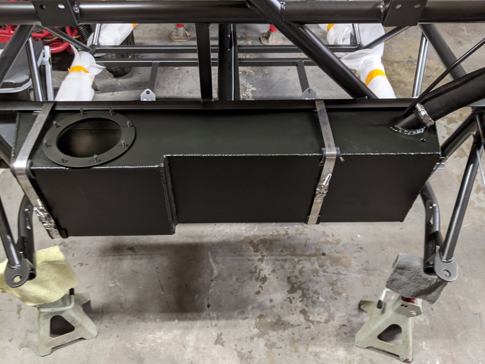

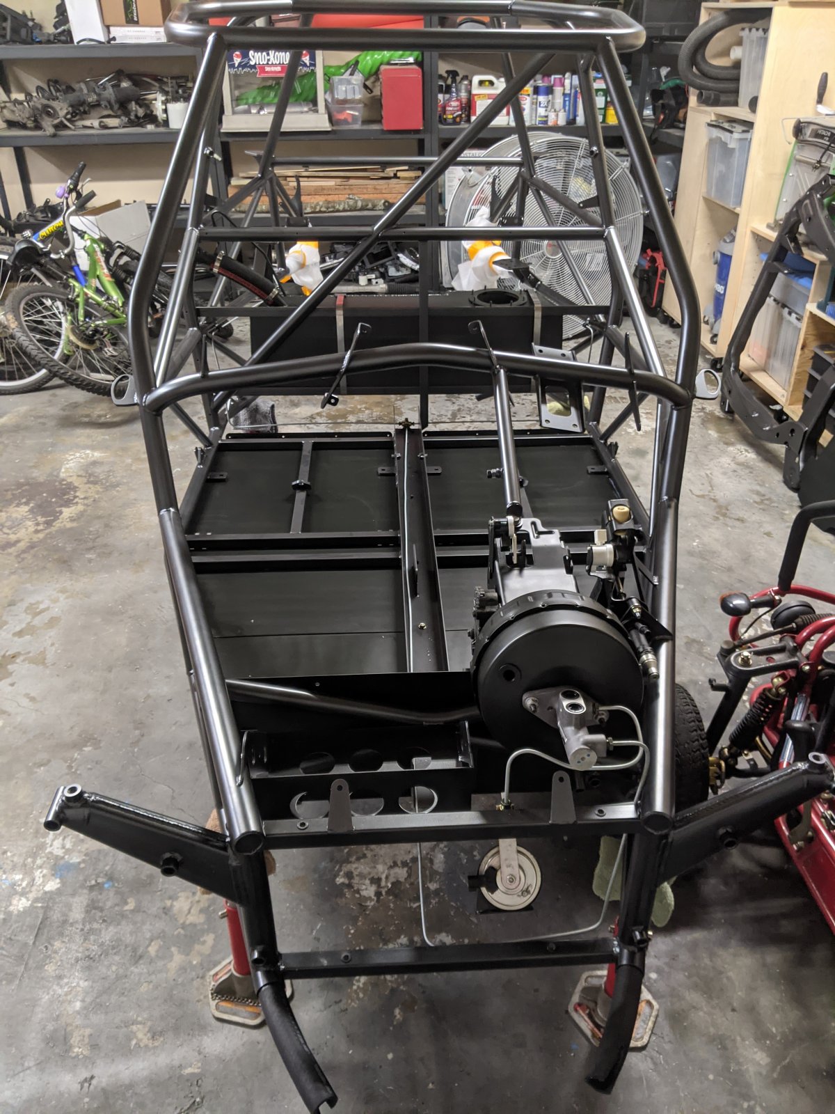

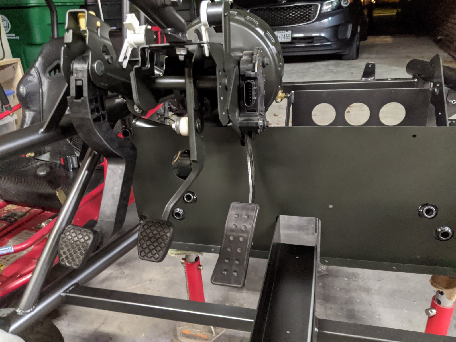

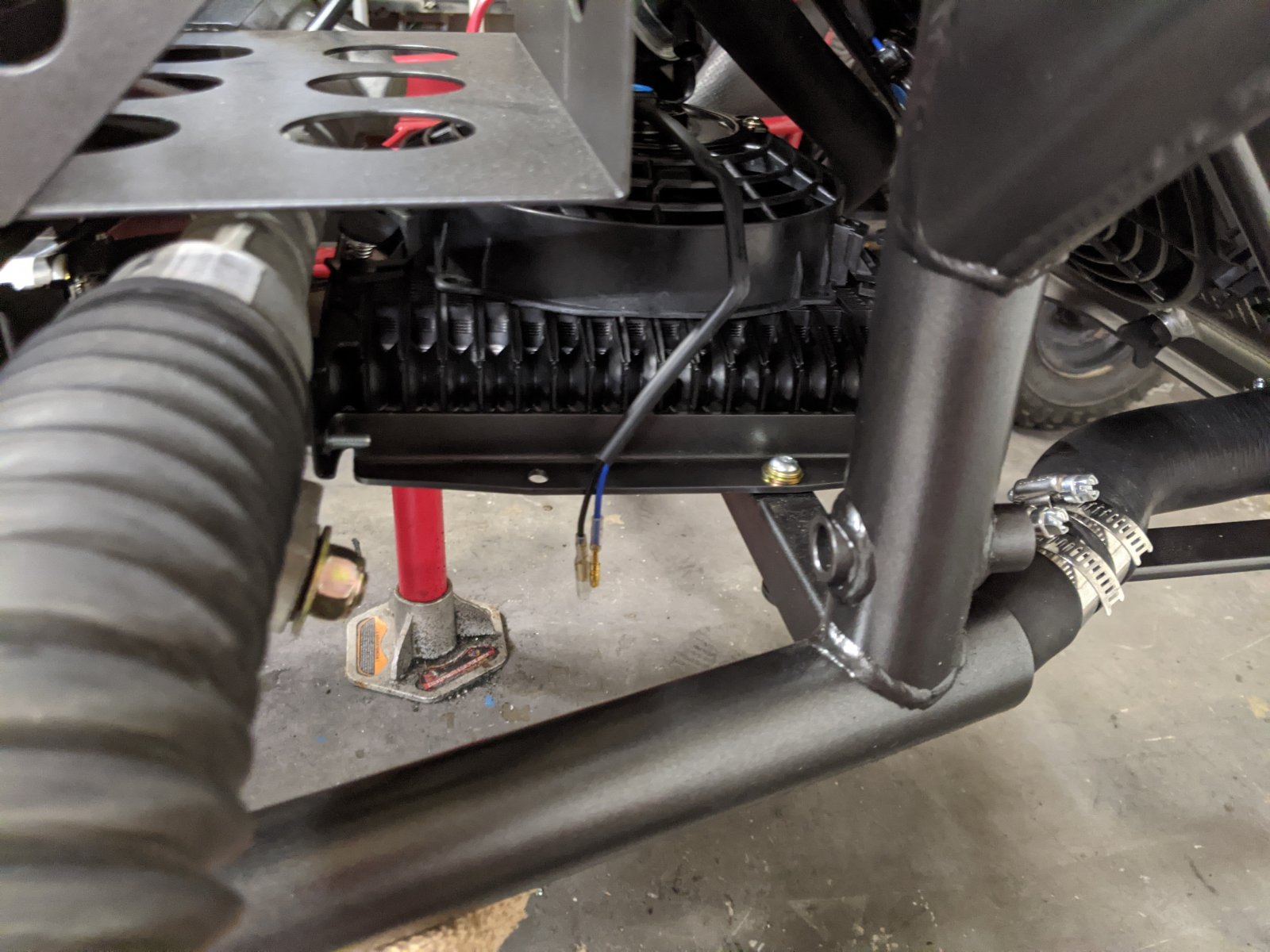

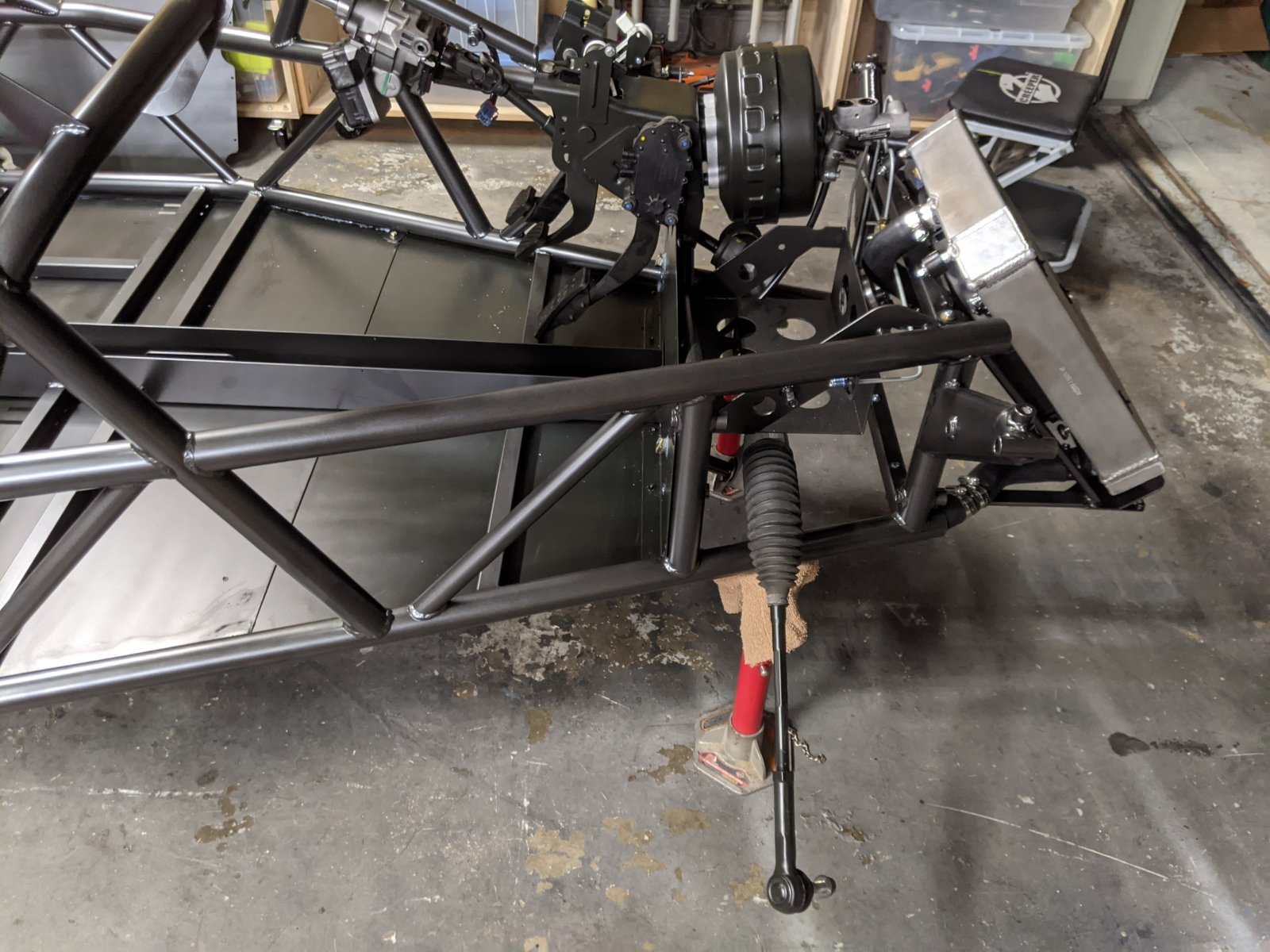

My son and I have been busy working on the kit. So far, we have installed the cooling hoses, brake lines, horn, brake booster, pedal box, ignition switch, sheet metal, fuel tank, and some other random items.

Now, for my first series of questions.
Currently wrapping up stage 1.
-Where did you anchor your brake lines? I have followed the written and video directions and still have many extra brackets. Should I hold off and worry about it when I have the braking system completed all the way to the calipers?
-Clutch line brackets - Where do these go? Can I also use the brackets used for the brake lines for the clutch line?
-I know one of the half shafts is broken. I see a large spread in prices for replacement half shafts. from $55 at Rock Auto, 100-250 at Autozone, and 450+ from some of the specialty Cobalt parts companies. Would there be a significant difference from the Rock Auto units and the Autozone units?
-I am about to embark on Stage 2. Are there any directions for stage 2 or should I just be studying all the various pictures.
I wish there were "pinned" threads in the assembly discussion for those important threads.
I only did a few anchor points before I connected up the whole system. Then added more bracing later. You want to stop vibration in brake lines and clutch lines, so I would think you can use the same brackets on them.
Rock Auto had about 10 different axles for my smaller drive shafts, which was better selection than the local auto parts stores. I consider them both to carry a selection, no one better than the other, but Rock Auto prices usually beat them (by a lot).
This forum's search is pretty good at finding stuff, but this and the build videos are your guides, there are no printed directions. If you can't find it, just ask, someone will know, or have the key words to help find what your searching for.

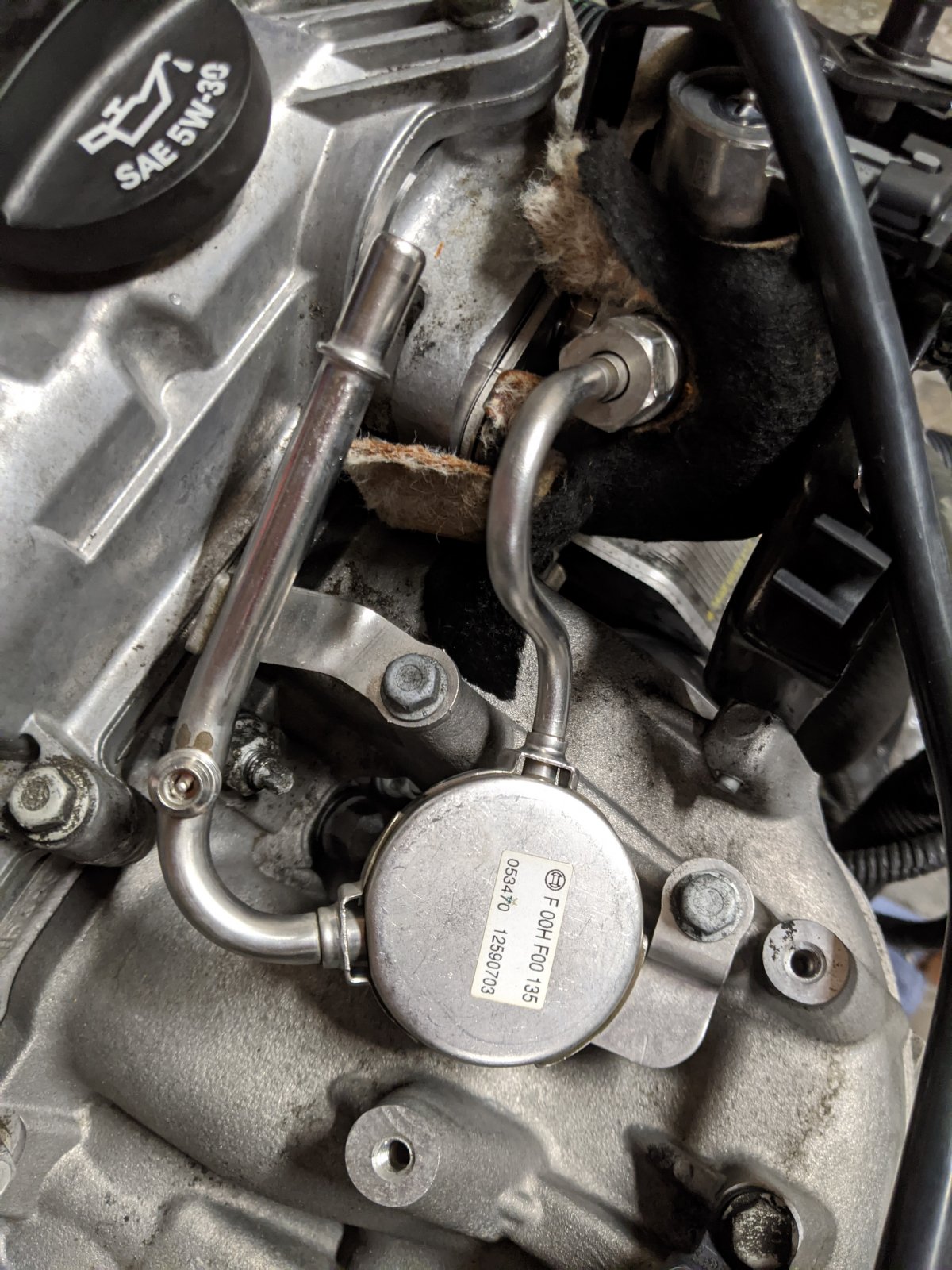

Whats the silver thingy on the top of my engine (first pic).
PXL_20201108_001349714.jpgPXL_20201108_001402966.jpgPXL_20201108_022855203.jpgPXL_20201108_022917721.jpgPXL_20201108_022923940.jpgPXL_20201108_022933511.jpgPXL_20201108_022939518.jpgPXL_20201108_022955746.jpg
The silver 'thingy' is a pulse compensation valve in the high pressure fuel line. It essentially helps smooth out the pressure pulses from the high pressure fuel pump.

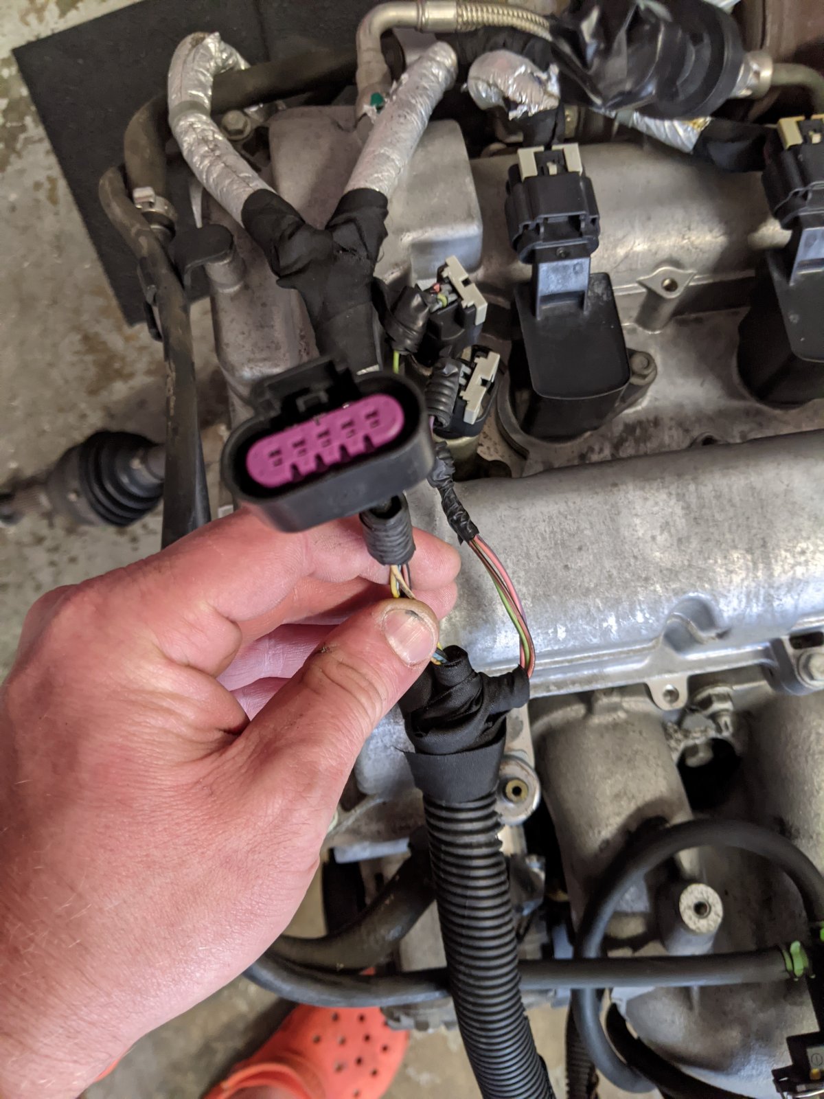

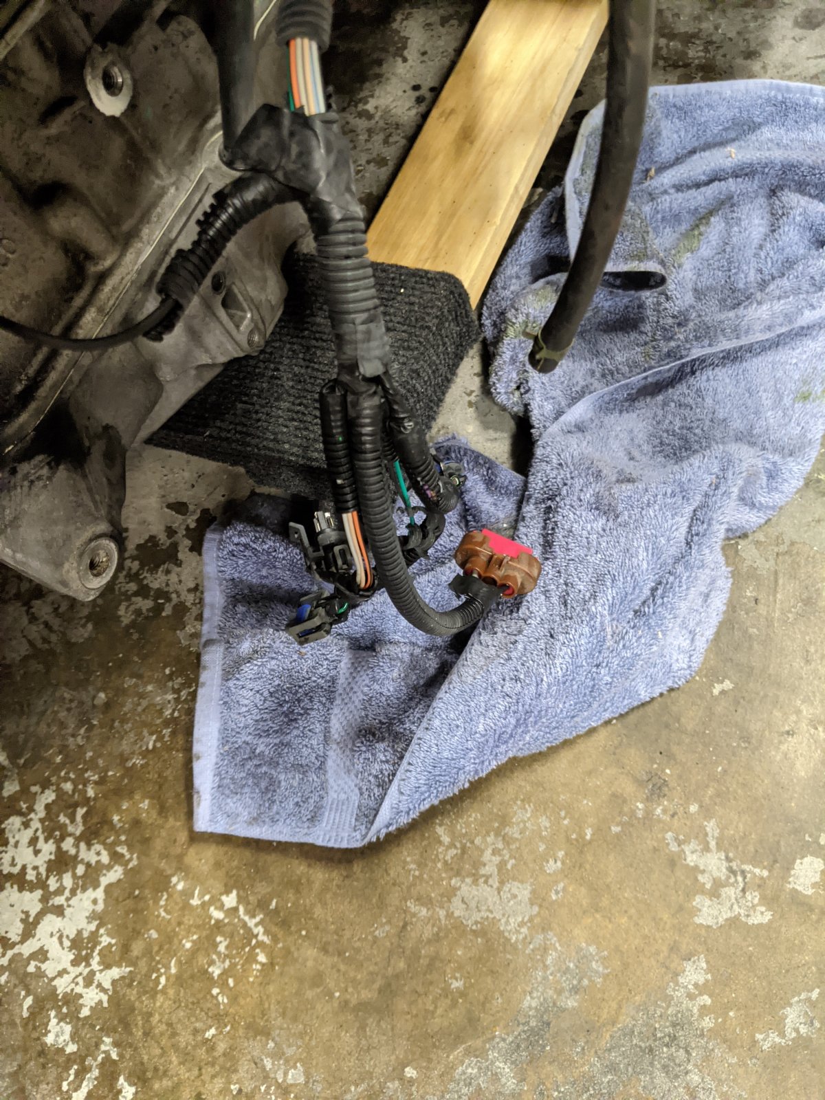

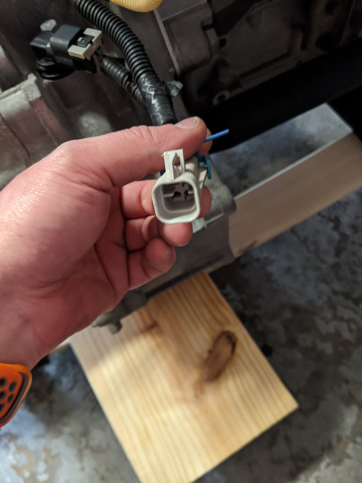

Im starting to clean up the engine harness wiring. Just want to confirm a few things before I do something that I might regret.
This is the MAF connector that needs to be relocated, correct?

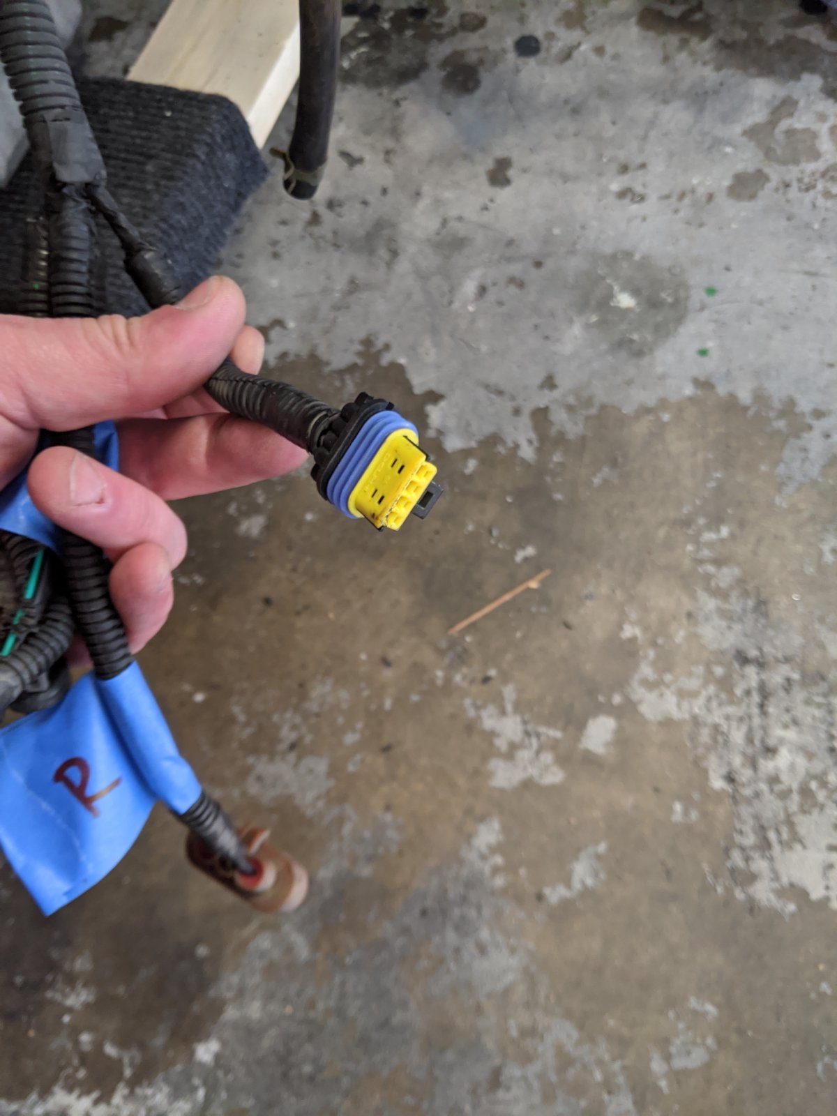

What is this connector for?
18119
