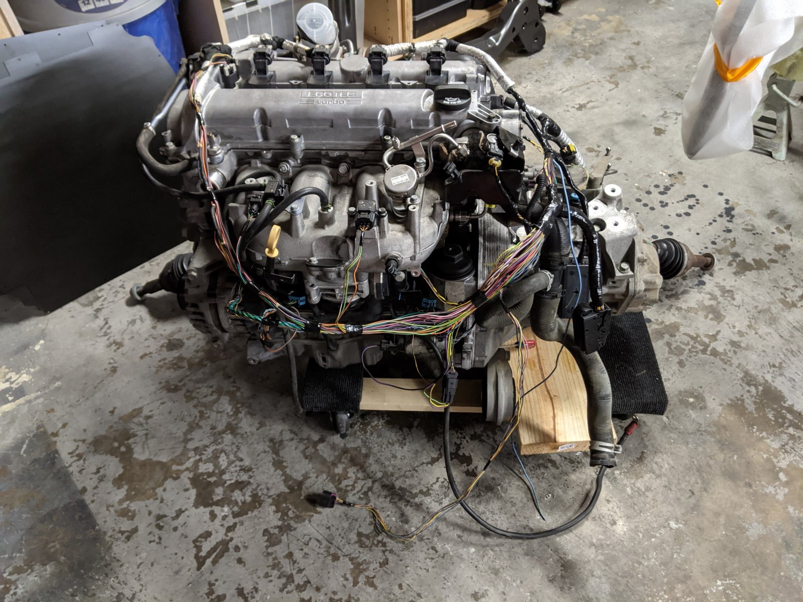

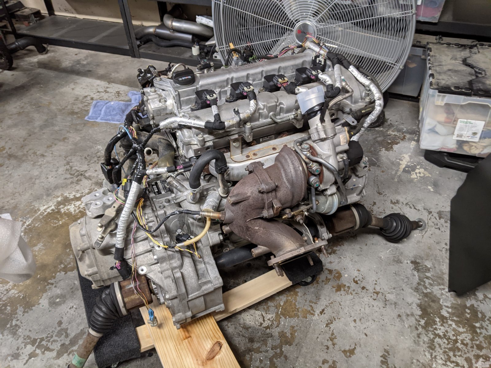

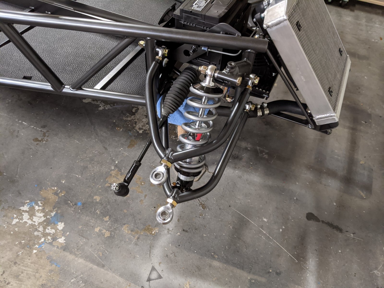

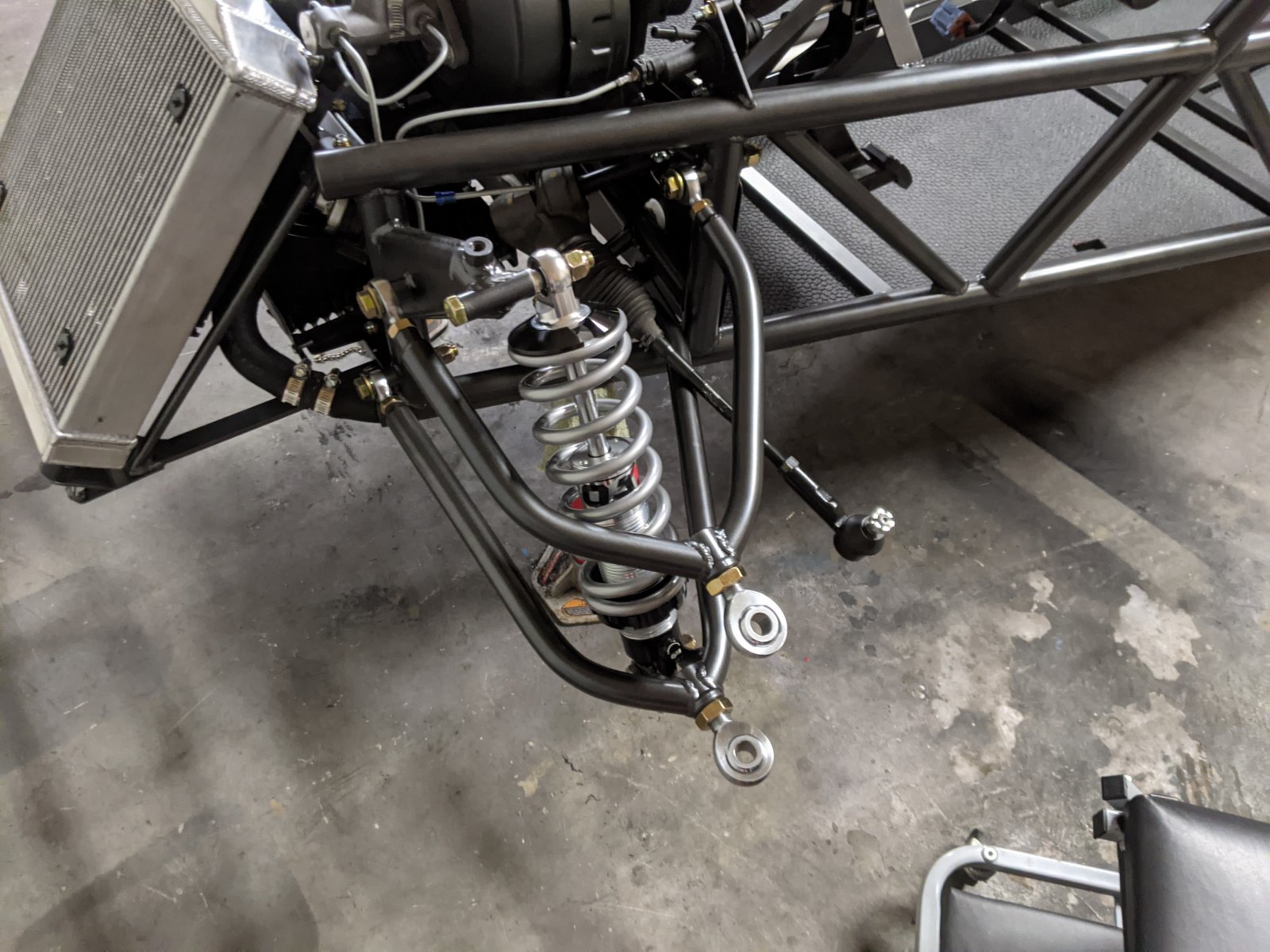

Got some more done today. Started cleaning up the engine harness, installed the front shocks and control arms, installed the coolant tank, painted some more parts, ordered half shafts, got a battery, changed the spark plugs, and probably a bunch of other things I'm not thinking about.
Going to try and get the engine finalized this week and install it next weekend. I talked to Adam the other day and it looks like I am about 2 weeks out on the harness. Hopefully, it is here before Thanksgiving week since I have a bunch of time off. Honestly, the seats are looking like mid December so that might be the critical point to a test drive. Wife suggested a couple of milk crates. That might actually happen.

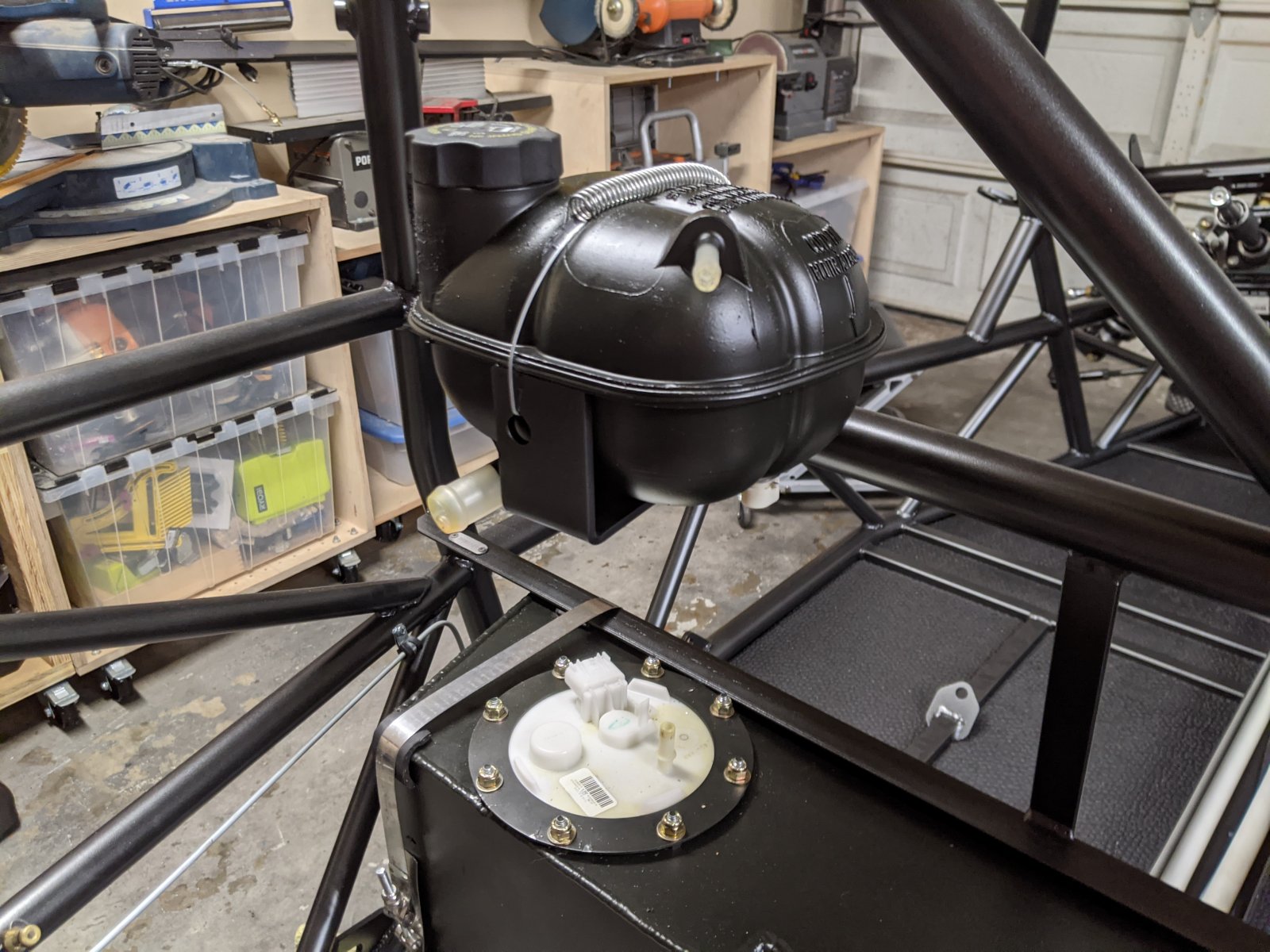

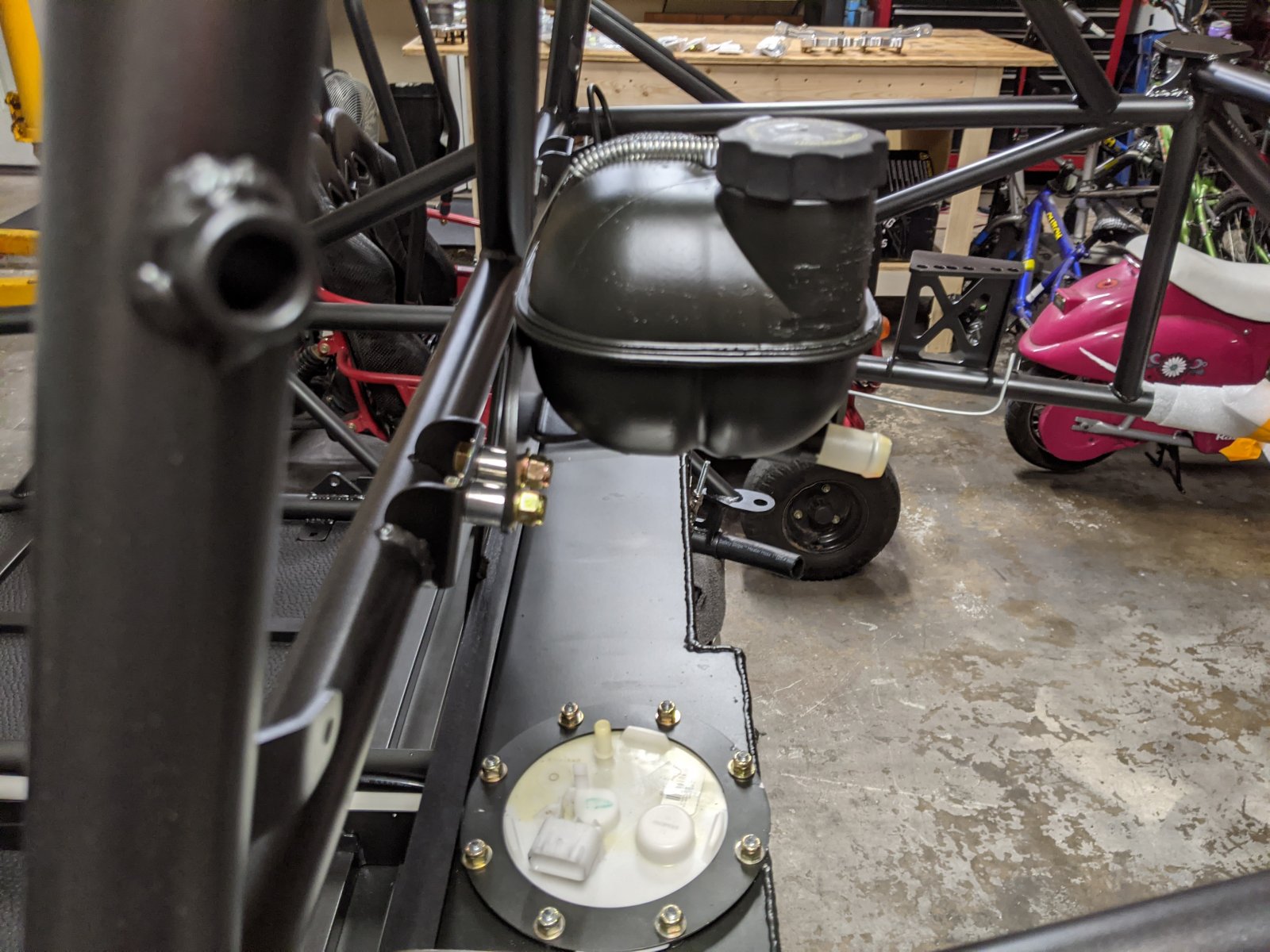

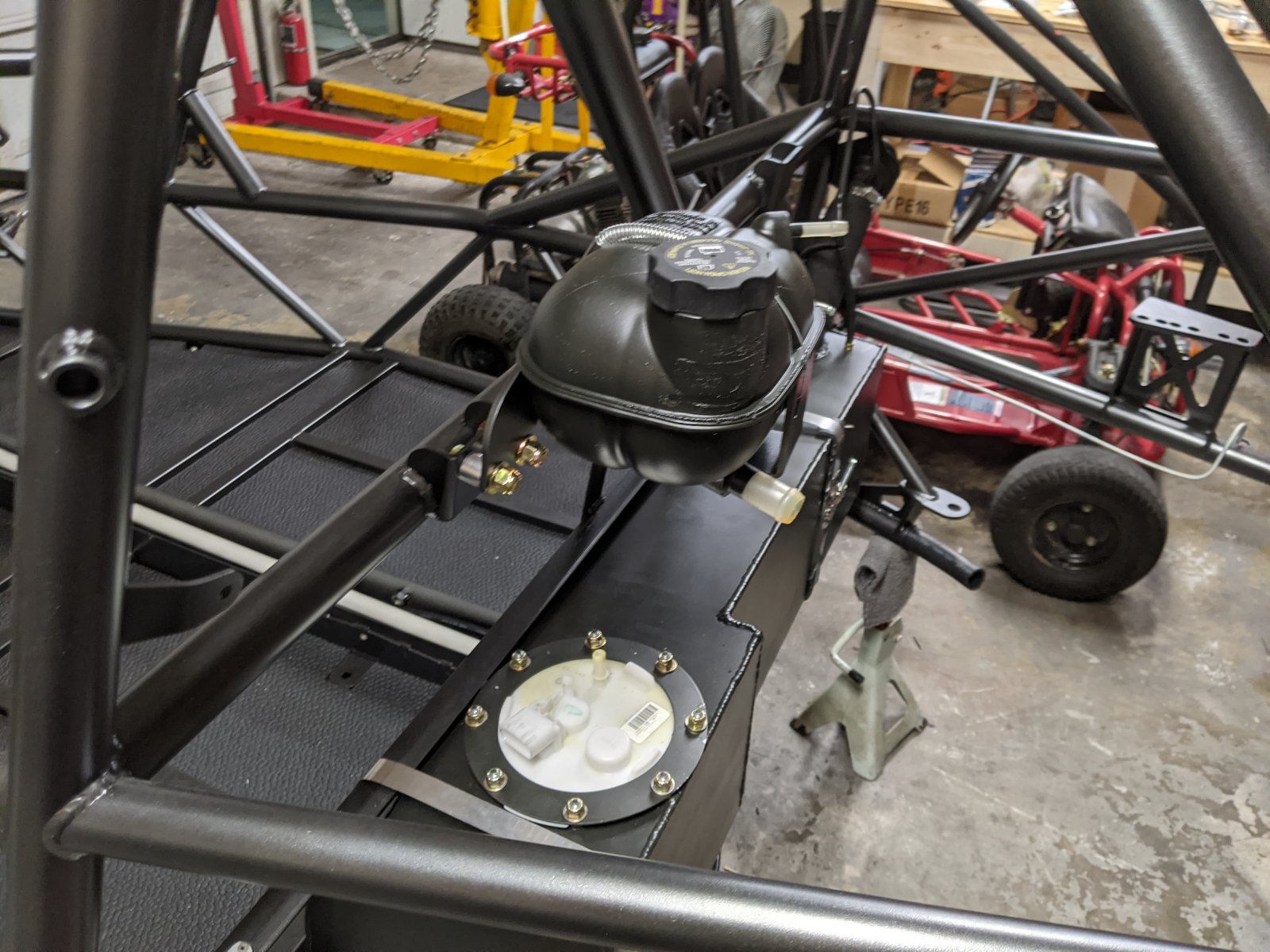

What did you use to paint your coolant tank? Looks great. I was thinking it’s the least attractive part in the engine bay
Brett
First, I used a Dremel to cut off the flange that protruded from the side (not the clip on the back since it is used as a refence for the mount).
Then, I wiped down the plastic with simple green (any plastic safe cleaner should work).
After that I roughed it up with 220 grit sandpaper. 320 grit might be better since the scratches wont show through is much. Goal hear was to give the paint something to bit into.
Using Rust-oleum primer that works with plastic (they should sponsor me give the amount of paint I have bought), I put about 3 coats of primer on the tank.
For the black paint, I have been using Rust-oleum matte automotive black paint (home depot carries it). I have found that the color and shine complement my frame nicely.
Note that it can take several days for the paint to cure on plastic. I rushed and mounted the tank after 24 hours and the spring that holds the tank to the bracket marred up the paint. Maybe I will touch it up in the future but probably not. While I want the car to look good, it is not a show car.
I opted to paint the tank since it had severely yellowed over time.
Also, I initially thought that a spring holding the tank down wouldn't hold solid. I was wrong, that tank isn't going anywhere.

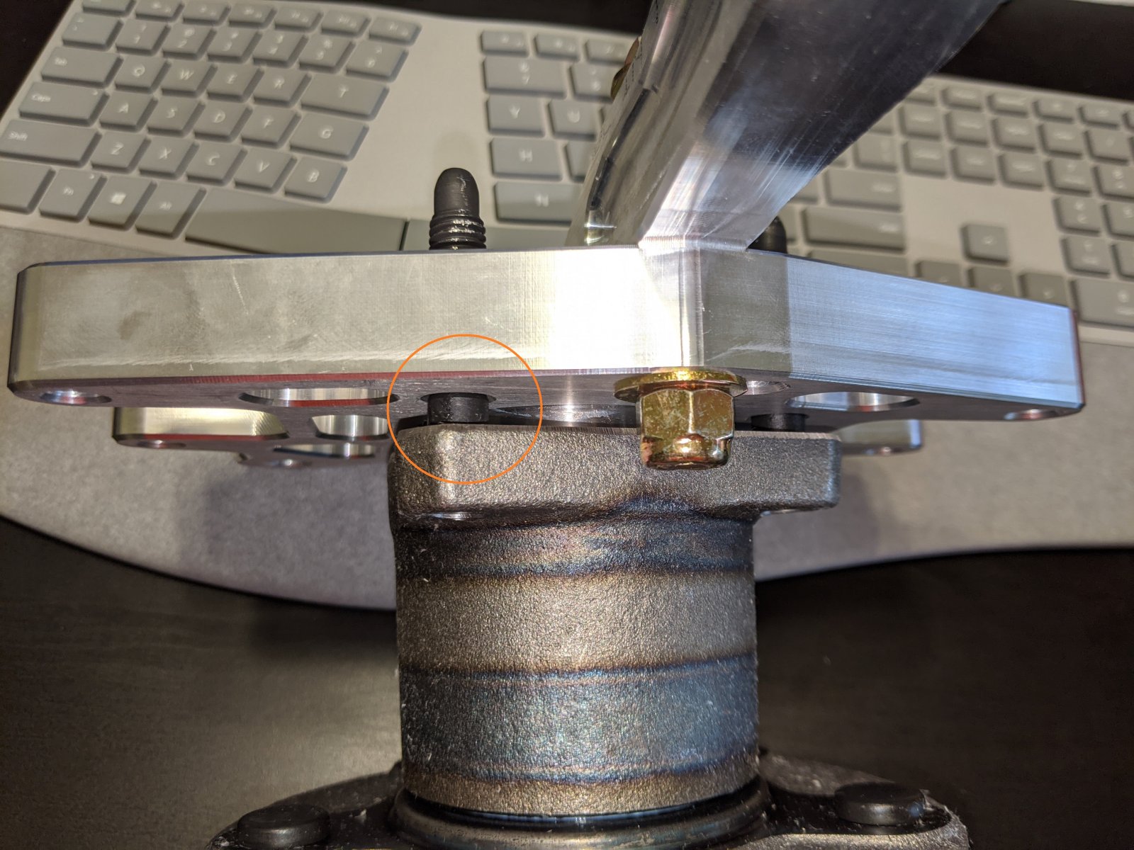

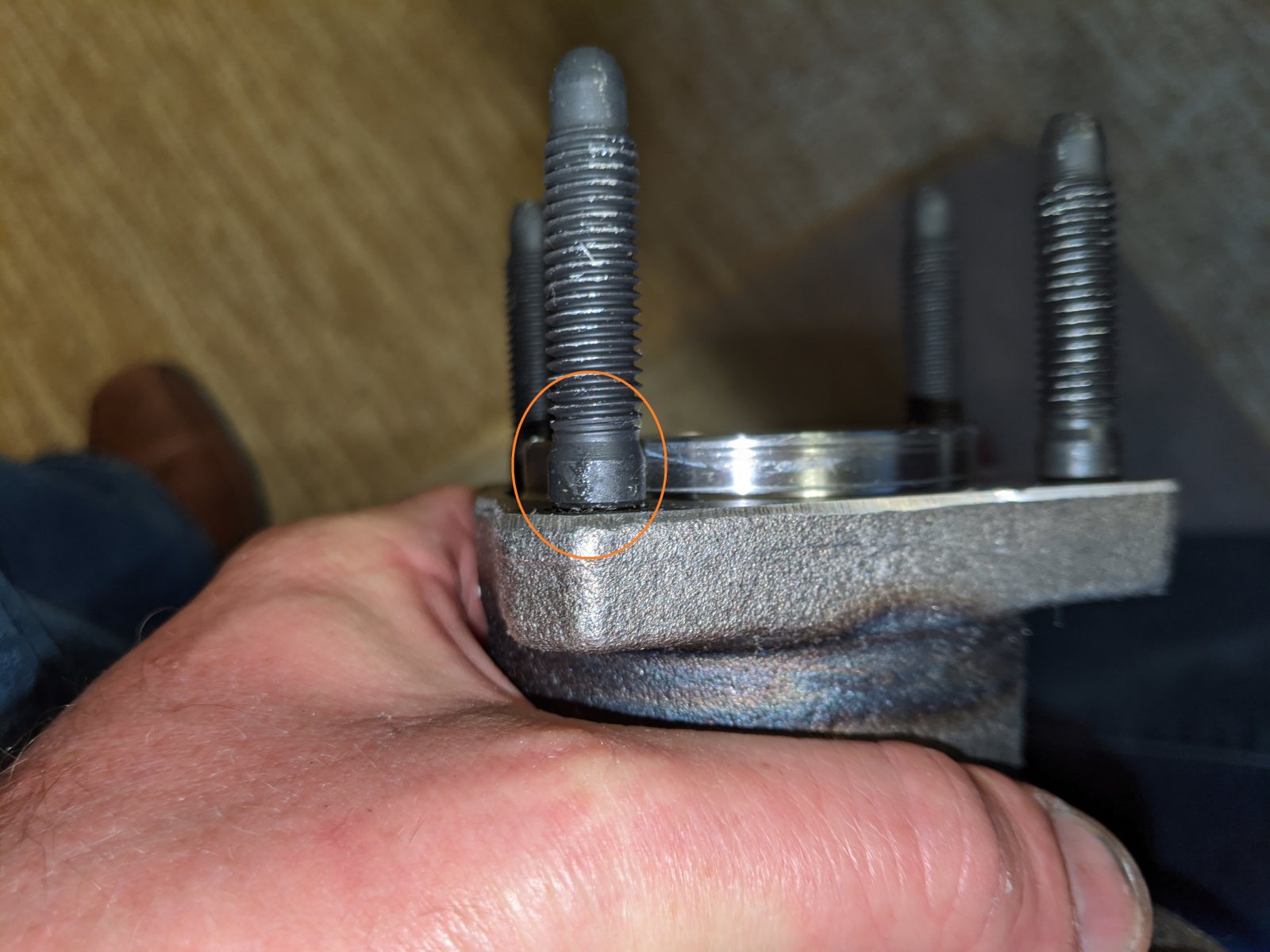

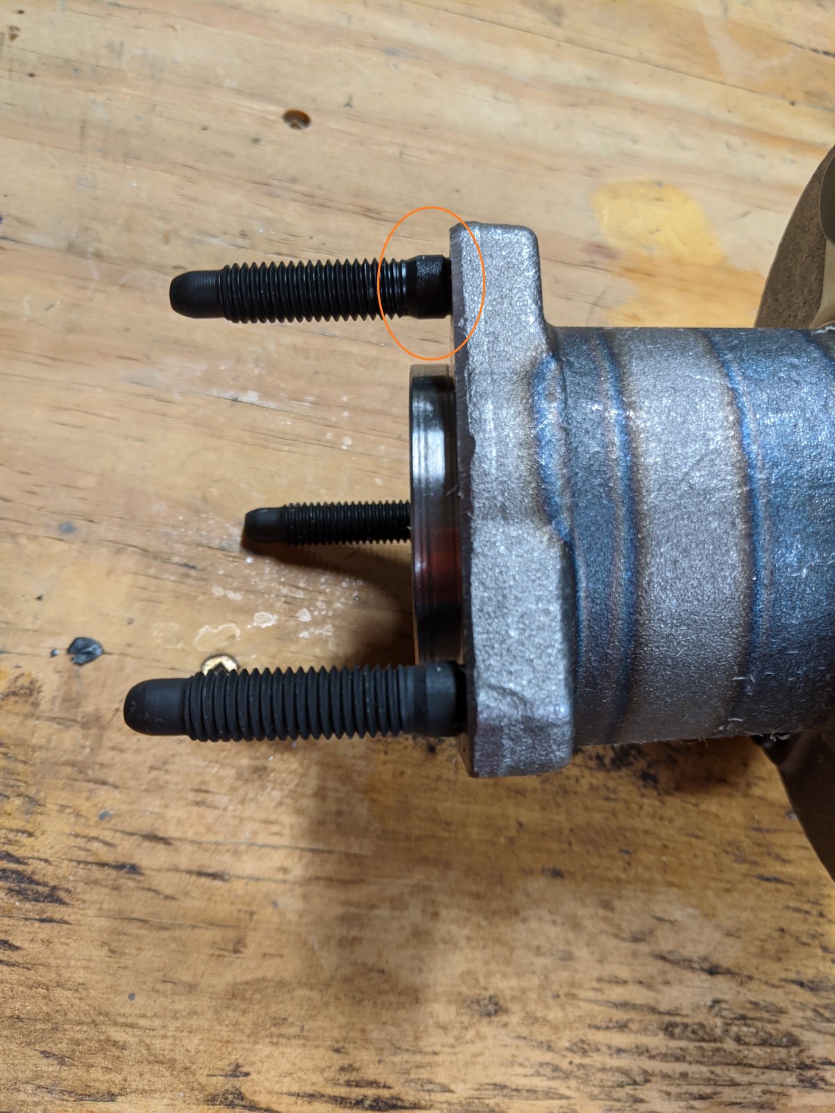

I have been futzing with the front uprights and the wheel hubs. I had ordered replacement hubs awhile back and noticed that the studs that attach to the upright have a shoulder preventing the plate from being flush to the hub.
Easy thing to do would be to return these hubs and get some without the shoulders but the packing is long gone (or apart of my kids box fort).
I was thinking of clearencing the holes in the upright to clear the shoulder of the studs. I can just drill them out a little bit.
Does anyone have a reason to not make room for the shoulder in the hole?
The hubs are inexpensive enough that I don't might purchasing some other that would work but I have these....
Pictures attached with the shoulder circled.

Are these 4 stud or 5 stud hubs? Many aftermarket hubs are supposed to fit multiple vehicles and some features are not always compatible with every vehicle the manufacturer claims. Sorry this happened. I would still try to return them to get a more correct part. Call the place you purchased from and explain the situation, they may be willing to exchange even though you no longer have the original packaging.
Brett
Five stud hubs. Here is the link to the ones I bought from amazon with the studs with the shoulders.
Listed as:
Rear Wheel Hub and Bearing Assembly Compatible With Chevrolet Cobalt HHR Malibu Pontiac G6 Saturn Aura (5 Stud Hub 4-Wheel ABS Models) AUQDD 512285 [5 Lug W/ABS]
Goblin Graber
I’d say you would have no problem drilling them as long as you have the right size bit to not go too big. The way that stud is designed is for the big shoulder to hold the shear load and line the hub up. The nuts just keep it tight.
Brett
I reached out to Adam and he indicated that drilling the holes down about 1/4 an inch to accommodate the shoulder should not be an issue. Looks like the shoulder is 10mm or about 25/64". Amazingly enough, I have a drill bit to handle it.
Brett
Uprights have been slightly modified and fit on the car / hub just fine. Now I have a friend working on printing the bearing covers.
While working on the front end, I realized that the tie rod ends don't have enough thread to put the cotter pin in. I believe that others have had this problem. Also, one of the nuts on the tie rod ends threads stripped out and just spins on the tie rod.
