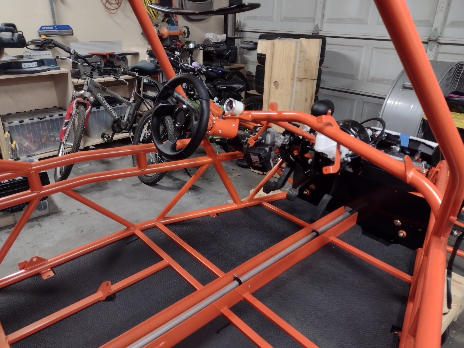

Heat is a concern but I wanted to be able to rivet the floor the frame rails. The first build seemed a little "flimsy" in regards to the floor. If I ever do a 3.0 build, I will probably just weld in a floor.

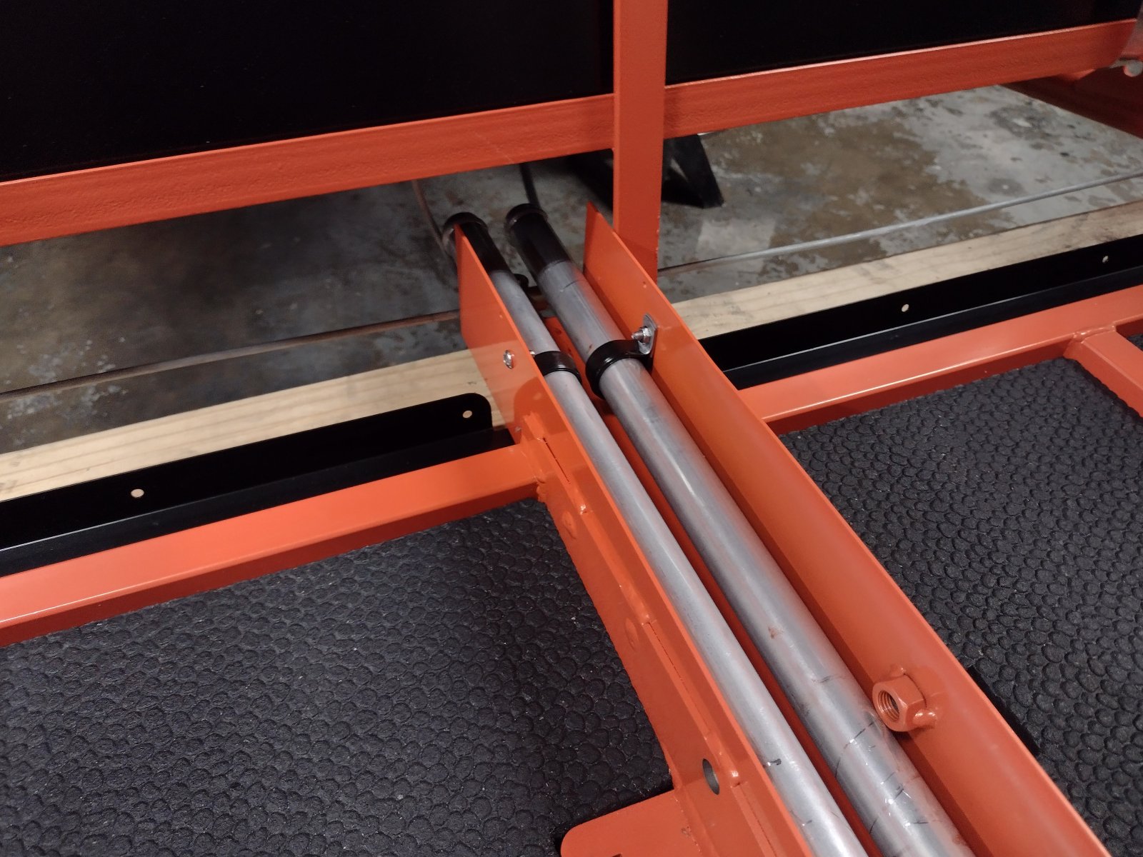

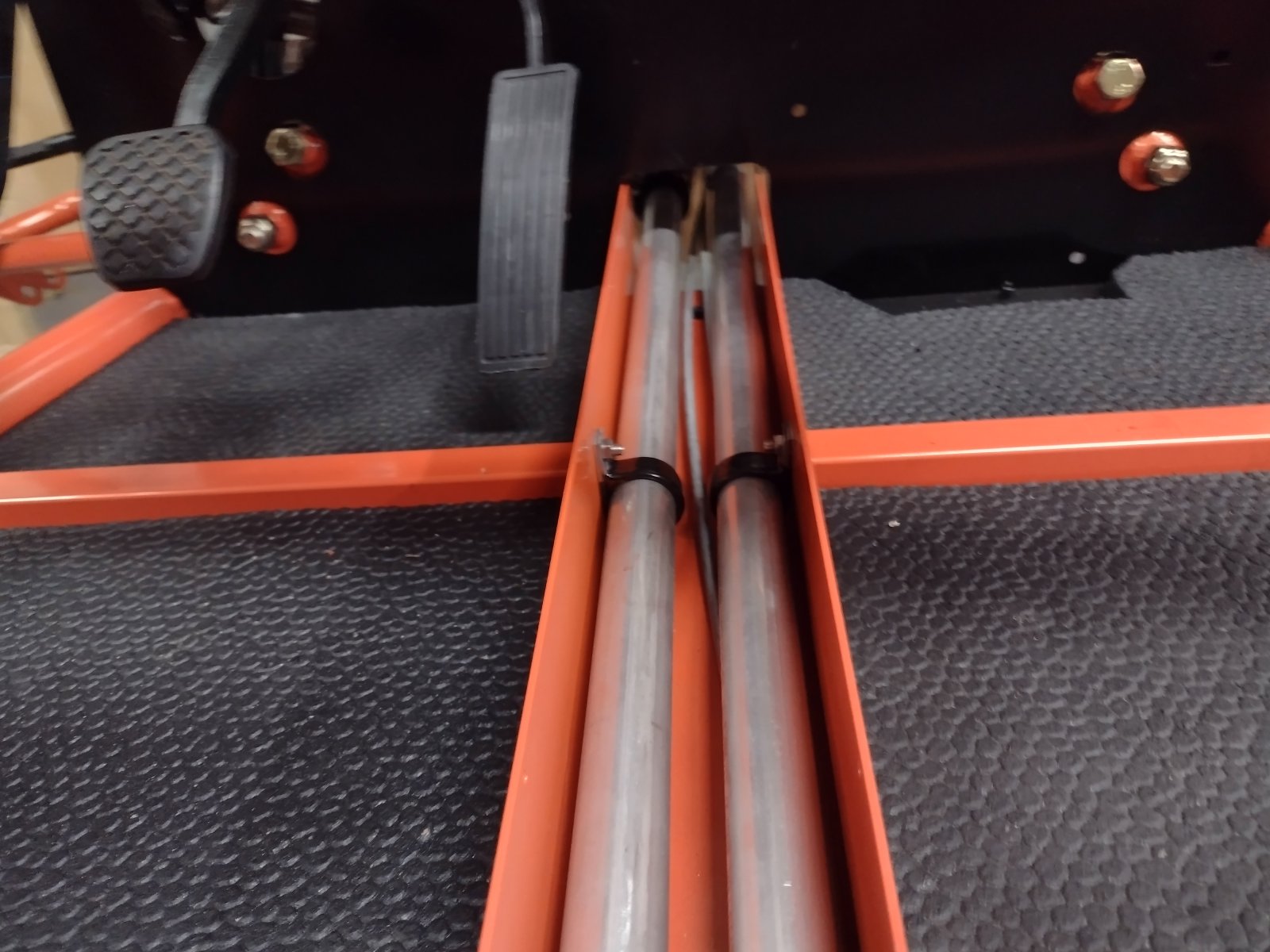

I have fiberglass wrap to put around the tubes and separate the tubes from the other items in the center tunnel. If it is a massive failure, then I just made a way to keep my coffee warm (mount a cup older to the tunnel) but I will have to take up drinking coffee.

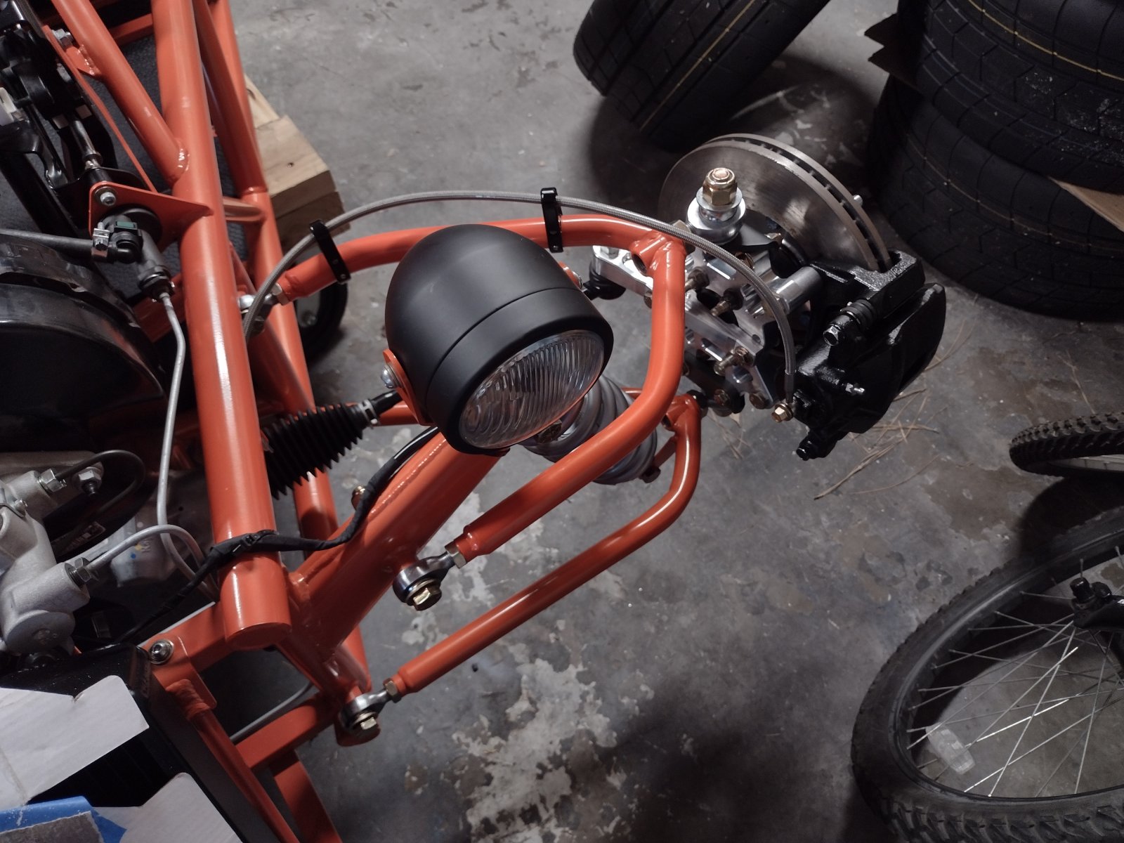

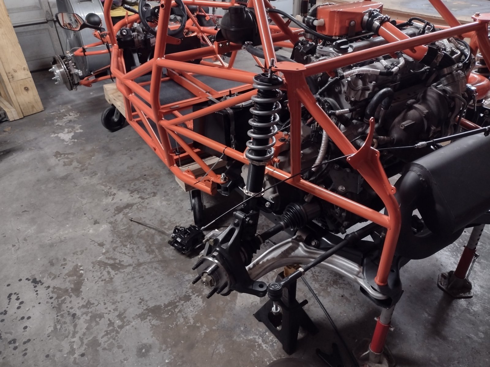

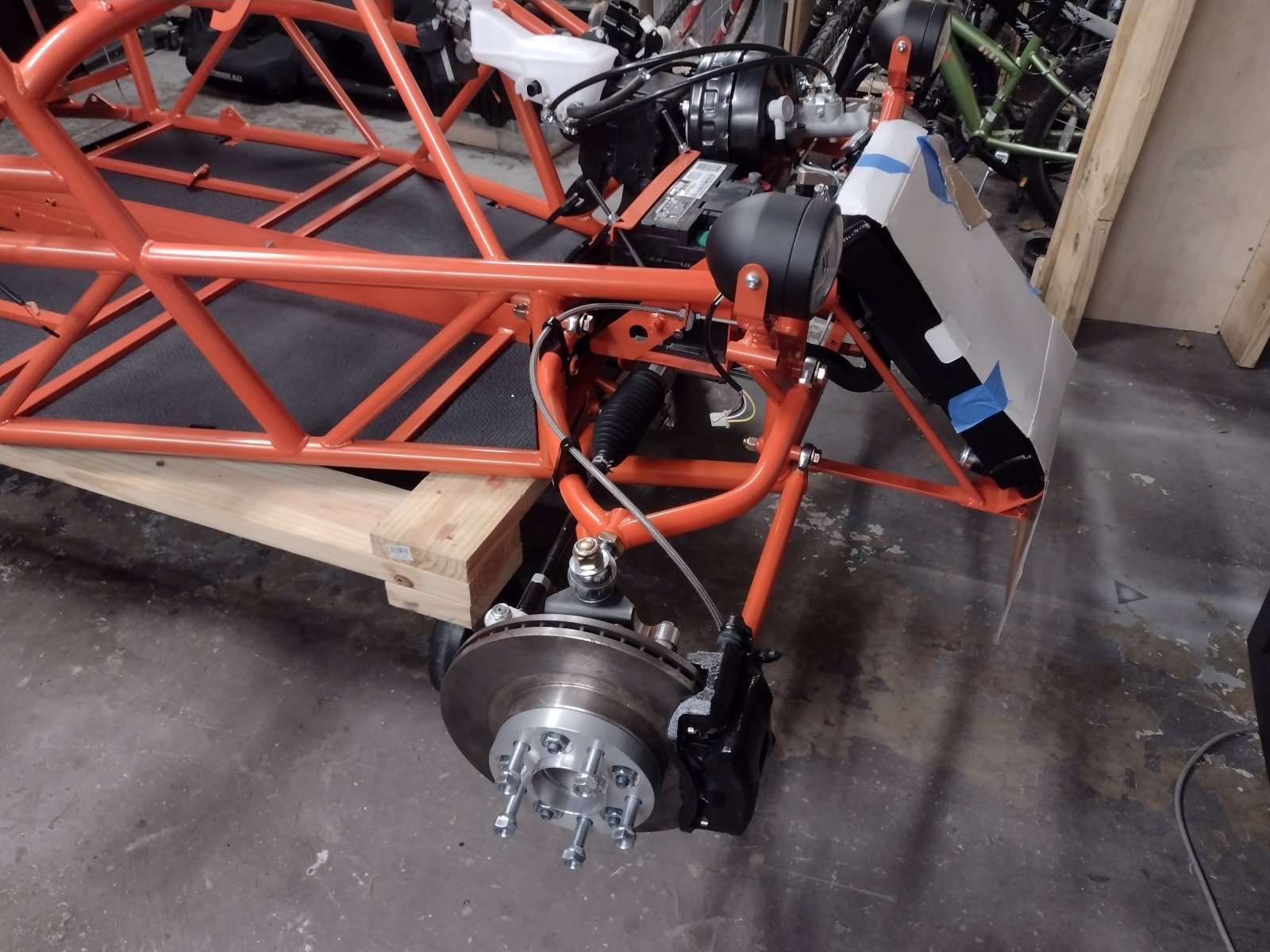

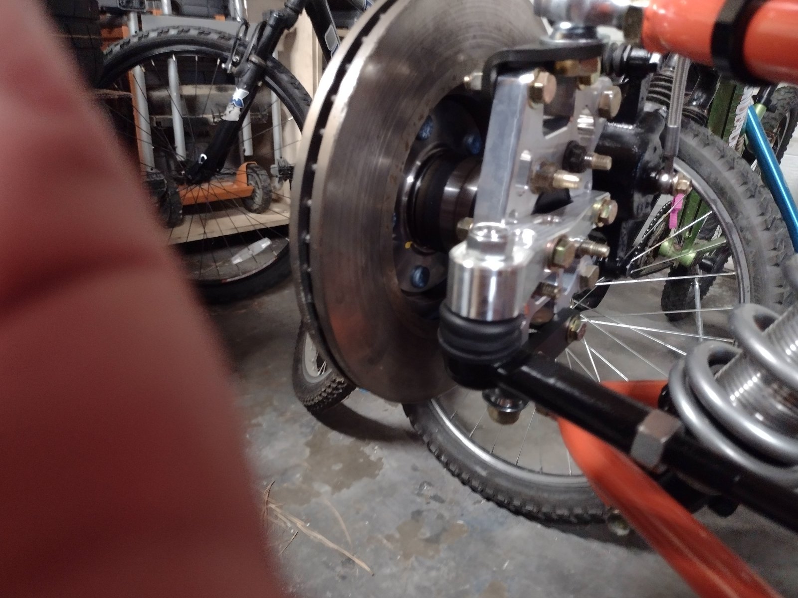

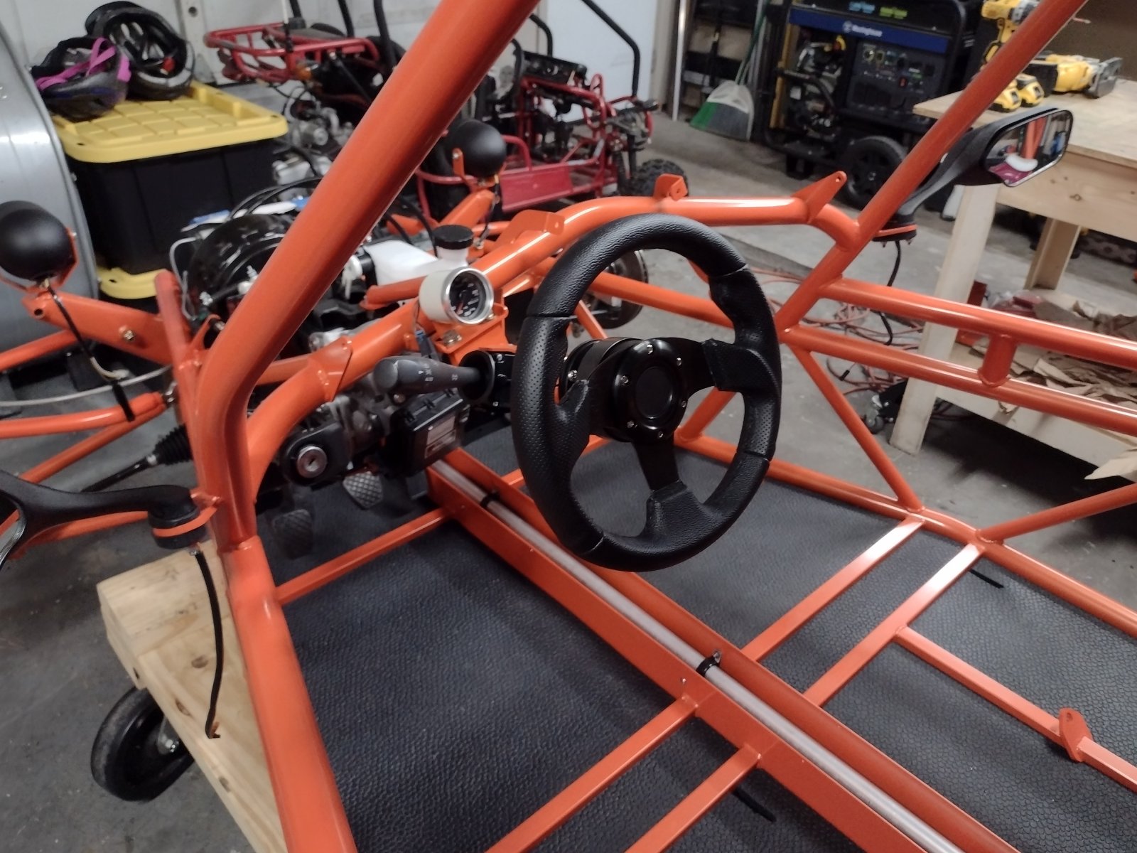

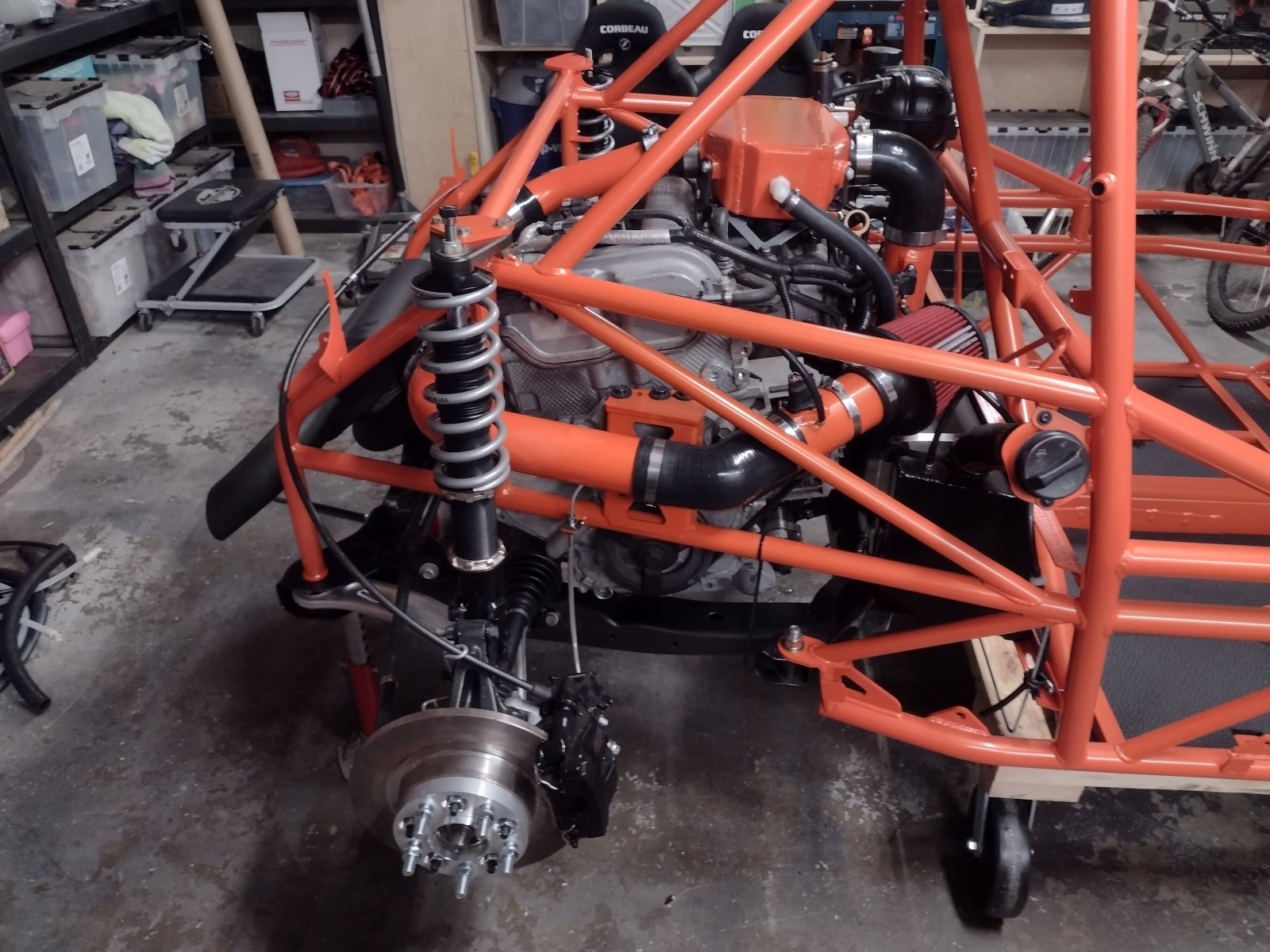

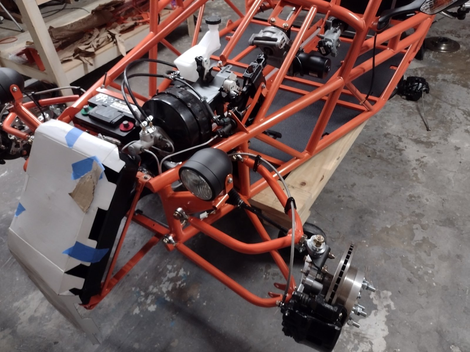

Got a lot done since the last update.

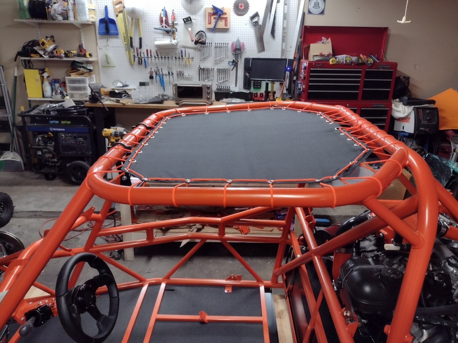

-Installed roof

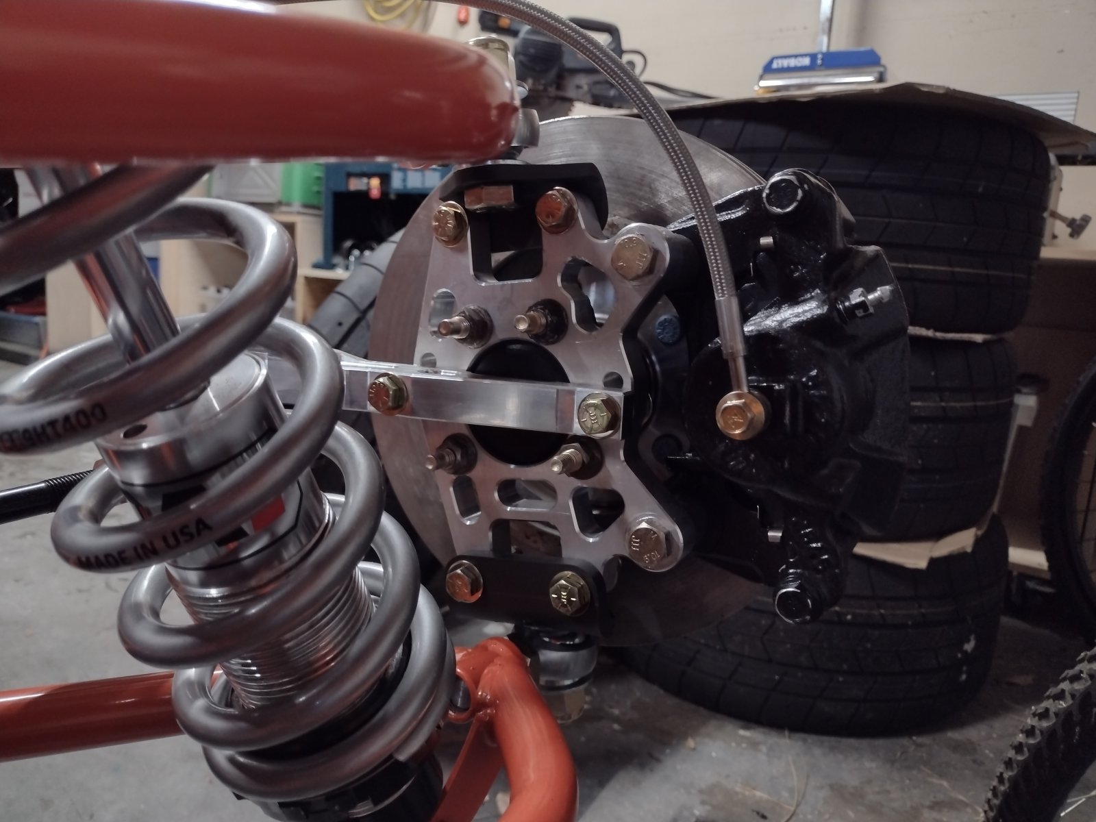

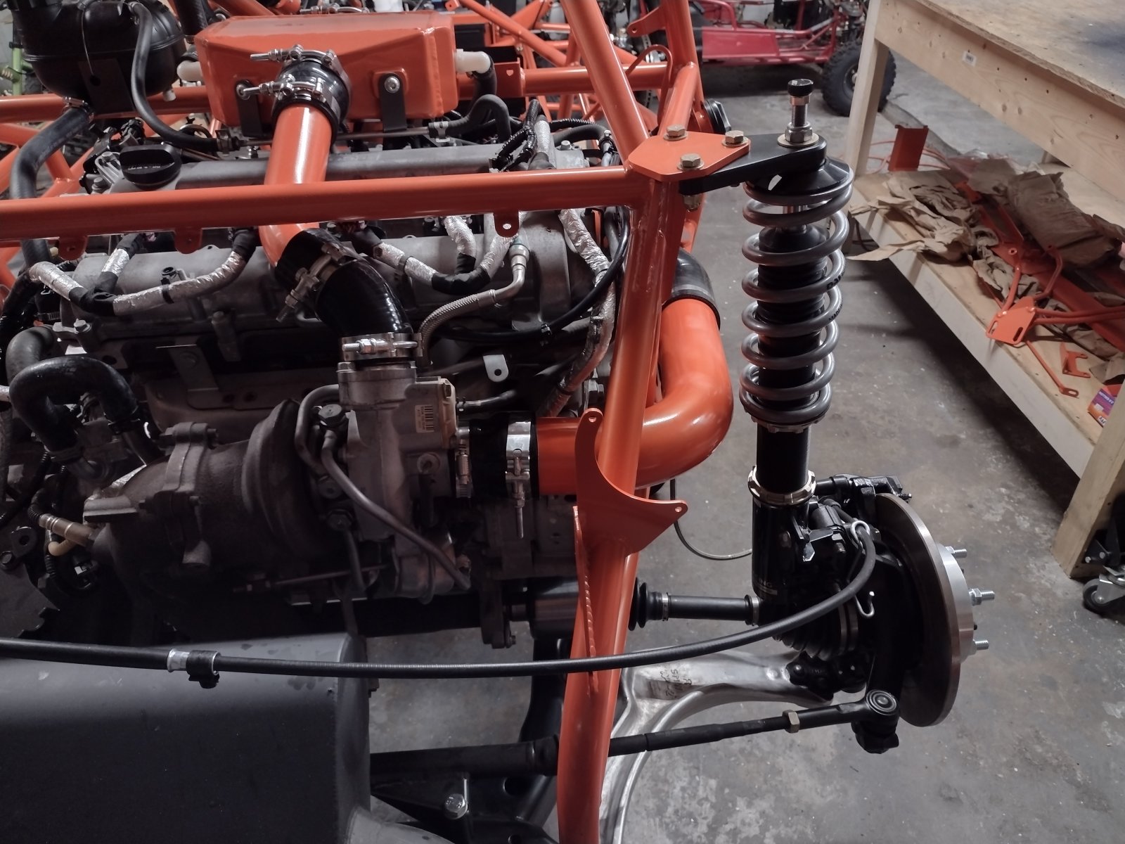

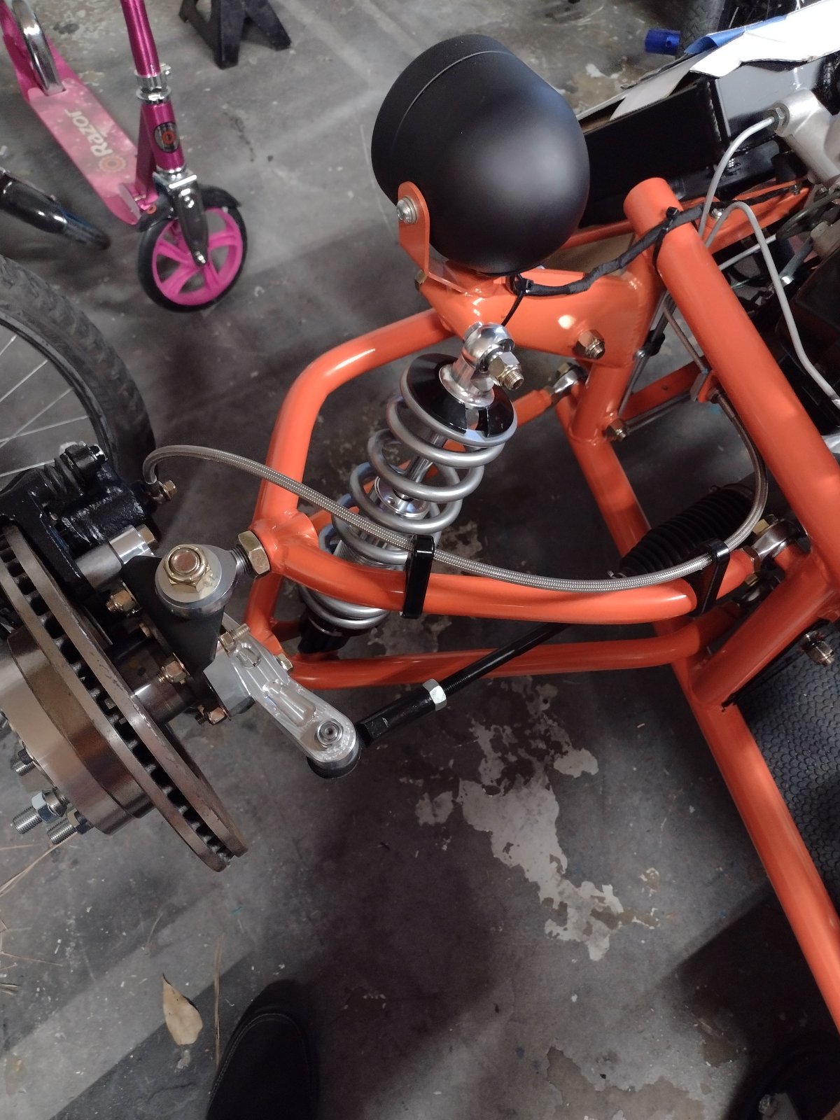

-Front suspension in except for the shocks. Need to get the proper mounting hardware.
-Installed the front brakes.
-Installed Horn.

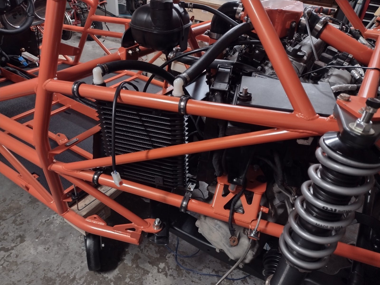

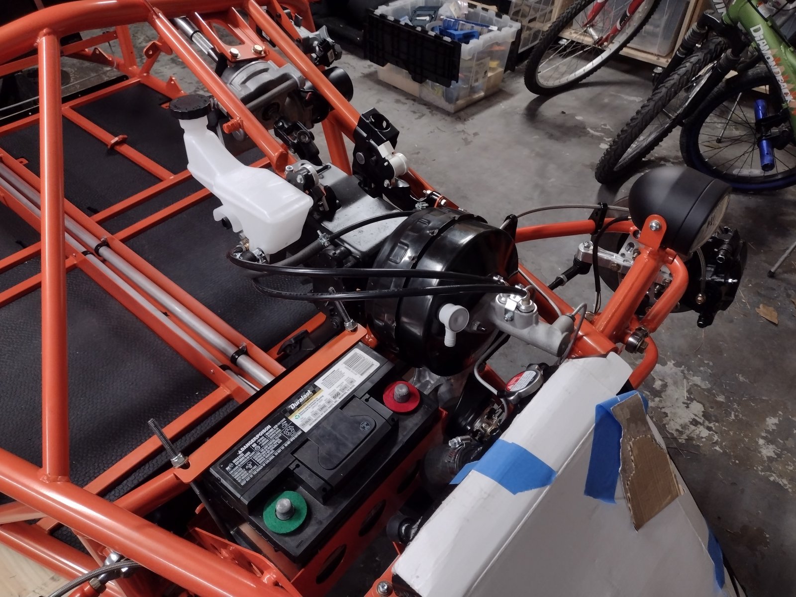

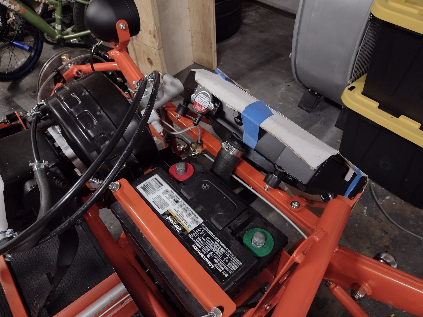

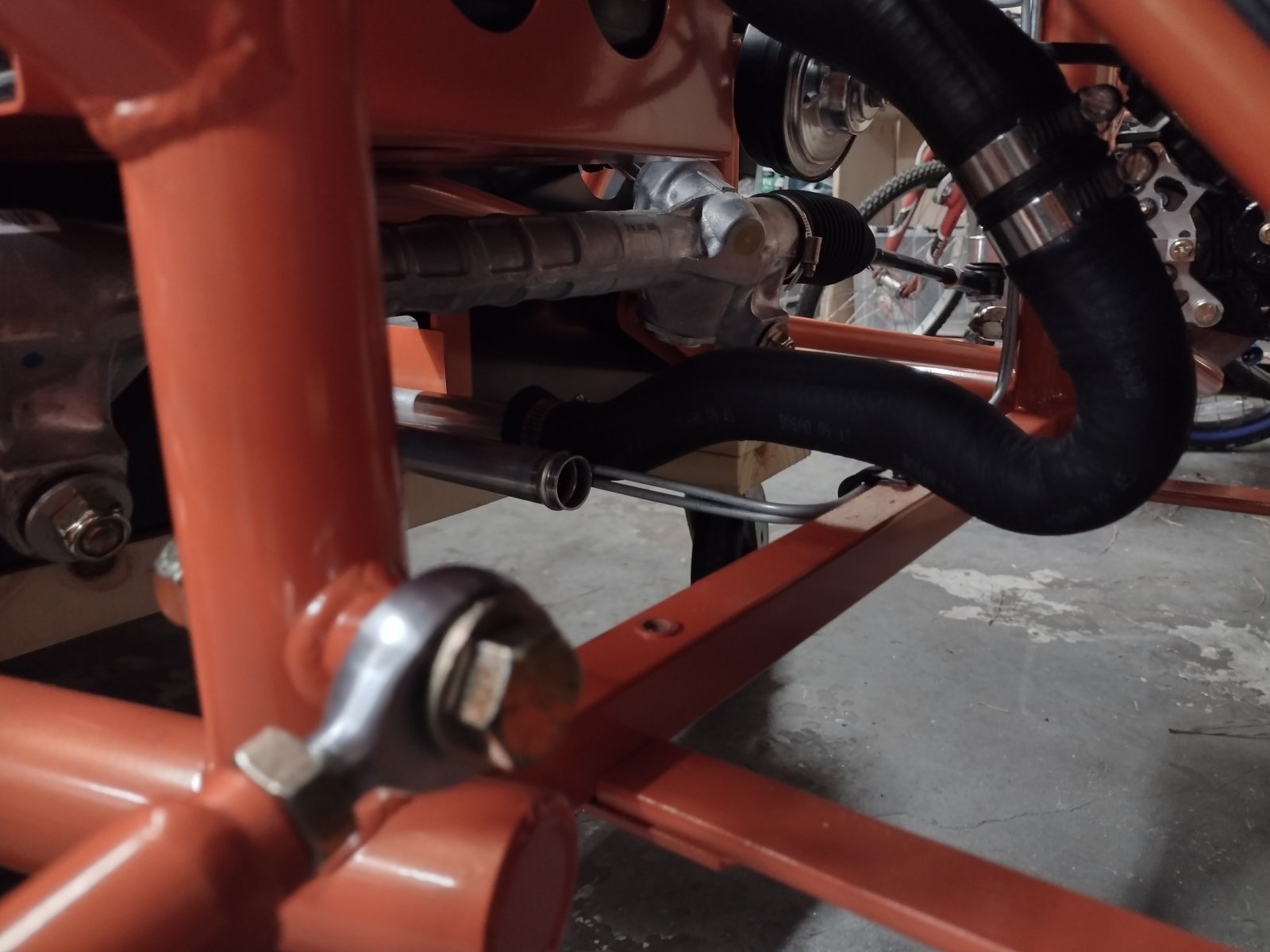

-Install coolant tubes in center console. Used 1" aluminum tubing from McMaster Carr and put beads on the ends to hold the hoses. Then anchored the tubes to the tunnel with 1" vinyl coated clamps.

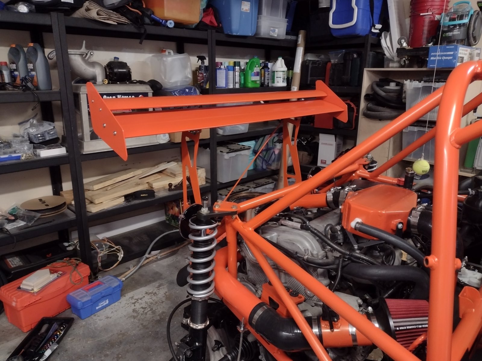

-Installed the motor and subframe. Made this a family affair with the wife and kids and it went really well. Also got the subframe bolted down. Had to use some ratchet straps to move everything around a millimeter here and there to get it all to line up.

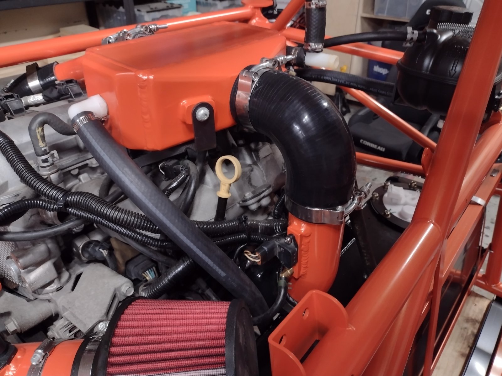

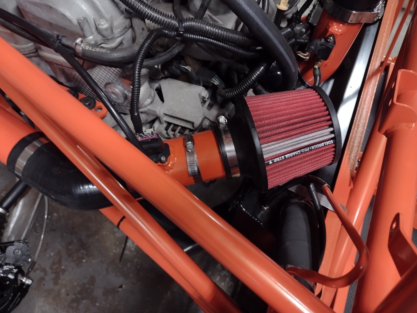

-Got the intake all setup.
-Hooked up the radiator.
-Fuel tank is in.
-Fuel line ran.
-Also have the passenger side rear suspension installed. Need to get some hardware to hook up the drivers side. Snapped a bolt that holds the hub on so I have to track down one of those.
-Steering system is also completed.
-battery installed
-rear view mirrors installed. Center mirror loosely installed. Will position once seats are installed.

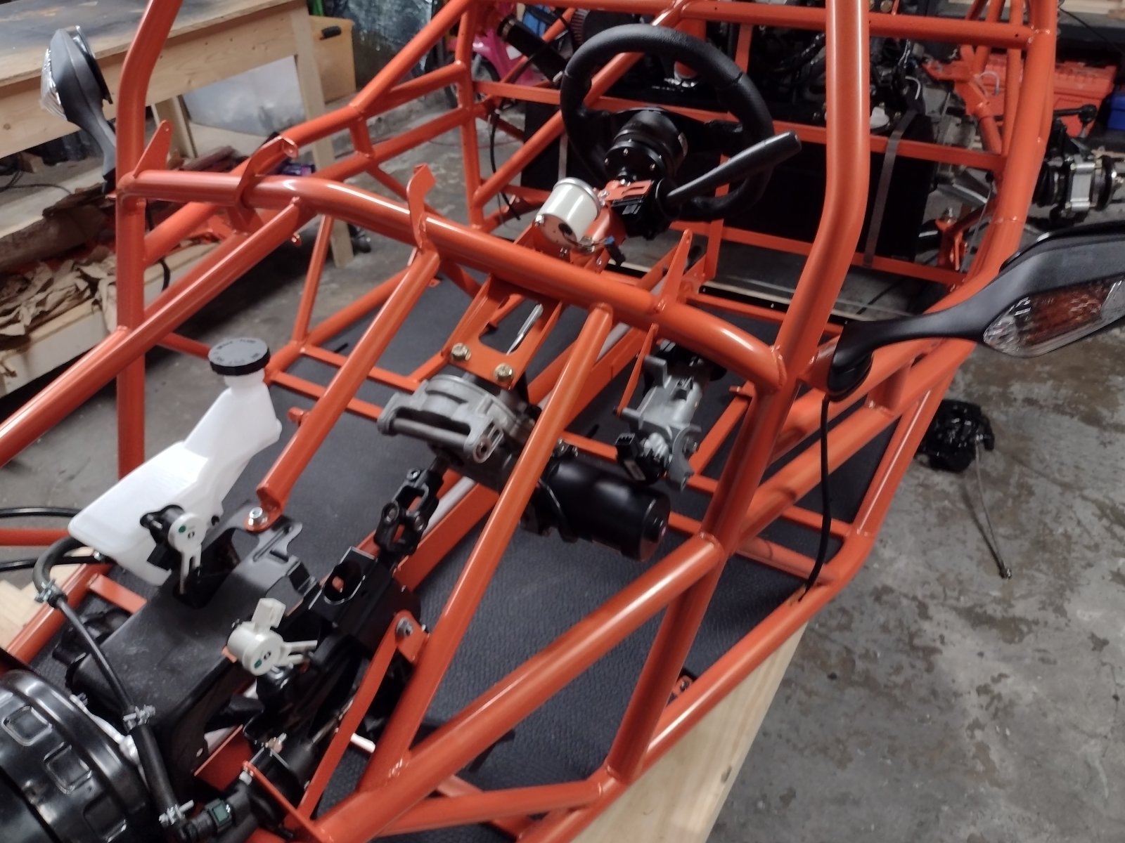

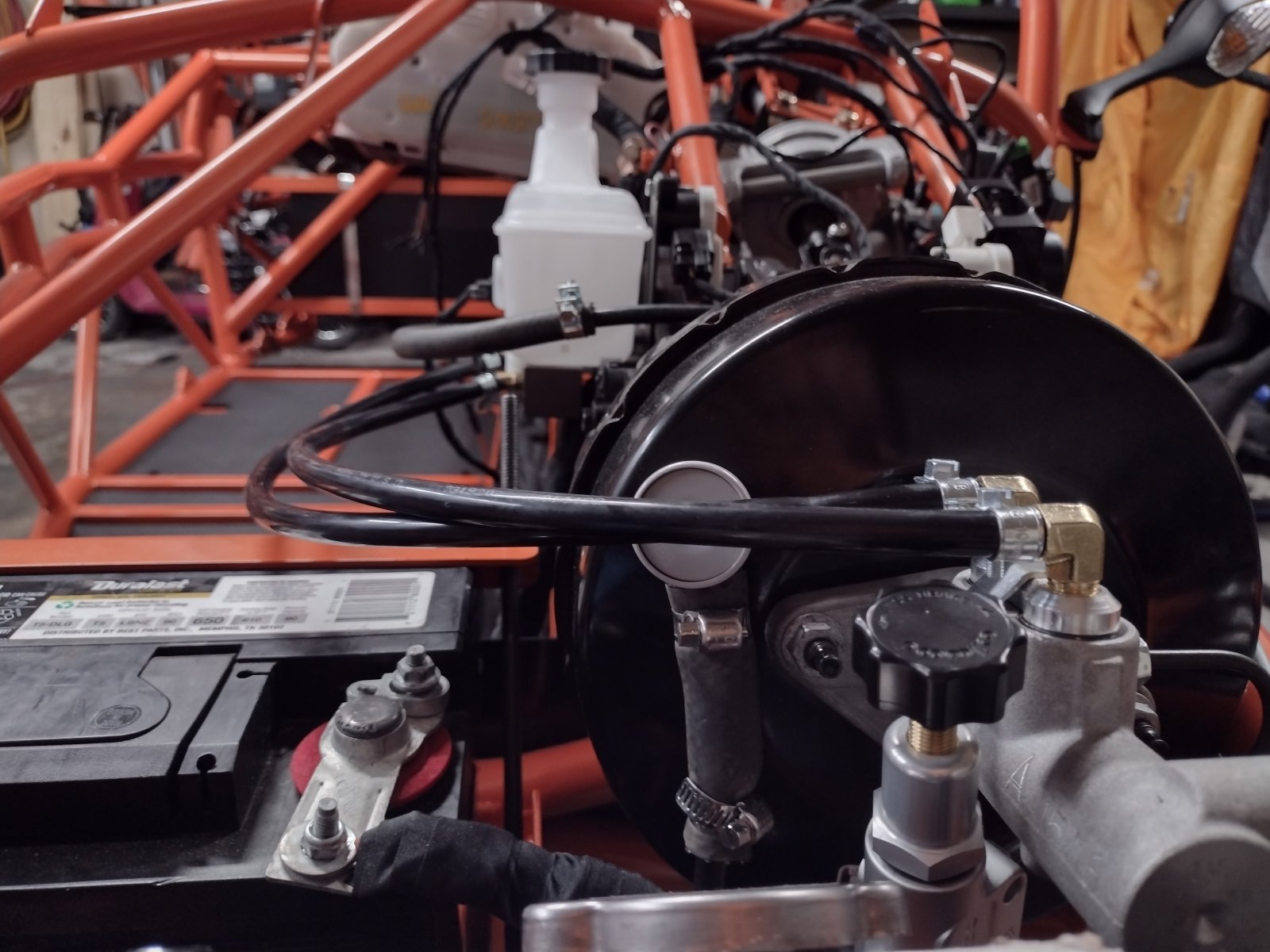

-master cylinder and brake reservoir installed
-boost gauge installed
During the week, I hope to get the rear radiator lines connected, mount the heat exchanger, and work on electrical. I'm trying not to cram too much stuff in the front since I want to have space to install the brake proportioning valve.

Running the radiator lines through the center tunnel is a cool idea but I didn't see a heat exchanger up front so are you planning on a rear mounted heat exchanger?
Brett
Correct. I will be mounting the heat exchanger in the back behind the driver on the side. Originally, I was going to put it between the fuel tank and the frame but it is just a little to thick so it will get mounted a little higher up.

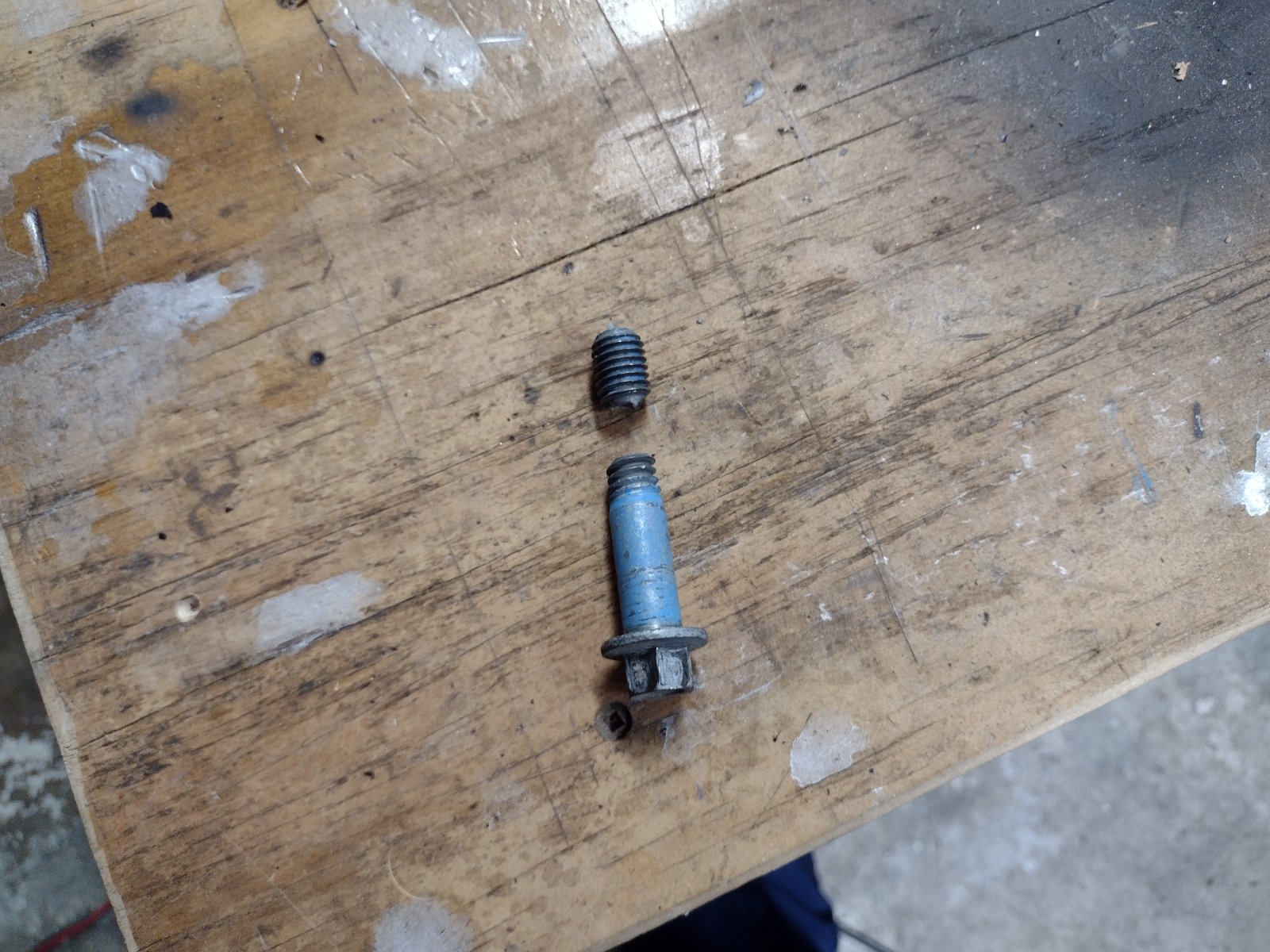

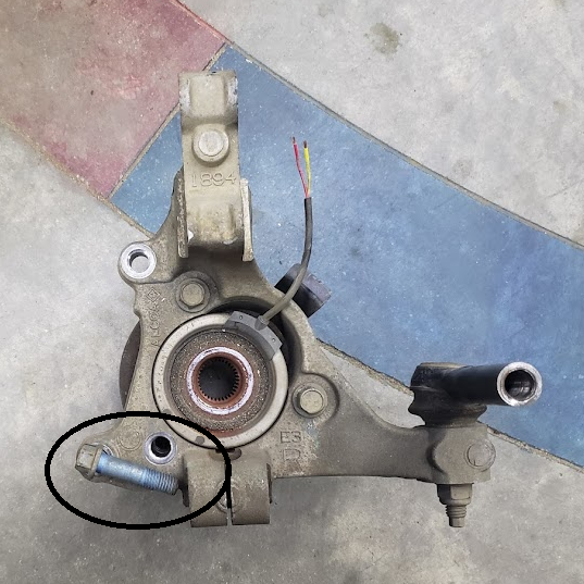

Looking good Brett. I might be able to help you with that bolt. Is it one of the 4 bolts that hold the hub to the DF upright?
Brett
Thanks Ross!
If you have one, it is the bolt from the rear of the Goblin, so from the front of a cobalt. One of the 3 bolts that holds the hub to the Cobalt upright. If you have an extra, that would be awesome. That bolt is not longer available from GM so I was going to hit the junk yard and zip one out. It would save me the trip.
Brett, here is the bolt I harvested. This is the right one?
Ross.
28587

Otherwise not much to report other than getting the brake proportioning valve installed and the radiator lines completed.

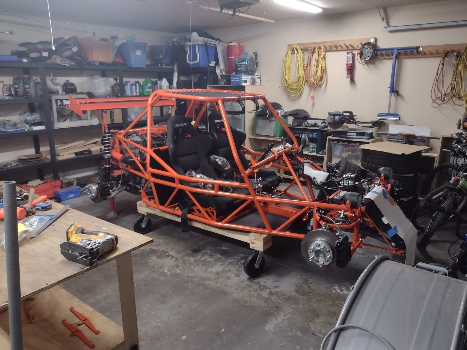

On this weeks episode of which way will the ratchet turn we make a bunch of updates.
-Suspension done, just needs to be adjusted
-got some 90 degree bends for the master cylinder adapter, now the lines are nice and low.
-brake proportioning valve is installed
-wiring is basically installed, need to tidy it up in the back of the car
-heat exchanger is mounted in the rear. I put rivnuts right in the holes on the heat exchanger and bolted it in with rubber coated clamps.

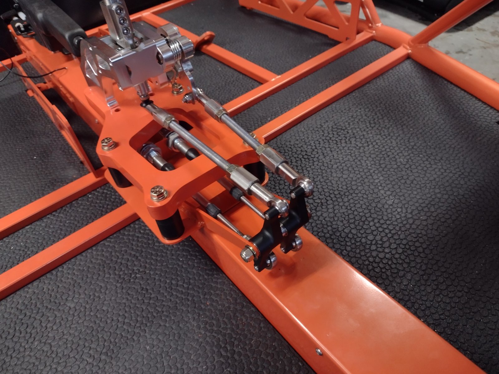

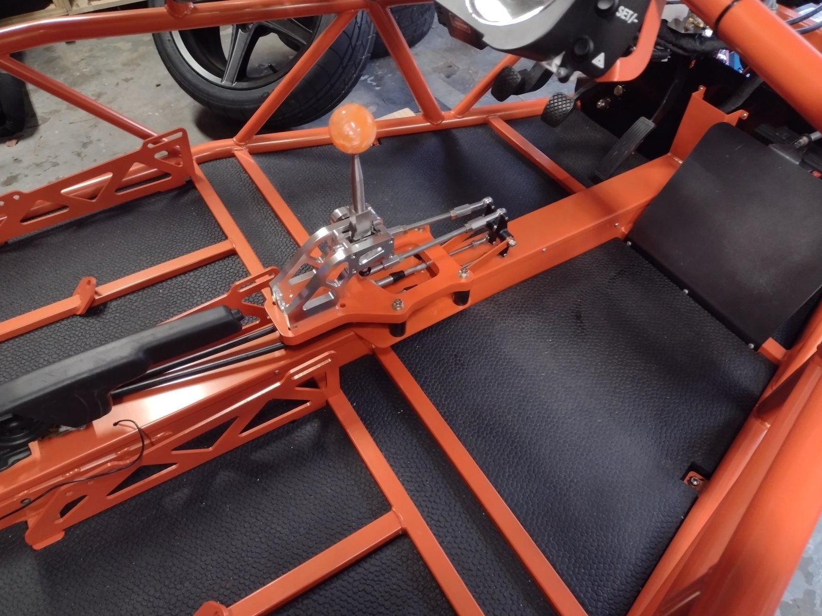

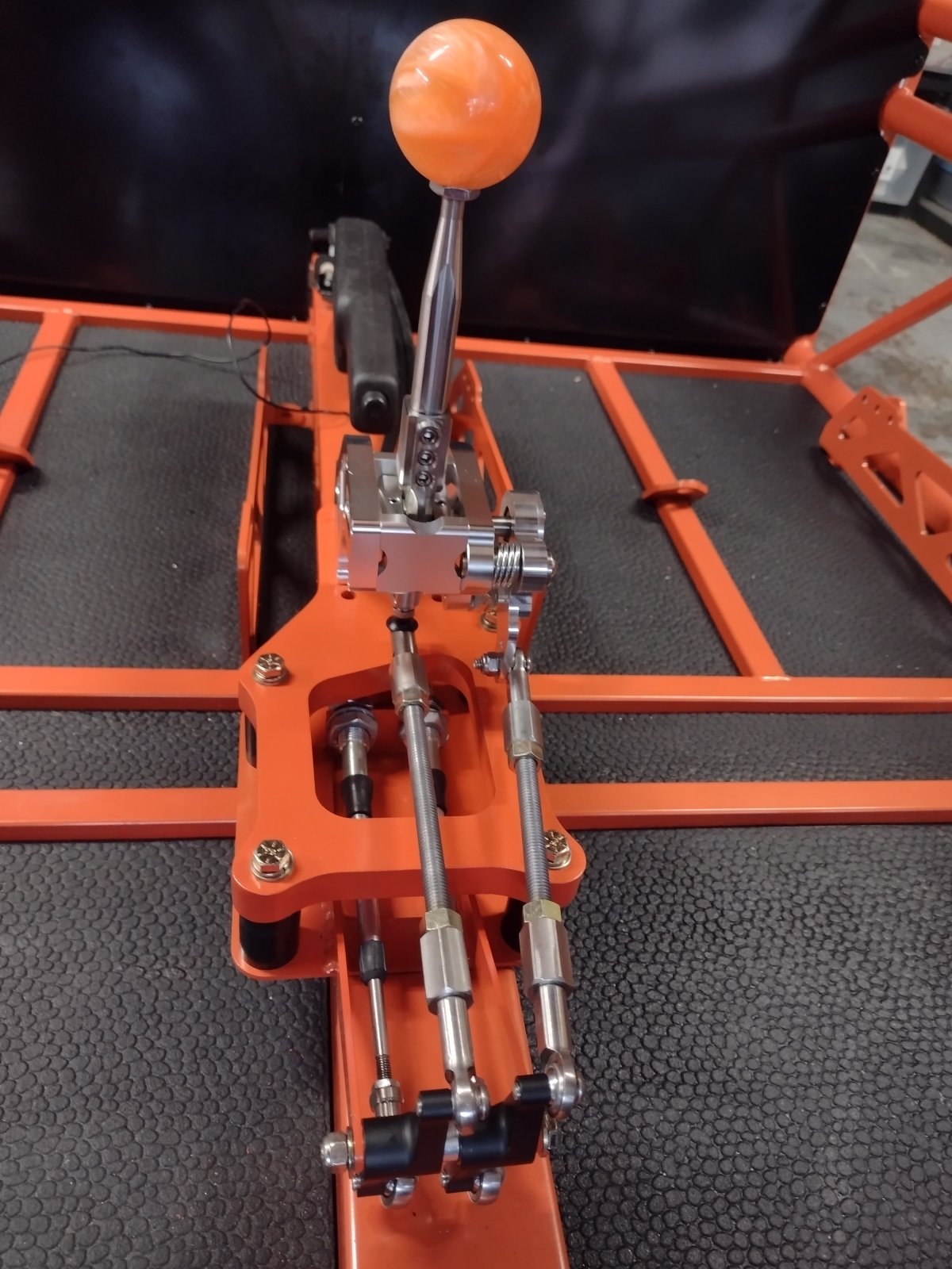

-got the group buy shifter installed. Still need to stiffen it up and put on the shifter socks I ordered from DF.
-installed the wang.
-got the seats in and verified I can still run the clutch.
-im sure I am missing a bunch of miscellaneous tinkering.

-spacer to stiffen up the side to side movement on the shifter
