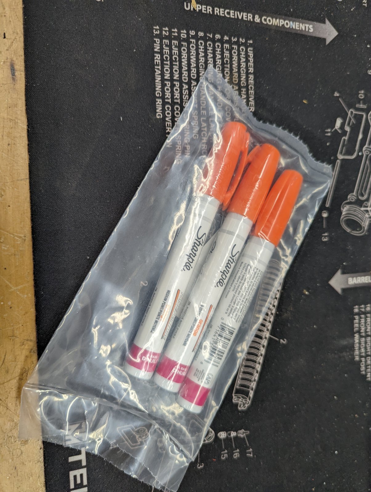

I used a paint pen to mark the bolts/nuts that I torqued so that I wasn't missing anything. Visually the rear looks way more toed in than it is, and when I went to what looked good, I was 1.5 degrees toed out and was scary under throttle. I now have .25 degrees total in and is highway stable.

Brett
Did somebody say paint pens? Yes, they are orange.
