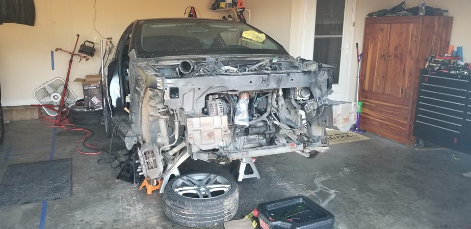

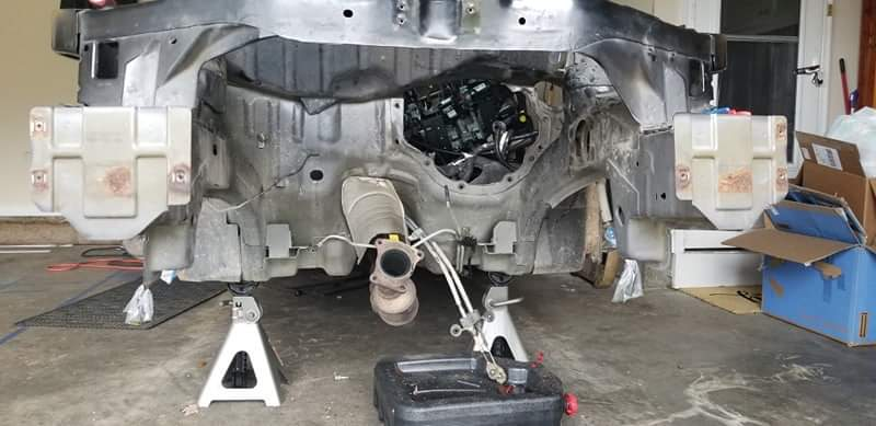

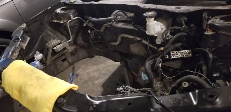

Moving forward, i spent a few hours saturday since it was nice outside. This is a middle of the progress photo. I have the brakes, calipers, spindles, struts, springs, all the AC stuff, and most of the harness undone. I still need to get the steering knuckle off and then the lower member should be ready to pull. hopefully have the motor and transmission out this weekend.
The guide videos make it seem a lot easier than it actually is. What took these guys 10 minutes took me most of an afternoon. I have been using them as a reference point on where i am though, even though i am pulling some things off in a different order.
I need to go to HF and buy a dolly to set the motor on. going to be a lot of deep cleaning on it for sure. I pressure washed it before i started pulling the stuff off it. I still find dirt, dust, acorns, leaves and other things.

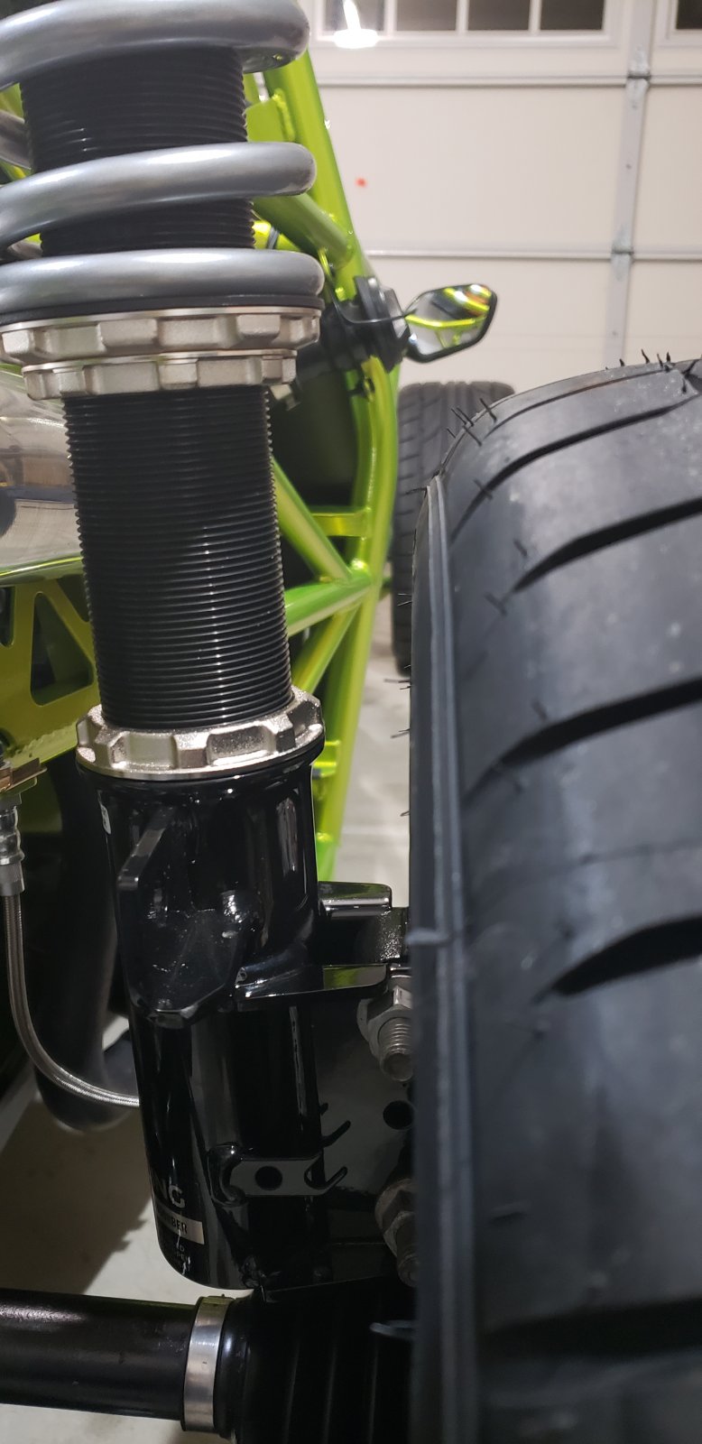

Regarding wheels, Here is a shot of a 17x9.5 with a 5mm offset and 275 tires on the rear, with the coilovers. I do not rub the control arms in the front on full lock.
This has 40mm of inner clearance (1.575")

IDRVSLO
So the 10" will work as it moves in 21mm towards the coilover from what I have. That being said if you dont have coilovers it probably wont work and you will hit your control arms at full lock up front if you go with 10s on all 4. If you go with the 9s up front you will lose 14mm of inner clearance which will probably still hit.

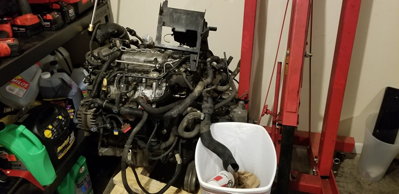

So i got a few hours of free time Sunday morning. So i spent a little time and got the motor and transmission out.. I couldn't sleep sat night and took a lot of the dash bolts out. HOPEFULLY i will have the dash and harnesses out this week. I want to give myself a few weeks to get the harness together. When it gets warm I will be doing some cleaning. The motor had a leaking valve cover gasket at some point in time.
Part of me wants to tear it down and put better rods and pistons in it.. part of me is saying just get it going. The "I miss my bike" bug hit hard last week... luckily i have been having to work over at work so its not as bad as it normally would have been. Oh well one step closer.

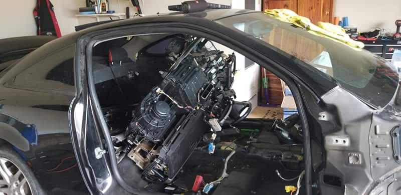

Well I have the dash disconnected from the car... I didnt feel like trying to strong arm it out so i am waiting for a friend to help on saturday... Picking up my Goblin the next saturday... man am i behind.. I really wanted to have the harness cut and ready for the goblin frame... Looks like i will be lucky to get the Cobalt out before then... I still have to pull the inside harness, tank, and rear hubs

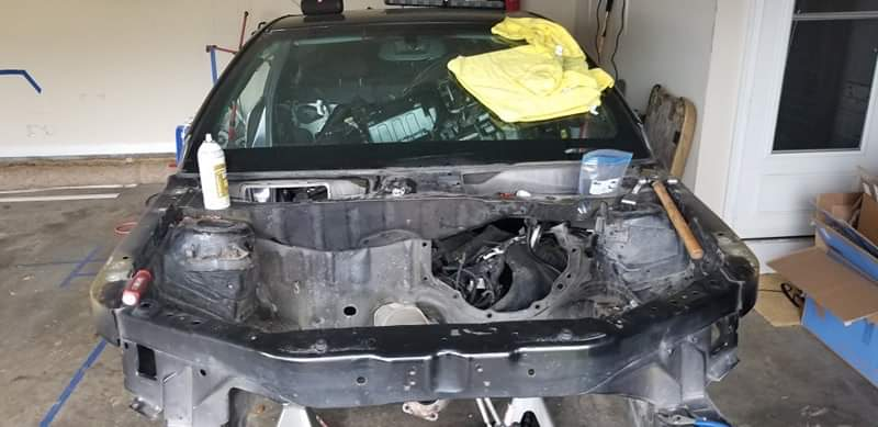

Well I have the dash out and the harnesses all out. All thats left is the tank and rear hubs. I will get those when i go to move it out to scrap it. I will be leaving for Texas to pick up my chassis after work tomorrow. Hopefully all goes well.

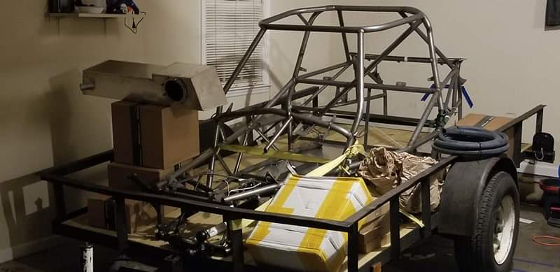

Well I spent the weekend in Dallas Texas. Made a little stop by DF and met Lonnie and Adam... Went on a test ride... and brought home some hardware. It was an over all fun trip. I (we) made it to DF on Friday which we had great weather, they were the first stop on the trip. They let me drop my trailer there and come back to pick it up on Sunday. I feel like they went the extra mile with everything. While in Dallas I did a little site seeing (gas monkey garage, fired up garage, flat 12, ASM, Arc-light Fab, Magnolia Farms, Silos, Billy Bobs Texas, Stockyards, Arlington, and some other stuff downtown). Eitherway... Frame 127 is home, going to the Powdercoater later in the week and i should be able to get the cobalt skeleton out of the garage this week as well.

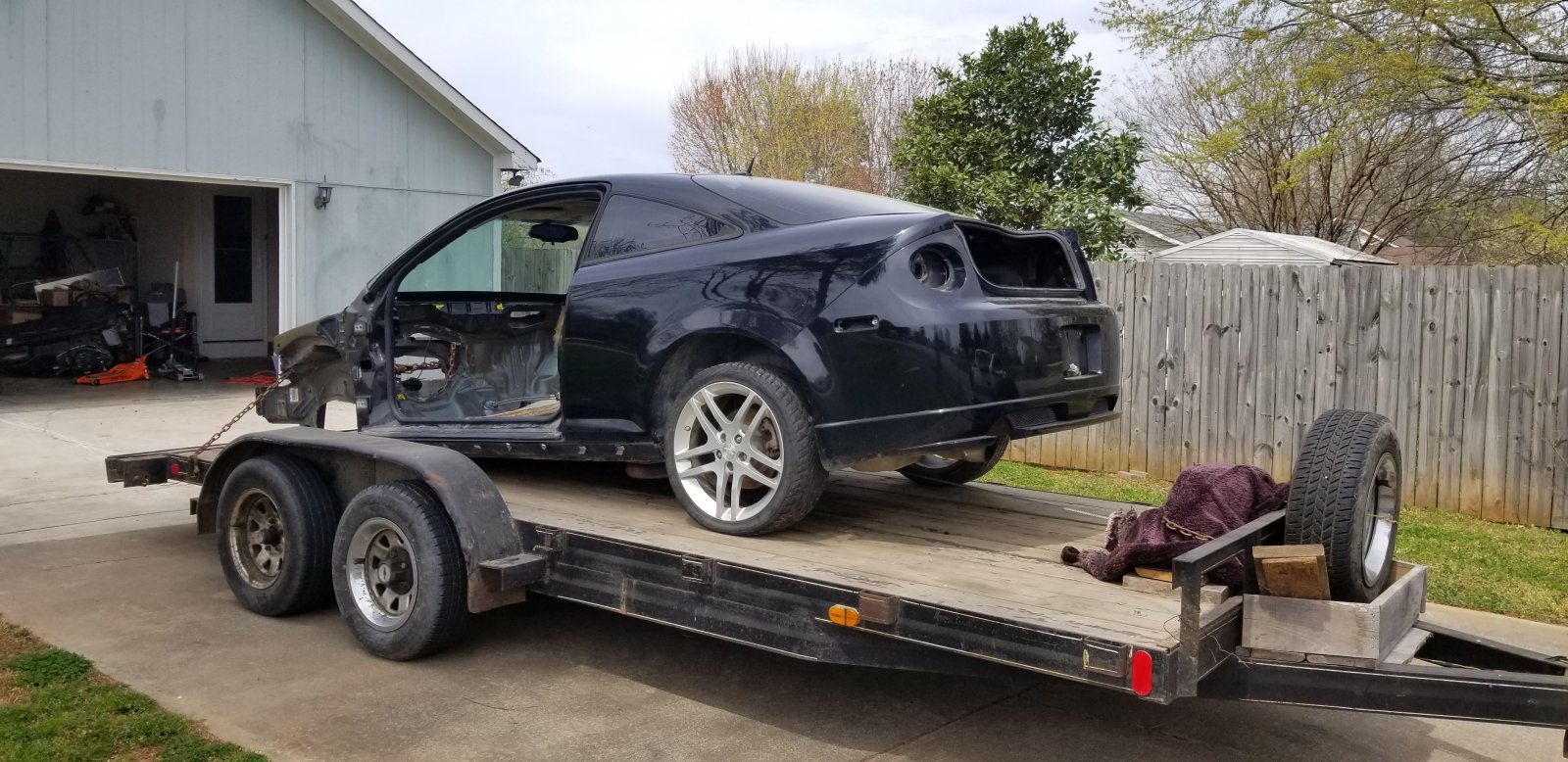

Well... the cobalt is stripped and gone. Ill be getting the rear wheels and all that back at a later time.
Yea!!! That seems to be a big first turning point in many builds when the donor carcass is gone. Sounds like the trip to Red Oak was a great time and you got your goblin kit home safe and sound. Now the fun starts and you get work with clean parts from now on.

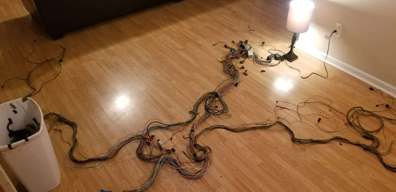

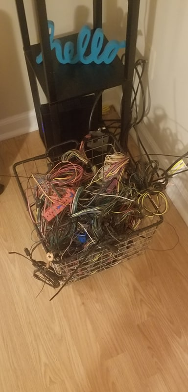

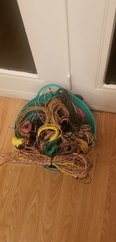

Havent updated in awhile. Chassis is at Powder coat right now, got a hell of a deal 450$ for a 3 stage color... I have been dreading the harness for weeks and pushing it back more and more... well finally gave in and started hacking. Spent all day Saturday going through video 9 and 10... first off... the Turbo Harnesses are NOT the same as the video. So i HOPE its all right. I did a lot of research and read schematics to compare. I took out several wires. Then Rolled the ones i would be using into a more organized way to store them. I went ahead and watched video 11 and decided it would be another day before i got all that together.

BaltimoreHokie
Havent updated in awhile. Chassis is at Powder coat right now, got a hell of a deal 450$ for a 3 stage color... I have been dreading the harness for weeks and pushing it back more and more... well finally gave in and started hacking. Spent all day Saturday going through video 9 and 10... first off... the Turbo Harnesses are NOT the same as the video. So i HOPE its all right. I did a lot of research and read schematics to compare. I took out several wires. Then Rolled the ones i would be using into a more organized way to store them. I went ahead and watched video 11 and decided it would be another day before i got all that together. View attachment 8363 View attachment 8364
Man, working on the ground. Thats got to be tough, hopefully that was only for the picture. The harnesses are a little different. There are things you'll want to keep that aren't in the base. Just think about what you're cutting. For sure keep the boost gauge. not sure what else. its been a while.
