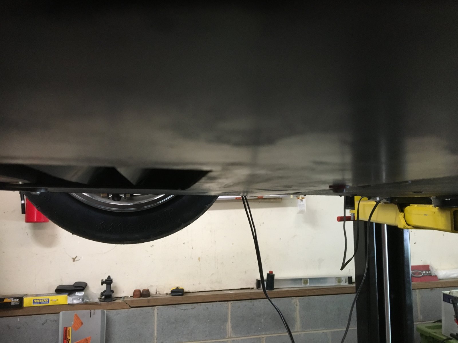

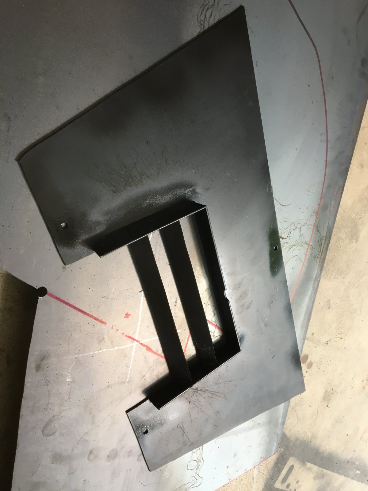

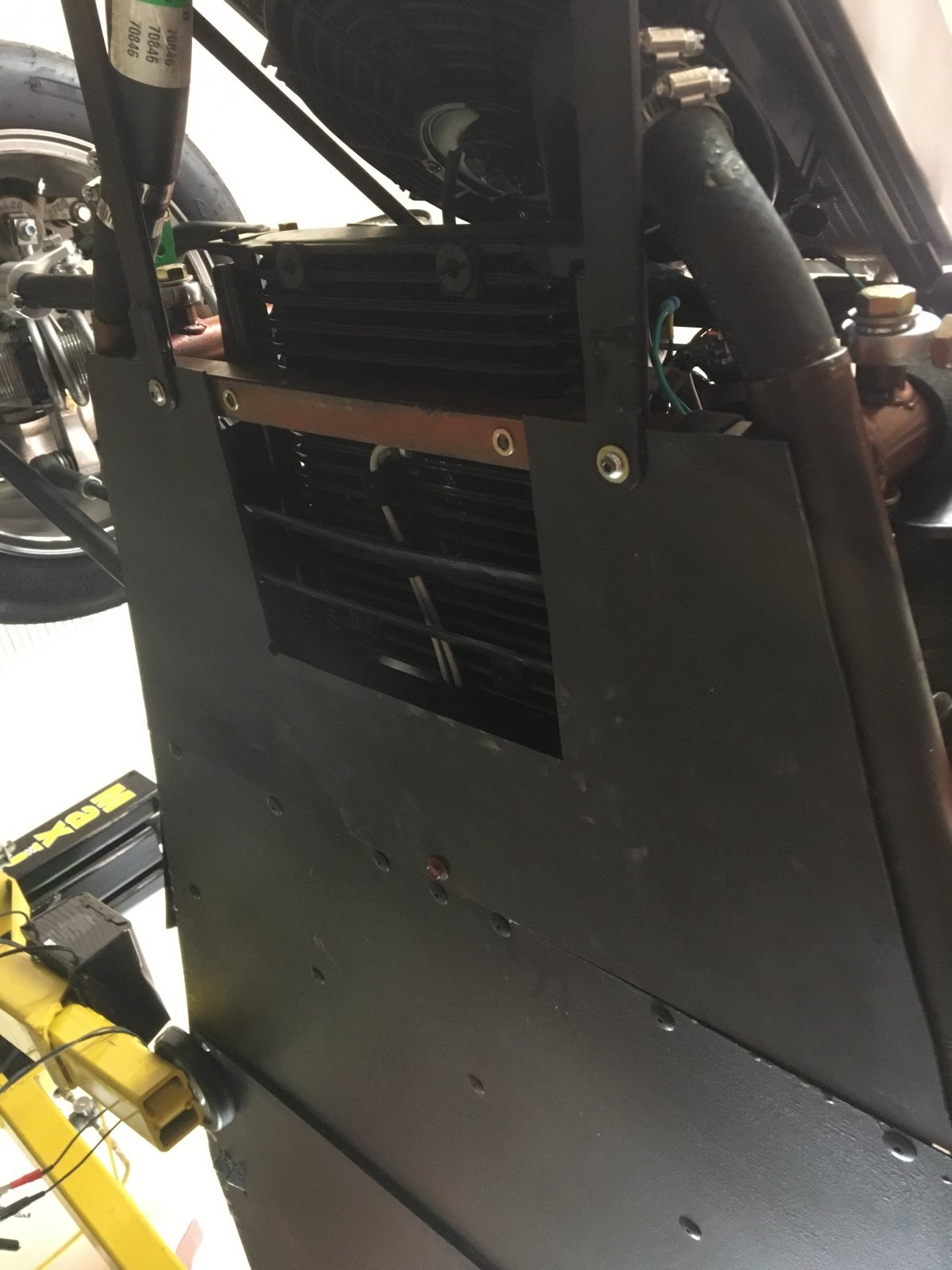

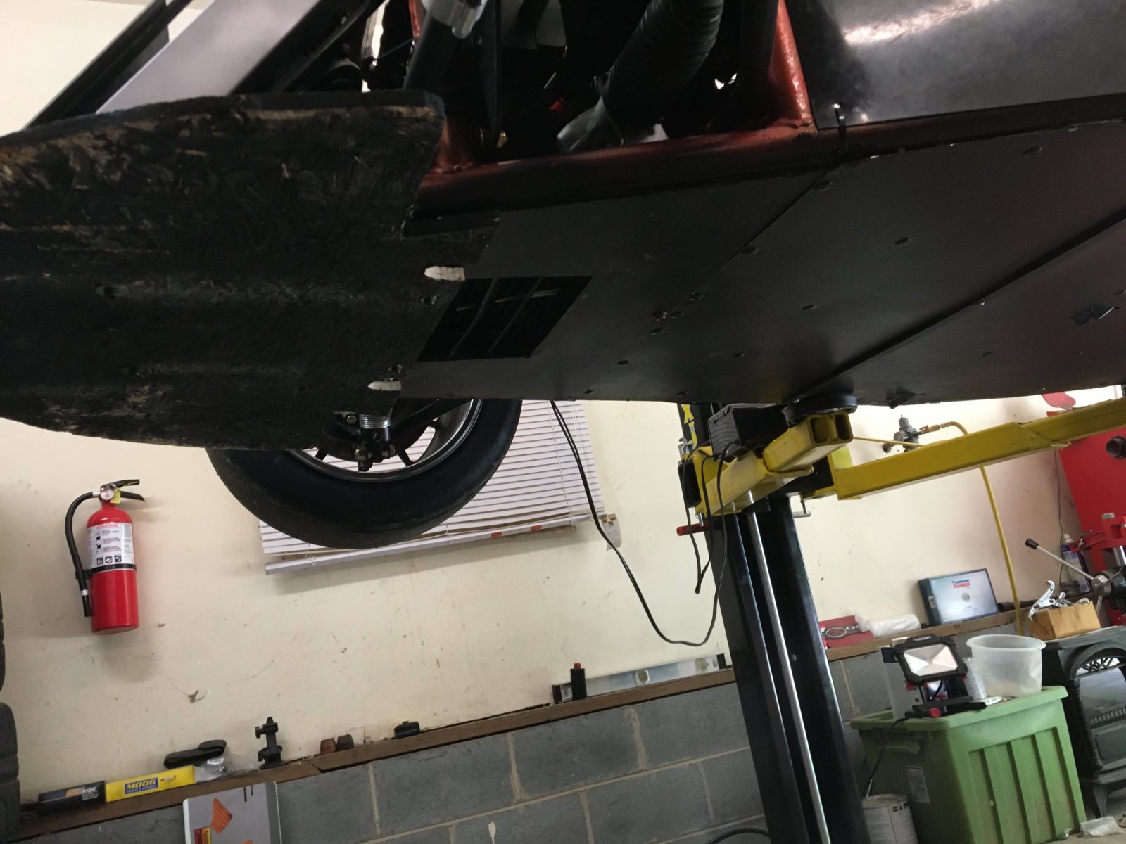

Starting to seal up the front. Plan on eventually making an engine diaper also.

Interesting addition.
Are you thinking it will help the air flow through the radiator and heat exchanger?
Or, some added protection from road debris?
Or both?
ccannx
It should protect components and help keep air from collecting in the front area. I have a removable plate partially blocking air from flowing directly into the radiator for now it takes so long for the coolant to come up to temperature. The intercooler fan is set to 1 in all columns in hp tuners so it comes on with the key. Will eventually make the front splitter from metal or carbon fiber sandwiched twin-wall polycarbonate.

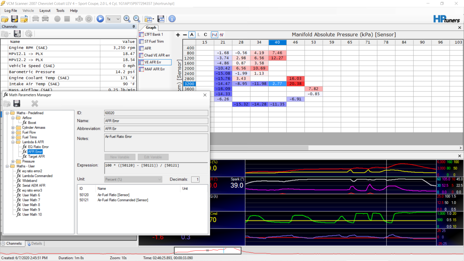

Can't seem to figure out how to get the commanded AFR to show a baseline. I already see some knock and the AFR's look way lean. Here is a short log haven't got the VE tables to populate yet.....
Need to see a HP Tuners log file to see how it is running.
I see your air-fuel ratio commanded (lo res). Started the log at 14.0:1 slowly went up to 14.7:1
Looks like you get knock when you throttle up.
You got real lean (18.5:1) before the RPM went up.

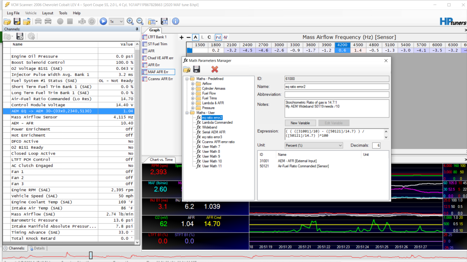

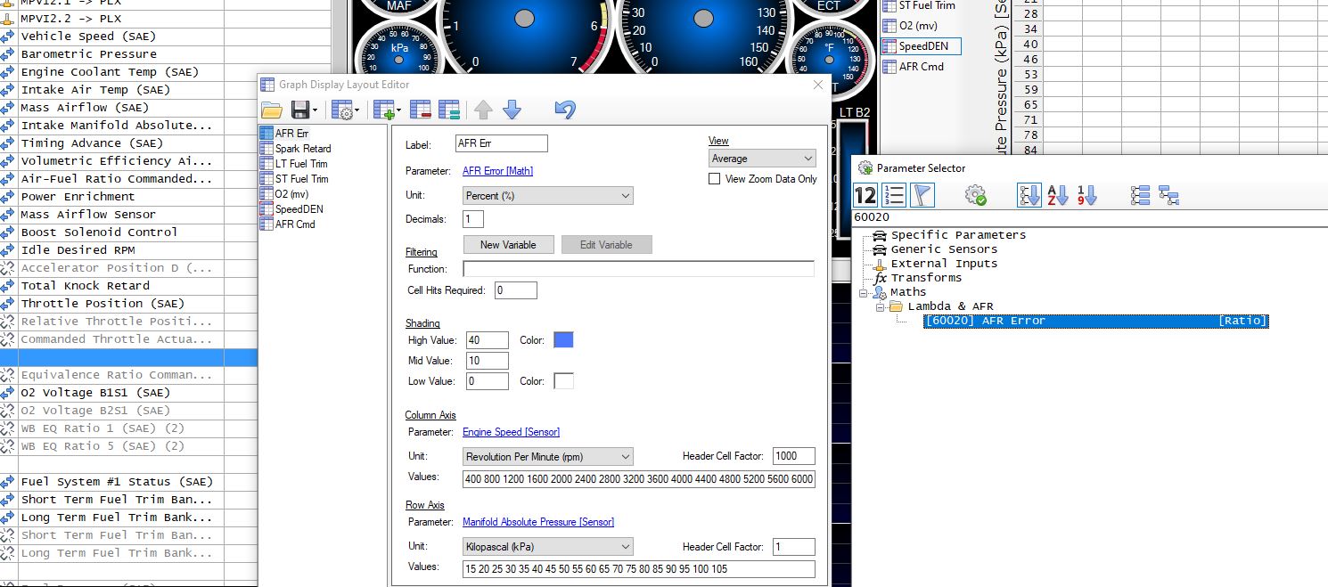

I see VE errors table populated... but its using the AFR Error [Math] parameter that I am not familiar with. Normally I make a Math-User with a custom % error calculation, using the
(("MPVI2.1 -> PLX" - "air-fuel ratio commanded (lo res)")/"air-fuel ratio commanded (lo res)" )*100.
14560

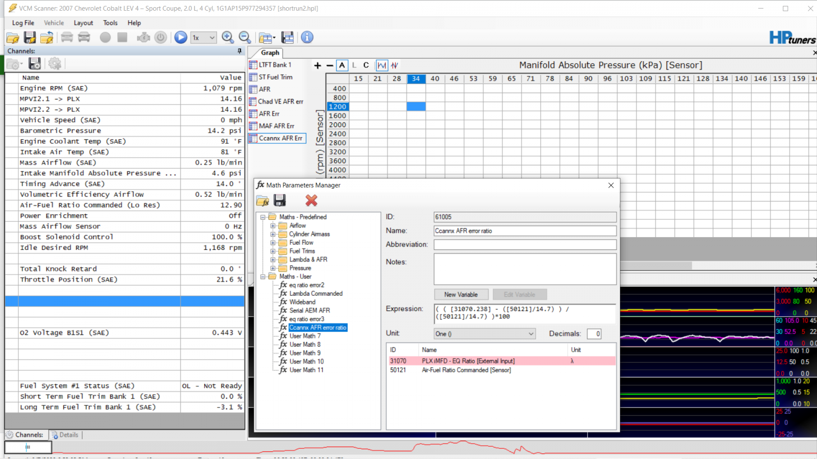

ccannx
I did not have that math setup. I was able to create it. Do I apply it to my graph for speed density as the math ? I'm still not getting a population on the speed density table, must still be missing something somewhere...
  • shortrun2.hpl
    shortrun2.hpl
The math setup should use your wideband AFR and the commanded AFR to get a % error.
Does your car have a stock wideband? I see log numbers that look your wideband in the parameters as "MPVI2.1 -> PLX" and again as "MPVI2.2 -> PLX", but when I search for that name to use in Maths - User formula, I can't find it.
Do you have an MPVI2 Pro? Are you getting your wideband info thru the CAN bus, or thru a serial port, or one of the extra MPVI2 Pro channels? (I use serial, as 2006 didn't have CAN bus)
In this image I tried "ID 31070 PLX iMFD - Eq Ratio [external input]" hoping that that was your wideband, but no, it didn't populate. :(
14573
My wideband Maths-User looks like this:
14575
That %error can be plotted with the same axis as the MAF table (as in the image above), or the Main VE table, or your fuel injector table... basically any table.
Once the %error is plotted (graphed) the same as your Main VE table, you can apply it (paste special, multiply by %) or multiply by half %.

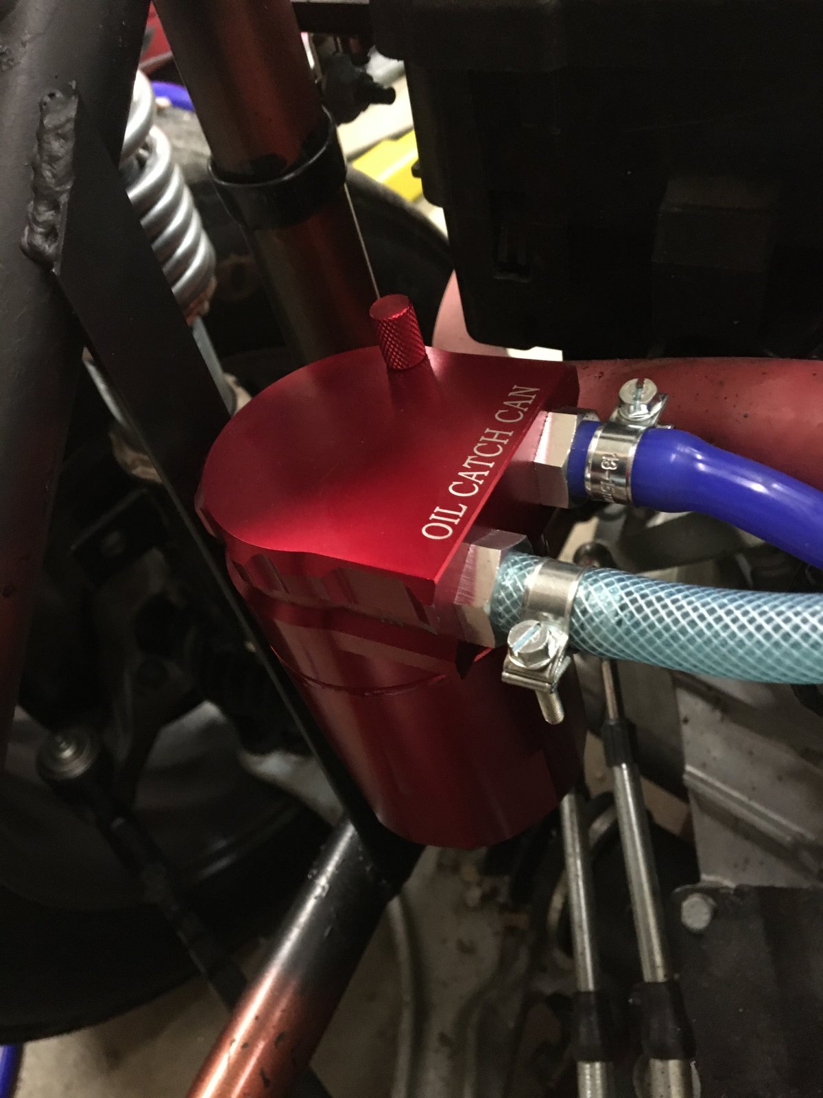

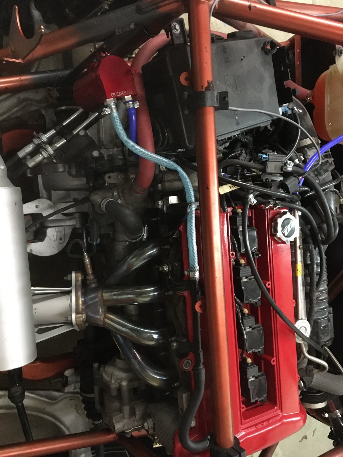

A couple of times I have noticed oil dripping from the Goblins intake. Ordered a catch can a while back and finally got around to it this morning.
ccannx
The catch can was 26$ The one for my corvette was about 160$ I will have to read up on the oil separator when I get a chance.
A trick to do with the eBay catch can is the baffle inside can be made much more effective by putting a very loose ball of very course stainless steel wool inside the the cavity. It is almost as effective as any oil separator and is cheap. ;)
ccannx
That's what that steel wool was for !
