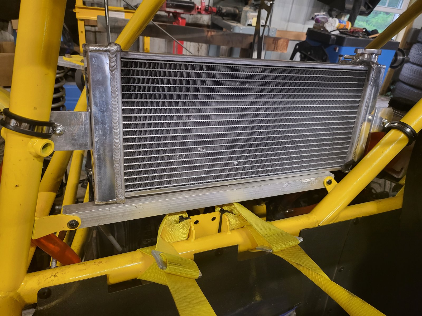

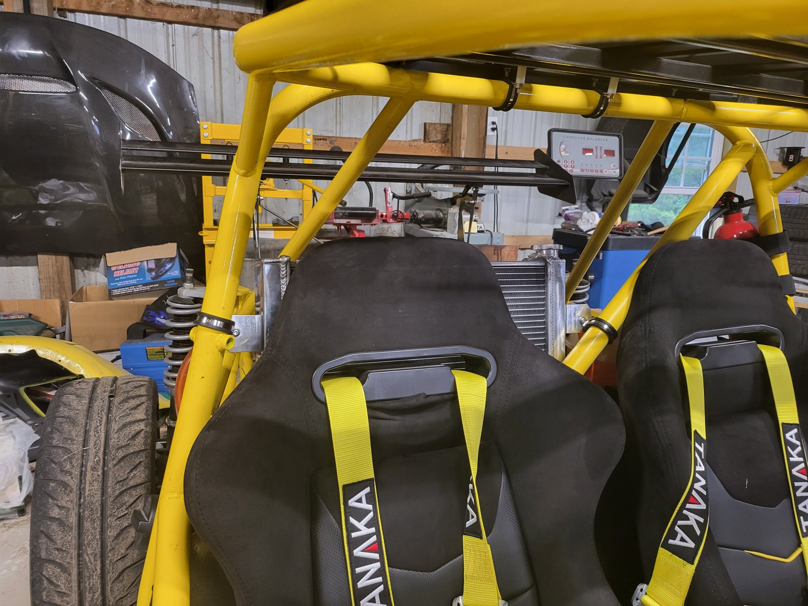

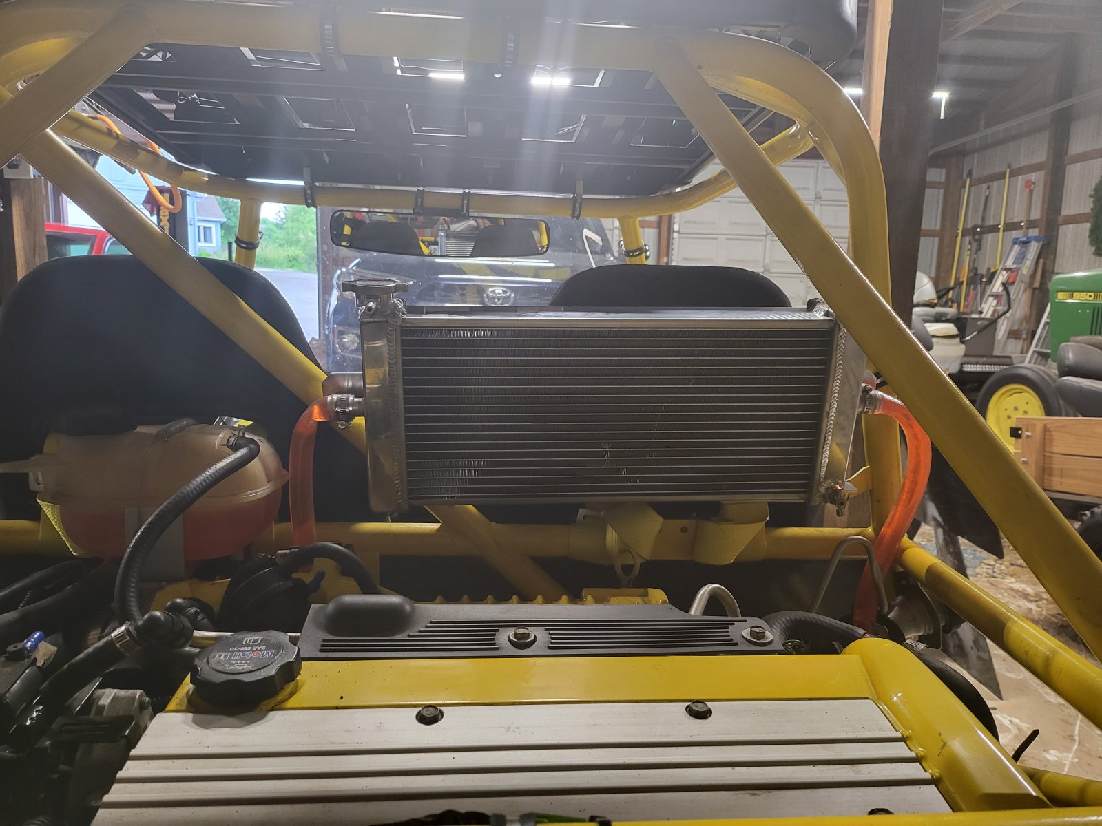

Some of you may know from other threads I was experiencing some high iat2 temperatures, in the neighborhood of 150°, even while idling. I believe the heat exchanger was absorbing heat from the radiator, which is relatively close to it. I ended up installing an auxiliary heat exchanger behind the passenger seat. Although air flow is mostly blocked by the passenger seat, it's still managed to lower iat2 temperatures by at least 10°, and probably 20 in most cases. Just cruising around, temperatures are normally around 125°, which seems completely acceptable. Under heavy load, they get up to the 145/150 degree range, which isn't ideal but still seems acceptable. See photos from mounting. I used a couple of factory installed mounting points behind the seat along with a piece of angled aluminum.
I need to get a 90° elbow for one of the hoses, as the inside hose is bent too sharply and kinks a little. It doesn't seem to affect flow, but an elbow would be better. It's a work in progress but I'm pleased with the results so far.

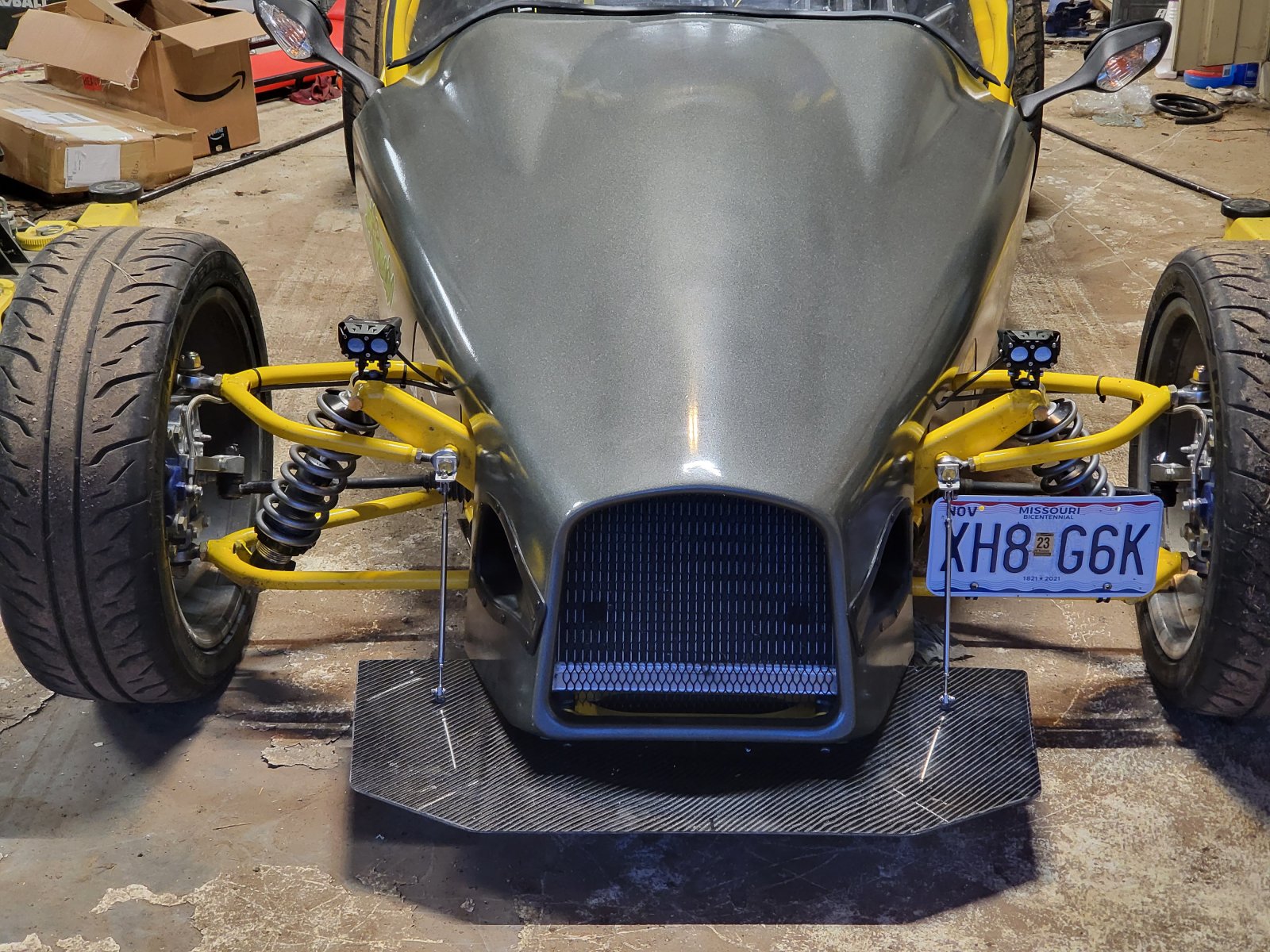

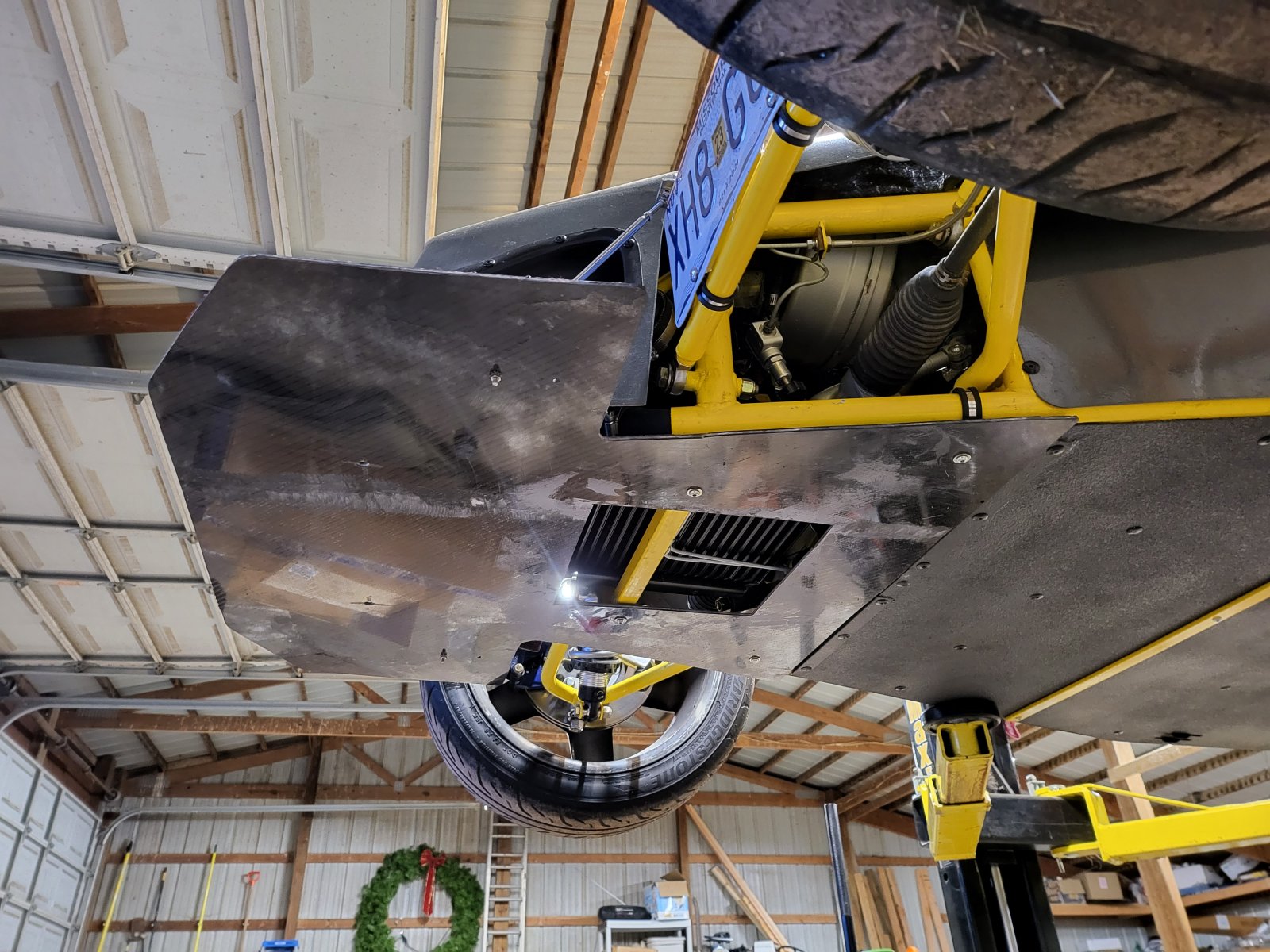

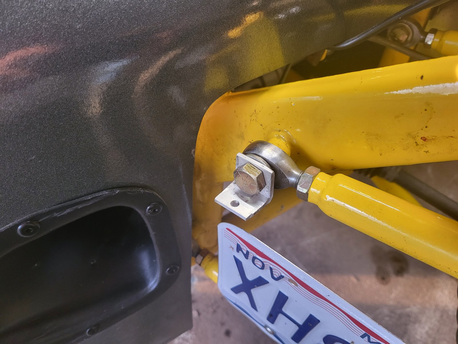

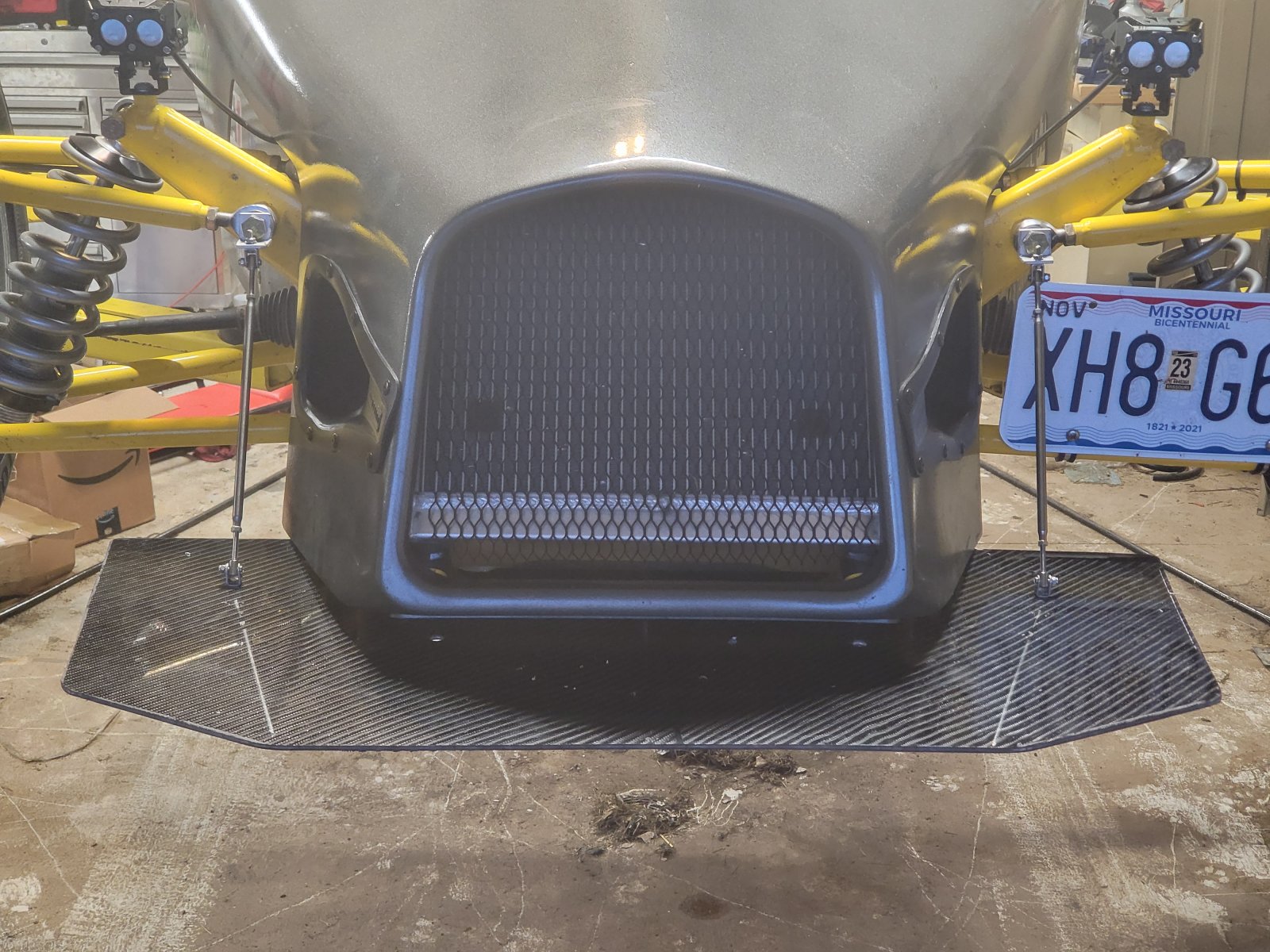

Next up, I mounted a carbon fiber front splitter. The splitter itself is a wet layup piece of carbon that I made in the garage with carbon fabric, and epoxy resin. Since the middle layer of it is made of a fabric material that absorbs a lot of resin, it's not the lightest weight possible. But it's still weighs next to nothing, and is crazy strong.
Mounting, unfortunately, turned out less than ideal. It's somewhere between "I guess that's good enough", and "that'll never work". The front supports just aren't far enough in front, and the very front flexes quite a bit. It's not terrible, but I wouldn't dare stand on it. It'll support maybe 50lbs, and that's a stretch.
Still, it looks amazing. I have test driven yet, but I hope to tomorrow.

I just made a big sheet, about 34"x38" if I remember right. Sandwiched between two large pieces of glass to make the final product smooth. There's some porosity in it because I didn't have equipment for a vacuum seal, but its minor.
Then I marked it all up in the right shape, and cut it out with a grinder/cutoff wheel.
Also, it works! It isn't a night and day difference, but the front end is more planted. The alignment made it feel 90% more planted than it was before, and I'd say this little bit of downforce added another 10%. It definitely won't fix a squirrely car, but it will help a bit.
