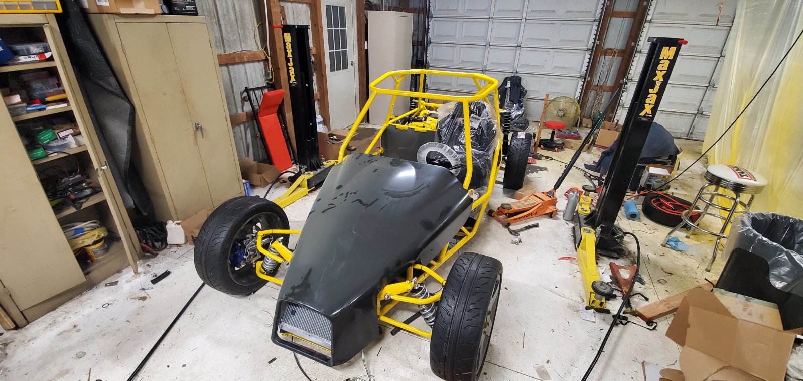

Time for a status update and a few pics.
The car is essentially built. The punchlist is pretty short....wire up the mirror turn signals, wire the tail lights and 3rd brake light, and wire up the dash buttons. Do a basic alignment. And finally, tune, tune, and tune some more. The car at least moves under it's own power, although I haven't driven it yet (just scooted it around in the garage). The hood and side panels need paint and mounting, but that will happen after the inspection.

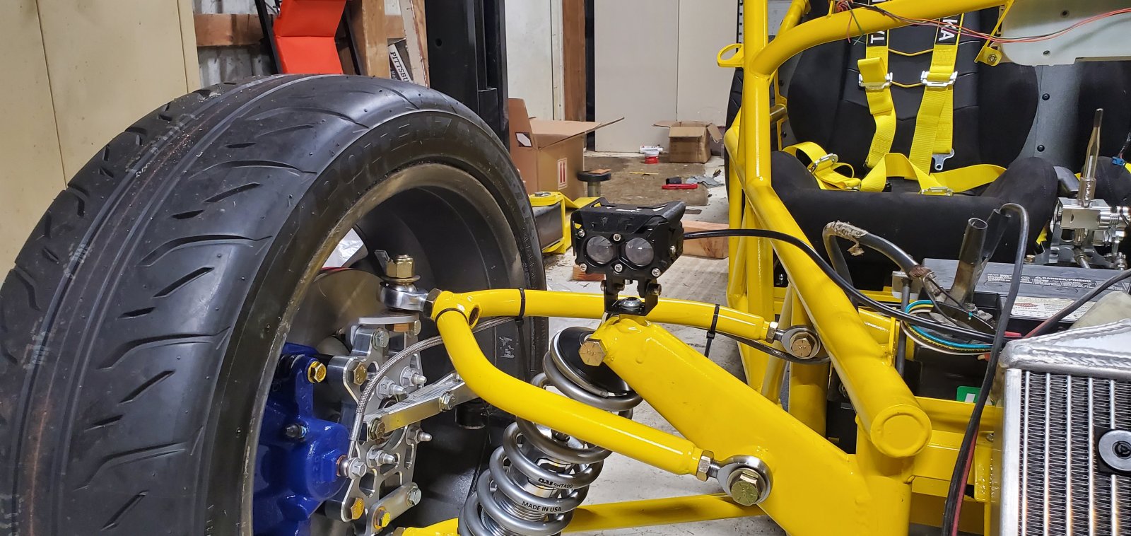

the headlights are these: https://www.amazon.com/gp/product/B08PKHC8VJ/ref=ppx_yo_dt_b_asin_image_o06_s01?ie=UTF8&psc=1
They are super tiny, and super bright. I'm impressed with them, although we will see how bright they are on the road. High and low beam functions, and they have an actual beam pattern, which is nice for a cheap headlight. The low beams are actually lower than the high beams. YOu know, like a real headlight!

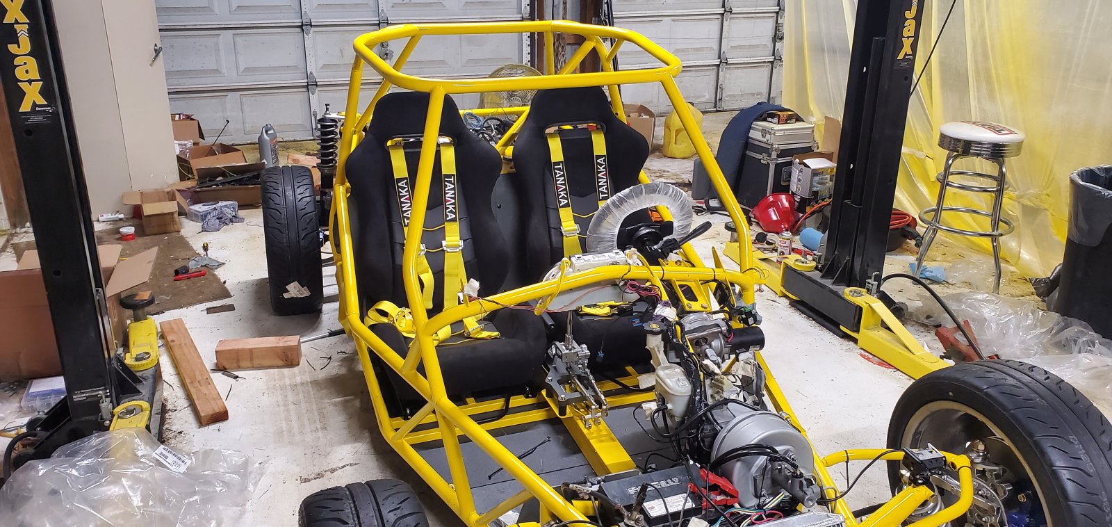

The seats are ebay specials, and they are exactly what I wanted.
They are super comfortable, and very supportive. No, they are not as supportive as the factory corbeaus, but they also aren't as restrictive. Plenty of room to get your knees apart. They feel great, I doubt I'll slide out of them, and they fit the car perfectly. The sliders they came with are the cheapest things possible, but they do work.
Seat base were also ebay specials: https://www.ebay.com/itm/231857036812
They are flimsy, but they fit the seats and the goblin. It took some 3/4" thick spacers in the rear, and some longer carriage bolts through the frame to mount them, but they work fine. I figured flimsy was ok, since they are mashed against the floor, and any crash loads will be taken by the cage and the belts.
Hopefully I can take it for a quick shakedown run to see what breaks before making the trek to the highway patrol station.

What was the weight on the seats, didn't see it mentioned in the description?
So sorry, I never bothered to weigh them. And now they are in the vehicle.
If I ever pull them out again, I'll be sure to stick one on a scale. Just taking a wild guess, I'd say they are around 30 lb. They certainly aren't lightweight, as they have a metal skeleton, lots of padding, the sliders, and a reclining mechanism. If you want pure racing seats, those are not for you.
I think they are an excellent compromise between a street and a race car though. Comfortable enough for everyday use (and adjustable), supportive enough for the track. I'll let you know if I change my tune after the first couple autocross events.

So I have a personal question….. I’m 6’3” 250lbs, are you anywhere similar? I’m looking for inexpensive reclinable seats and I’m worried that the harness slots might be too low and the seat to narrow.
C
I think you'd probably love these. I'm 6' 1", about 210. They fit me really well. If anything, I wouldn't mind if the bolsters were just a little more aggressive, or a little narrower. But the suede material is really high friction, so they feel very supportive even if they are slightly wide. I'm definitely not sliding out of them, and they are comfortable. It's nice to be able to spread your legs a bit while cruising.
As with any cheap seats, I worry about how long they will last, but so far they have held up well. I try not to slide across them when I get in and out of the vehicle. So far, they have no wear, though I've only driven the car maybe a dozen times. With some precautions, I'm hoping they do just fine.
I'm 6'2" 230 and could not stand the factory SS seats but am reasonably comfortable in the 36" wide corbeau FX1 seats. I would prefer them to be a little more reclined but that would sacrifice leg room.
J
Awesome, thank you. Yeah I’m not to worried about how long the seats will last. Just want a cheap set then later look into some better ones.
mom just about to order my kit so I’ll have a bit more time to find seats, but I like the ones you have.
thank you again.
