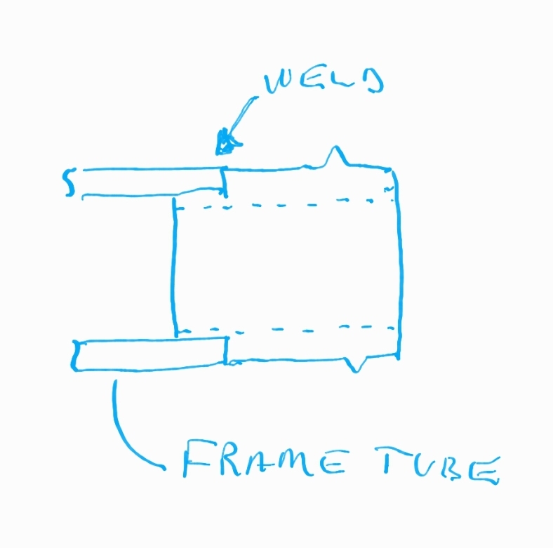

I was wondering about this a few w weeks ago. I'm building with a cheap paint job on my frame until I am ready to powder coat, but my concern was that if the coolant hose is in the frame, it will need to be removed to cure powder.
I'm thinking something like this.

Another concern would be expansion and contraction of the lower frame rail only. I'm not sure what the forces would be there.

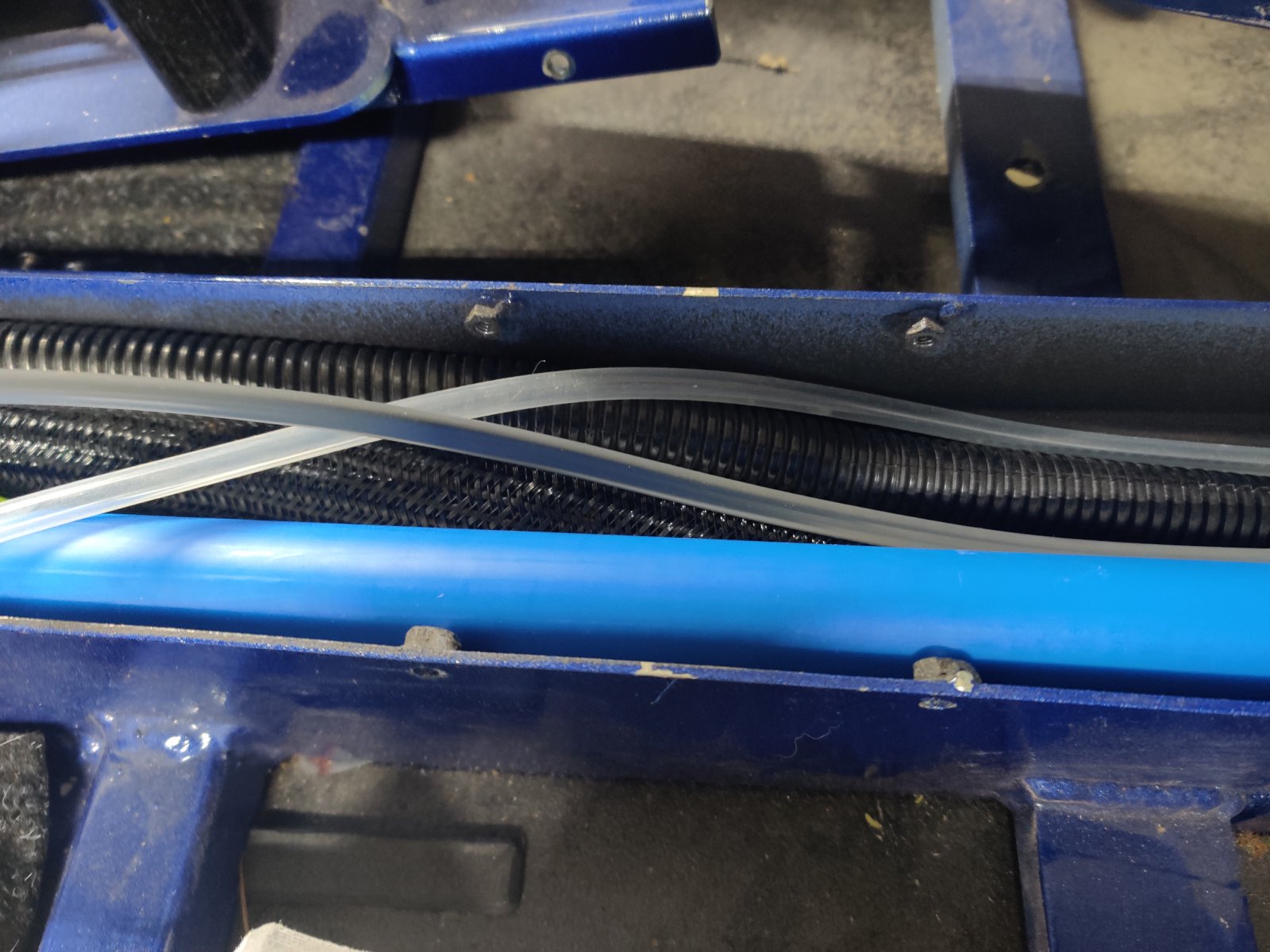

Thats what I planned on doing on this first build. I'm a little concerned that there isn't enough room in the tunnel though.
It will be very tight. Are you going to run the DF heat exchanger?
Here is a picture of my tunnel as of now it has the Harness, Battery cable, boost gauge hose, 2 - 3/4' pex tubes for the heat exchanger, wire for HE pump. I still have to run the wire for the AFR gauge in there.

According to my google search, PEX is only rated for about 180-200 degrees. That's not going to work. lol
Not saying it will work, but with the low pressures that are in the radiator it could work. Probably better on a normally aspirated engine that makes less heat. Maybe there is something better.
Waterdriver
Use the supplied rubber coolant lines. PEX in the picture is for the intercooler heatexchanger. If your running an intercooler, locate the heatexchanger somewhere aft instead.

I'm planning on running 2 intercooler heat exchangers. Both with fans. A primary in the engine bay to dish a bunch of BTU's with fairly high temp differentials and then forward to the stock DF exchanger to get closer to ambient.
I think where he was going, is that you could maybe move all cooling hoses, both intercooler and engine to the tunnel.
