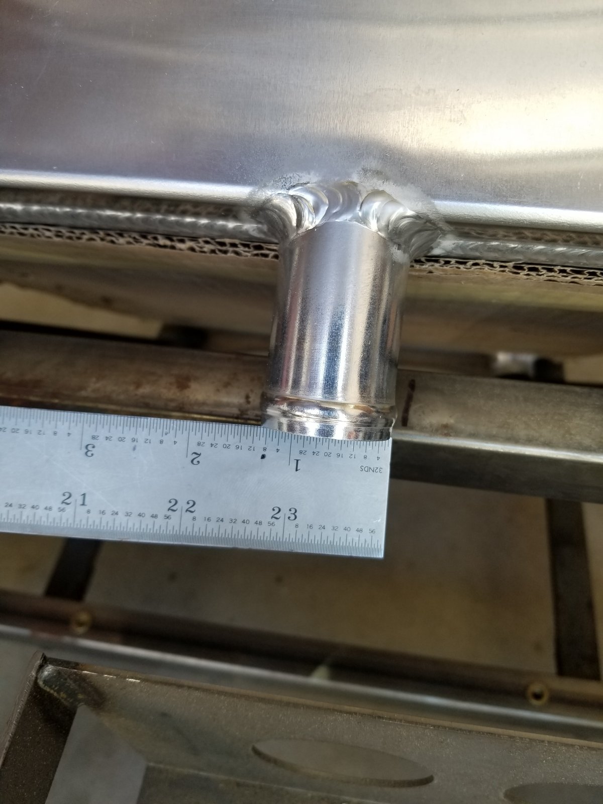

Ken, I got some -16 hose... what'd you do in regards for hooking up the 16 line to the engine/radiator? I'm seeing 16 -> 1.25" radiator adapters at 18$ each at a minimum, assuming i'd need 4... did you go this route? I'm also assuming the radiator hose is 1.25" but I'm not certain, I don't have my kit yet.
1.25 inches. That's 1 8/32 on the ruler in the photo.

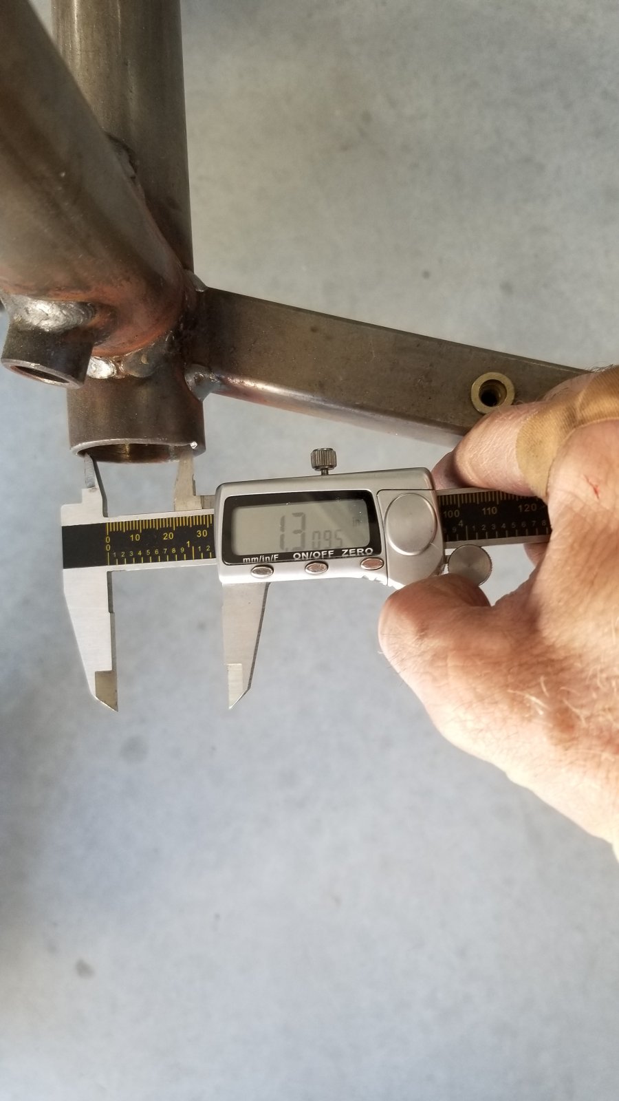

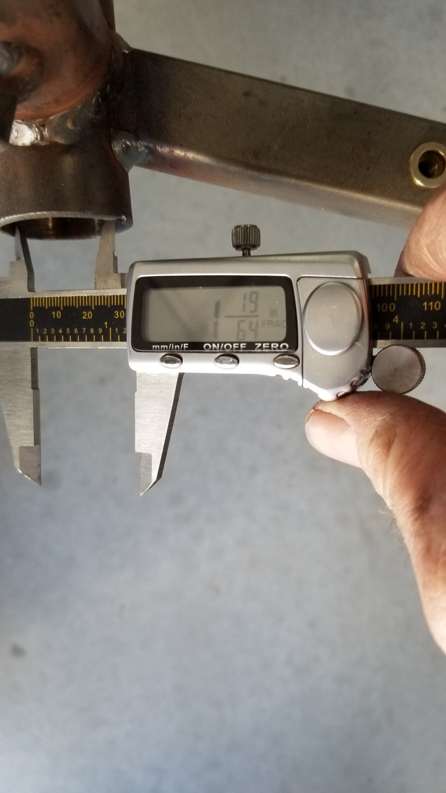

I'm curious as to what the ID of that tube is so that I can see about getting my fittings turned down to slip in for welding.
Couldn't I just thread the an fitting onto the welded fitting after the subframe is bolted into the car?

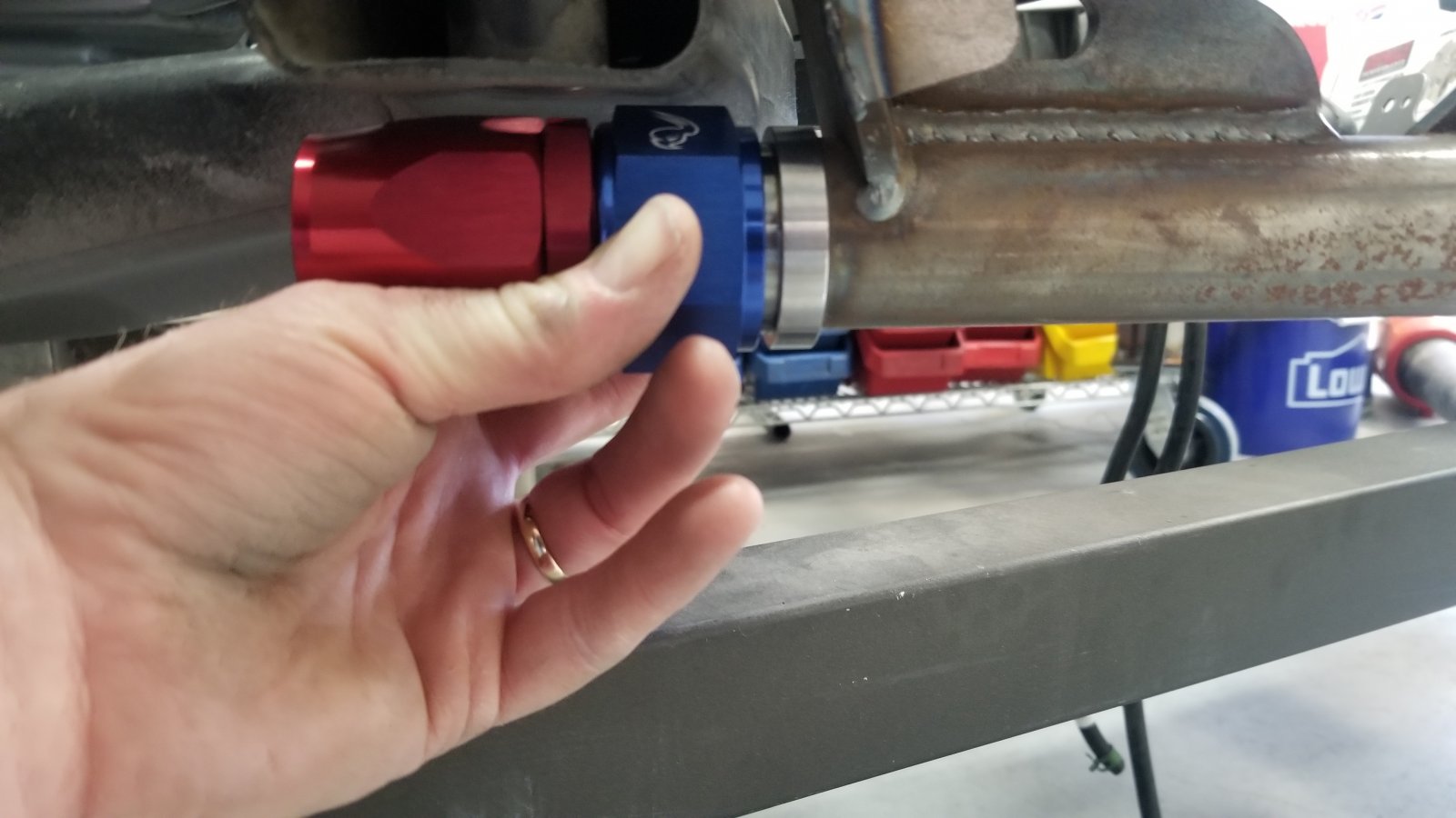

The concern I have is
Jim, would a 90 degree fitting work in that location? The hard line in the bend may give more room for the bolt head, maybe?
I don't know. They also make 30 deg bends also.
They are an expensive little fitting, and on eBay, the vendor doesn't allow returns, so I'm afraid to use to much trial and error. I can use 2 of them on the front of the car, so I've got one more shot to find something that will work on the rear.
I thought about trying an elevator bolt , but I'm nearly positive that even they are to high.
I'm going to see if I can machine a 1"npt female coupler into a weld fitting and then use a 1" barb on the rear. Not nearly as visually appealing as anodized AR fittings, but it would still maintain stock diameters for our much needed desert cooling.
