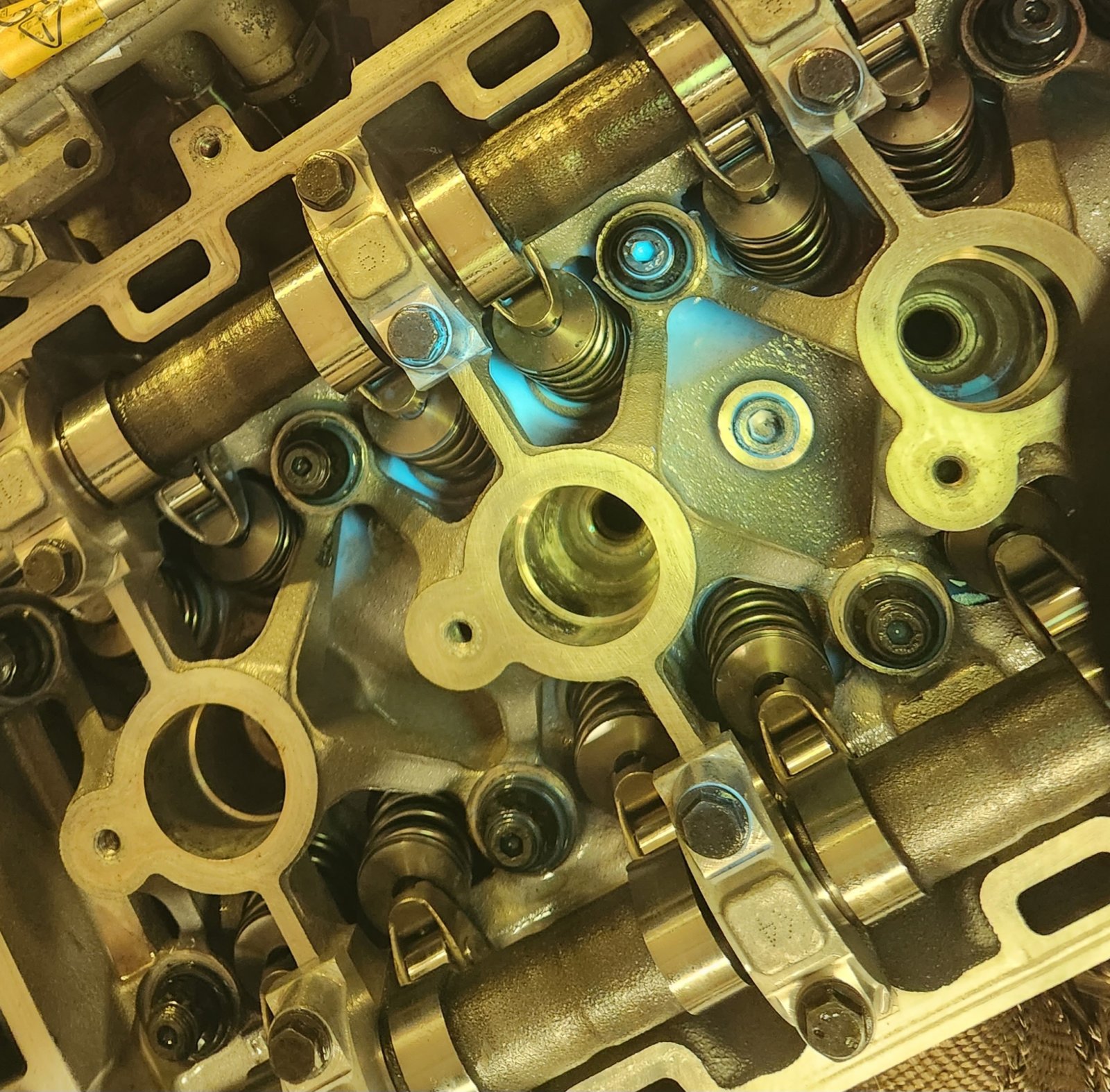

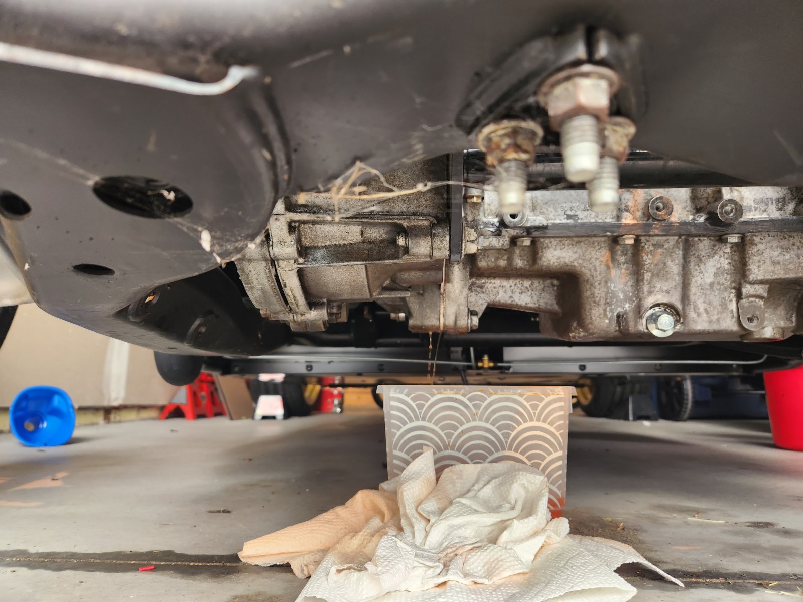

Tried the dye tracer. Didn't help me much. Nothing on top or on the exterior is leaking. Here is a picture of how fast it's draining out. It's coming out of the hole where you can see part of the flywheel so it seems like it's inside the bell housing somehow. I still don't see any trace of mixing of coolant and oil. I checked around every hose connection and thermostat housing and oil cooler etc. I wish I had an xray machine.

Could one of the upper bell housing bolts be too long and has punched into the water jacket?!! If that is the case fill the cooling system (you prolly don’t need it running.) take each of the bell housing bolts out one at the time and see if coolant comes pouring out! I think there is only water jacket behind the two top bolts straight down from the head. You can run the engine with a couple of bolts out SO LONG AS THE REST OF THE BELL HOUSING BOLTS ARE TIGHT! AND DON’T drive it! Reinstall all bell housing bolts before driving any car! ****I have seen block seal work but if it’s leaking that fast it’s a fair crack. Could it have frozen? I don’t like block seal, it could seal up more than your problems!! It works by filing in any gaps where there is a pressure drop. The calcium in the mix will stay liquid in hot water but where it leaks the coolant water phase shifts to steam and the calcium wants to fall out of suspension, the calcium sticks to and builds up in the exit point until it actually blocks the hole. There isn’t much area behind the flywheel that is the outside wall of the cooling jacket. The only way is to pull off the trans and clutch assembly and the flywheel. Maybe you can use one of those inspection cameras in there? I paid $80 for one at harbor freight. It has ID’d many 4.8 LS motors for me. (A 5.3 has a dished piston and a 4.8 the crown is flat. Pretty easy to see with the bore scope and a piston all the way down.) I am really curious as to where this leak comes from!

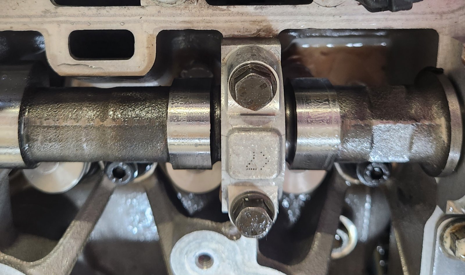

Started taking the engine apart. Pulled the valve cover off and there is coolant everywhere and a jelly like substance covering everything.

Jelly-like? Coolant under the valve cover is bad. Jelly-like may be really bad. GM’s factory coolant doesn’t mix well with other coolants. Mixing old-fashion green anti-freeze with GM’s can result in a jelled mess. I hope that isn’t what your jelly is.
